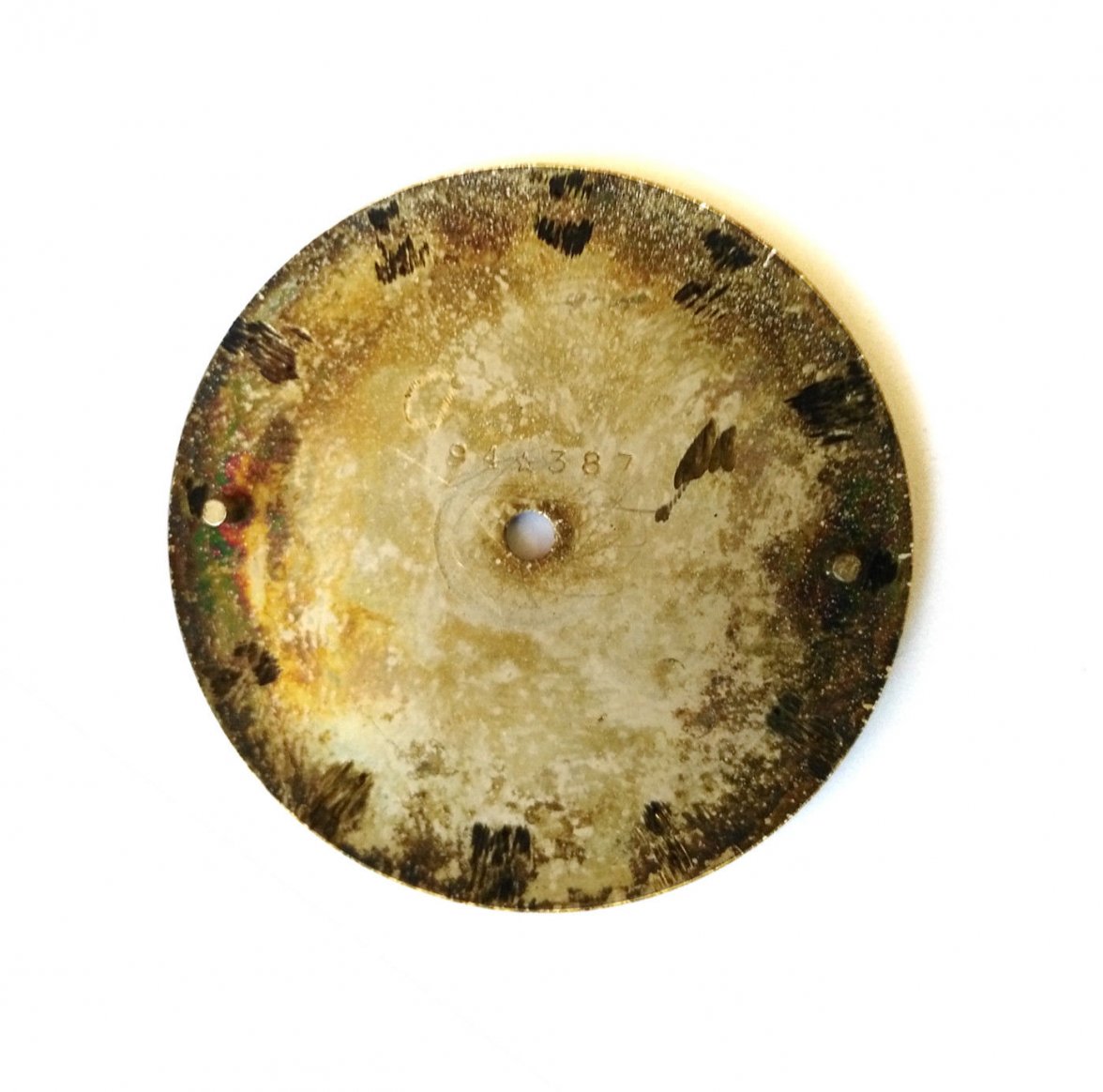

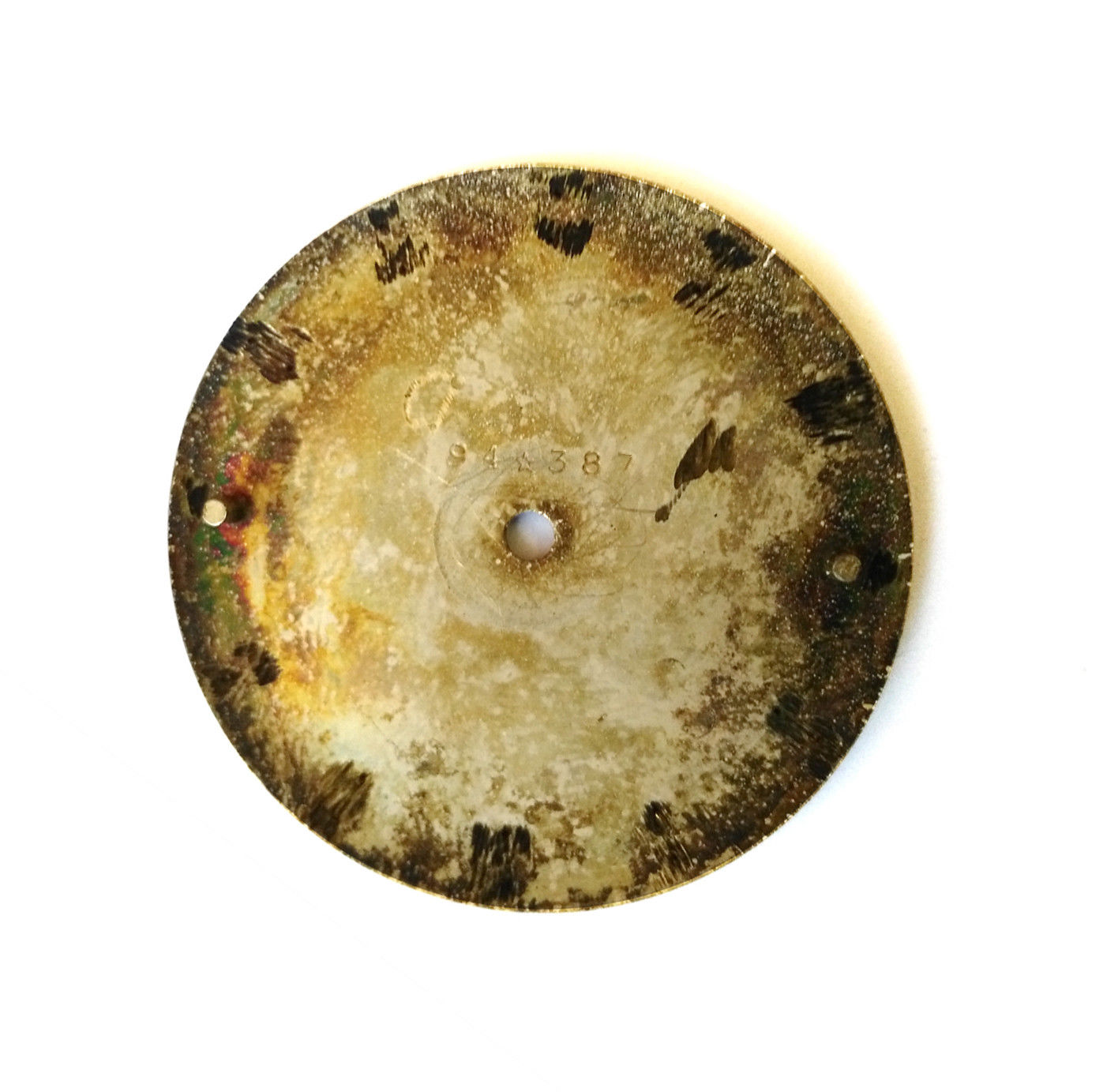

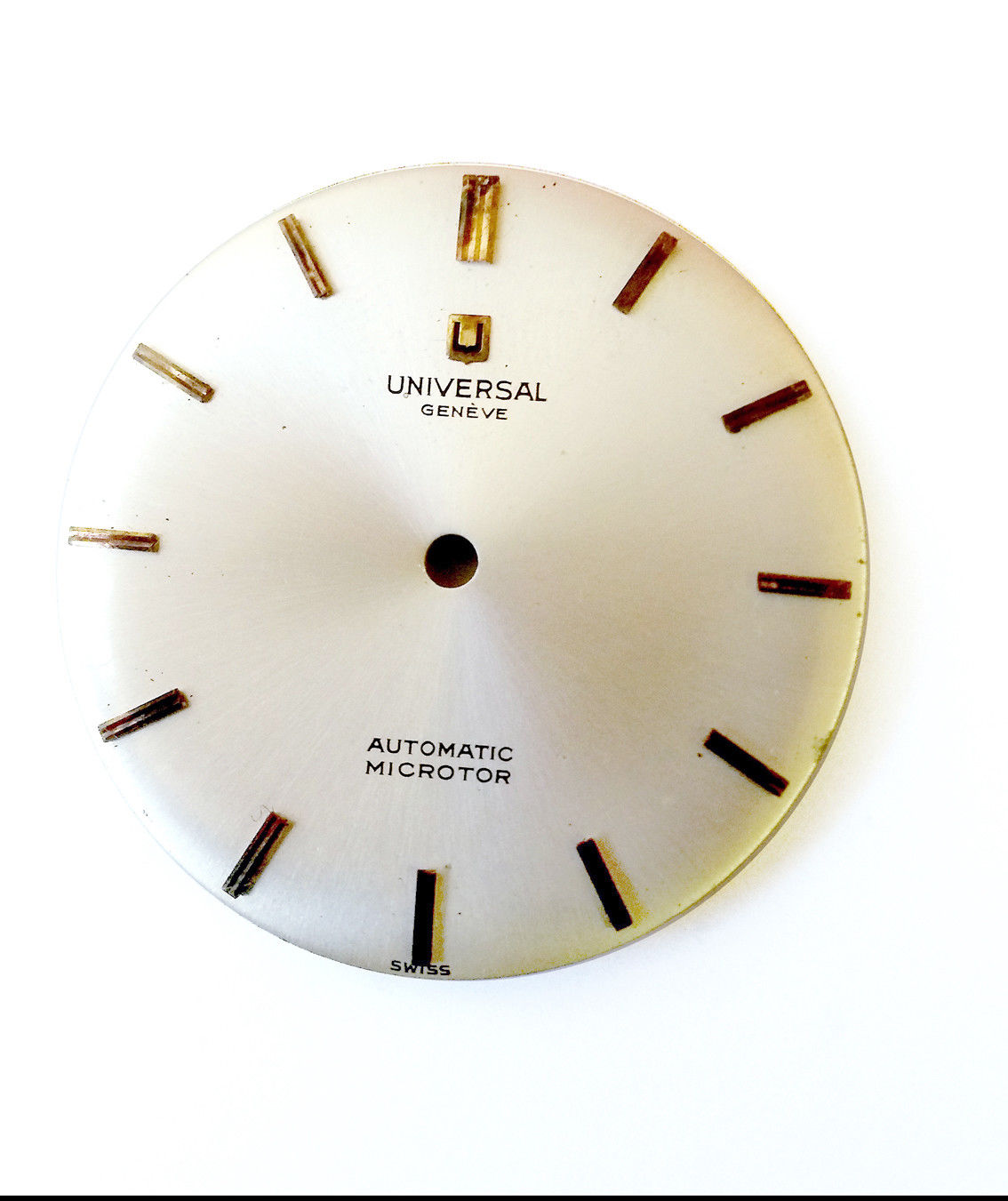

Another Stern dial for UG on eBay today with the Stern UG code of "94".

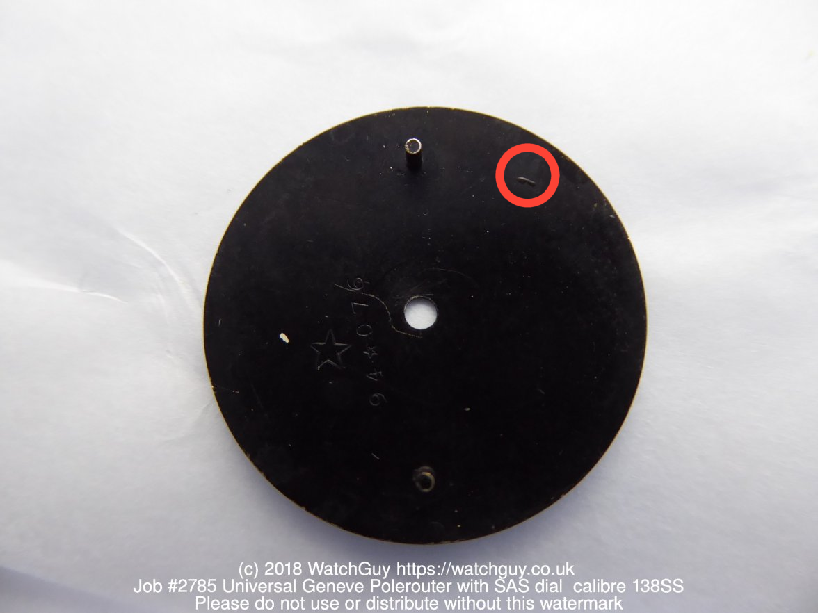

The order number for this dial is "387" whereas mine has an order number of "076" so is presumably earlier. Anyone have a feel for the date of this dial?

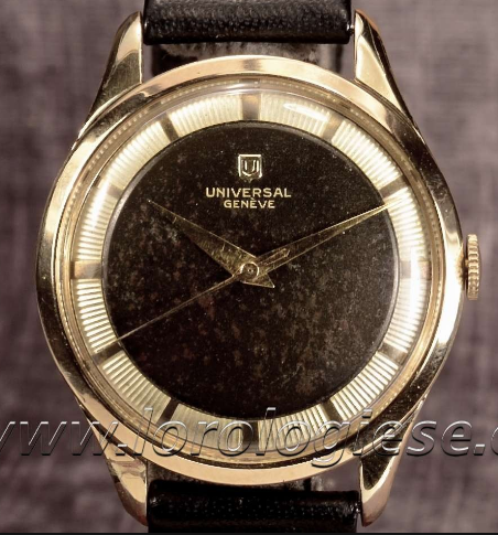

Are there any known examples of a case reference 20217-4 that do not have Polarouter printed on the dial?
13,636
18,994
Took me about 2 seconds to find one:
http://www.shucktheoyster.com/universal-geneve-polerouter-ref-202174/
Another one:
http://forums.watchuseek.com/f29/un...**-ref-20217-4-**-c-1955-**-ohpf-4603397.html
And another:
http://styleintime.com/Vintage-Watc...niversal-geneve-polerouter-automatic-sold/152
All are 17M+ serial numbers. I think the "Pola" vs. "Pole" has more to do with the production date of the watch than the reference number.

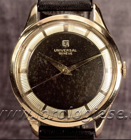

I was wondering if your watch could have been a presentation watch based on a classic dress watch, as opposed to a Pole/Polarouter. UG apparently reused the Genta design language in a series of dress watches such as this one...

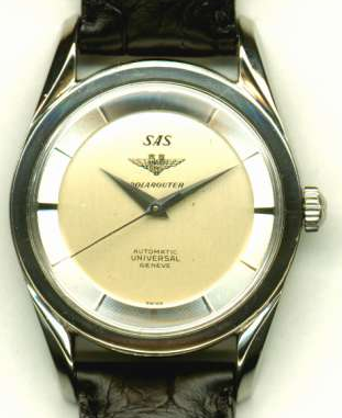

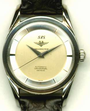

The SAS Polarouter was only produced in a very small batch (maybe 20?) and over a very strict timeline (1954). However, the 20217 case reference was around for far longer so there are many Polerouters with that case.reference.The gold SAS examples were presented to:
Hans Hedtoft (Denmark)
Erlander Day (Sweden)
Oscar Torp (Norway)

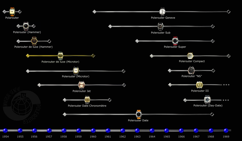

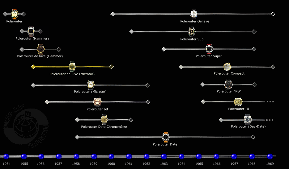

The standard Polarouter SAS were presented to the crews of that very special flight when the polar route was opened. here is a timeline of the polarouter and polerouter models (courtesy of polerouter.de)
Concerning all of the other scenarios like prototype, non production, test and so forth that may have given rise to the "black" SAS polerouter (so made after the polarouter), it is mostly assumptions and guess work all of which introduce further doubt as to the genuinity of the dial and watch. It should all be taken with a pinch of salt considering the following:
1. no other examples of a black SAS apart from a claim which cannot be verified
2. back painted black (indicates a redial)
3. condition of dial is very good (recent re-dial?) but poor print
4. incorrect script and many inconsistencies when compared to a known original SAS dial
5. silver hands (may be correct for original SAS but not on black and gold)?
It is wrong all over when compared to the real McCoy ...

- I am still hoping/expecting to hear further from the dial manufacturer. I know for certain that the three digits after the star indicate the order number for the particular client i.e. "94*076" indicates that the dial was made for UG and that it was UG order number 76. This is why I am hoping that it will allow me to date the dial.

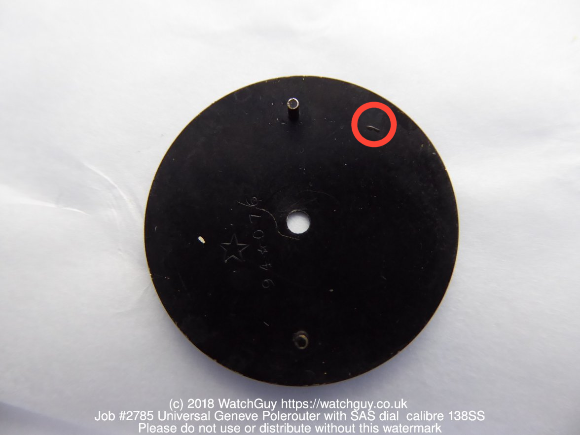

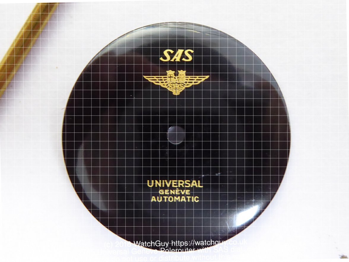

The reason why the dial is black on the reverse is apparently because it was galvanised. This is also why the front of the dial is very glossy and has survived well because a layer of lacquer is typically applied to the front after the galvanising process.
I'm still hoping to date the dial itself although that is unlikely to answer the key question of who applied the SAS logo and text and when it was done.

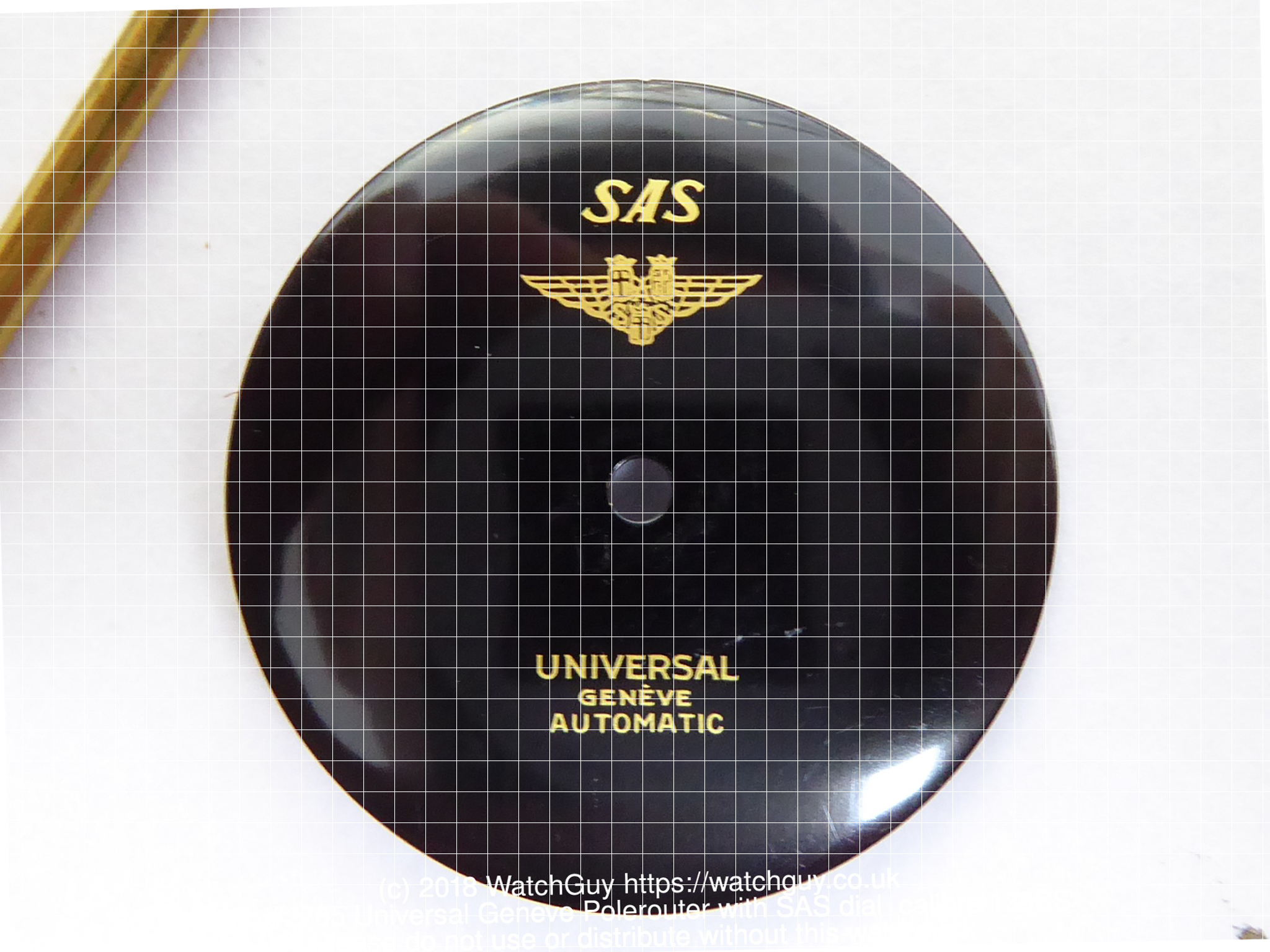

1,210
3,069
Although the dial printing is not perfect, it is at least straight, with the SAS text, the SAS logo and the UG text all parallel with each other.
1,526
3,158
Galvanising protects steel or iron from rust. The process involves dipping iron or steel in zinc. Dials are usually made of brass, silver and rarely in more expensive watches, gold plated or gold (which does not rust). Galvanising leaves a silverish tint, not black. Additionally that dial shows what looks like a blob of paint ...
It is definitely not galvanised or anodized come to that (only used on ally) ....
Sorry to be so skeptic about it but it does not convince me in any way. The very least I would expect from a redial, is centering !
Apart from all of that, you seem to be convinced and I admire your persistence. However, in my eyes it is mutton dressed as lamb (old english saying).
I was just passing on the opinion received from the expert consulted by Phillips regarding the galvanised dial.
I understand that dials produced using the galvanic process would usually have a back showing the same black galvanic bath and a very glossy dial as shown here.
I'm fairly sure that galvanising was used to produce "gilt dials" with recessed golden lettering. I'm not in any way comparing my dial to a "gilt dial" (the printing of my dial is not recessed) but just pointing out that a black galvanic bath was used to produce glossy black watch dials with brass plates.
