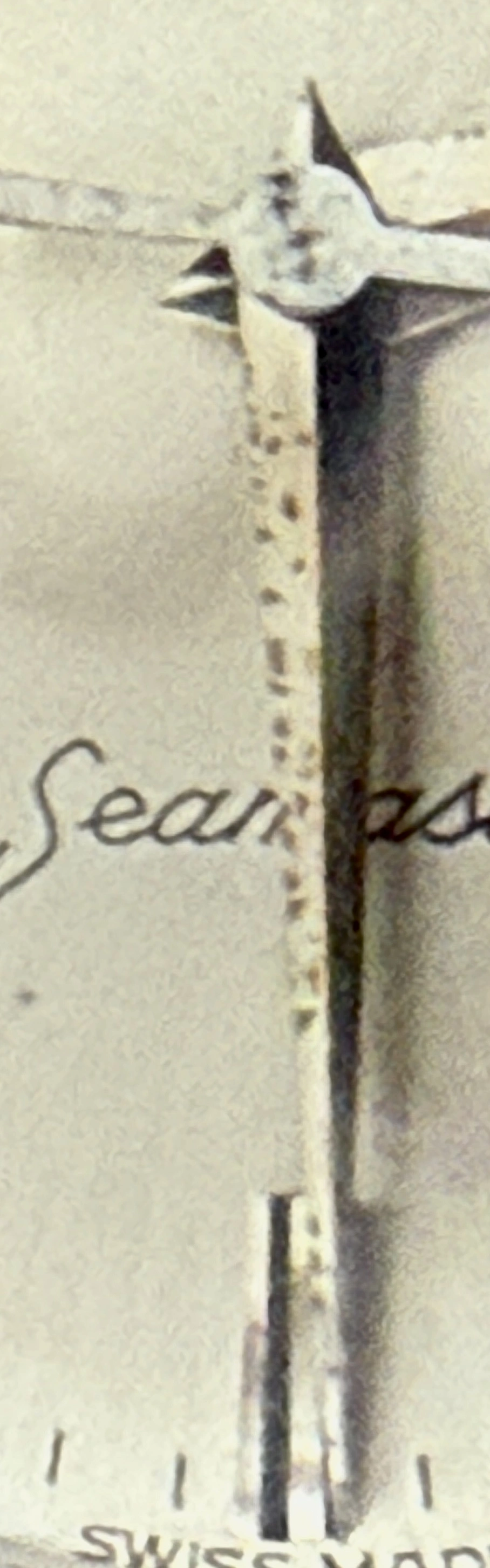

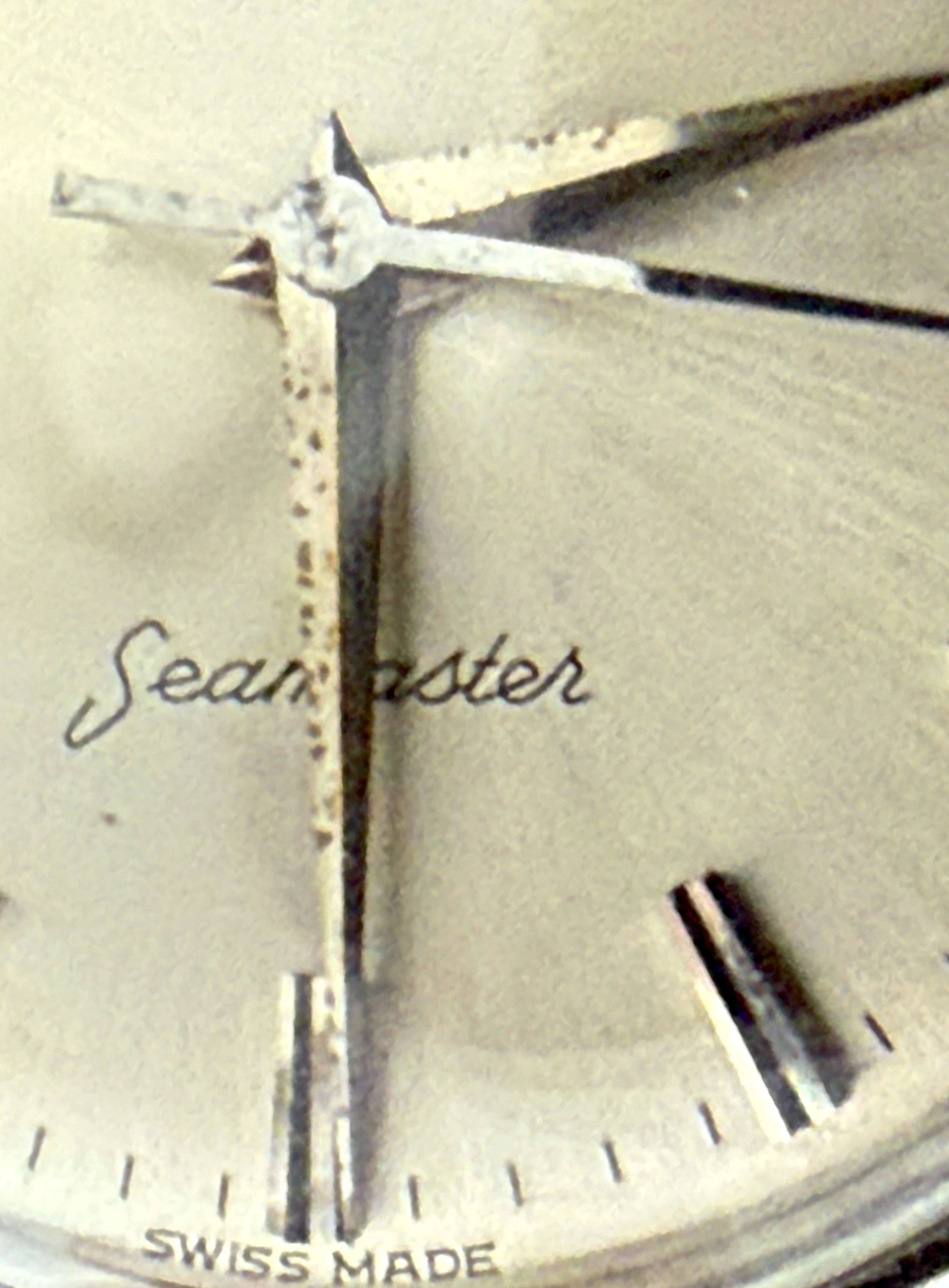

Hi,
I took a picture of this watch yesterday and noticed some rust on the hour and minute hands.
What do you recommend in this case:
1. Replace hands
2. Clean current hands if possible
3. Leave it as it is
Thank you
Jorge

I have worse.
These are fairly common, so replacment is probably an option.
Restoration can be time consuming, and material will be lost.

Also a lot of these hands are stainless steel but plated so polishing them can wear through the surface and expose the base metal
Edit: I meant “not stainless steel”
907
3,818
Did you mean they are "not" stainless steel?
I had a set of hands in similar condition and I had them replated in white gold. It definitely improved the look but it's not perfect.

You’re right! I meant they’re not stainless steel.

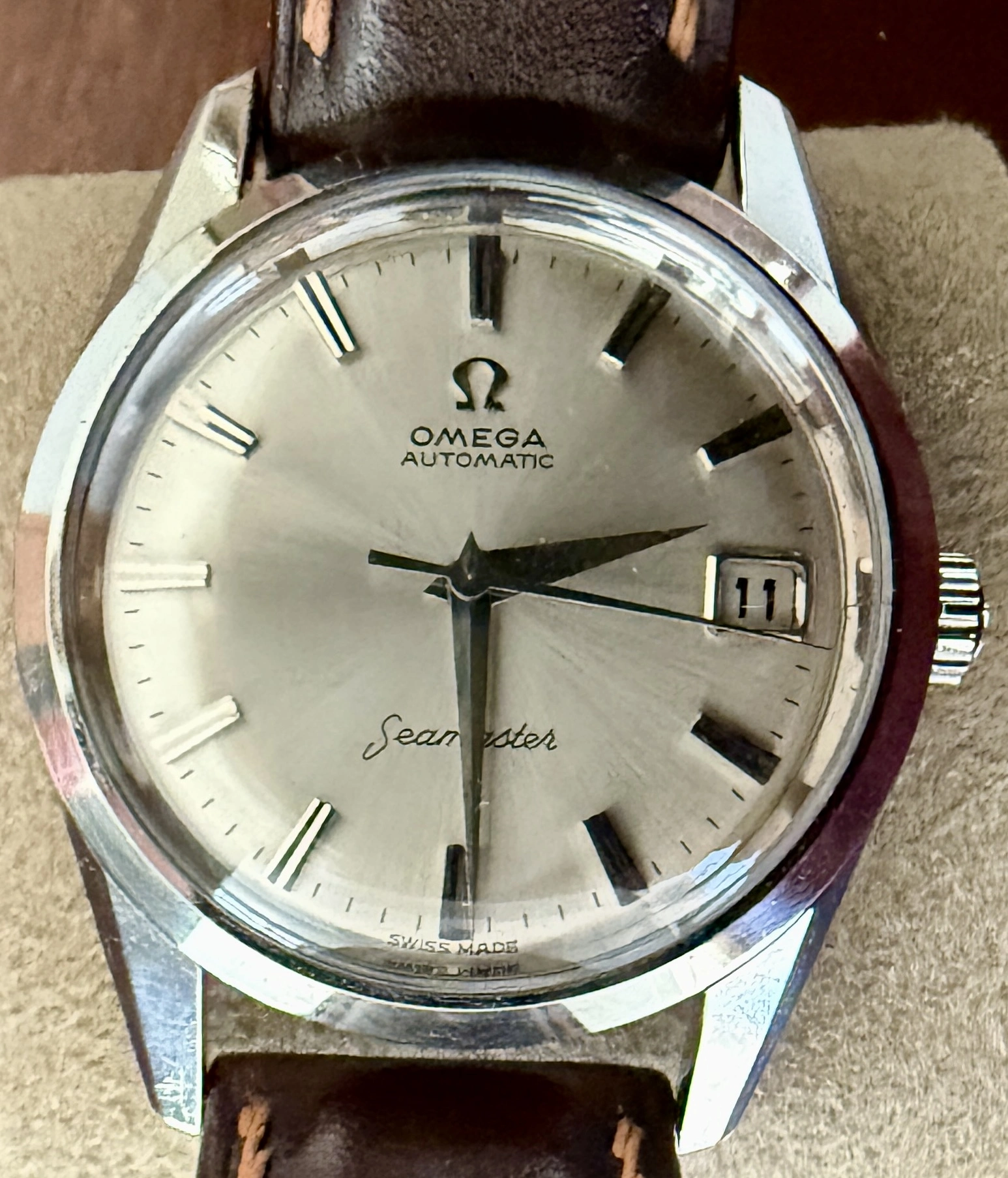

Here’s a before and after of white gold plating of the hands:

I had some spare hands that had corrosion on them. I polished them with fine diamond suspension (1 micron I think) on a rotating disc flat lap and came up with a great surface on the metal. The black paint in the centre of the hand was lost, but was easy to replace. If the part is rough, its worth a shot.

I vote curtain #3
Many if not most vintage watches will show some oxidation on the hands- but usually I cannot see it on the wrist. Maybe its my aging eyes. And youre not running around with a loupe I hope.
