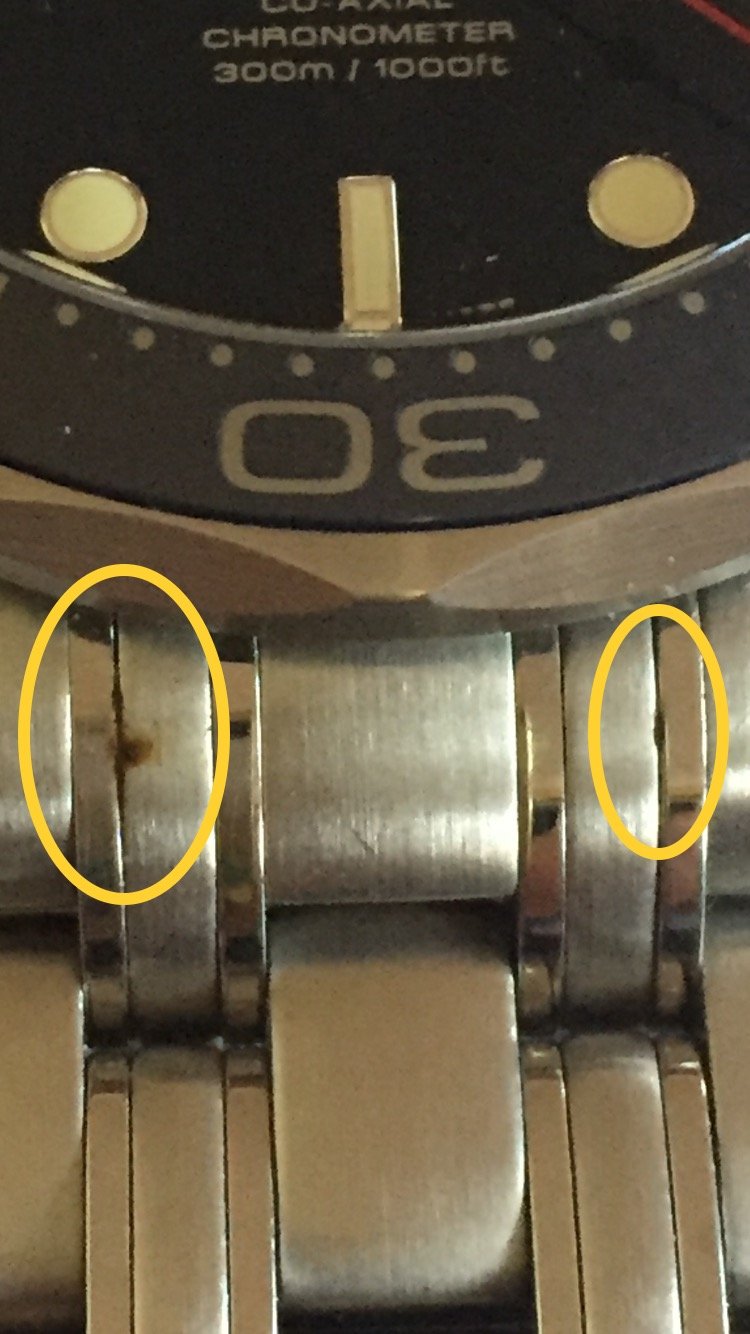

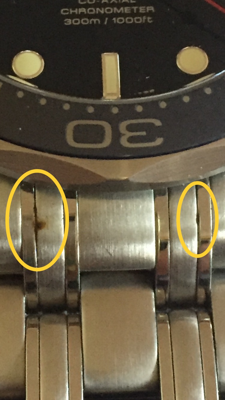

Rust/corrosion on 3yo SMP Diver 300 bracelet

G’day Donn, I’ve never worn the watch in salt water nor has it been in a pool (salt or fresh). I live in a tropical area, so I assume that perspiration from my wrist has played/plays its part. I wash/ clean the watch regularly and manage to remove the rust stains at those points. Despite numerous cleans over the last 2 years, the rust always returns. I’ve just become used to it.

just looking at where those rust spots are, is there a chance that the spring bar has rusted and it’s spreading up between the links?
One of the first things I checked; no joy there.

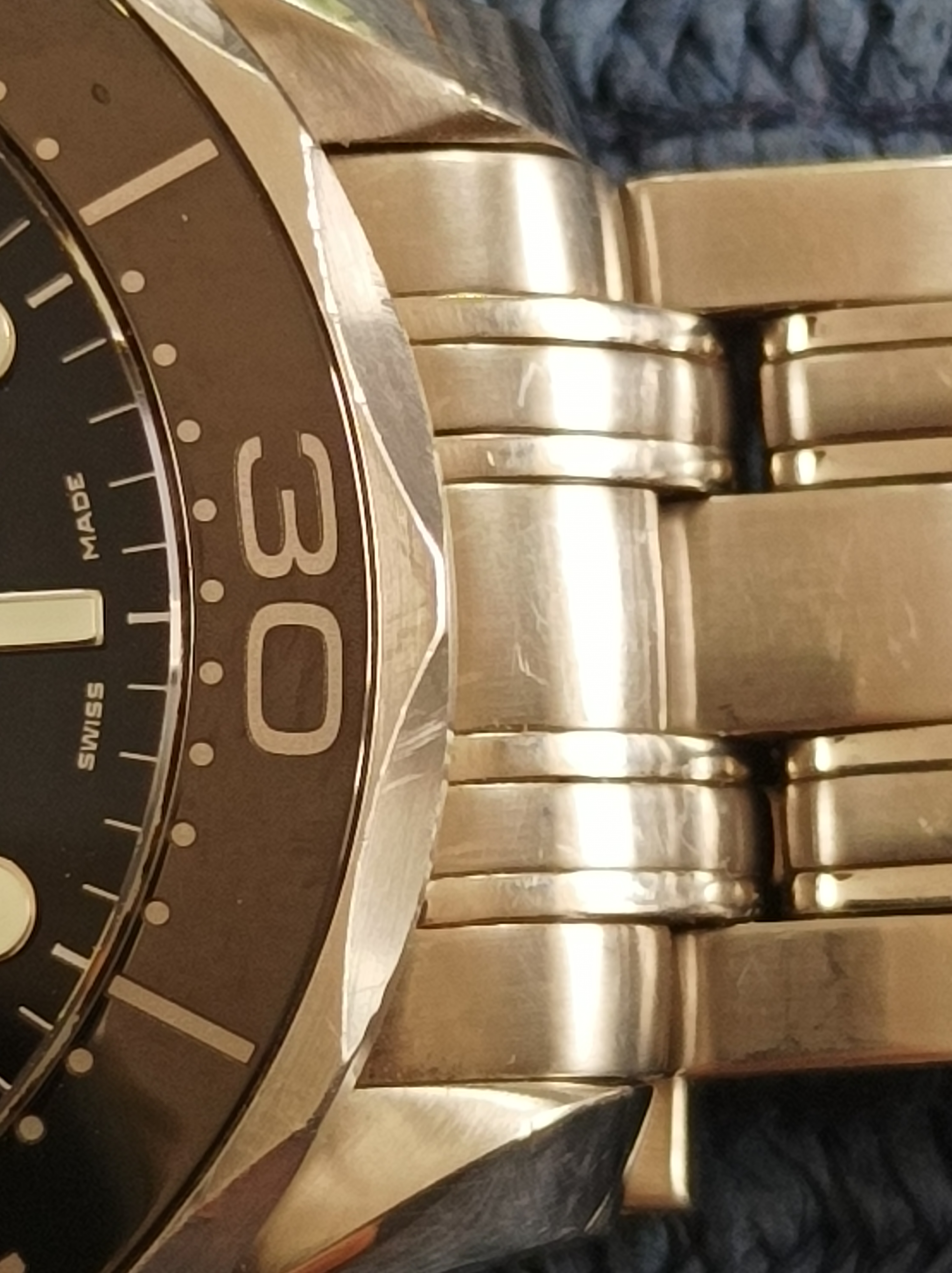

Not that it's of much use to you but I think you've been unlucky, my 2016 has had a feed of sea water abuse over the years, worn sailing, windsurfing, swimming etc, not an ounce of corrosion. It is a bit battered though.

No idea. I did a double check of the watch just now, looking through the links and all the nooks and cranny, all clear. The only rust spot is the one pictured on the side of the link. The rest of the watch is fine.
Unlucky......yeah, I guess so, but it’s only one link, which is replaceable. Interestingly, I inherited a 40-year-old Sea master from my father who wore it to work as a builder. The condition of the bracelet and crystal is bad enough that it would turn heads and have folks staring and talking in hushed tones if I walked into an Omega-only soiree. Of course, there wouldn’t be any talk about rust...because it doesn’t have any.
