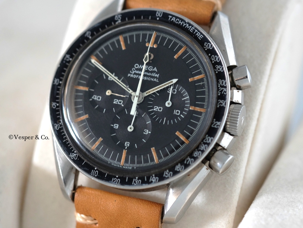

    Hi all. I've seen the occasional Speedy and other older SS watches with small rust or corrosion spots on lugs and sides of the cases. I'm wondering how big an issue they are? Is it something that should be avoided or can these spots be treated without removing metal? Here is a recent example I've come across...
