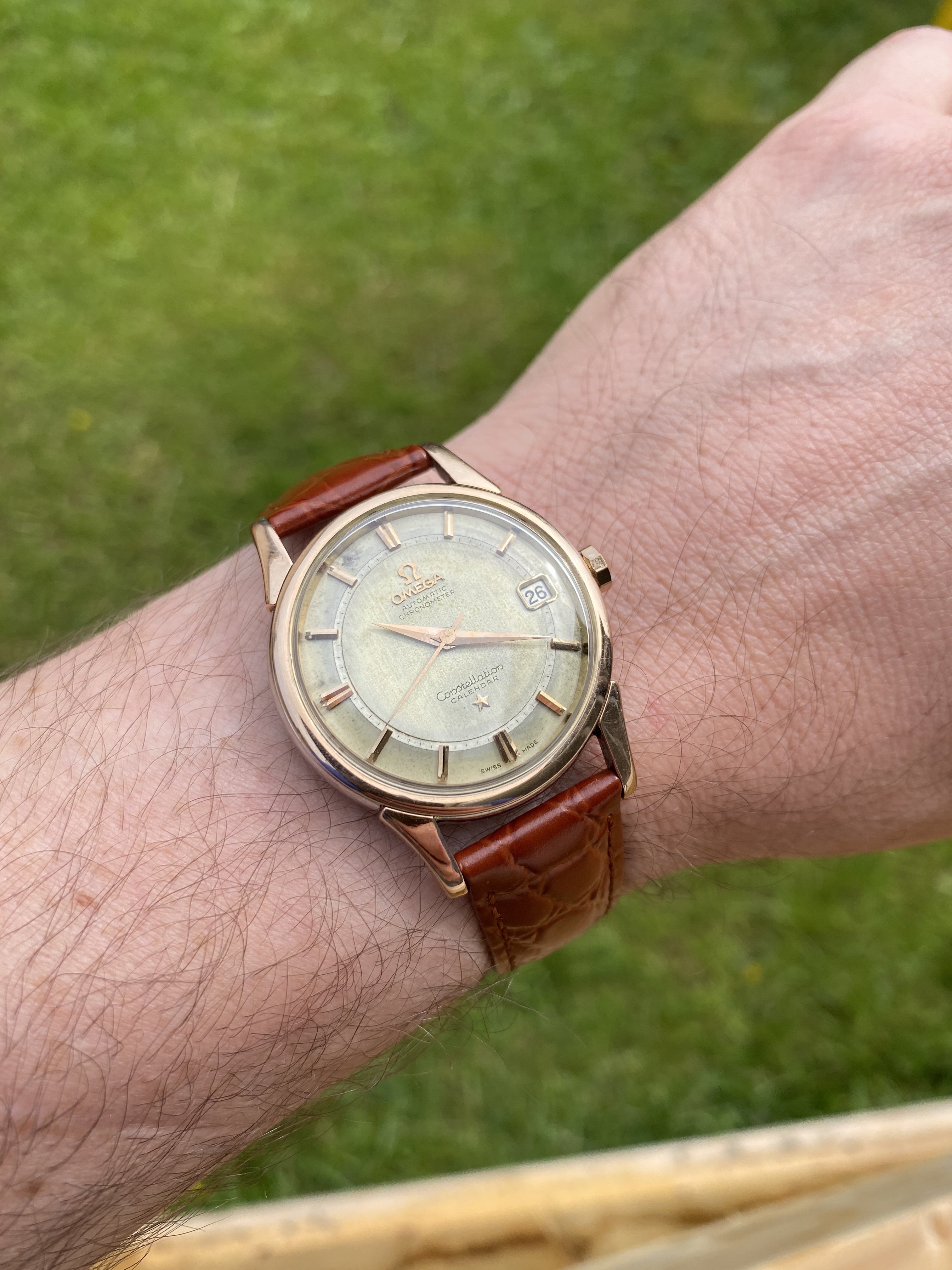

Hi!
I’ve owned a number of different watches at varying price levels and for example I can’t hear the rotor in my 16234 Datejust even in the slightest. Of course I’ve had Seiko 5’s that make a racket!
Just wondering about this old constellation with a 561. Those of you kind folks that own an omega with this or similar movement, is it ok that I hear noise a bit or should I get it looked at maybe it‘s rubbing?
thanks very much in advance!
