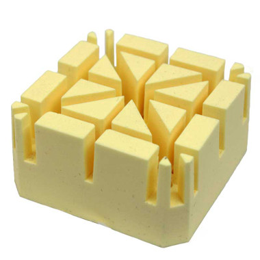

While we’re on the topic: anyone use these? Worth buying one?
