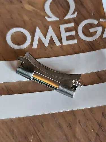

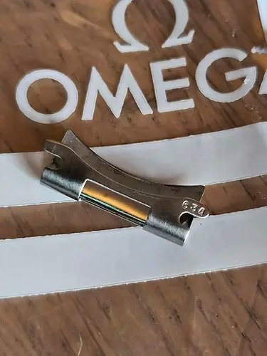

I recently bought the vintage bracelet for my 166.073 with 22mm lug width.
My question is. Do I need to source two "barrel links" in order to make a 634 End link work?
I could pull the fixed link to expose the barrel, but then the last remaining link is 19mm not 22mm. ( if you follow me 😀

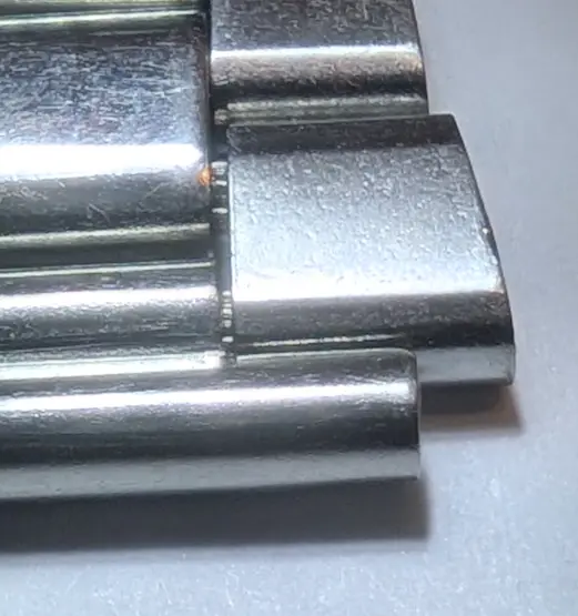

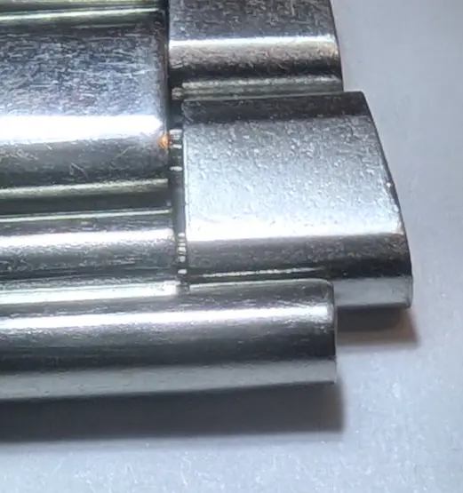

Here's what I'm up against. PS. The last pic shows the "somewhat" serviceable fixed link. it'll come apart where the serrated pins enter the side piece

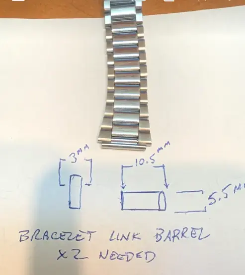

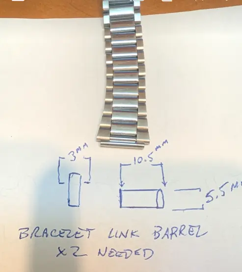

I was just walking my dog thinking of this exact option 😀 I'll look into the measurements of the links youve mentioned. I have 2 SM300s. One all original with the Joske J/M bracelet, and the other on a leather strap.. I'll be sure to post what I come up with. Cheers for the options. Here's an example of what I planned in order to keep the fixed link the original width..
