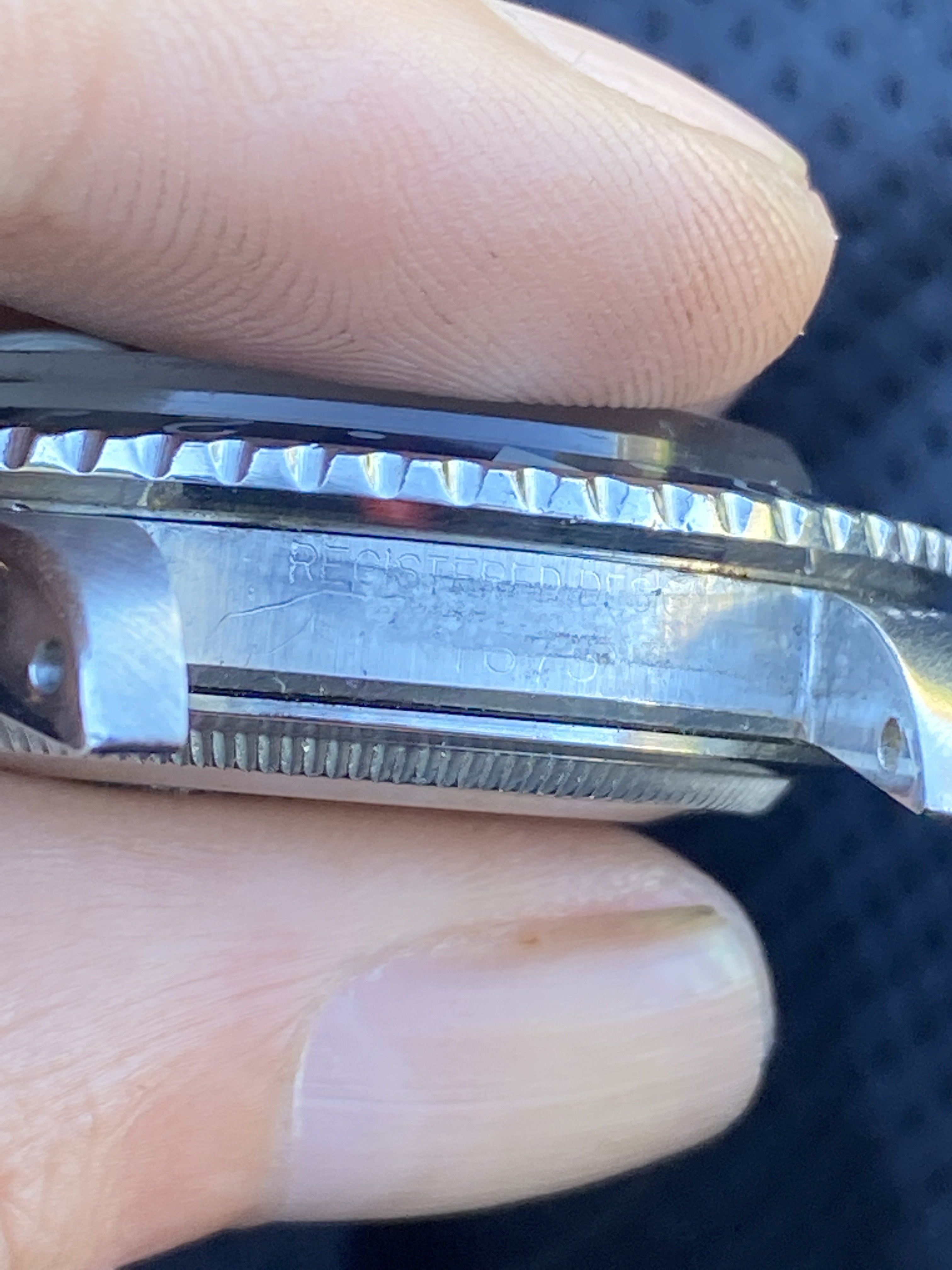

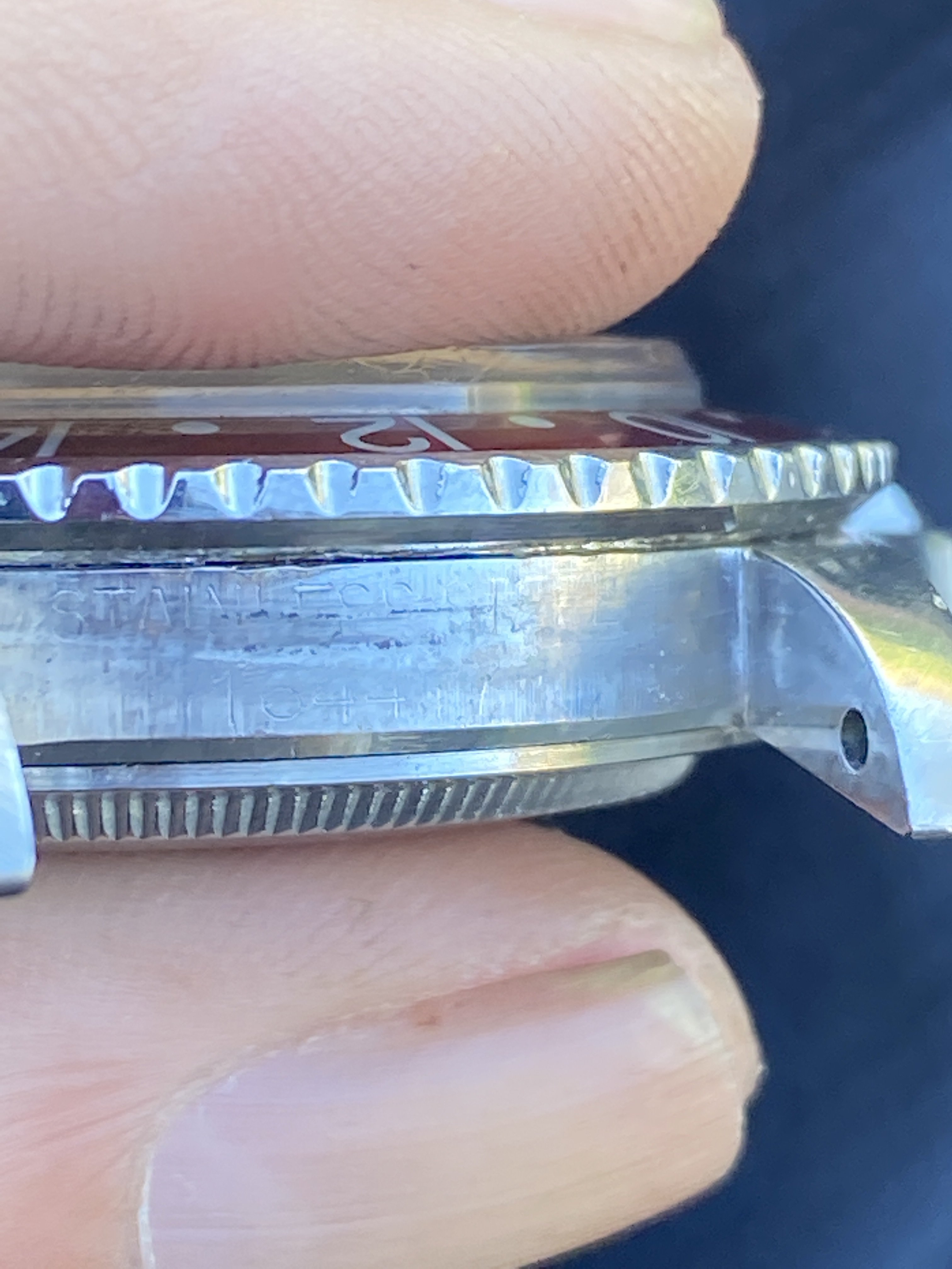

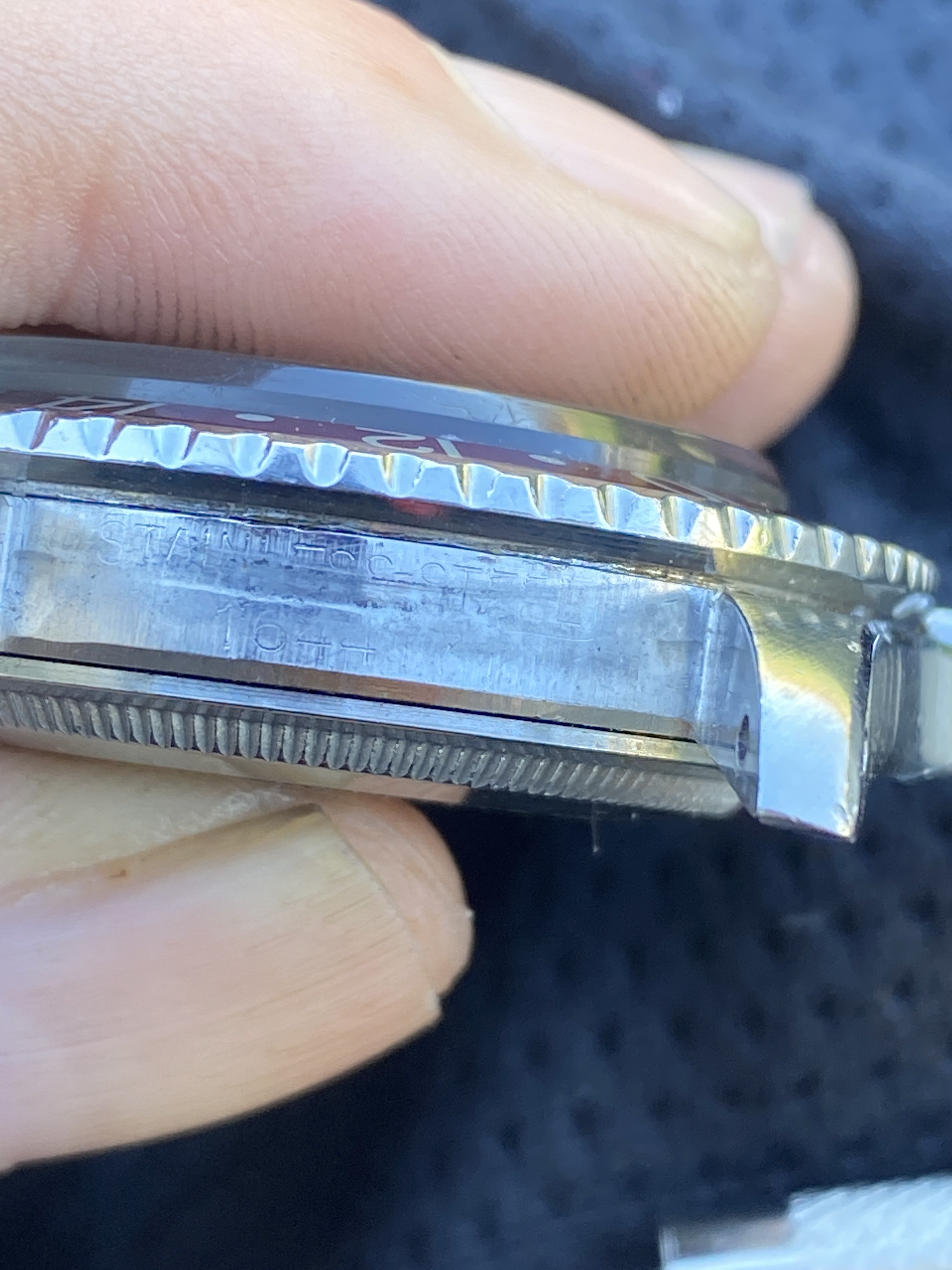

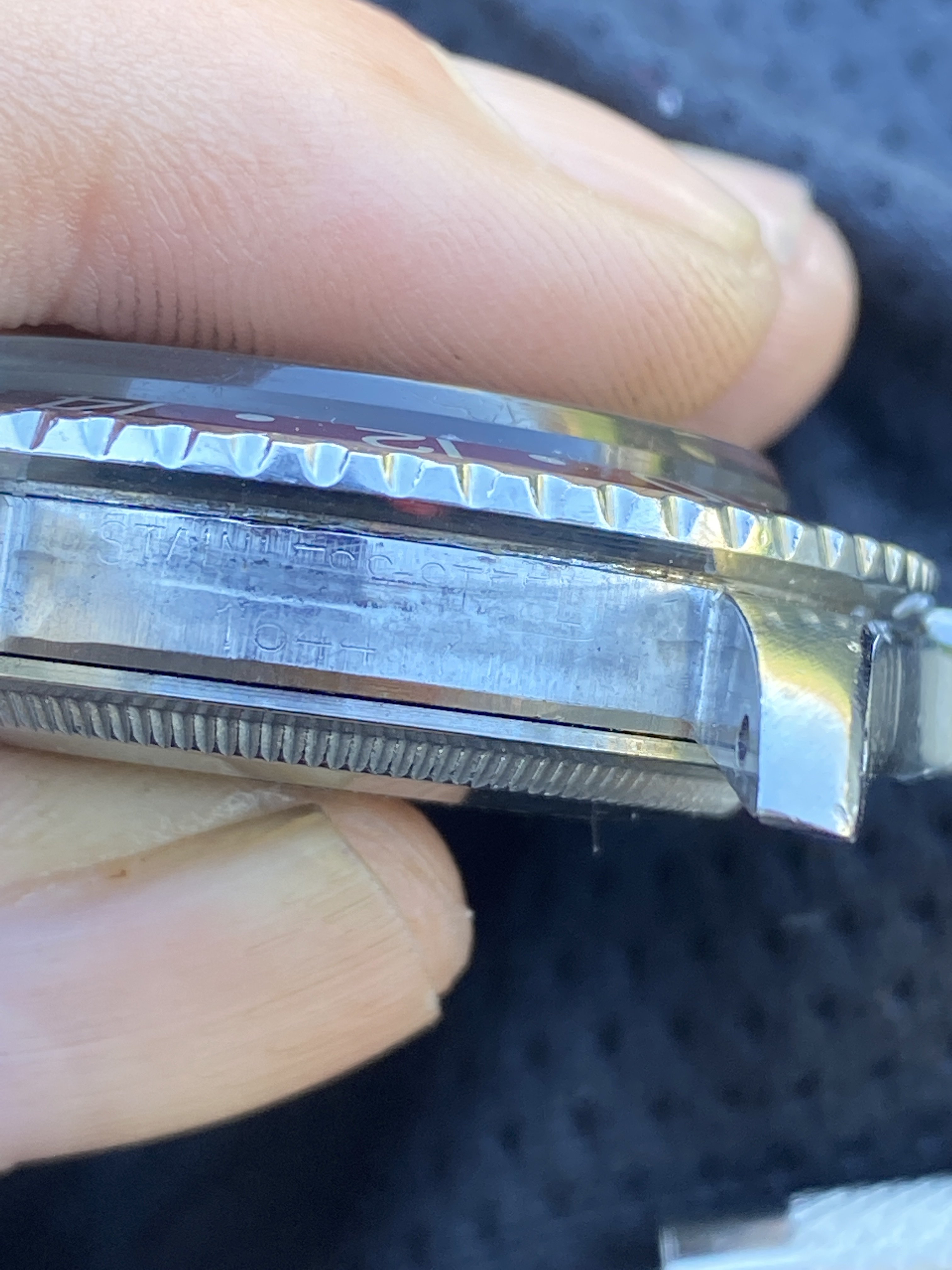

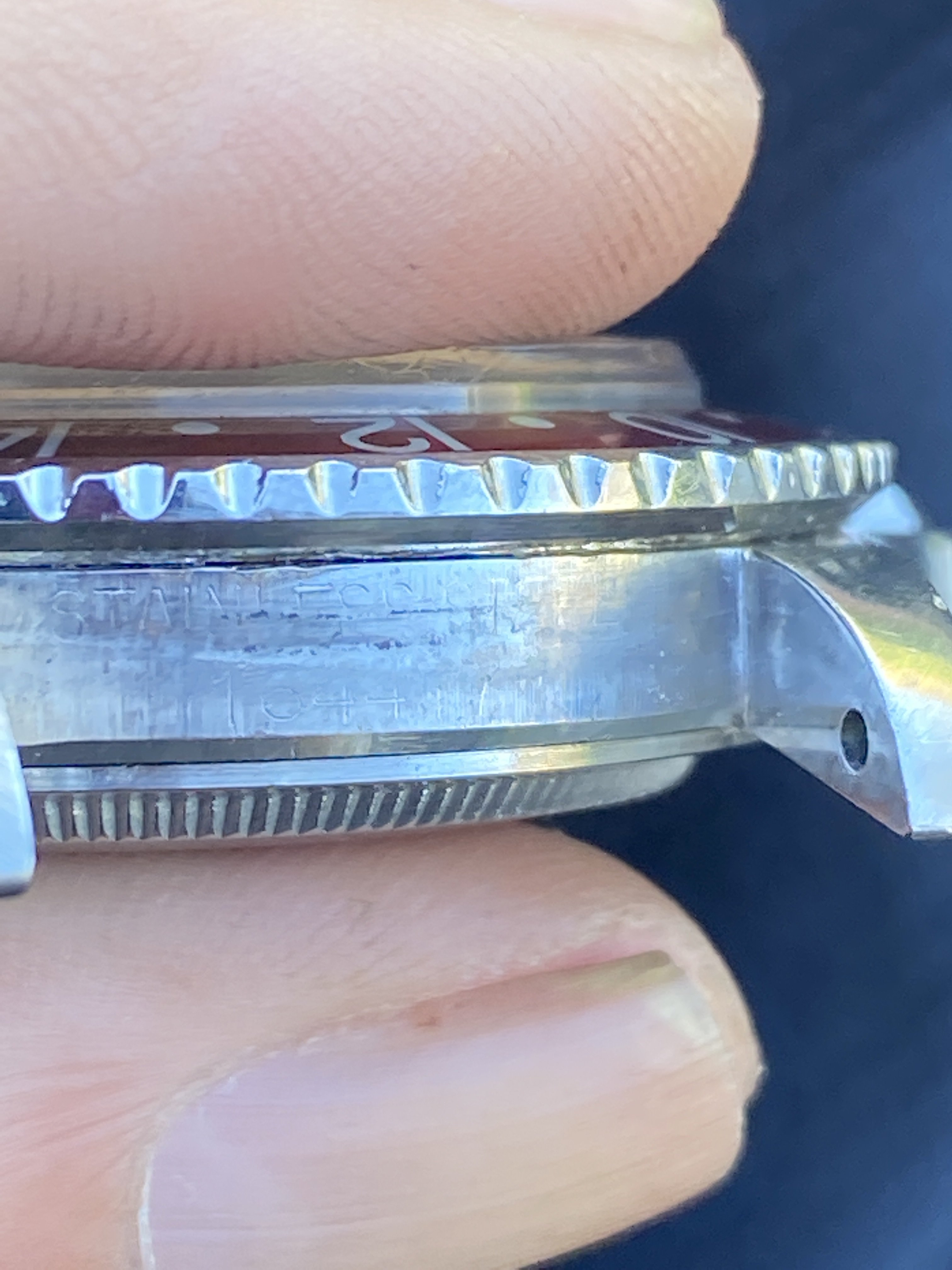

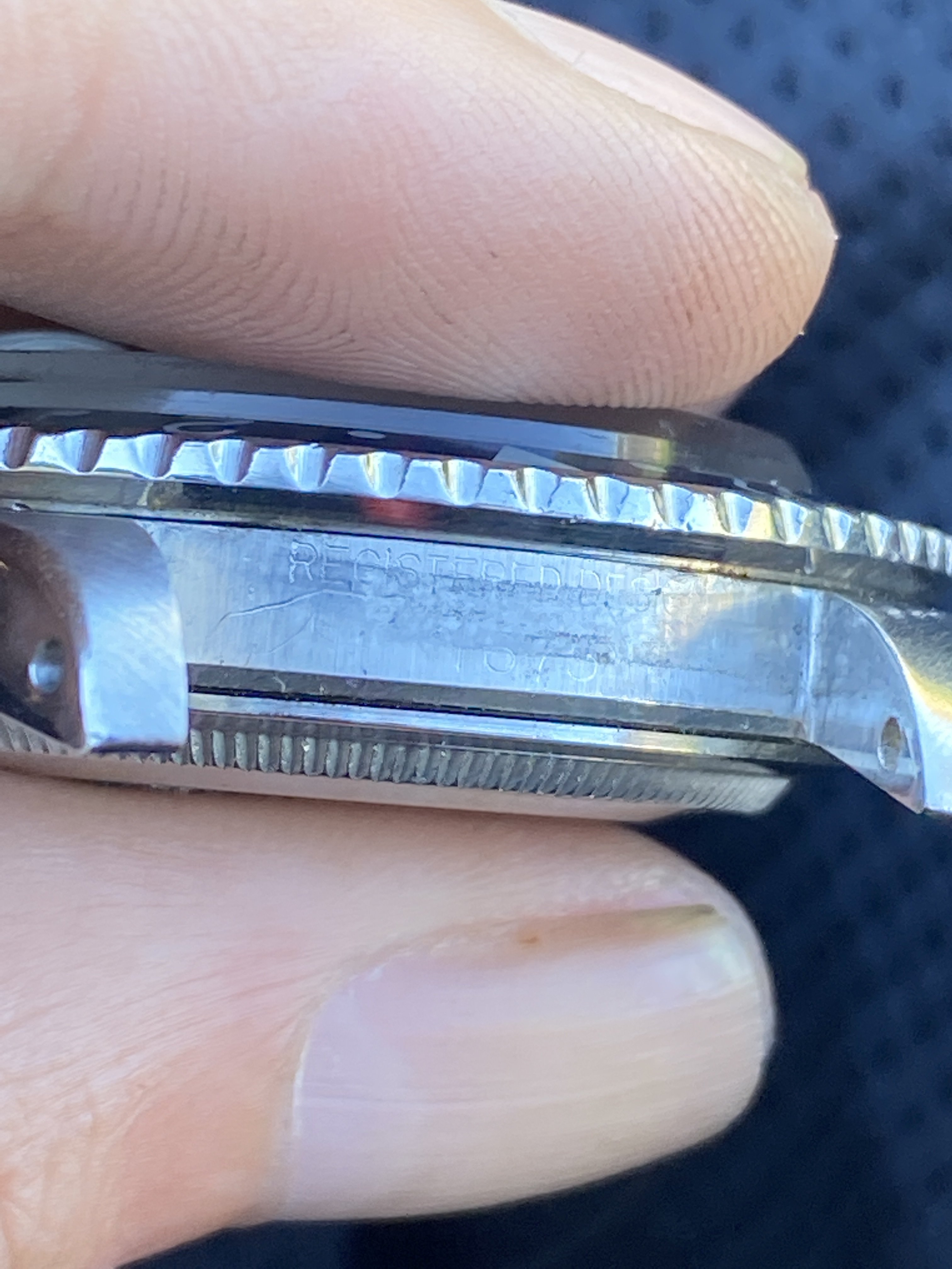

Did you ever tell us the serial number so we know when the watch was made? I can't find it. It's a bit hard to recommend bezel inserts if we don't know the year of the watch.
No he hasn’t....
276
929
I can’t read it out 100% cause looks like the bracelet scratched it up pretty bad but I’m sure it says stainless steel 164417.

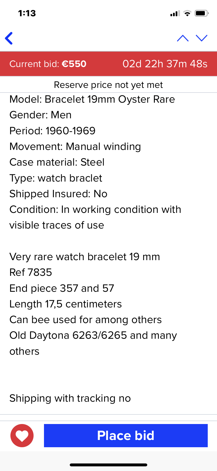

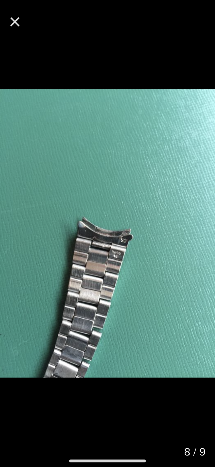

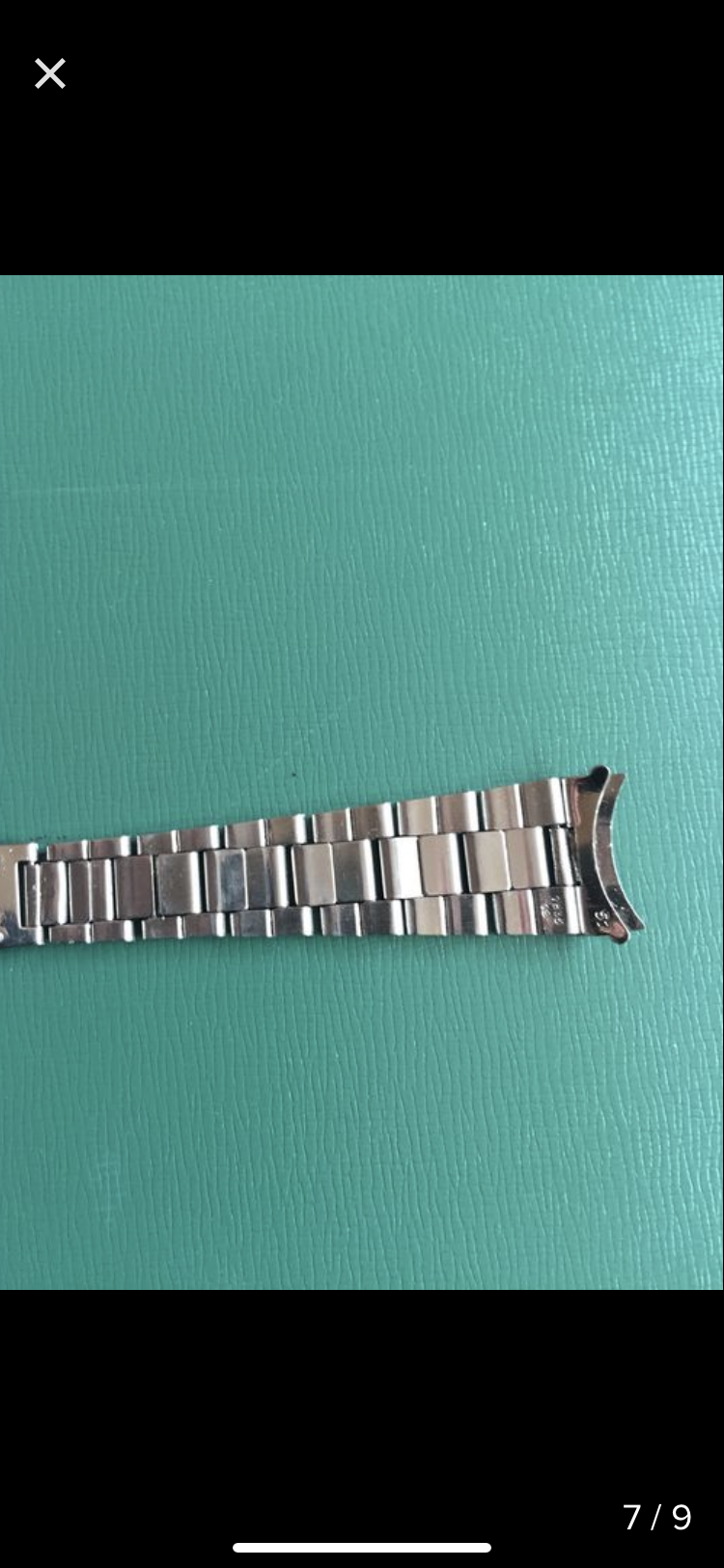

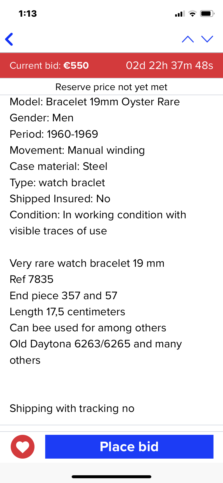

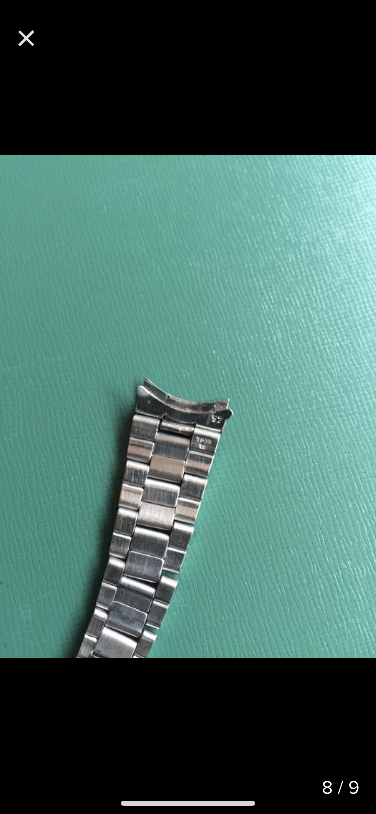

That’s ridiculous, I think I’ll be doing the insert last that is a lot of money at this moment considering my last 2 purchases. With the bracelet though with you said it’s hard to fit the bracelet? I was wondering what end link numbers I should be looking at? I found this one so far but it seems it’s for a old Daytona.

The correct bracelet would be a riveted 7206 with #58 end links. However, if you didn't like the price of the insert, you're definitely not going to like the price of a decent 7206. You could also fit a 7386 or 73860.
The bracelet you are looking at is wrong, and it wouldn't even fit, since it is a bracelet for a watch with 19mm lug spacing.
That bracelet is a 19mm. You need a 7206 or 6636 rivet bracelet (both of these are north of $2k), or a jubilee bracelet.

Not sure what we're supposed to do with comments like this. You seem to be interested in watches but are doing little, if any, research of your own and are instead soliciting forum members' advice and responding with comments that reflect your lack of effort.
Why are you looking at a 19 mm bracelet for a 20 mm watch, which you could figure out the lug width and correct bracelet models through one google search?
Why are you stating the market price of a good insert is insane and then stating that you found cheaper inserts when the prior one you posted was obviously incorrect for the watch?
I was kind enough to link you to my GMT website in a prior post, which has detailed descriptions of all the different parts you'll need. Please refer to it and stop expecting others to do your research and work for you.
