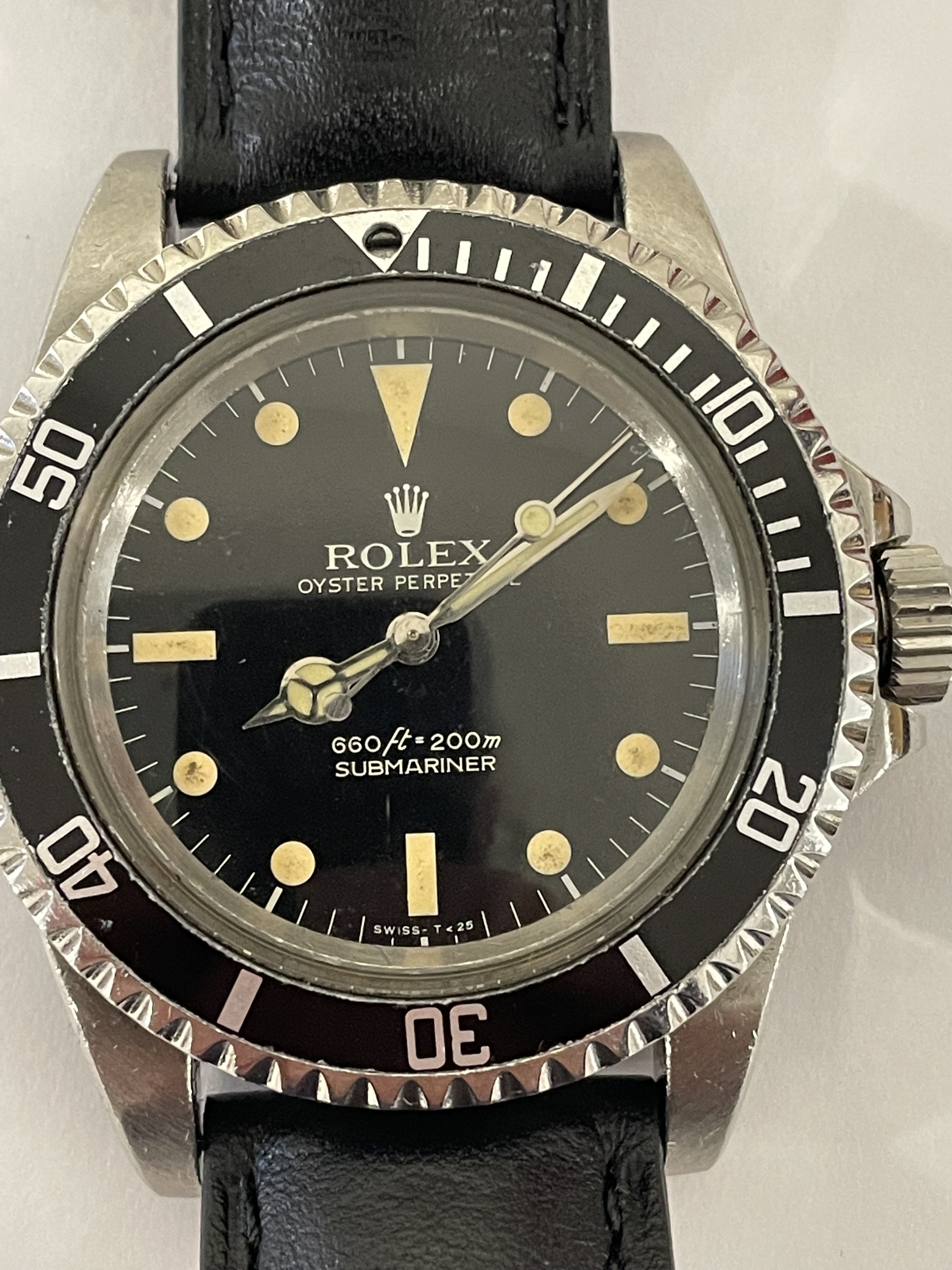

Hi Everyone
On this Rolex 5513 from 1971 there are some lume spots that have darker markings on them. I'm wondering if anyone else has encountered this or knows what the cause is. Any help would be greatly appreciated.
Thanks
Jay

It won’t grow if the watch is dried out and water tight, but it won’t get better. It means it got damp in that watch at one point- maybe not wet, but fogged crystal damp.

I have seen slow spreading of mold on lume plots (dial or hands). It's so gradual, you would probably only notice it by comparing photos taken years apart.

Lume is the canary in the coal mine. It’s like a sponge so any moisture- even just humidity that gets past an old crown seal will get absorbed by the lume.
As far as value- it will affect it compared to one that doesn’t have spotting on the lume. If it doesn’t bother you much, use it as a bargaining chip with the seller.

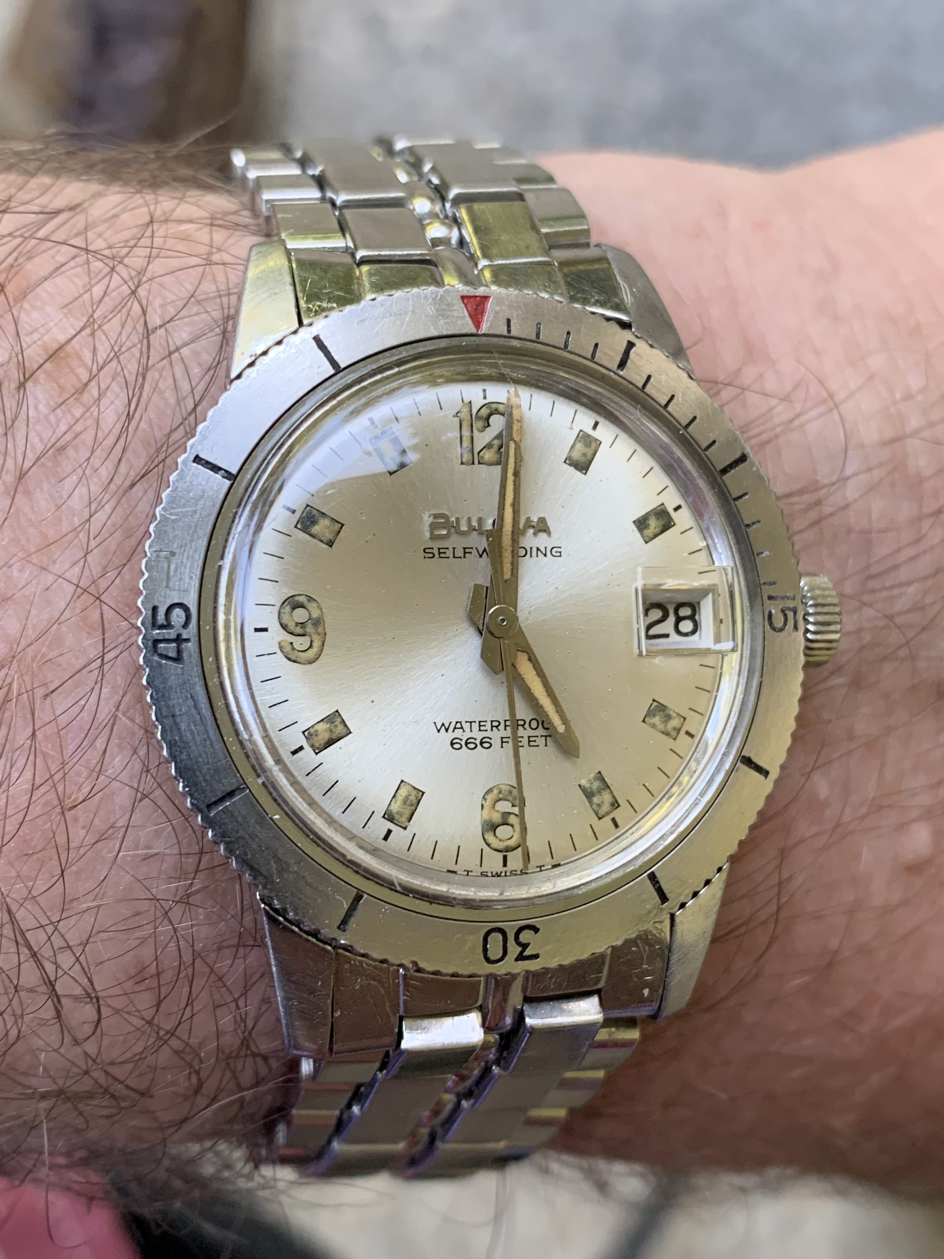

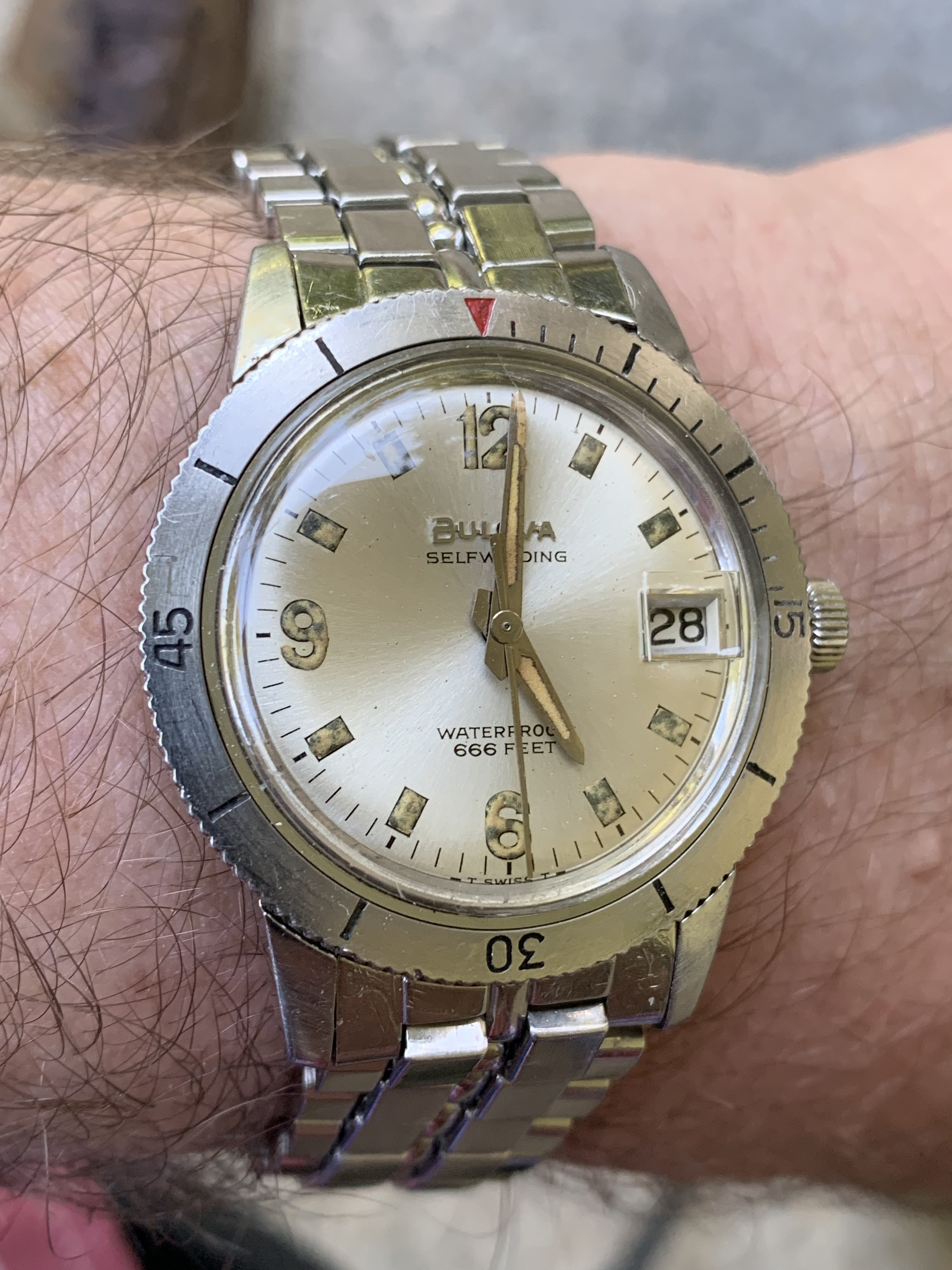

Here’s some nice moldy spots
I’ve referred to it as “leopard lume” which will catch on and eventually increase the value due to its cool factor.

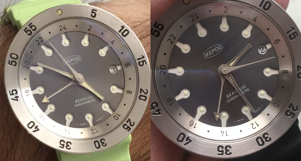

This happened inside 2 months...it's not always slow growing...

There are always exceptions but my experience is like Dan's...gradual. I would guess to happen quickly there would have to be a big difference in humidity level inside the watch.

A rare look at 1 owner watch noticing the change. Thanks for sharing!
