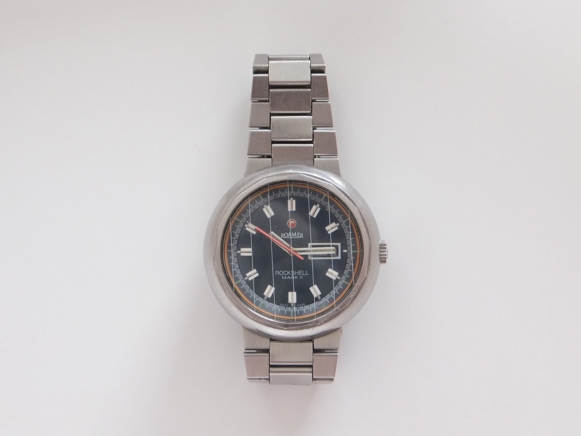

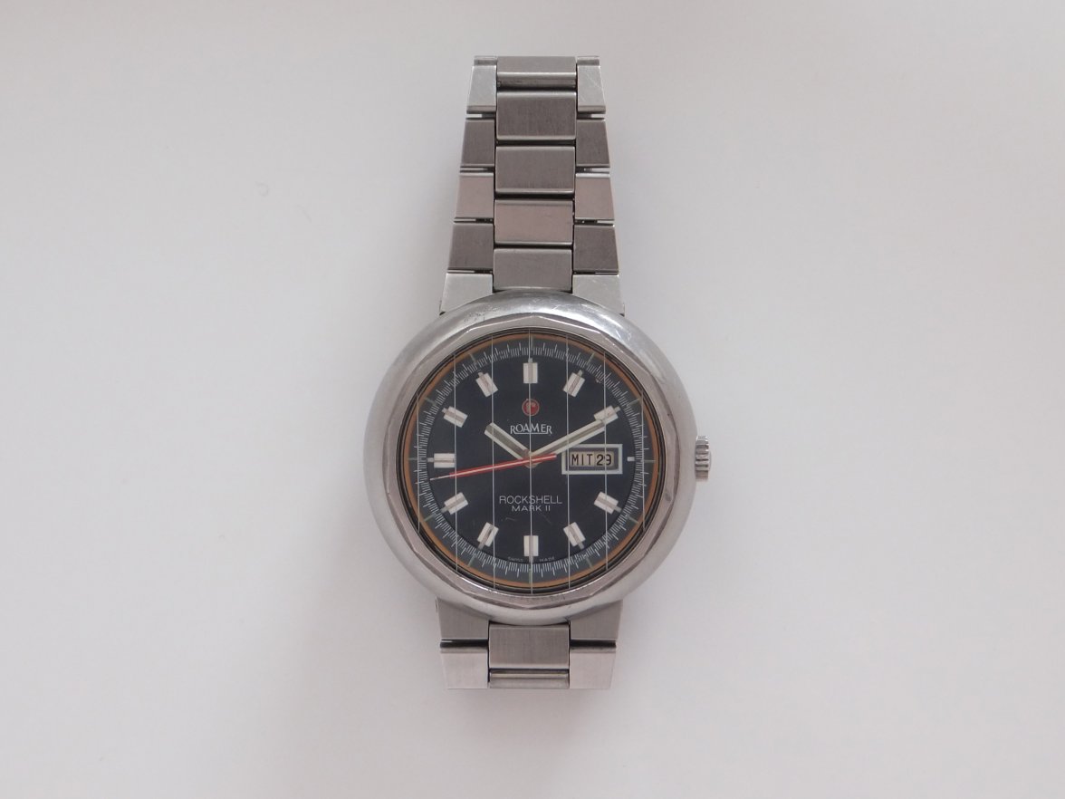

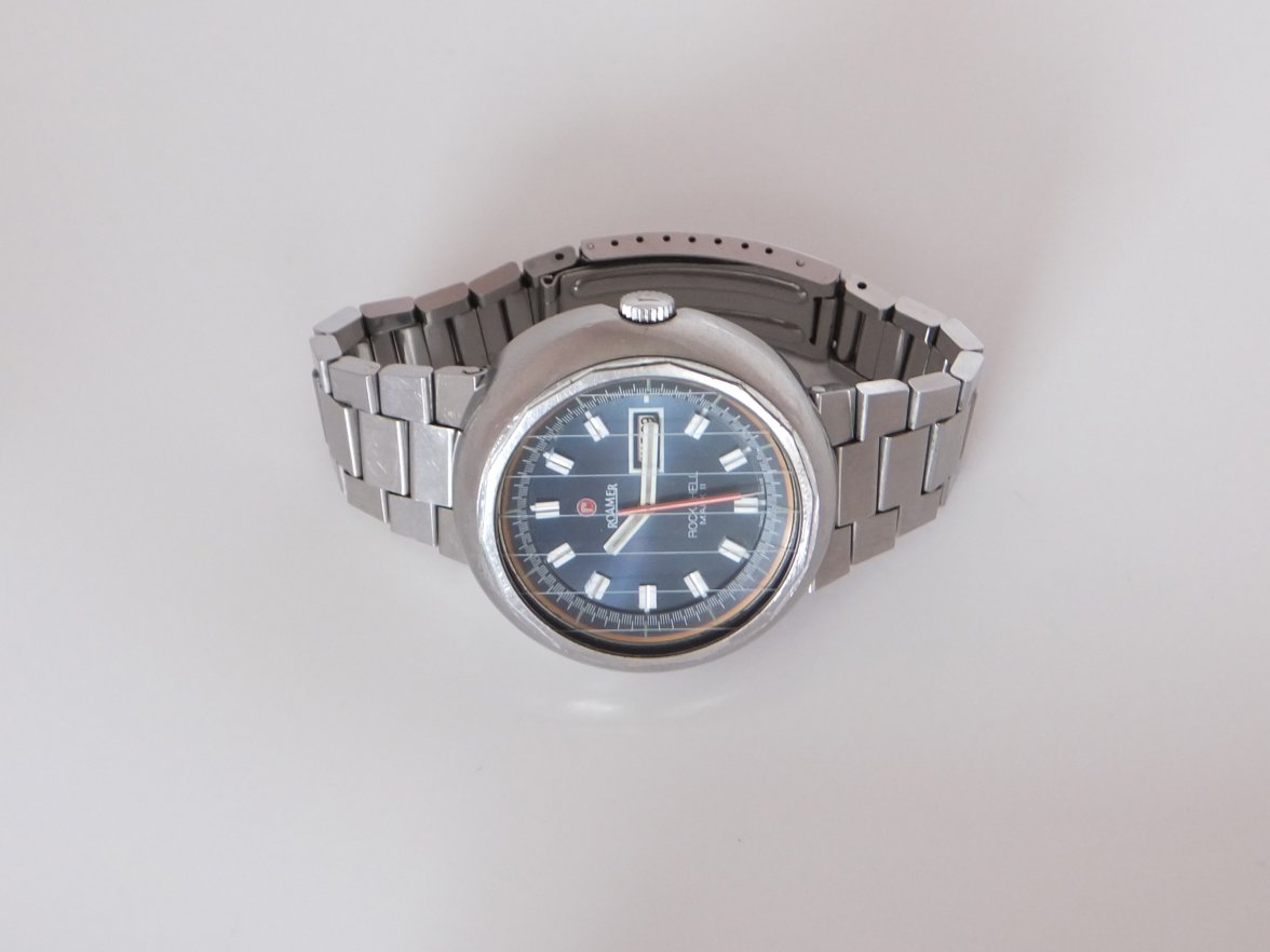

Some time ago I found a Rockshell Mark II on the net with the eye-catching and heavy wedge-shaped case, the integrated bracelet and even the original crystal with the vertical stripes. Since I always wanted this watch and the price was more than okay, I reached out.
When the watch arrived, everything was visually as far as I expected, and the watch started running after a few shakes and was keeping time.
Only the crystal was a little twisted and its lines were not vertical and therefore not aligned with the indices on 12 and 6 and the scale inside the Rehaut.

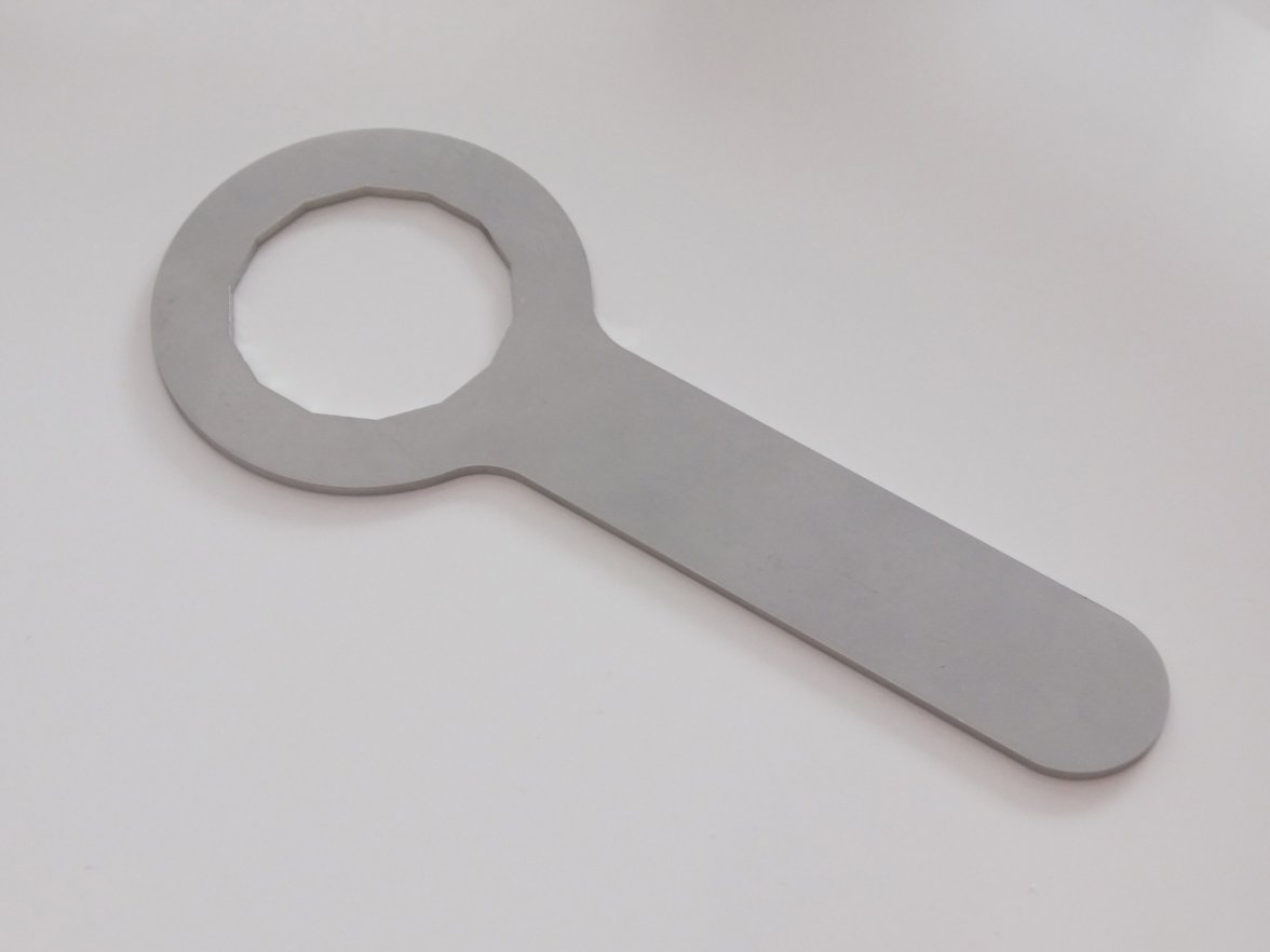

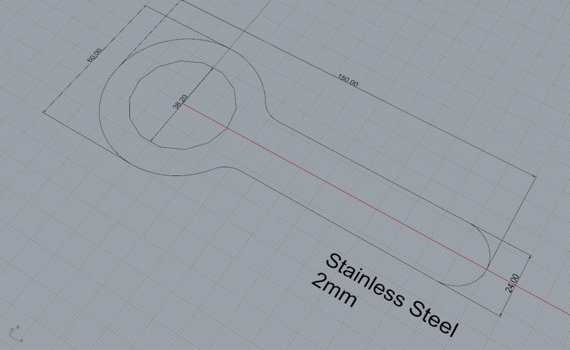

Then I came up with the idea to do the tool all or partly by myself. I made a CAD drawing and sent it to a laser cut service on the Internet to have the tool lasered out of 2mm stainless steel.
Laser-cut wrench made of stainless steel (less than 30 euros including packaging and shipping)
Realignment
The tool fit perfectly and the mounting ring could be unscrewed without any problems.

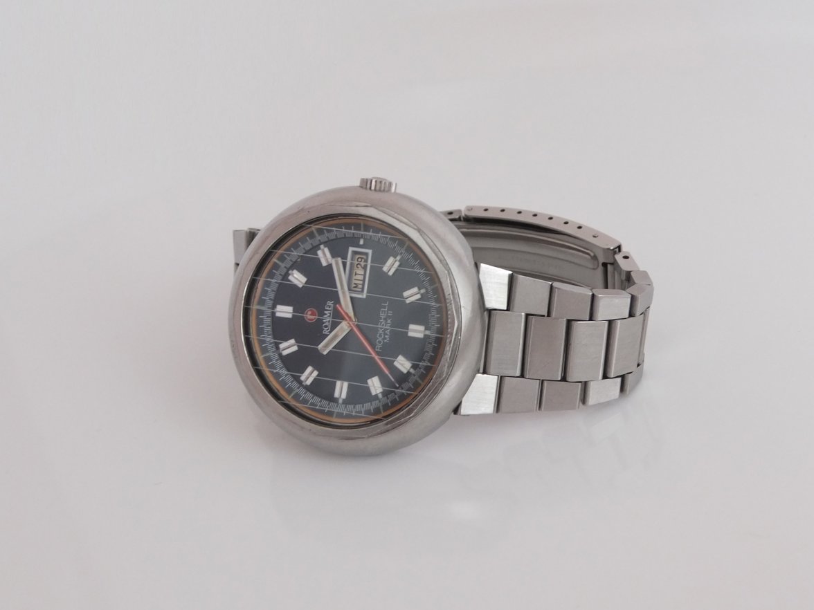

Aligning the crystal was easy. Here the watch with newly aligned glass

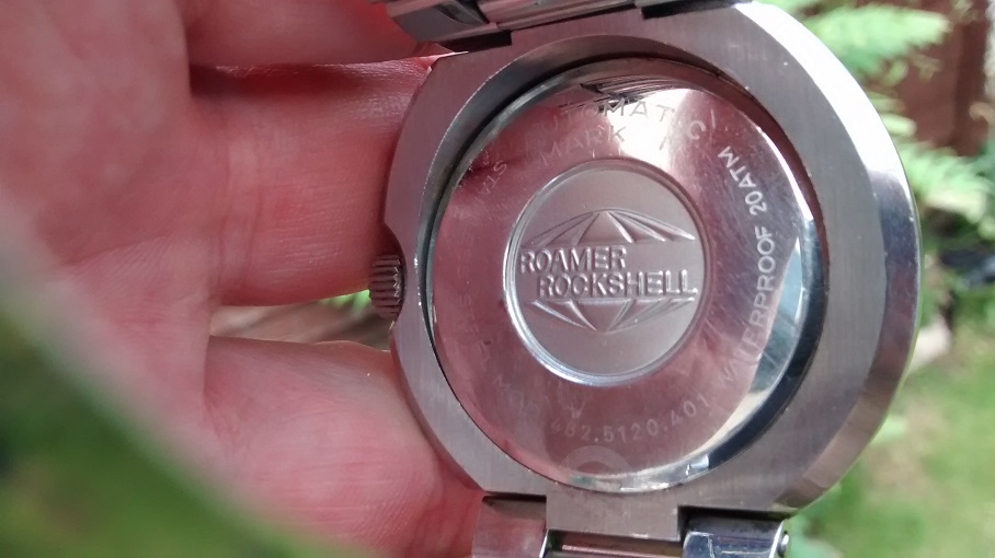

I have one off these two which is away awaiting a full service at the moment ..I had know idea how to get into it.

The watch has a snap back to get to the caliber.
The front mounting ring is for crystal and gasket. I assume, to increase the waterproofness.

Thanks for the update Zoohannover.
I`m suprised about a snap back rear cover though on this case to access the movement .
Most of my other "waterproof" cased Roamers have the patented case design where you push the main part of the watch through from the front out of the rear of the bezel casing-or they have a screw down case back.

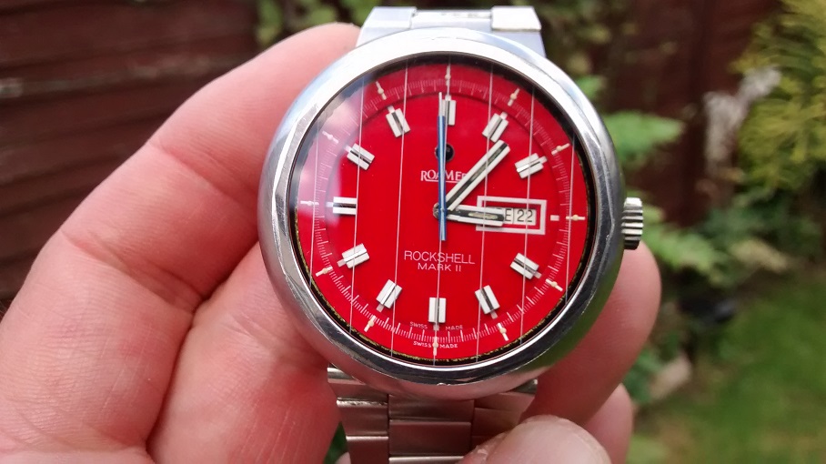

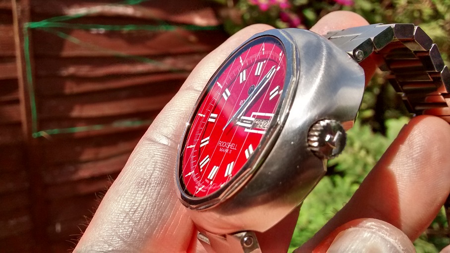

Thanks..I`m a regular visitor to that website..I have over 60 Roamers so far :
The mark II and III`s are rare beasts..the red dial even more so.
They are impressive pieces.
