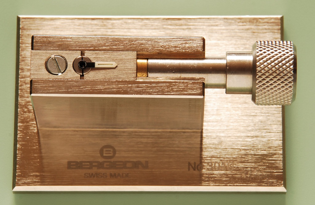

Old watch hands, for any movement or model, can become loose over time. If hands are reapeadetly removed and installed it's inevitable that they will become loose. However, just because that's happened, doesn't mean they can't be re-used. Bergeron make a tool that is specifically designed to tighten the seating for the hands. It grips the base of the hand and applies even pressure all the way around. It has a variety of sizes and can tighten everything from a chronograph sub-dial hand to an hour and minute hand (assuming you have enough pipe to grip on).
Here's the tool pictured below:
Having said this, it should be done correctly. If the correct tool is not used and the proper care isn't taken, the pipe for the hand can become bent, or worse still, crushed. So make sure you head to an expert in vintage work.

Some people tighten hands in a watchmakers lathe by choosing the correct collet and lightly tightening down which is more difficult than using the Bergeon tool as noted by @ATracyWatches. Here it is in use (it happens to be out because I'm tightening an Omega Admiralty hand). You have to be very light with the touch as it's a huge tool for applying very small forces. It would be very easy to tighten it carelessly and crush the pipe.
I can't remember if all the Speedmaster hands have pipes (I think so) but on a hand that just has a hole, tightening is a different matter....

Pipes can be tightened or replaced (I use the lathe for tightening personally - I don't find it difficult but I've done it a lot), loose rivets can be tightened, and lume can be stabilized. Many watchmakers just don't want to be bothered with this kind of work, so it's important to make sure you choose one that you can work with to do what you want done.

On a Speedmaster the hand that would cause the most difficulty in tightening would be the minute hand, as there's not much of a pipe to work with. However these can be tightened in a staking set with a light touch of course.
