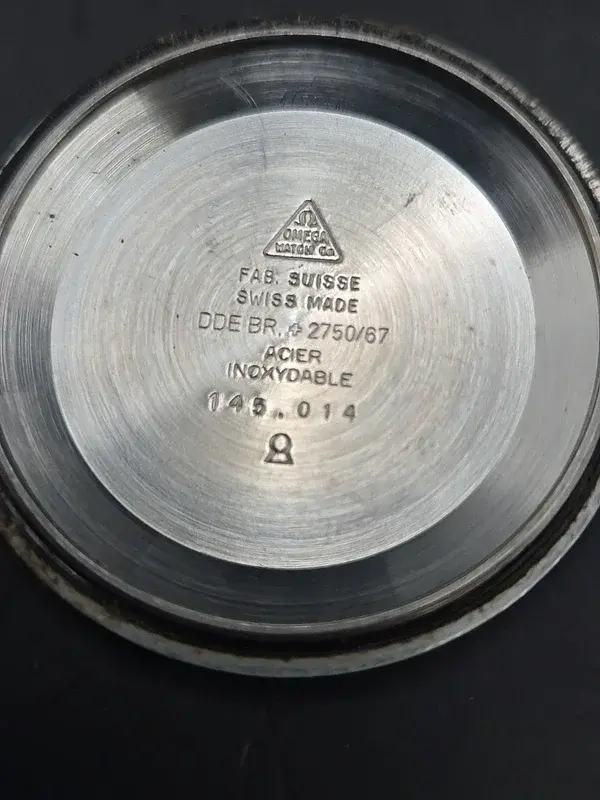

Hello everyone!

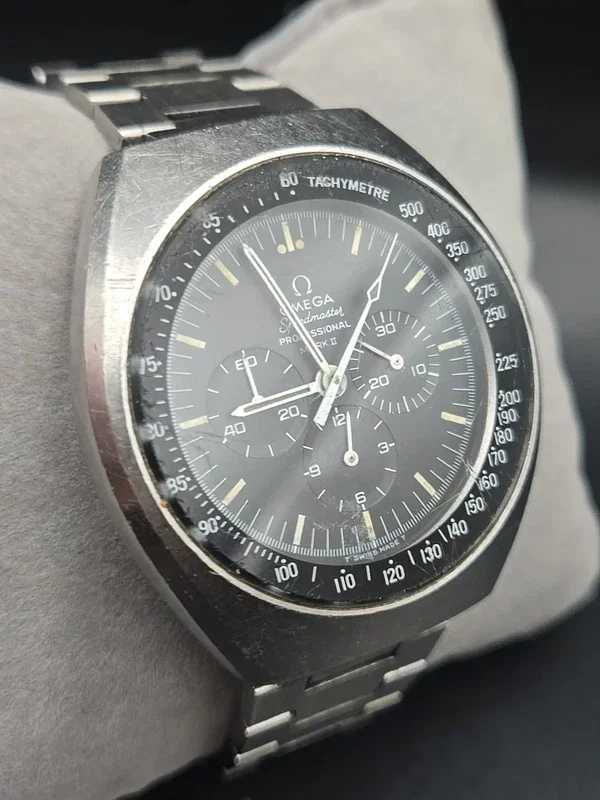

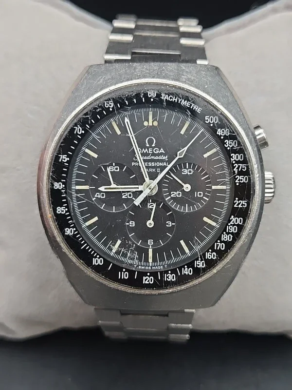

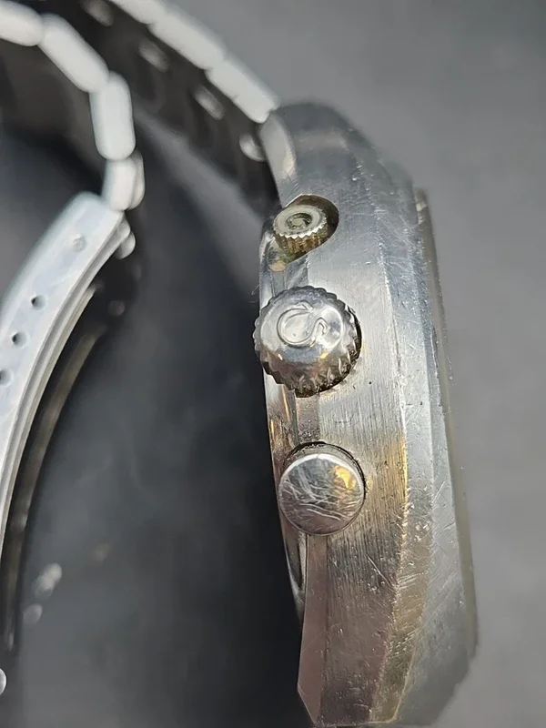

I'm looking at this project 145.014 and I wanted to know if everything looks alright with it. I've done my research and my best to cross reference images of other 145.014s to determine if the watch is authentic, and I believe it is, but i figured I would get some more opinions.

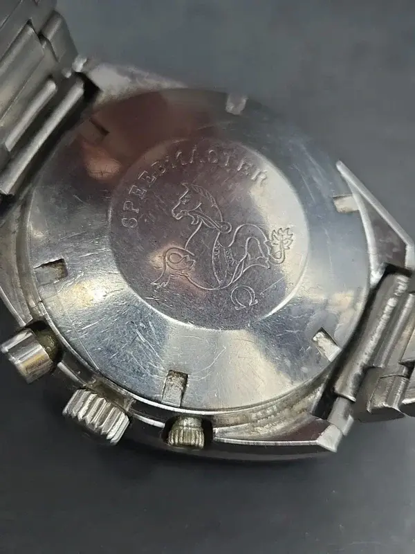

The only thing that is setting me off about this watch are the caseback markings, they look a little sloppy particularly the reference number and some of the text, although that could be just from the photo, or just my inexperience or how they are normally. Other than that, I think it looks alright? Minus the obvious missing pusher. 😅
Thanks in advance for any assistance!

It looks to be a real MKll, albeit in rough shape case/crystal wise. Interesting one for a project. The crystal is a mineral crystal, not hesalite, so it would need to be replaced.

Sounds good, thanks for the advice! Yeah it's definitely rough, but I think it should clean up nicely.

Looks ok to me, and I own an original MKII from 1973, the original owner. It comes down to price, plus the costs to bring it up to wearable standards.

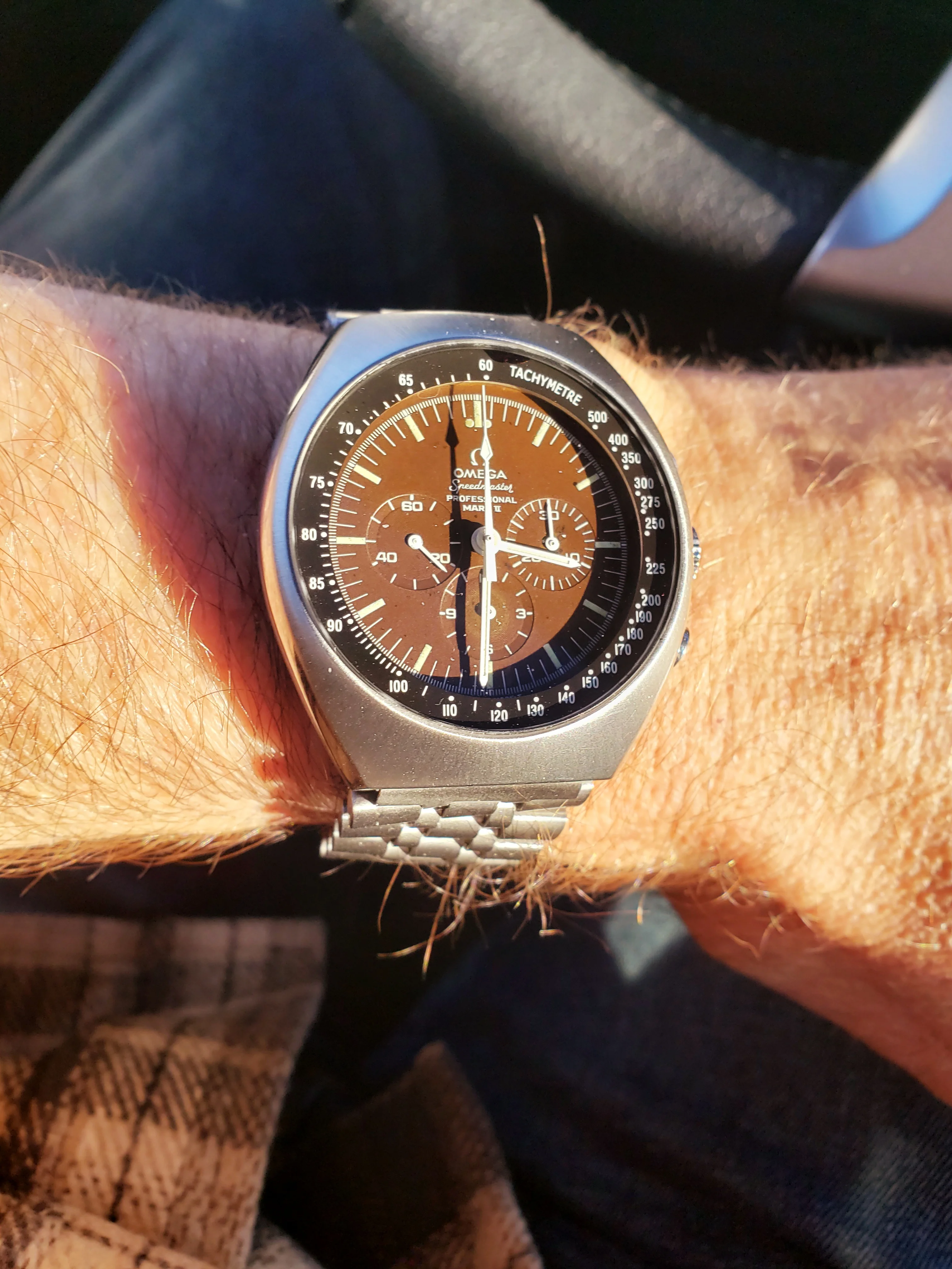

Yeah, when I bought mine it was for the tropical dial. Seller did a crystal swap and excellent refinish of the case. Really love how it wears and uniqueness of the case. Fun pieces but definitely need to look at overall costs.

There are good quality replacement crystals for <$100 online. Try ebay.
The pushers are also interchangeable with the speedmaster moon watch - they just have longer screws pins. You can use the pendant tubes + button caps from the set, and only 50 pounds from place like Cousins UK.

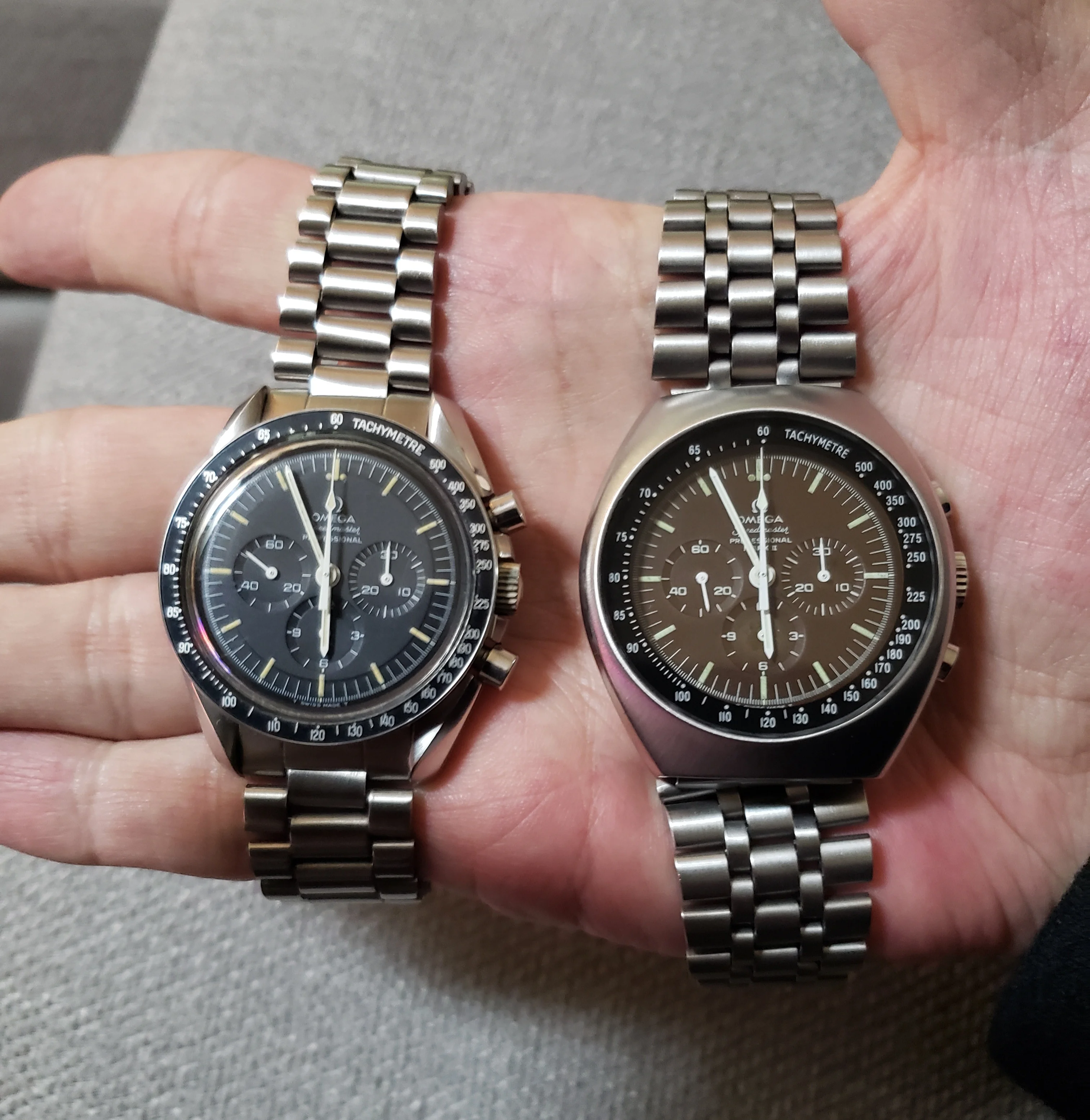

Yes, I am well aware (I now own two of them). But maybe as people look at vintage watches and see the price of a regular Speedy from the same period, the Mark ii starts to look a lot more attractive.

Nice, that's a beautiful dial.

Thanks, it's the reason I grabbed it. Haven't seen anything like it, especially in the sun. The lime green lume has an iridescent quality contrasting against the brown.

For $600, I'd say you got a pretty good deal. Gives you enough room for a full service, replacement pusher(s), crystal, and refinishing (not sure on price offhand for that) and have a really nice piece to wear.

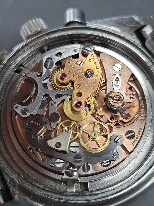

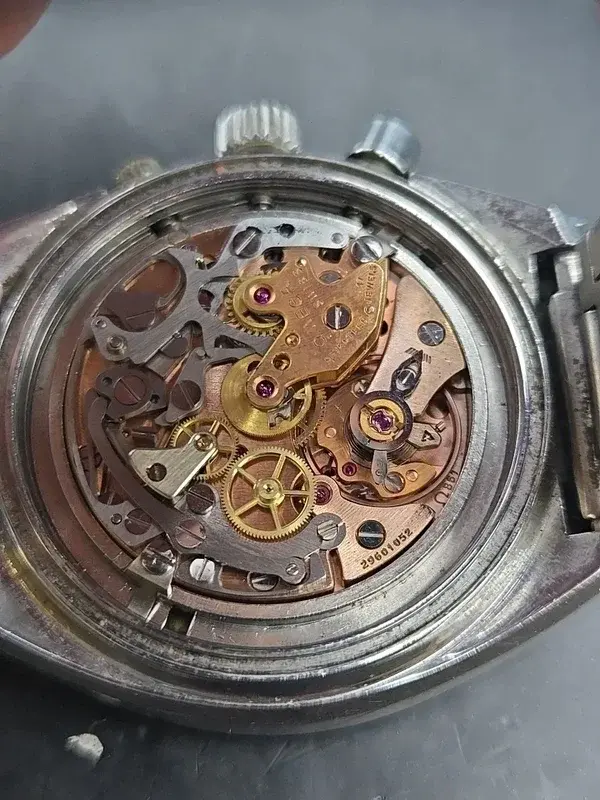

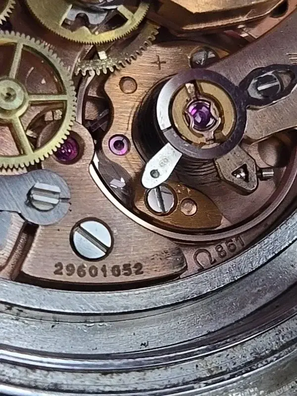

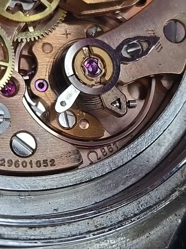

Thats an unusual serial to see in a MkII.
2960xxxx is usually seen in the 145.022 and MkII's usually are 31m+
Are there any other MkII owners with a serial this close?
I have a soft spot for MkII's
1,383
735
Racing dial 30.5 mill confirmed by Bienne.

It’s looks nice, this will be great once the restoration is done. Try to keep the original dial and hands. Caseback looks fine to me. How is the bracelet?
