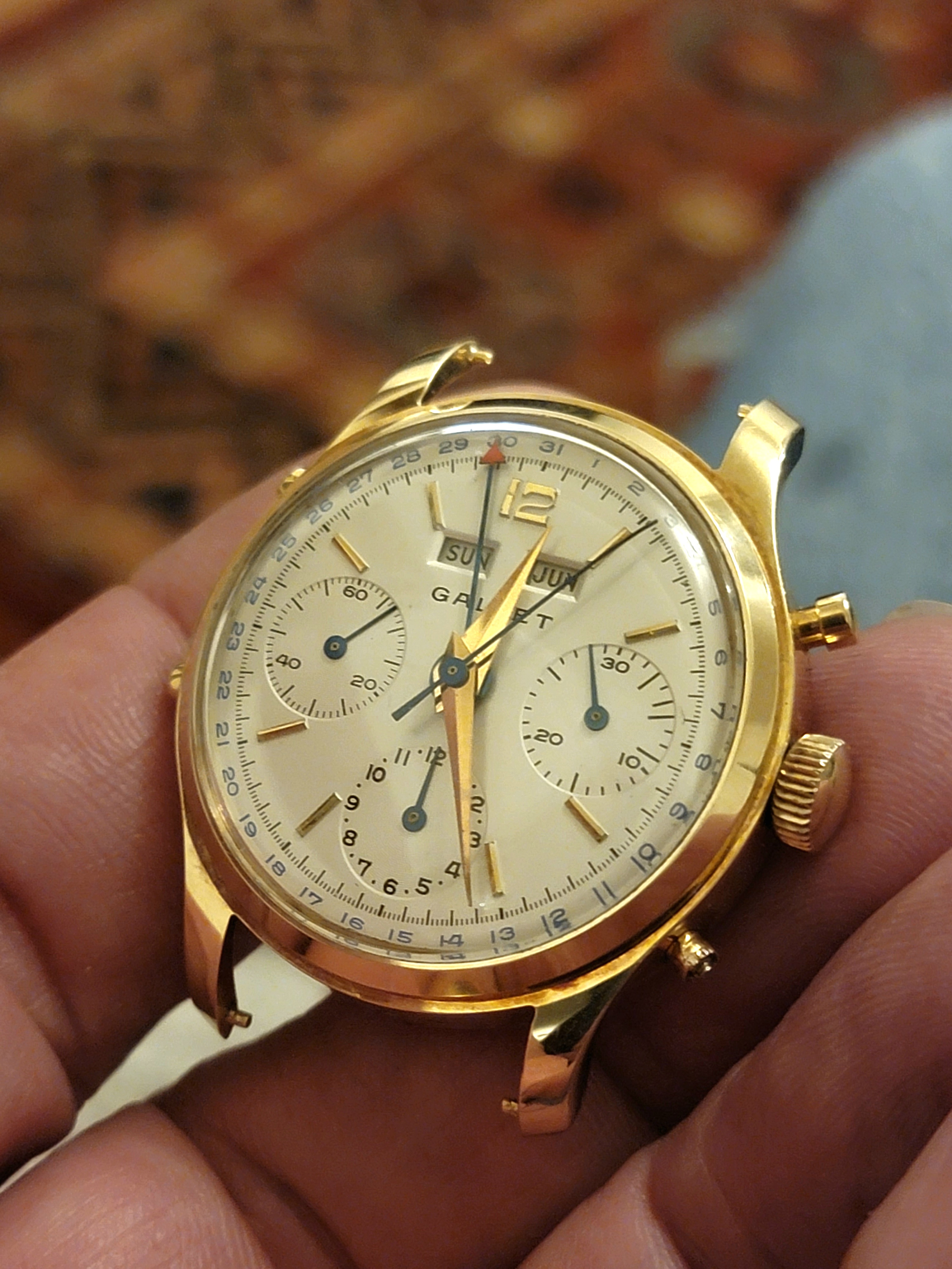

Replacing chronograph pushers: how interchangeable are they?

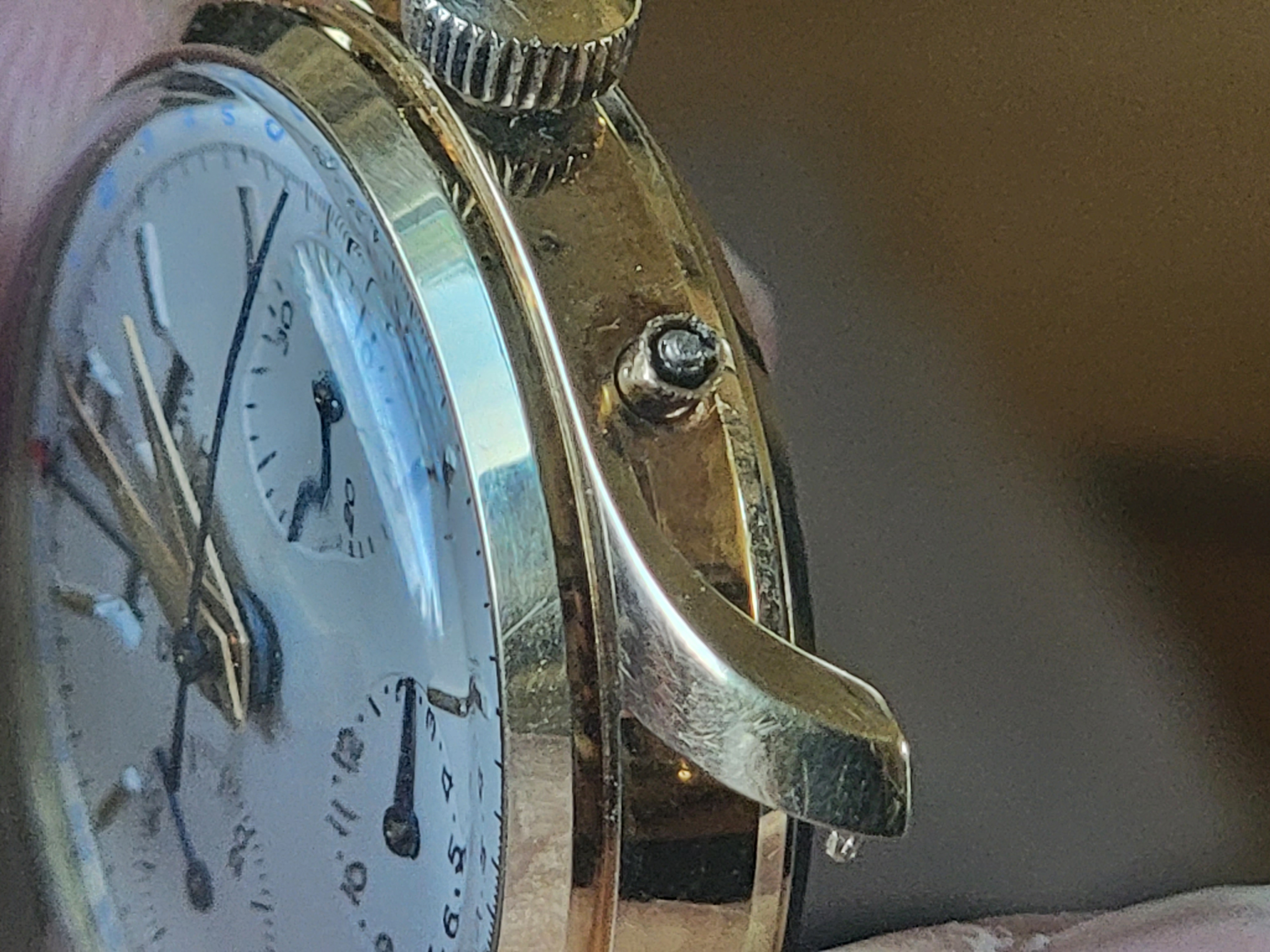

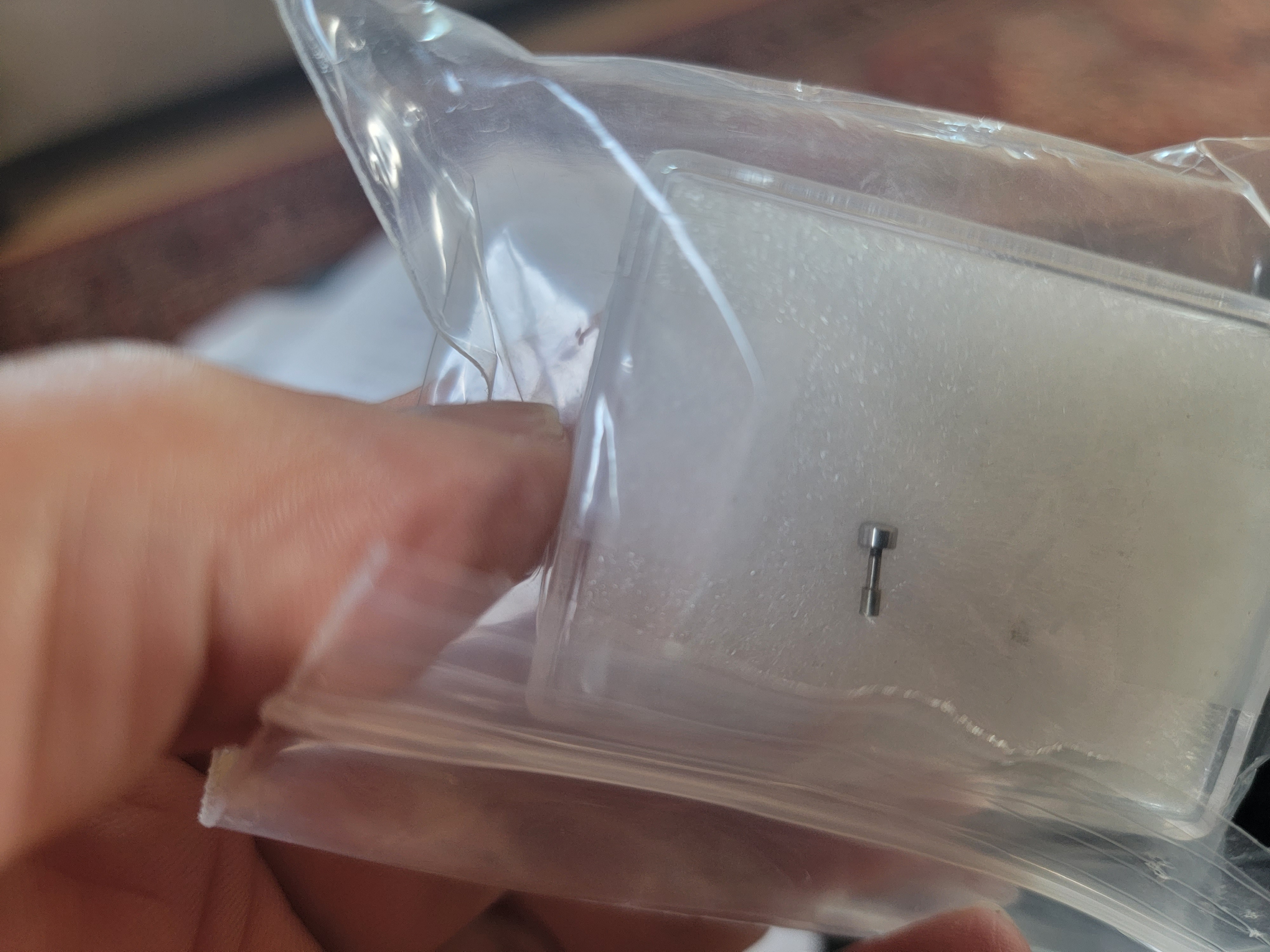

I will have a look at my stuff. Good that you have the stem. The spring, if missing, can be obtained from a big diameter springbar. If you find a silver cap, I'd take off the second cap as well and have both gold plated in the same colour by a good jeweller.
6,475
22,005
2.5 mm gold-plated here.....

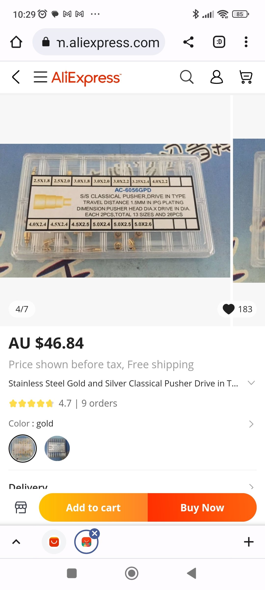

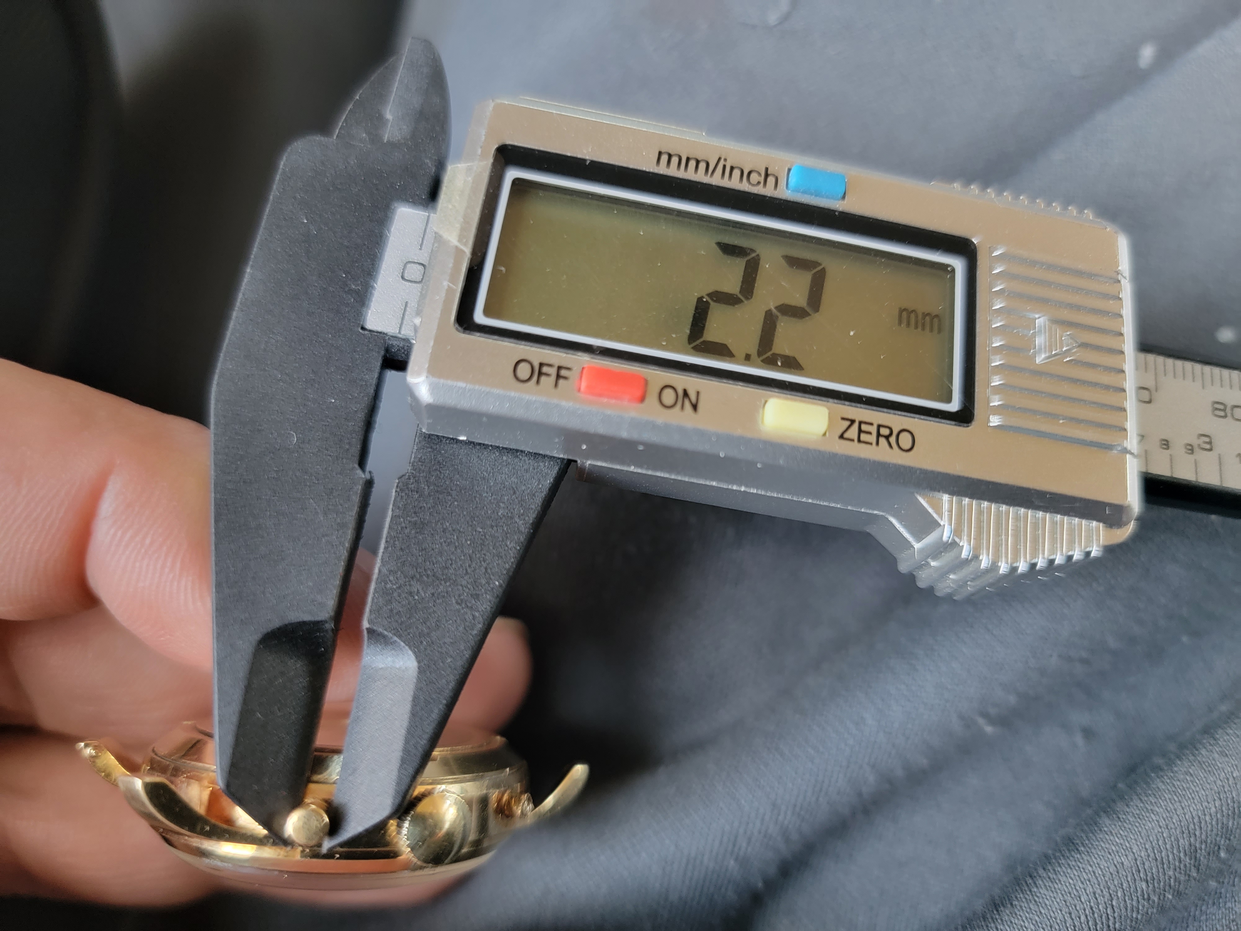

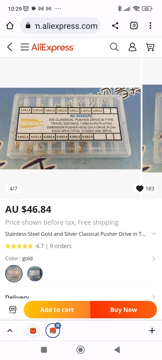

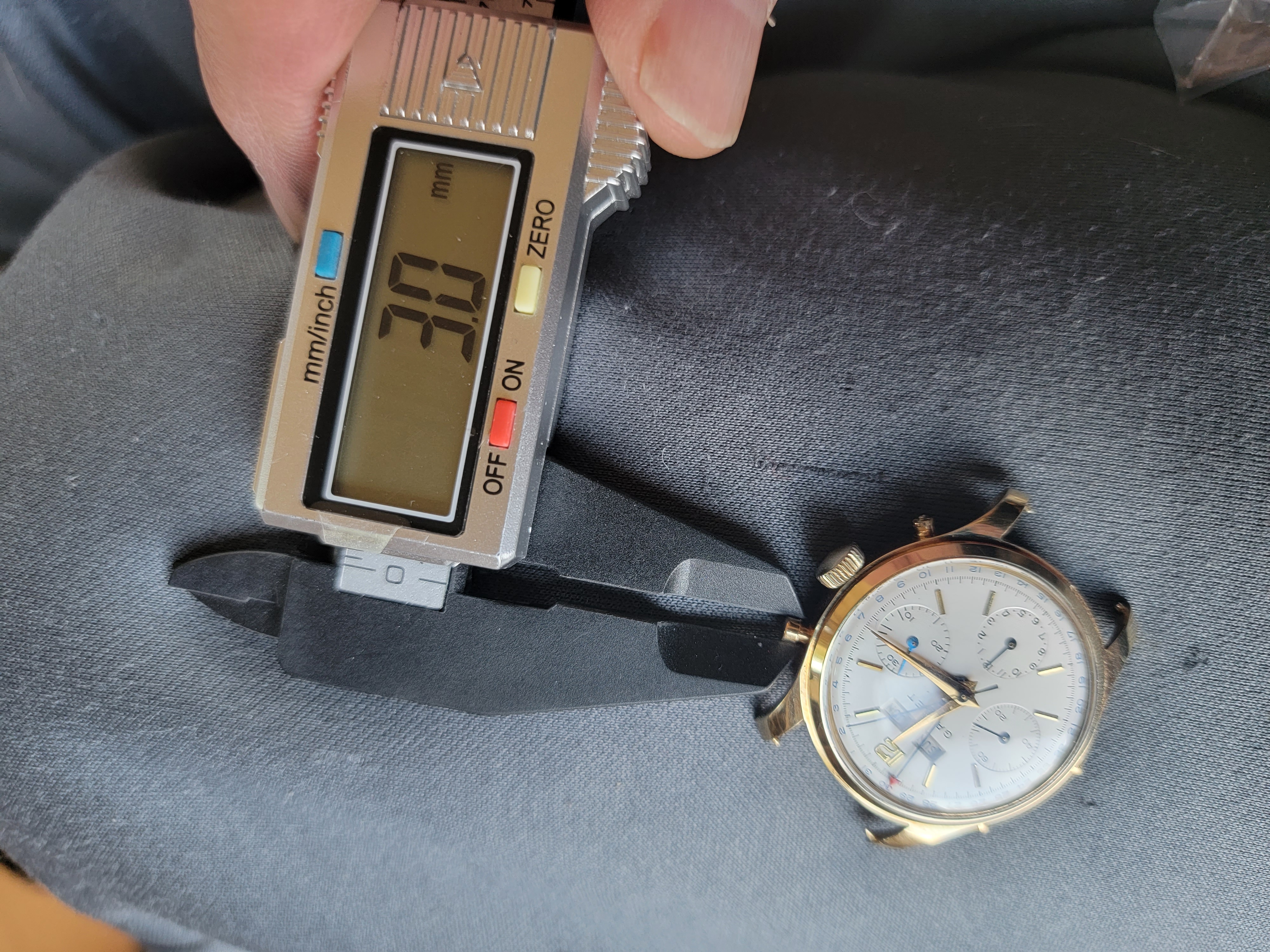

Thanks. Those are the friction fit and I need screw in, but I see similar screwin kits. Based on the feedback, i believe the generic screwin kits will fit. Worth a try for 50 bucks.
Thanks for looking out for a fellow collector in need. I appreciate it.

If you are in luck and can tweak things a bit, you might keep your tubes ( pusher base ) and just replace the caps plus stems, because they might have these mini clips to secure the stem to the underside of the existing/new tube.

Thanks. Those are the friction fit and I need screw in, but I see similar screw-in kits. Based on the feedback, i believe the generic screwin kits will fit. Worth a try for 50 bucks.
Use caution when using these Chinese made chronograph pushers. Notice they are sold by the Chinese export website AliExpress. Try to find an an original Swiss pusher cap or assembly, as difficult as that might be. It is a great watch and worth holding out for.

That is funny.... Have you any idea, how many parts , used in High End Swiss watches , are made in China ?

Yes, an unfortunate diminishment of true quality in our turgid 21st century world.

I'd rather see the owner fix his chrono and wear and enjoy it soon and then take his time to find originals if he desires so. To leave it unfinished for years does not make sense at all. There is always a high horse and then there are practical solutions for the time being.

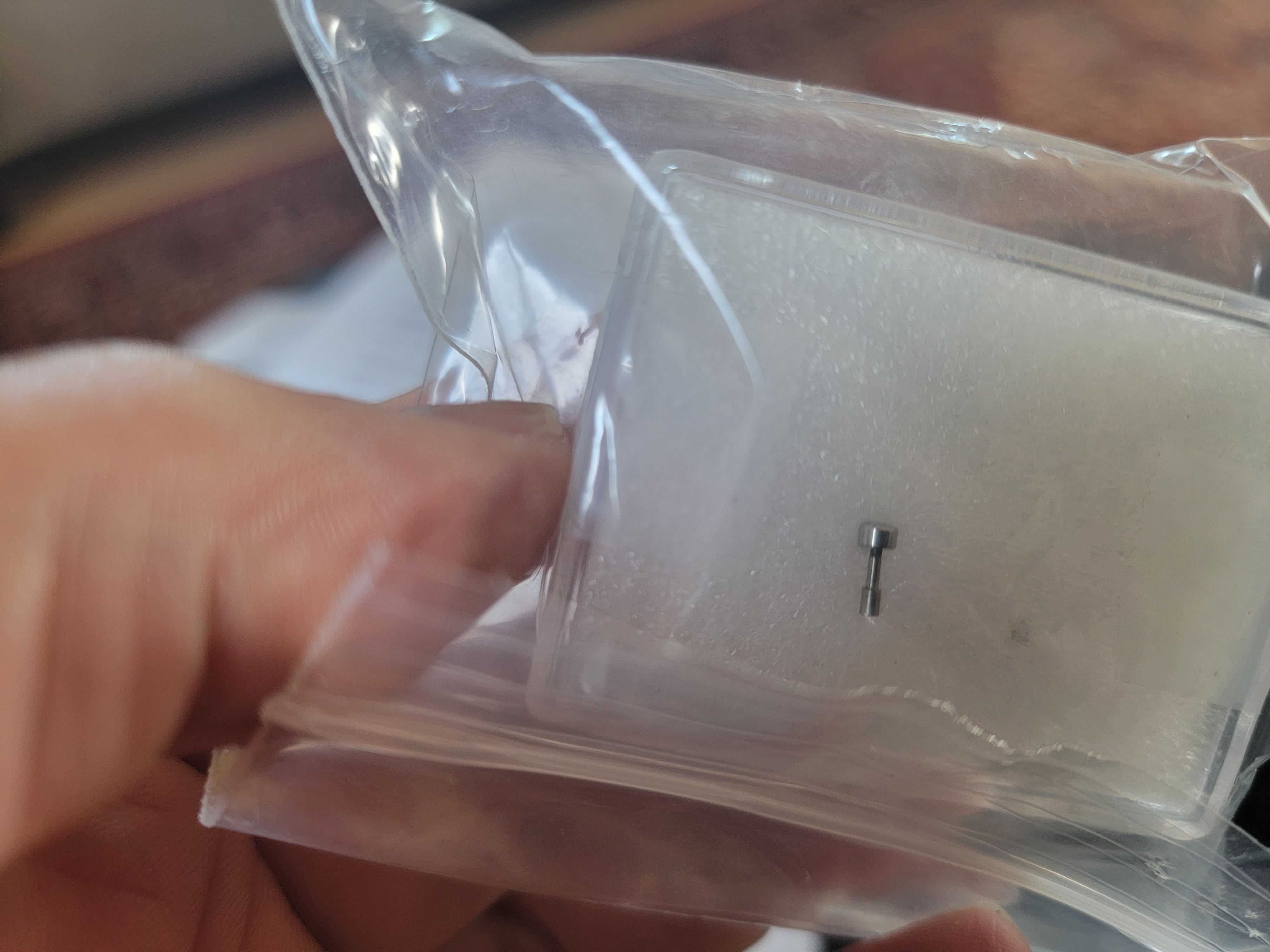

Update: the service center returned my watch. They didn't replace the cap but said they found one at the last minute and sent the part. If it will fit, i can get it plated. I have a couple watchmakers who might be willing to tackle it. Feeling good. Thanks for you support and encouragement. I'm taking the Sheepdoll approach and never give up.
5,666
9,496
So...., Unscrew the stainless cap and try if it clears your tube/base teeth.... All thumps and Paws crossed.

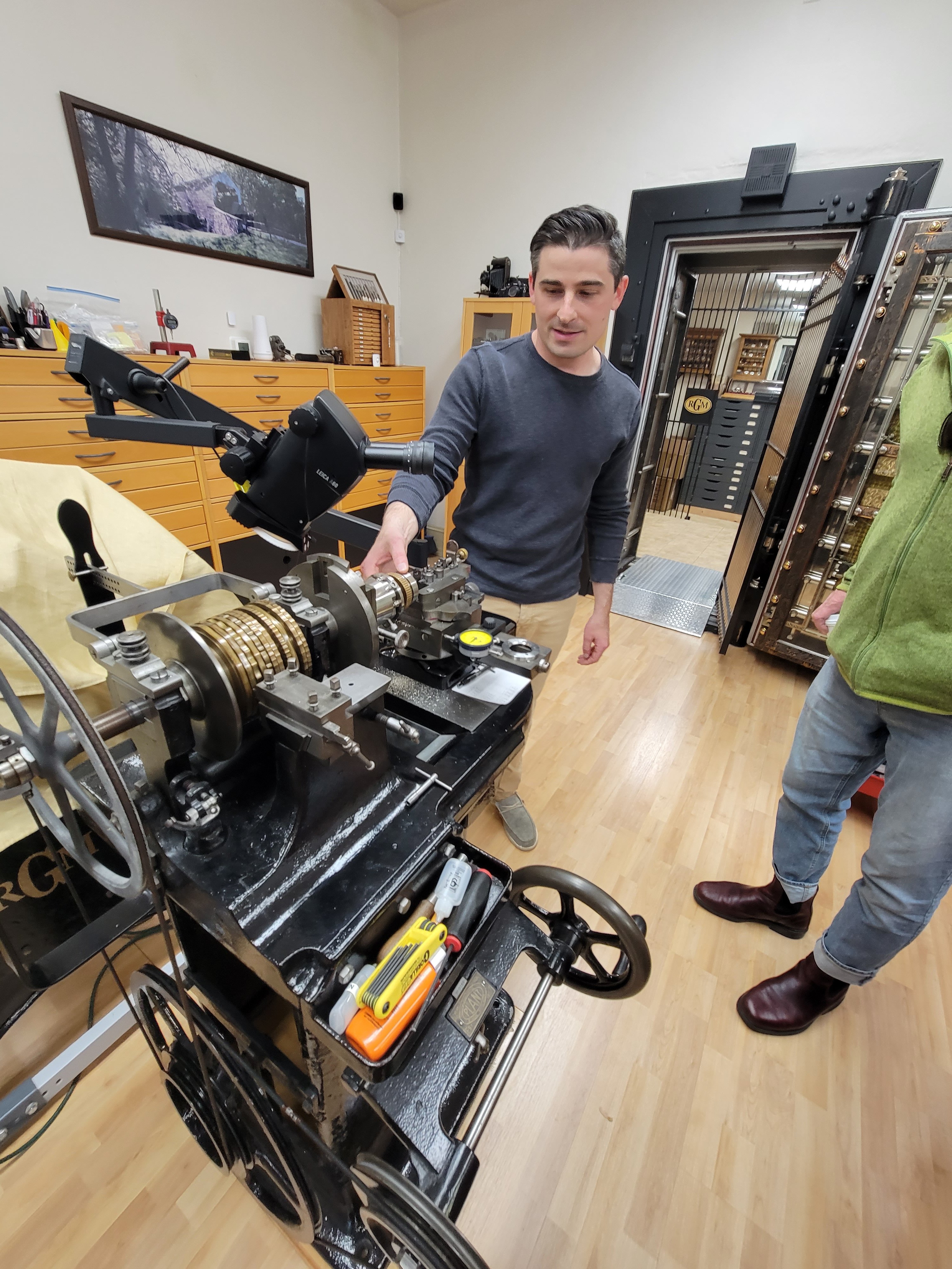

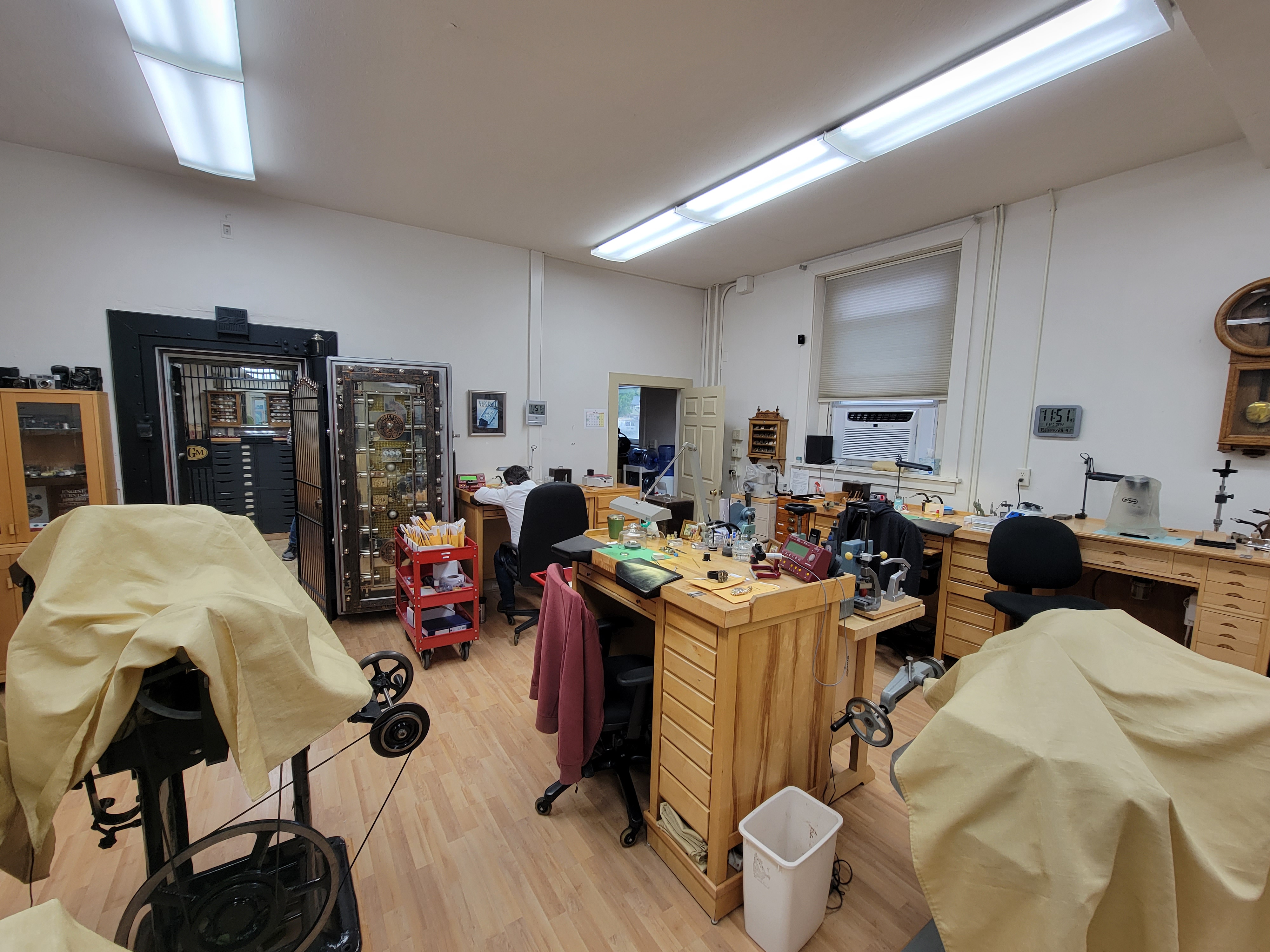

Dropped it off with Roland at RHM who will be doing a service and will make a new pusher (not cheap.) Looking at 6 to 10 months due to backlog.
One of the watchmakers showed us how to make dials.
