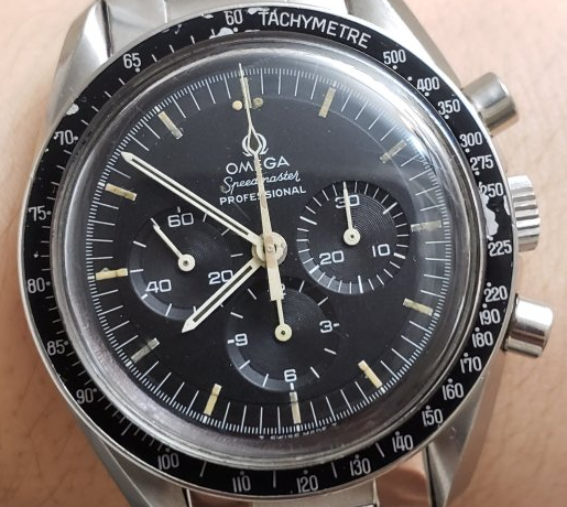

I recently came across a 145.022-69 with a 220 bezel. It's a fantastic watch and the dial is very nice. The plots show a tad inconsistent wear, but it's part of the character and I will be leaving them untouched. The bezel has a few small flakes and is also in line with what I consider "honest wear", however with discussions about replacement DON or ghost bezels, I was curious if replacement 220 bezels even exist, seeing they were not a "normal" production item and whatever replacements may exist may happen only if the rest of the watch was scrapped.
Thoughts on where I may find one, if they exist, or perhaps the chips can be touched up?

Referring to the last part of your question, it would help if you posted a picture.
Here it is:
As you can see...it's relatively minor and I would only be interested in touching up the black parts and not the numerals or indices.

This seems to be a good base. Since the scale and letters are quite intact, it will be possible to repair the chips with black paint (of the right consistence and finish) and obtain a major improvement. The area between 250 and 225 is a bit difficult, of course.
Needless to say that the bezel should be detached for the job...

i'd be happy to wear that just as it it, not a safe queen, an honest 50 yr old beauty with earned wrinkles and grey hair.

Looks a nice watch to me, sometimes we need to give these old Speedies a break as most didn't live in a safe for 50+ years, a good serviced movement combined with a few battle scars (patina) tells me the owner is an interesting person who appreciates watches but doesn't want to show off.

I would leave it as it is.
Just imagine the work is not up to your expectations. now every time you look at your watch you see different shades of black on a ruined now non reparable bezel.
Is it worth the risk reward?
As you said wear it now with it's war scars and be happy 😁
My opinion and be happy with whatever you end up doing 😎

The watch, of course! Yes...I would tend to agree with you, as the appeal of a vintage watch (or cars even...) is in the character and history of the battle scars. As I said in my original post, I was just curious if this has been done or if any 220 bezels ever appear on the resale market.

I would concur with your opinion and will be appreciating this watch for everything it is.

I'm leaving it as is. An oblique concern was the chipped areas of the bezel flaking off even more, but I'm not going out of my way to swap anything out. If I happen across one, then so be it! If not, it's all good.
