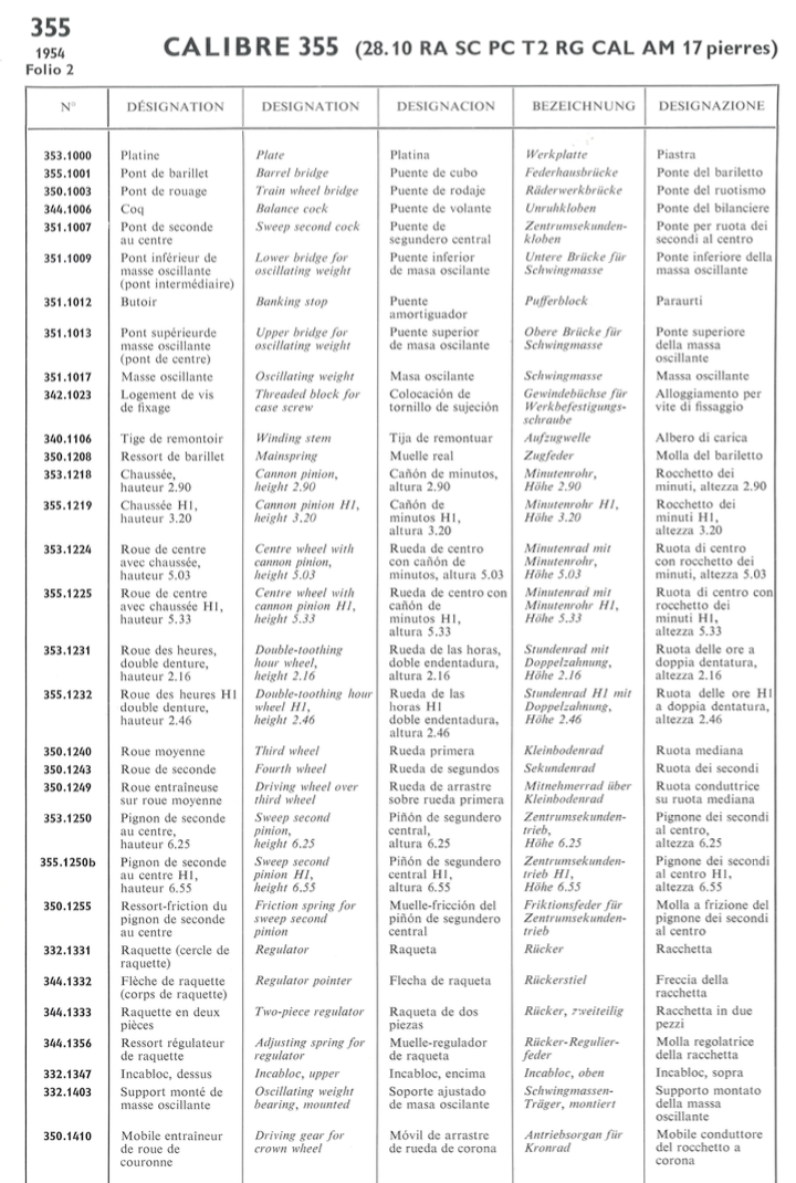

2627 houses a 353 so many 355 parts will fit as they both derive from the 330 base caliber, but it needs care when selecting parts.
Example of 355 parts list.
