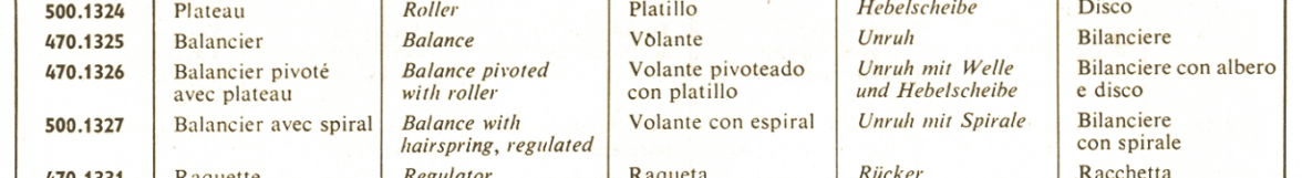

Posts 18,766 Likes 38,985 JimInOz ·Feb 26, 2020·Melbourne Australia Part numbers from original parts list, later ones may be longer. (ignore 1324, 1326 should get you out of trouble) Or if your watchmaker just wants a balance staff.
