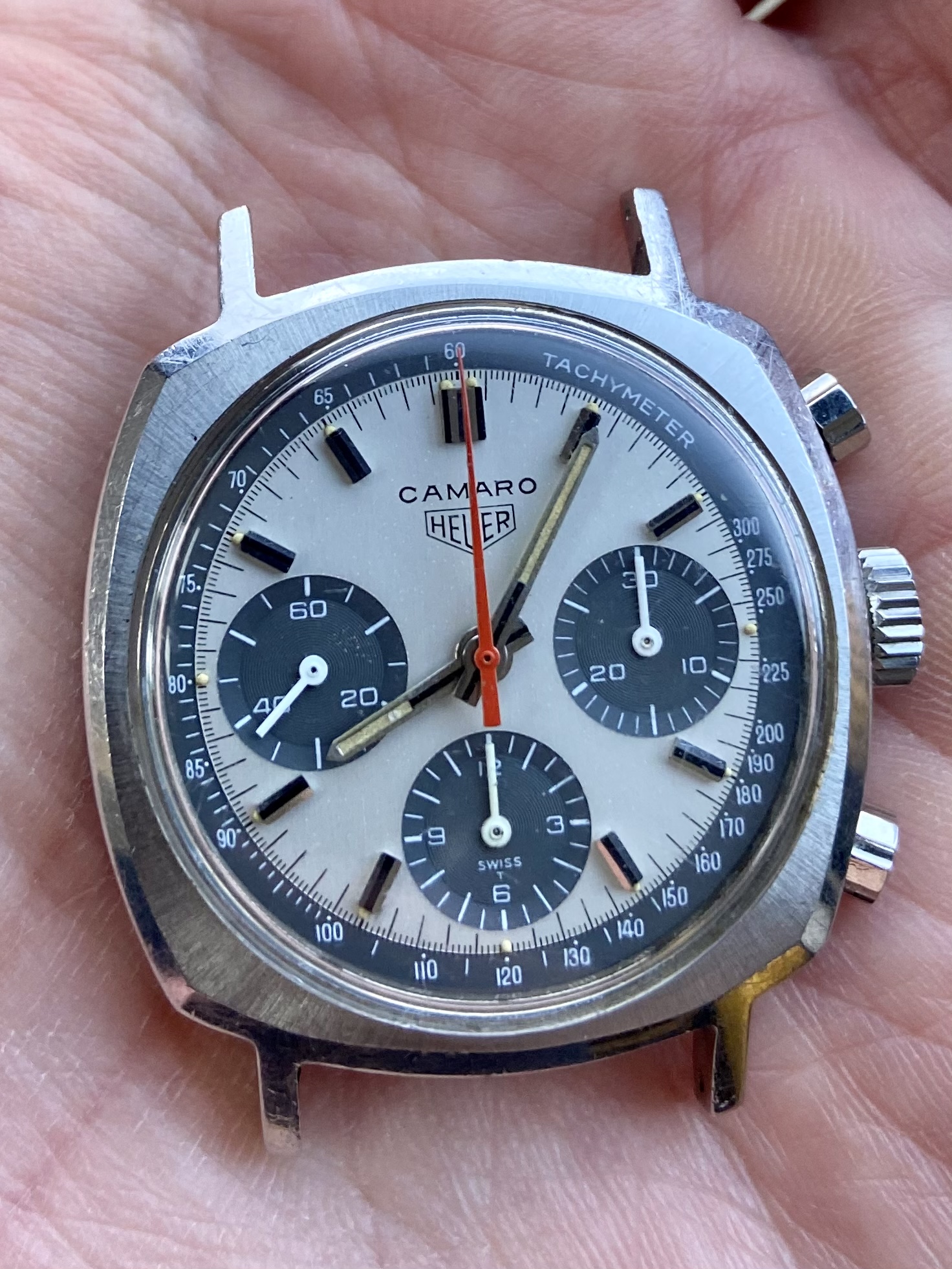

Botox for watches Dan. Here are more pics. And Canuck is being humble. The watch was horrible inside too. He is a magician.
Do you recall how many microns did they did?
13,556
23,503

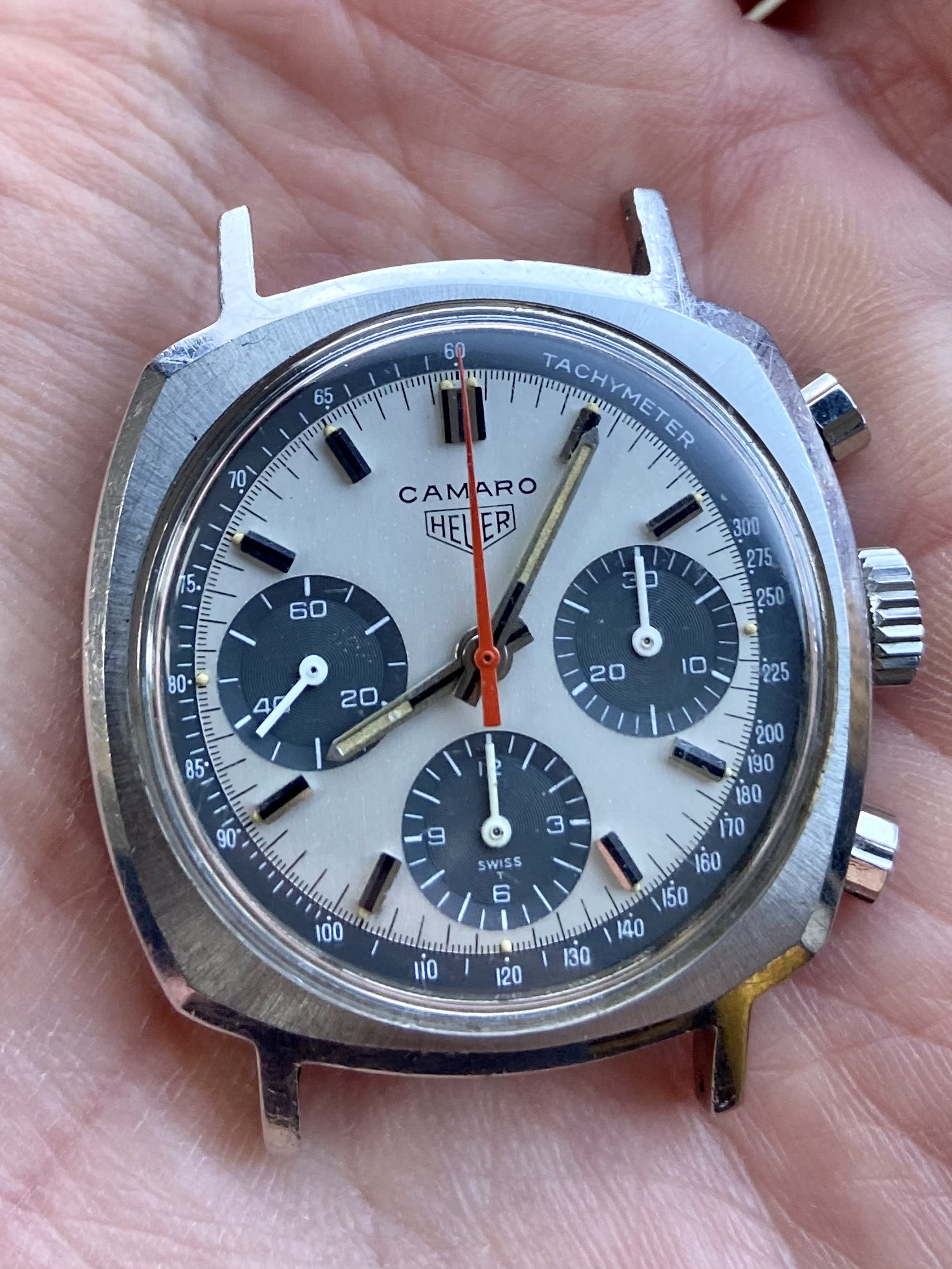

Thanks for the input everyone.
@Canuck and @Duracuir1 that case looks amazing, great work. I鈥檓 still shying away from this resolution as I really don鈥檛 want to risk loosing the serial number. However it might be a road I go down in future. Obviously once it鈥檚 been done it cannot be undone.
It鈥檚 good to hear @Dan S @vintage hab and @JwRosenthal say they don鈥檛 think the the pitting will progress if it鈥檚 let dry and hopefully your right. I also agree it was probably stored for 20 years with a load of gunk between the case and end links which likely started all this. However, I always have that nagging voice that says the corrosion needs to be removed to prevent it spreading. Perhaps I鈥檝e been bitten too many times with rust on old minis when I was younger!
So, What I would like to do is clean up and remove the corroded/pitted material. I can live (for now at least) with the clean pits it will leave behind but I would like to remove the oxidised material. Correct me if I鈥檓 wrong but an ultrasonic won鈥檛 achieve this will it? Will it just need a good going at with some peg wood or will it require buffing out or use of some kind of rust remover paste?
Appreciate any further thoughts and here鈥檚 the dial.

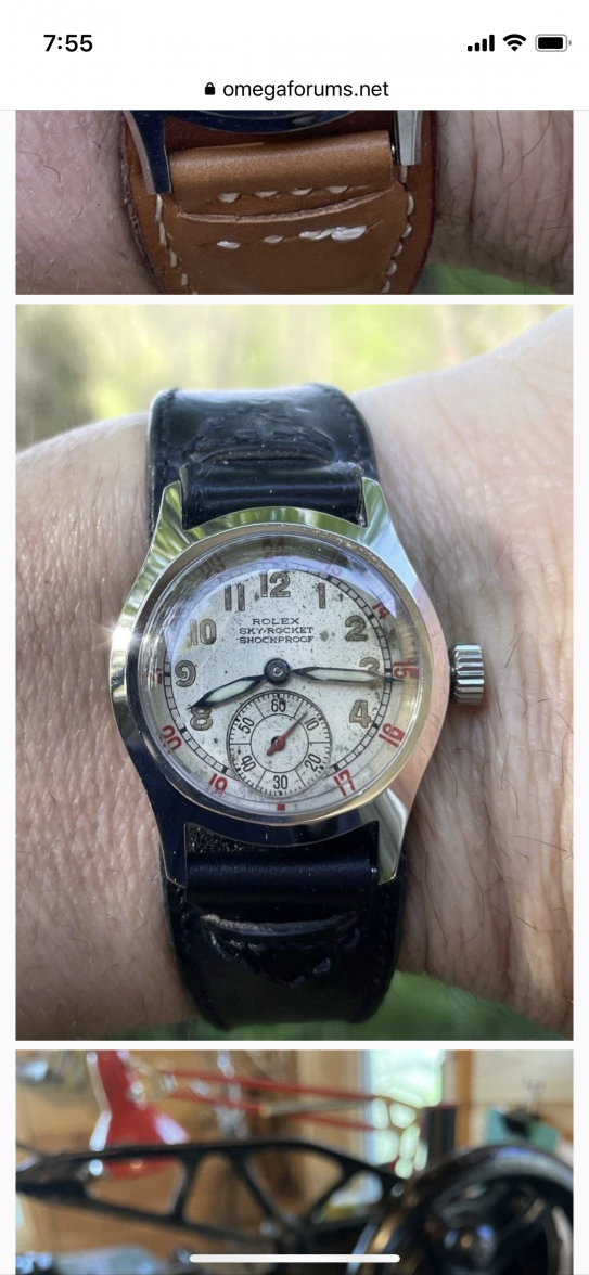

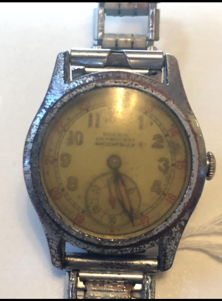

RePlateit is who you want to talk to. They were inQuebec (Canada), but have recently moved. They are now in Roseville, California. I can vouch for the quality of their work. See images, before, and after. Maybe send them a picture of what you want fixed.
https://www.replateit.com/
Wow, that is amazing work. I'm definitely going to add these guys to my list of watchmakers/repair artists.
