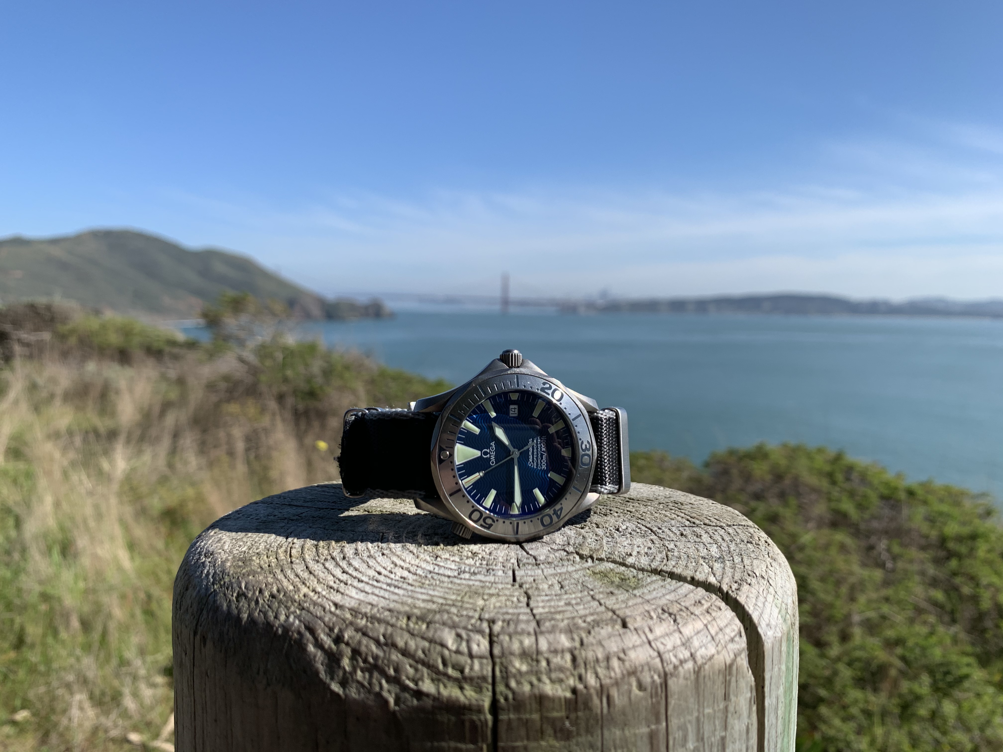

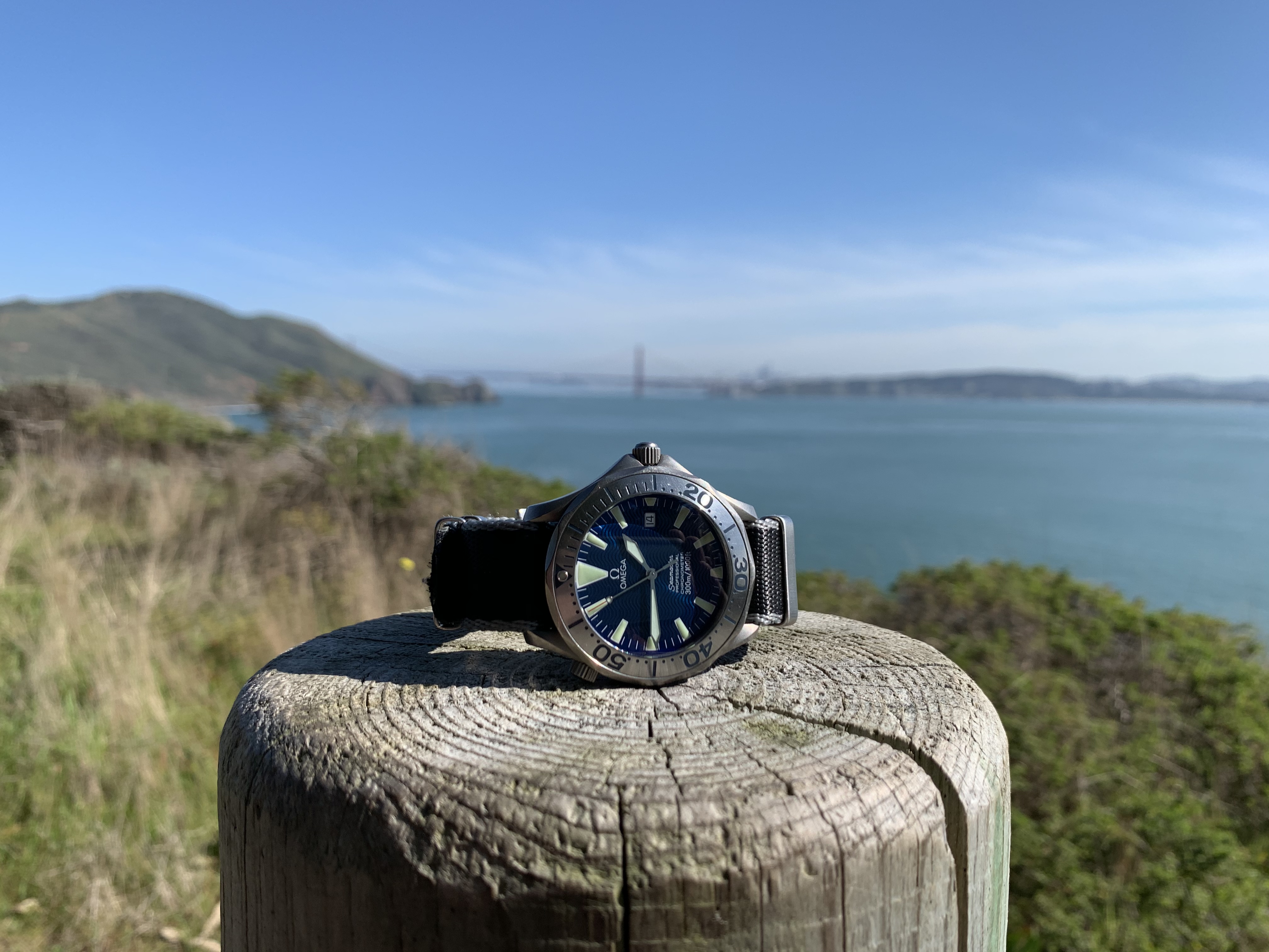

Thank you for your feedback. I have a Timegrapher. After really messing up that SKX I’m just hesitant to try it on the Omega. I was only planning on turning the fine adjustment screw and would think the chances of ruining the watch would be slim. Here’s a photo of the watch.

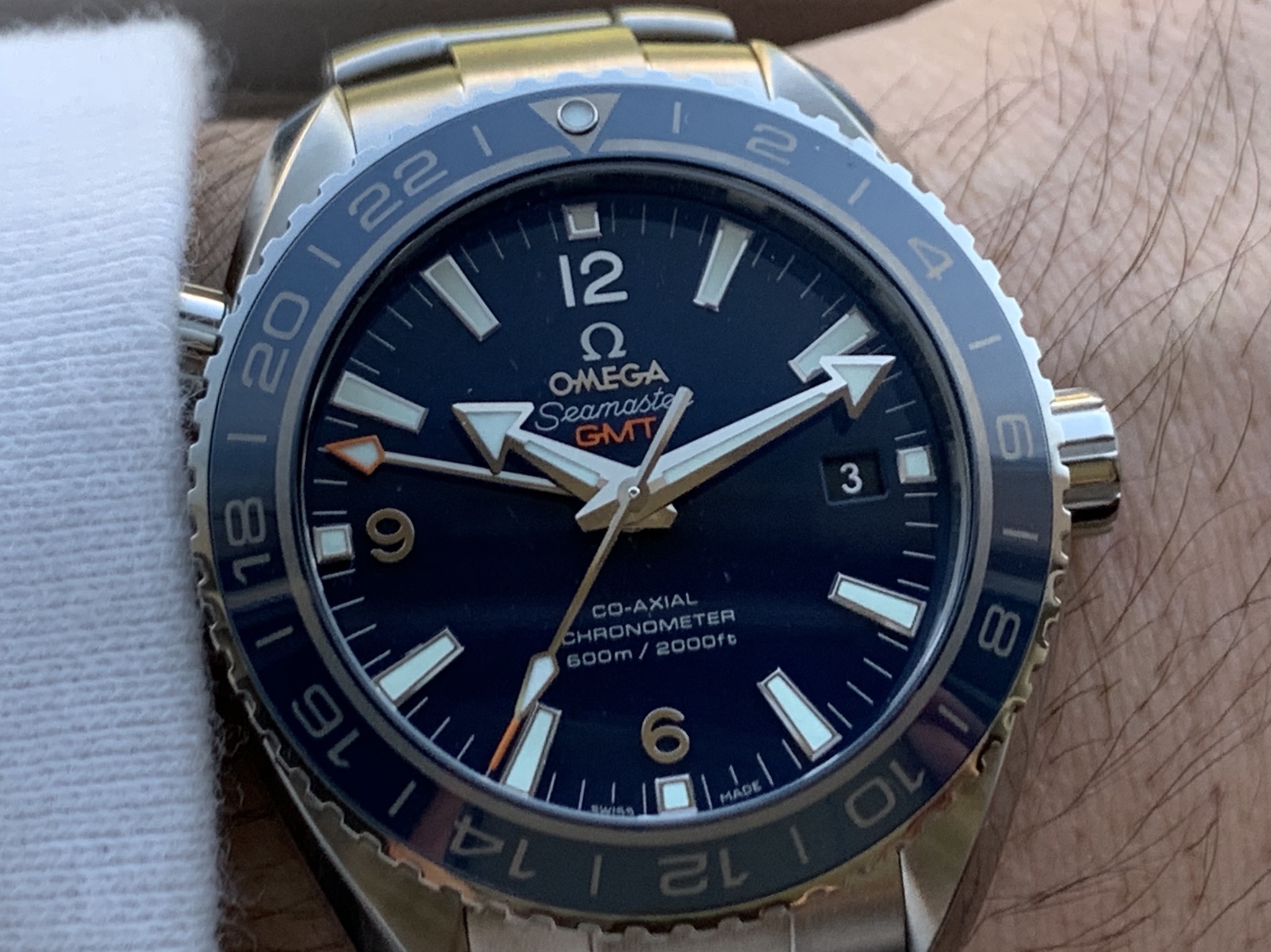

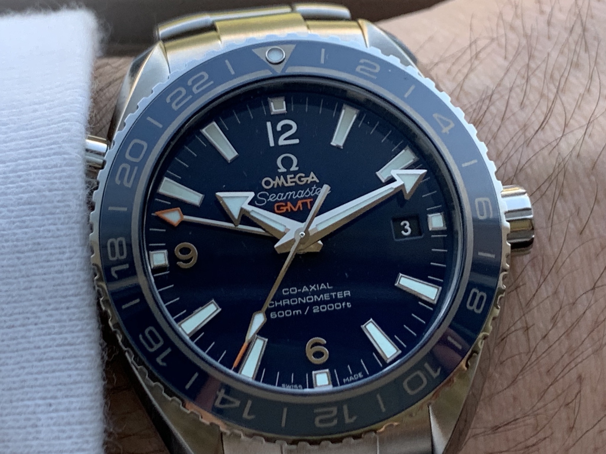

If I tried to regulate this Omega I’d be crazy. Good thing it runs +1 spd.
