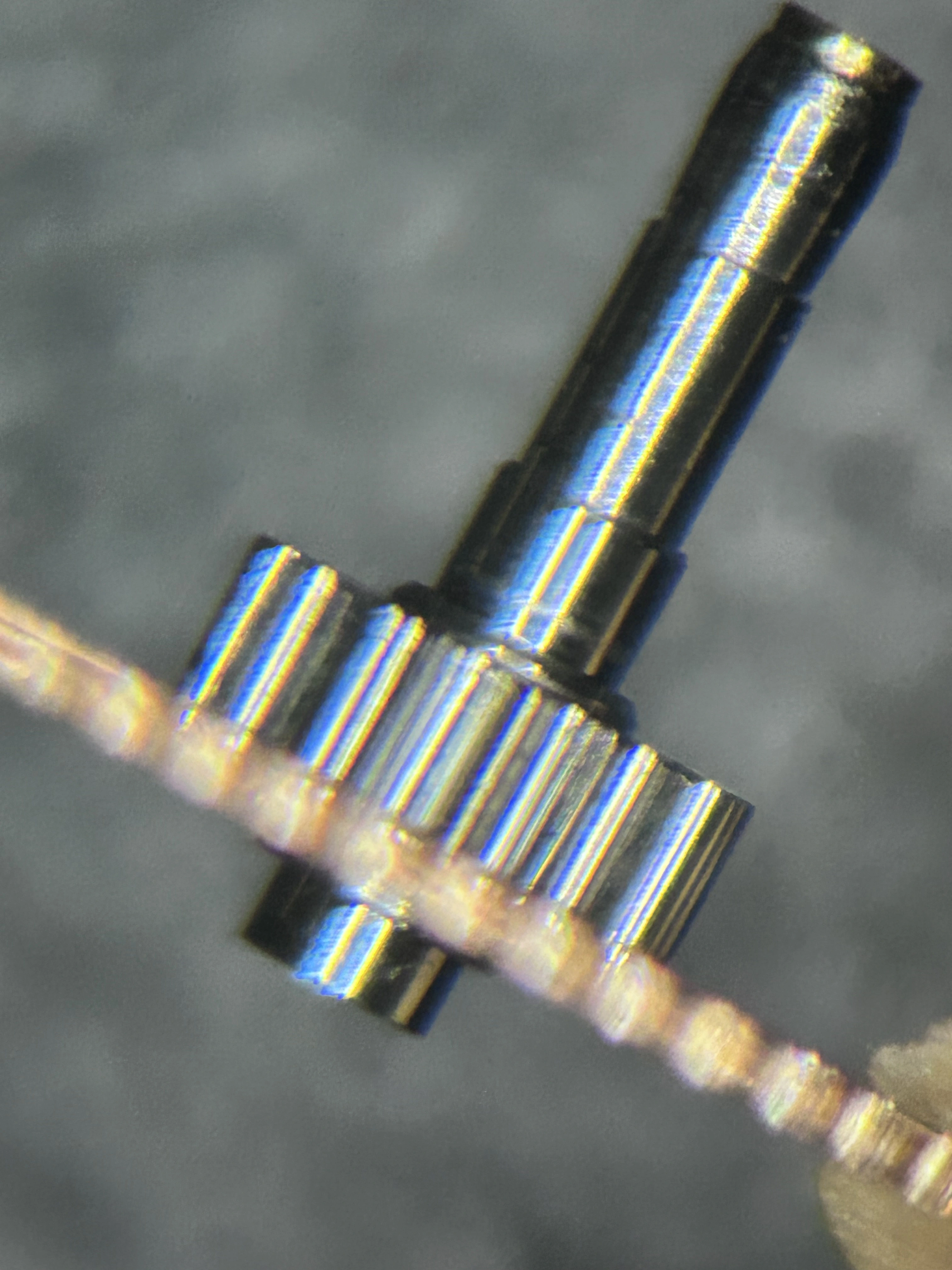

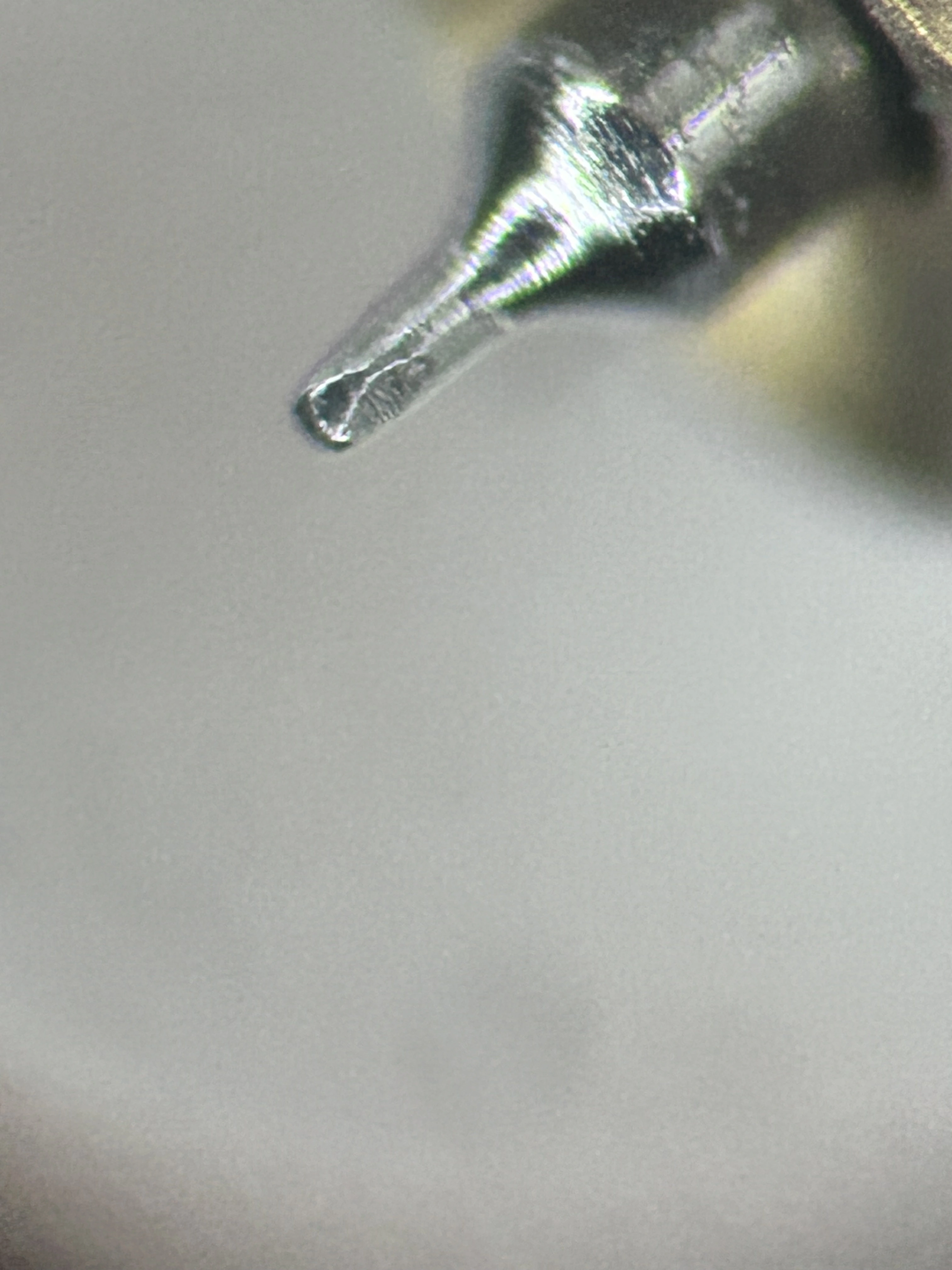

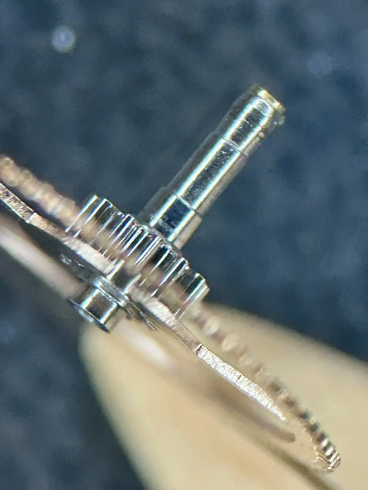

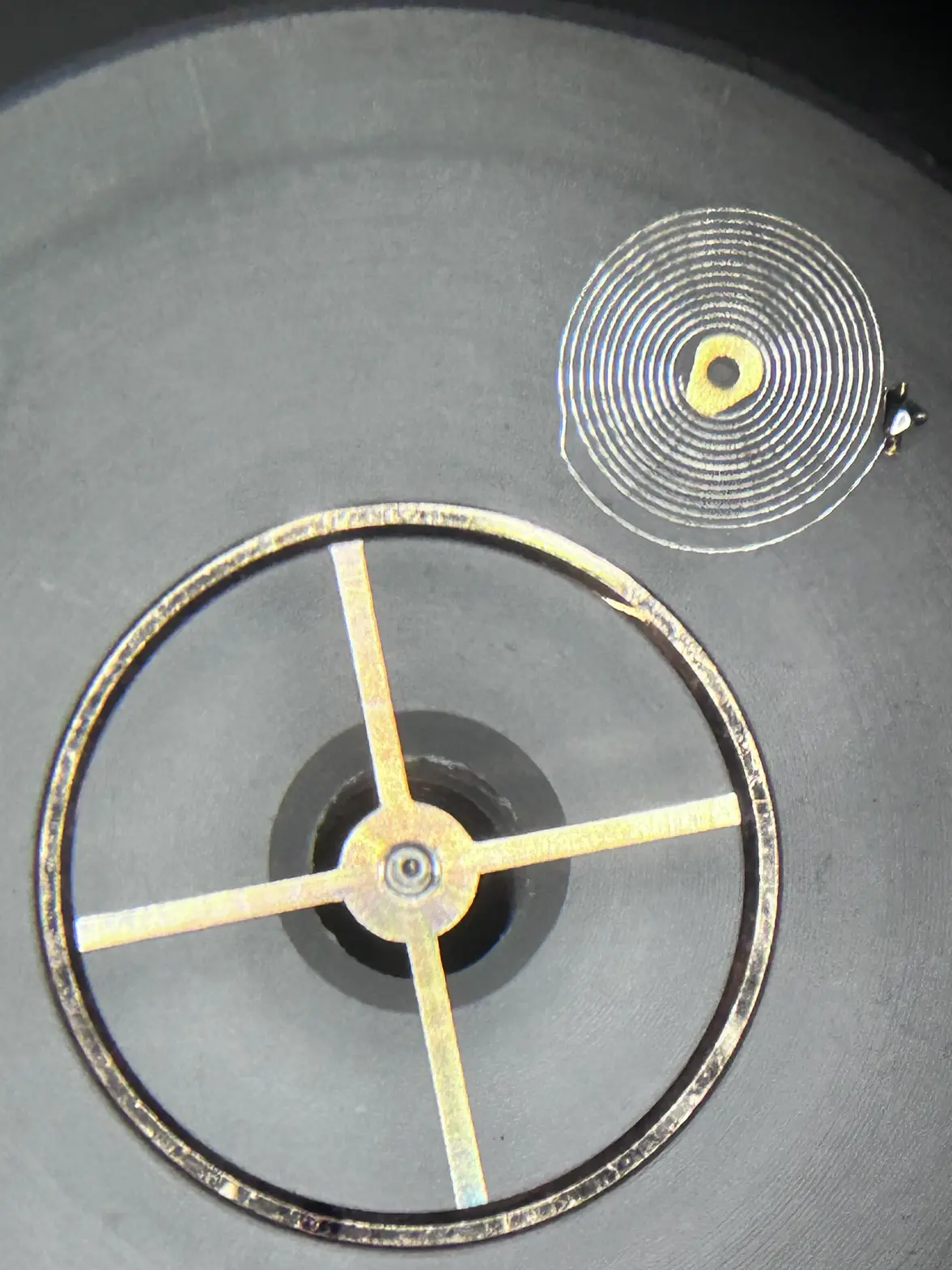

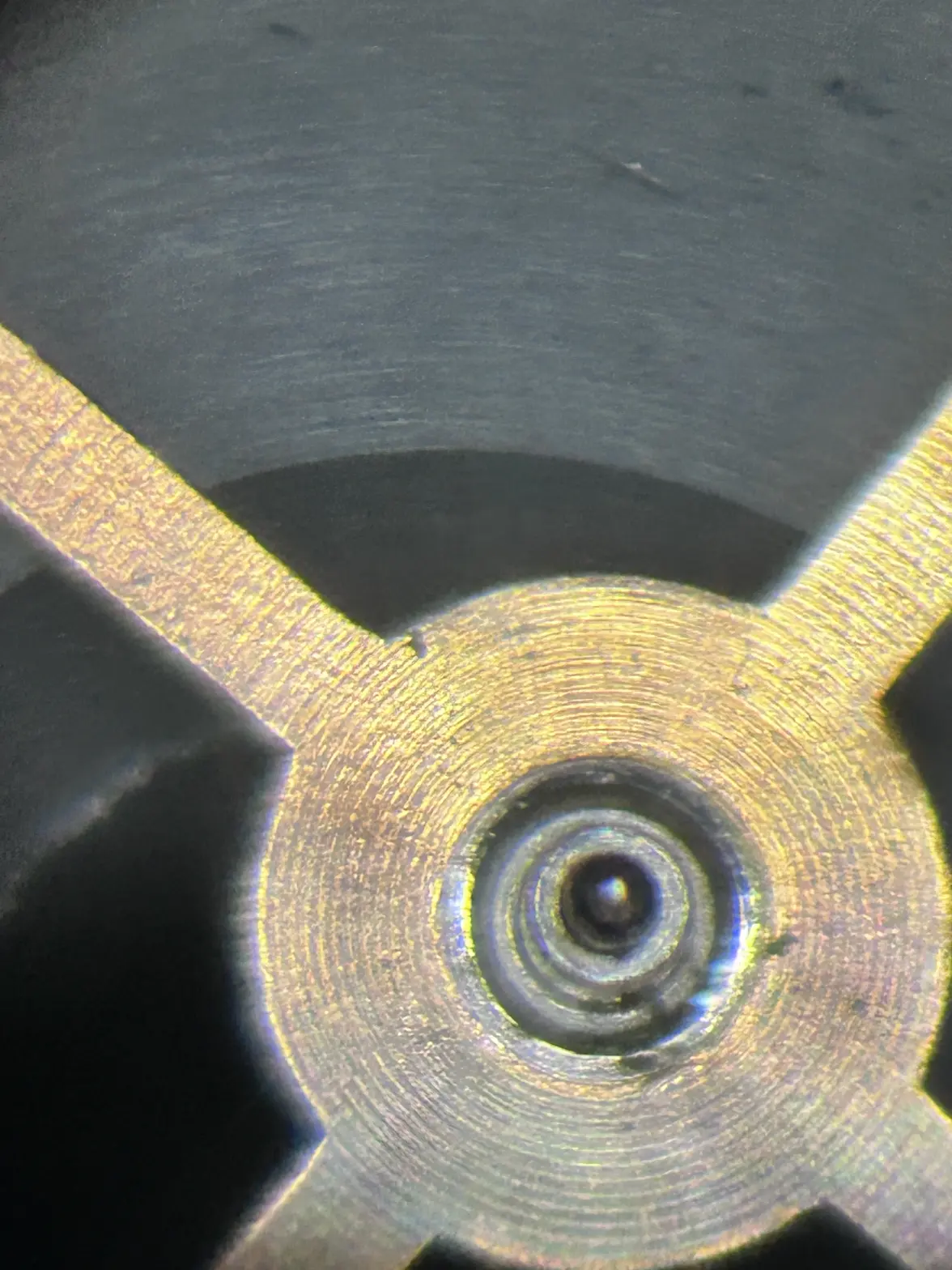

Got a 2x lens in the mail today and it’s still a challenge to see the damage on the end of the staff, but it still looks like it’s shot. No idea how it would have gotten like this. It’s really difficult to photograph with a phone down one of the eye pieces. But viewing it at many angles it definitely looks squared off on a few angles. The other end looks fine.
So now to figure out a way to fix it. I could source a replacement balance staff, buy the tools to repair it myself (staking set, Horia tool, roller remover) and know it’s good. I’m sure I’ll need to tweak something after like the hairspring.
The other option is just to buy a replacement balance. That doesn’t seem in the spirit of repairing watches, plus I don’t end up with tools afterwards. So I think I’m leaning to the first option right now.

That staff is toast. You can use alum to safely remove the staff (don't punch it out!) and then it's very straightforward from there.
I've written a post on doing this specific job here:

Thanks Archer! Confirmed what I thought and I was very worried about enlarging the hole by pushing the staff out. Hadn’t even considered Alum so that’s a perfect and safe solution for an amateur like me. Very much appreciate the excellent write up, plus I’ll go through all the other ones you’ve written too.

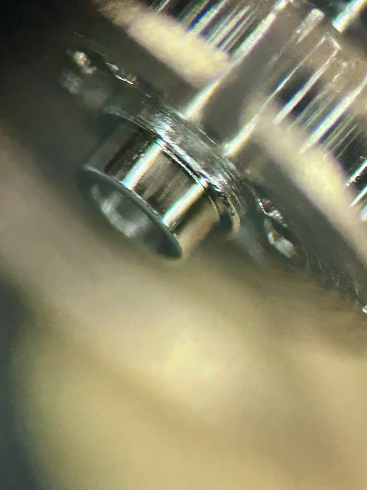

I got my second bridge in this week and have taken the old one apart. My plan was to use the Omega incabloc spring on the underside so the colour matches and it’s OEM Omega. But weirdly it doesn’t fit. It’s slightly too big. So for now I have the aftermarket one from Cousins in.

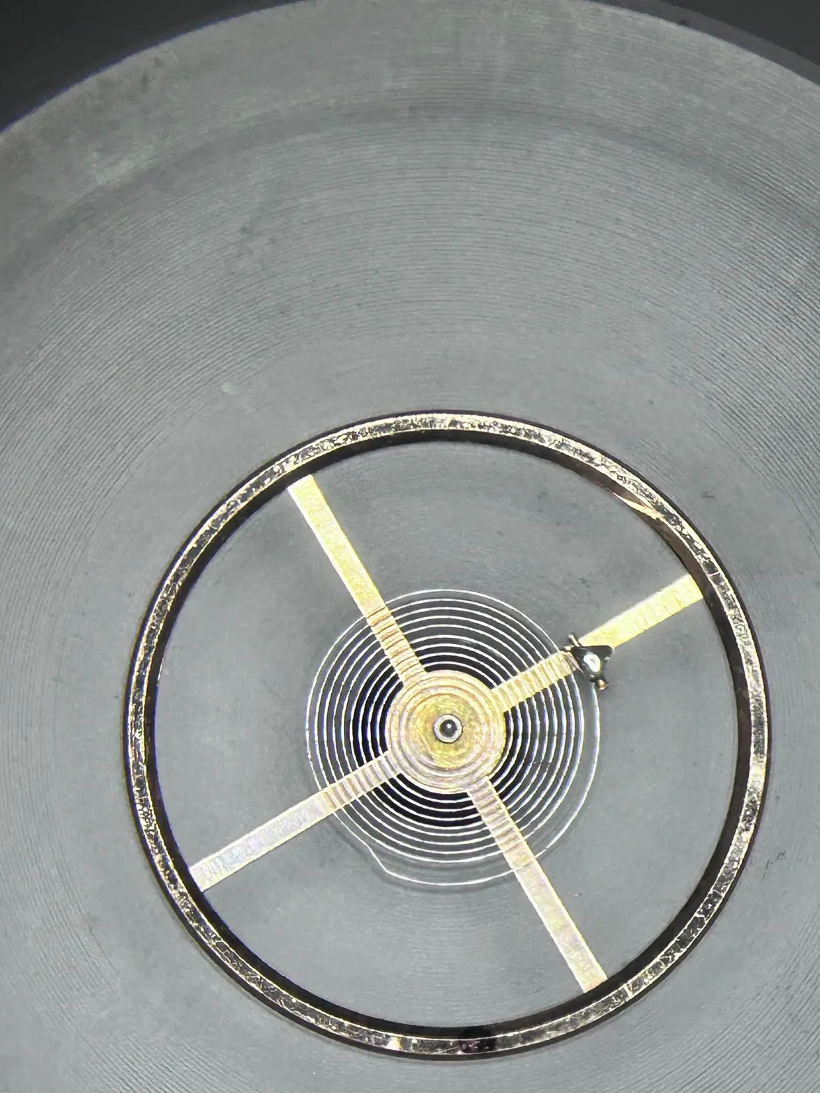

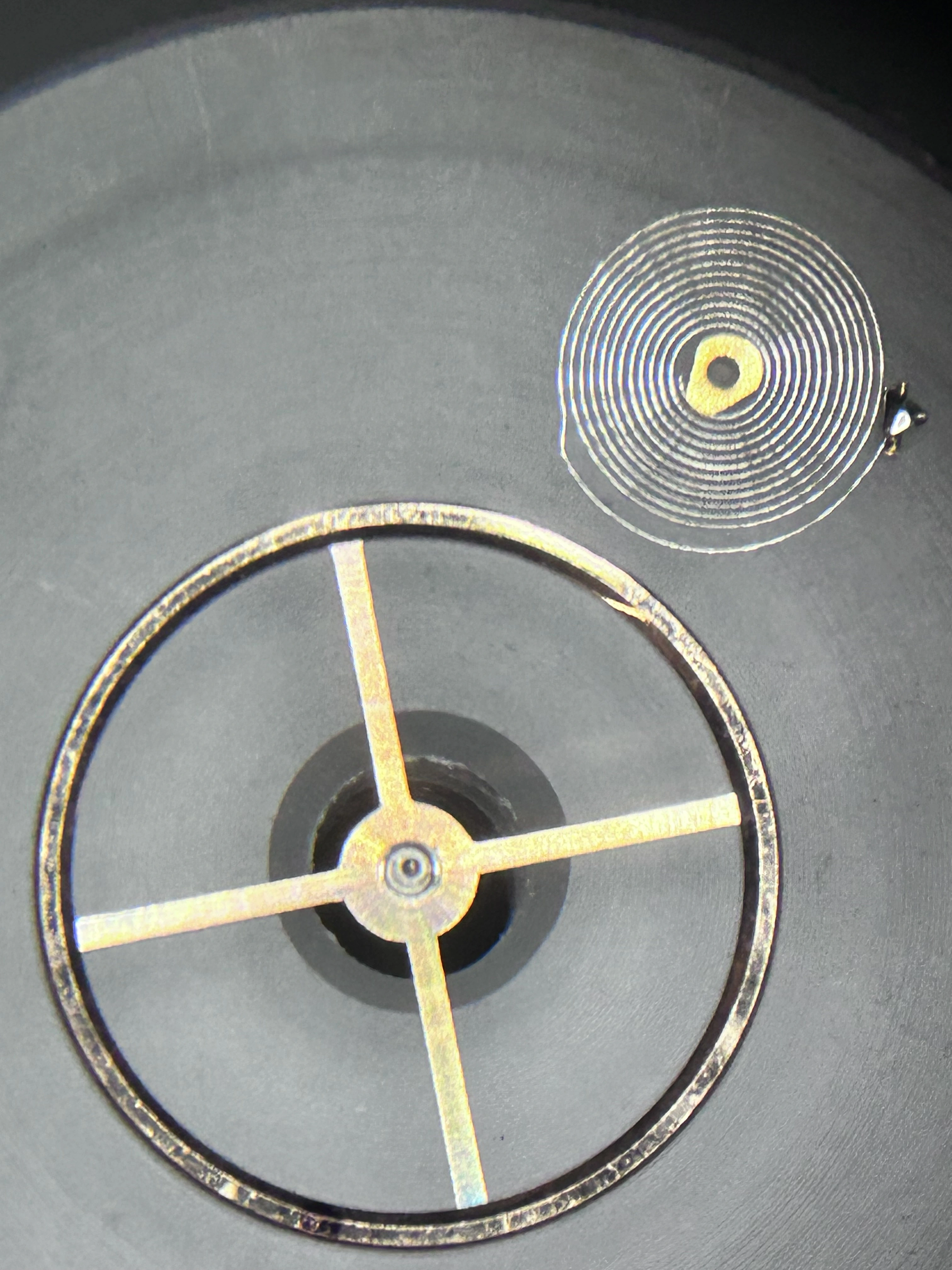

A few updates. I’ve purchased more equipment. Bit silly when I only have 3 watches but I’m enjoying the process of fixing this 565, plus it’s about the same cost as buying a complete balance, but I then have the equipment to maintain my watches in the future.

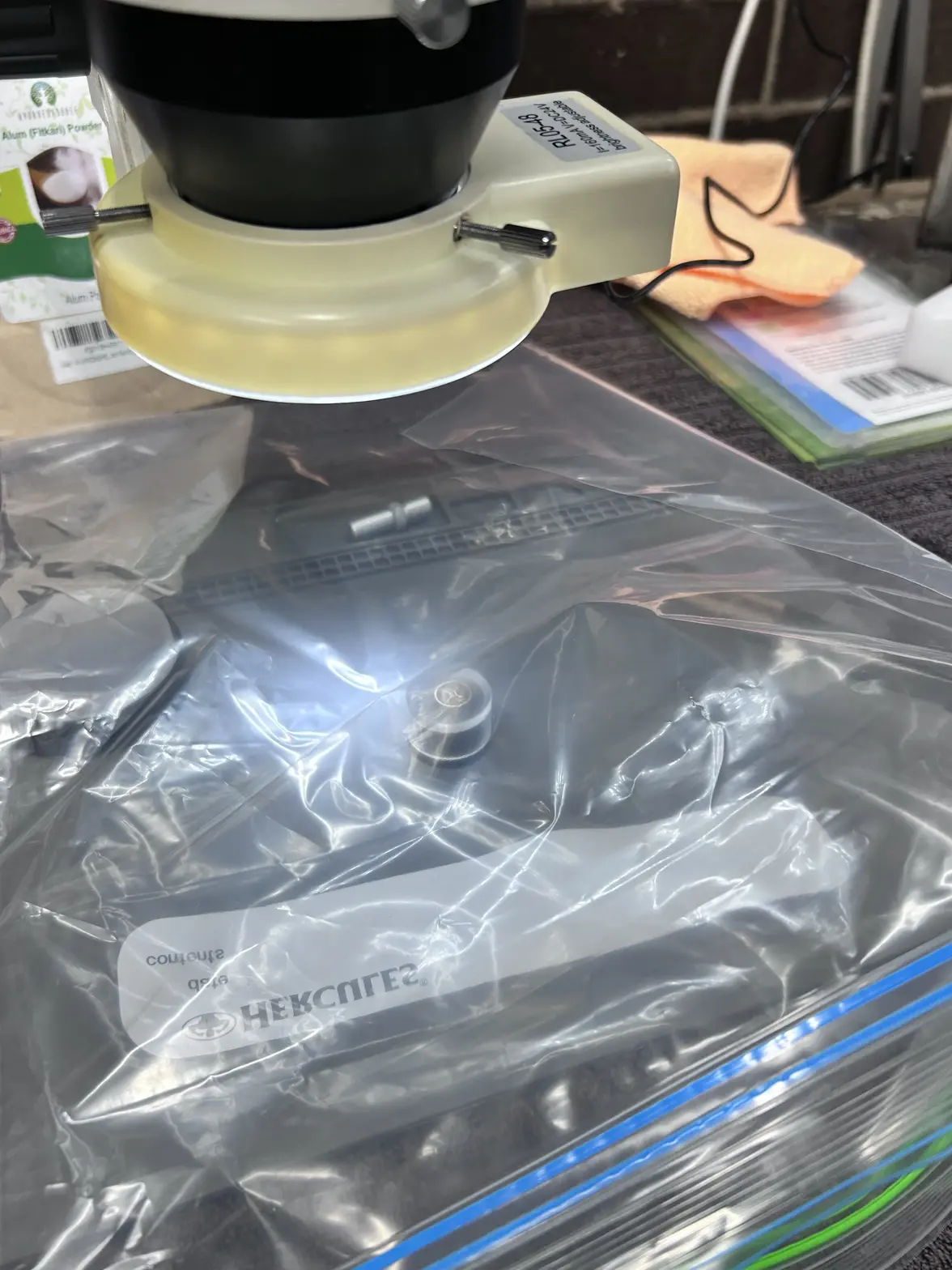

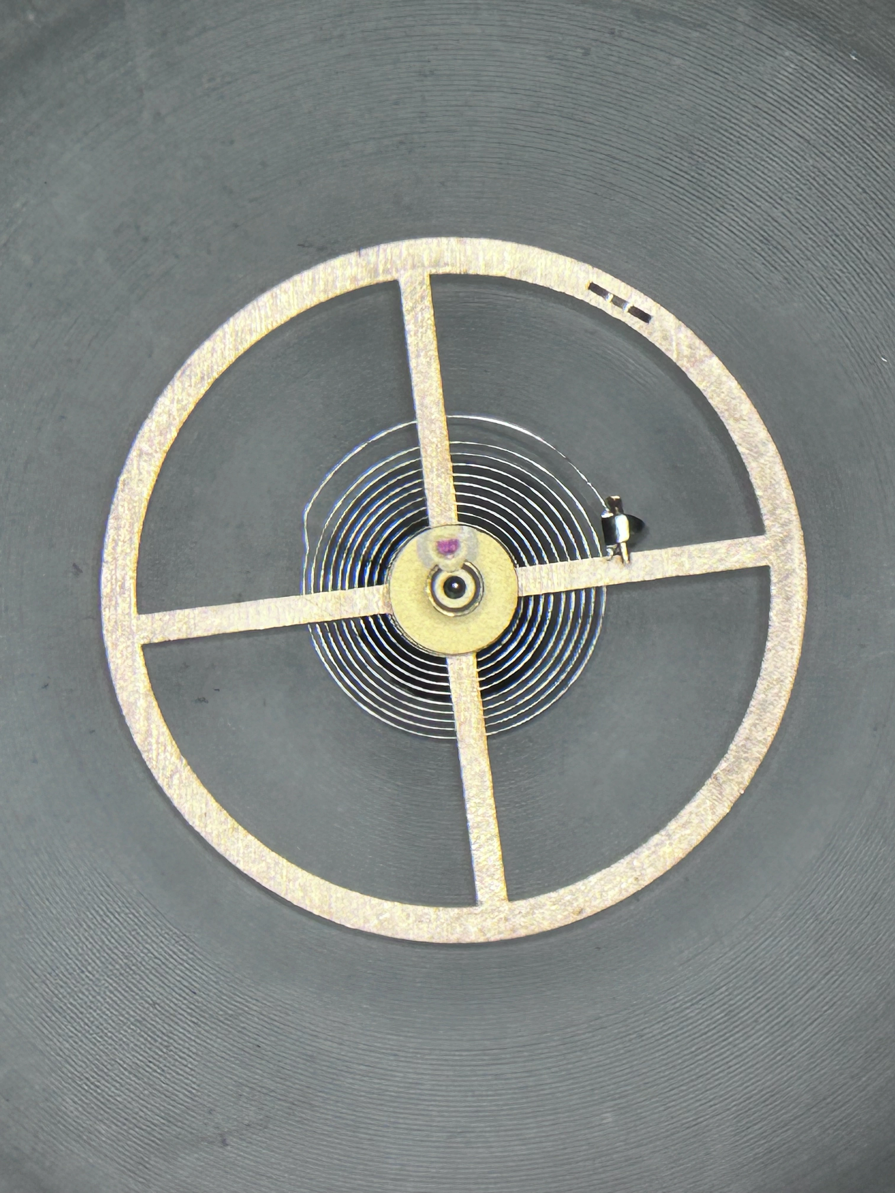

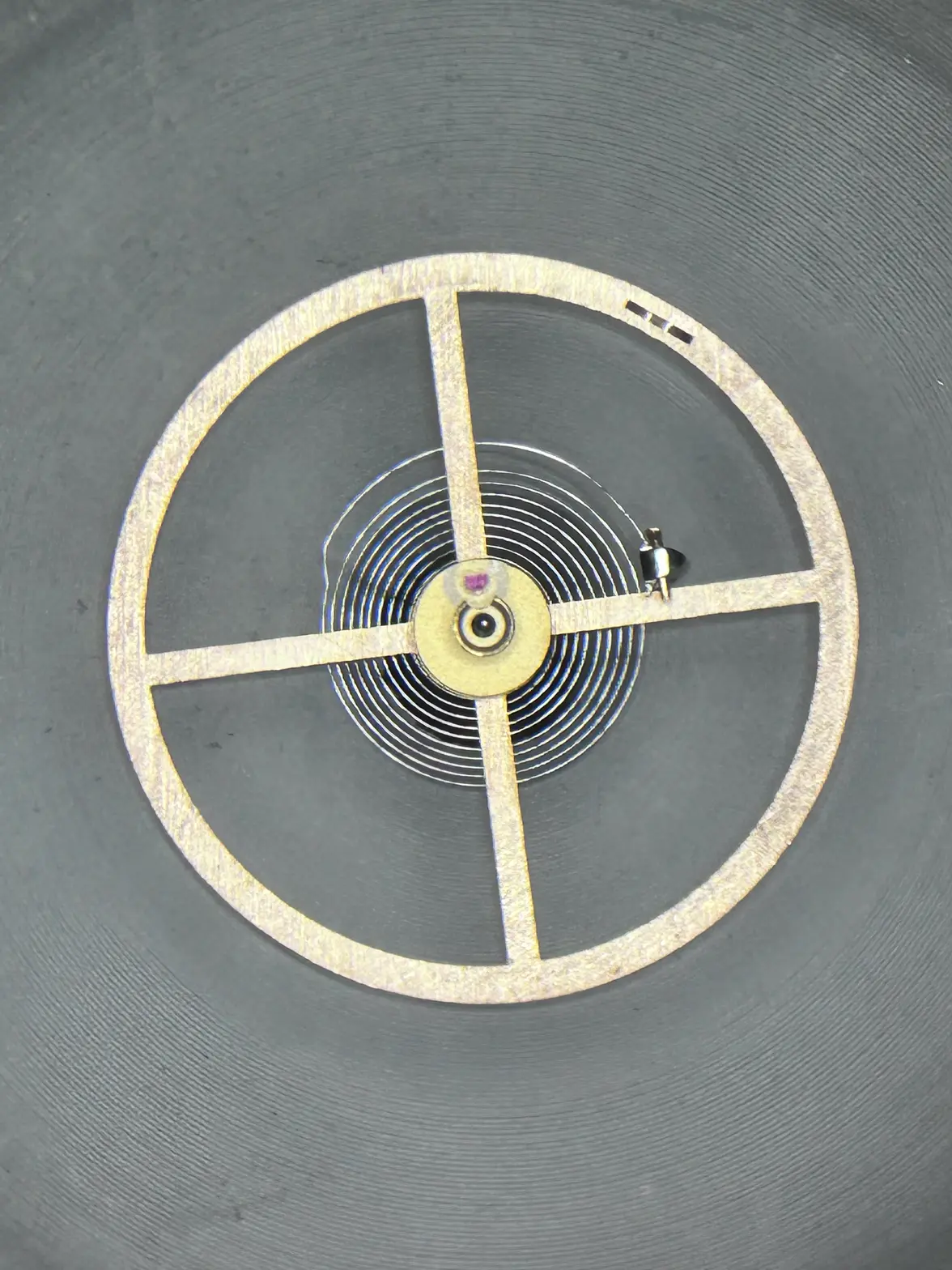

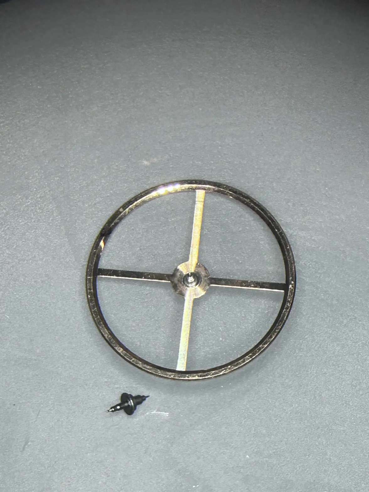

Today’s job was to seperate the balance wheel. I took plenty of photos so I can ensure I put the hairspring and roller back in the exact same place. Plus I marked the location of the balance wheel using a sharpie.
I bought some dedicated hairspring levers and gingerly set about taking the hairspring off. I was exceeding gentle and took my time and eventually it popped off with a satisfying action.

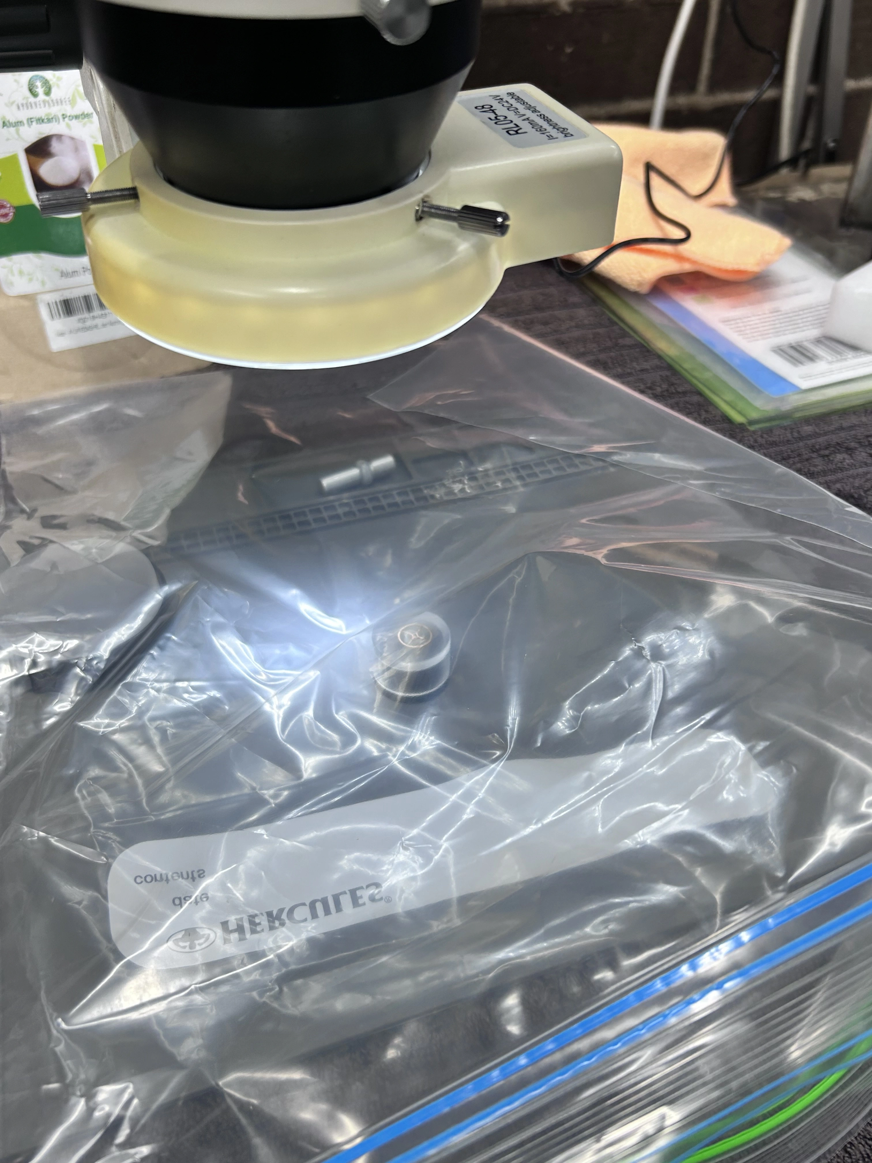

Next I did the same with the roller. Carefully straddling 2 arms of the balance wheel. I also did this in a giant plastic bag as I’d heard about rollers pinging off into another dimension. Again took my time and was rewarded with the same result.

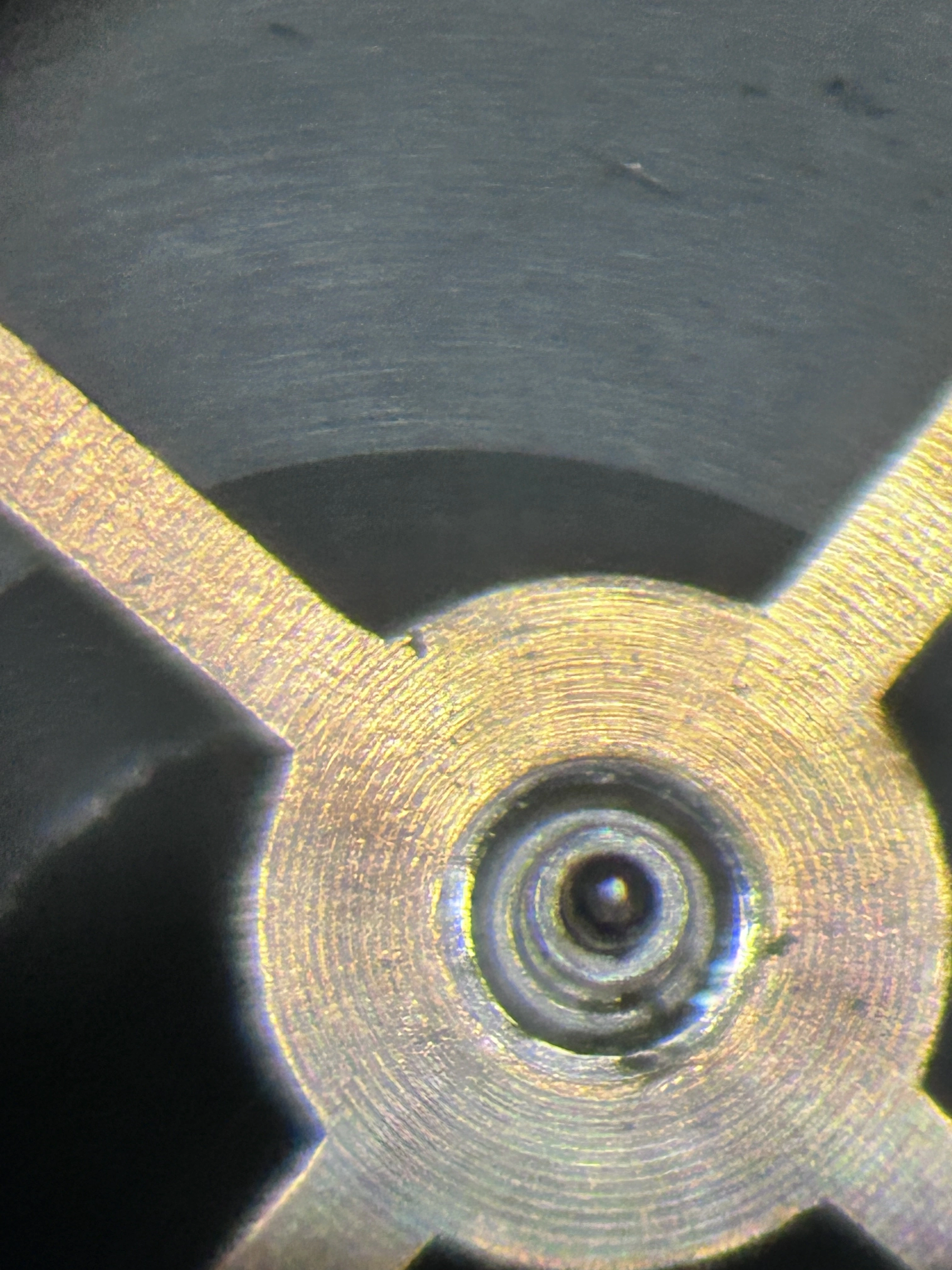

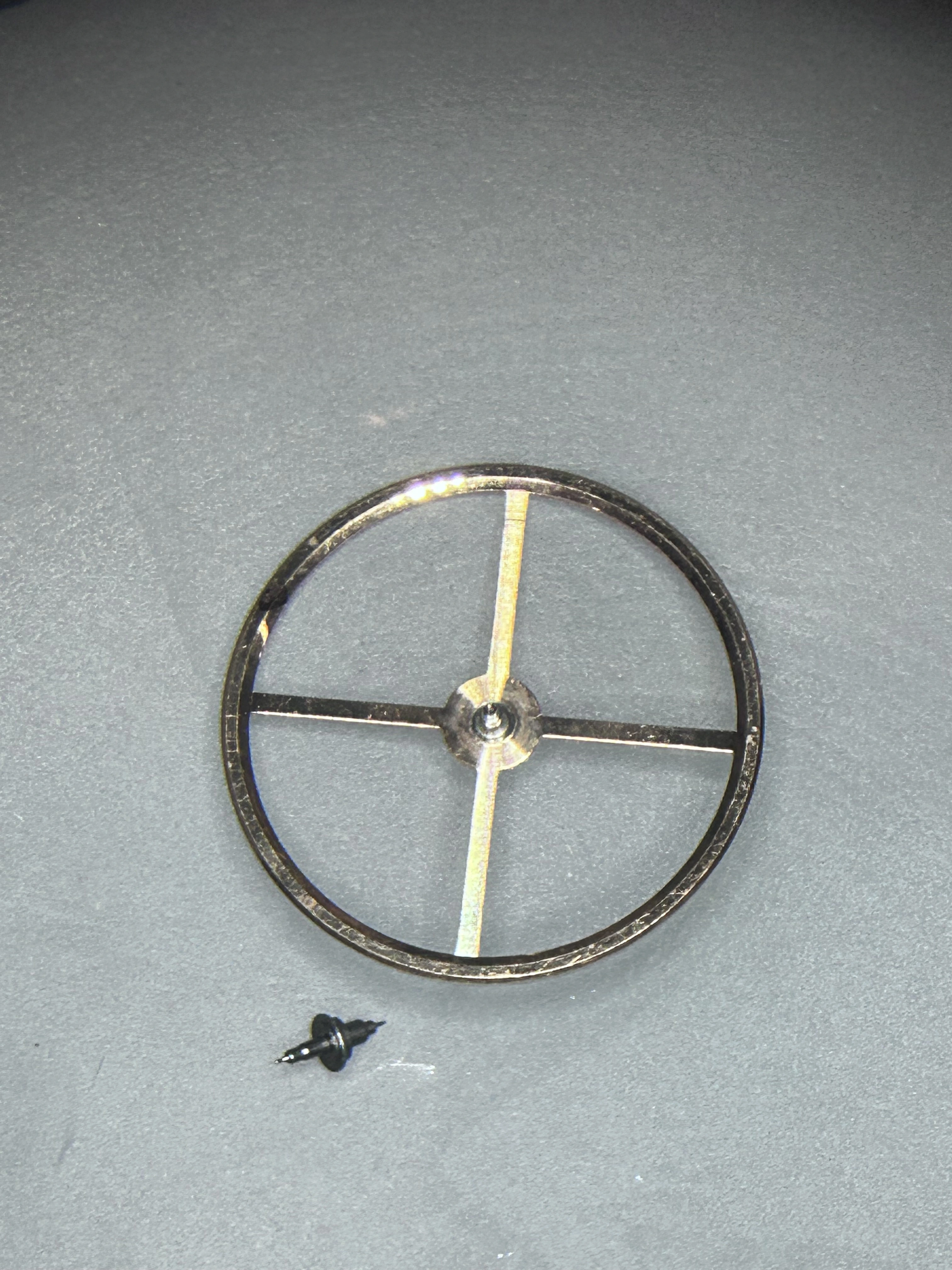

So now I need to mix up some Alum power in water and get this staff out. I’ll go back to @Archer guide to understand how long I need to leave it in the solution for.
That’s a job for tomorrow and I’m hoping to polish up my punches to have the new staff in the balance wheel ready for a test fit in the new balance bridge.

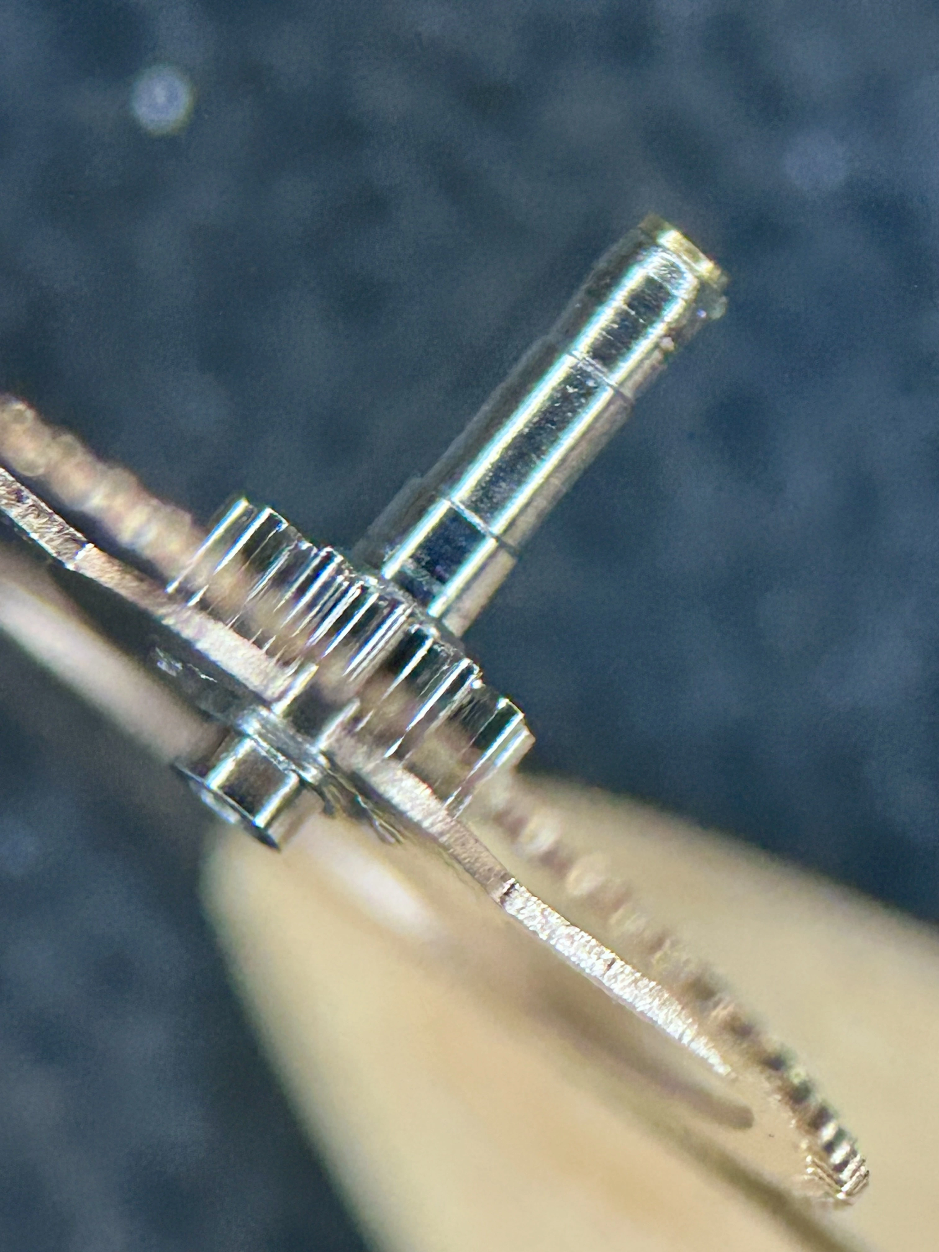

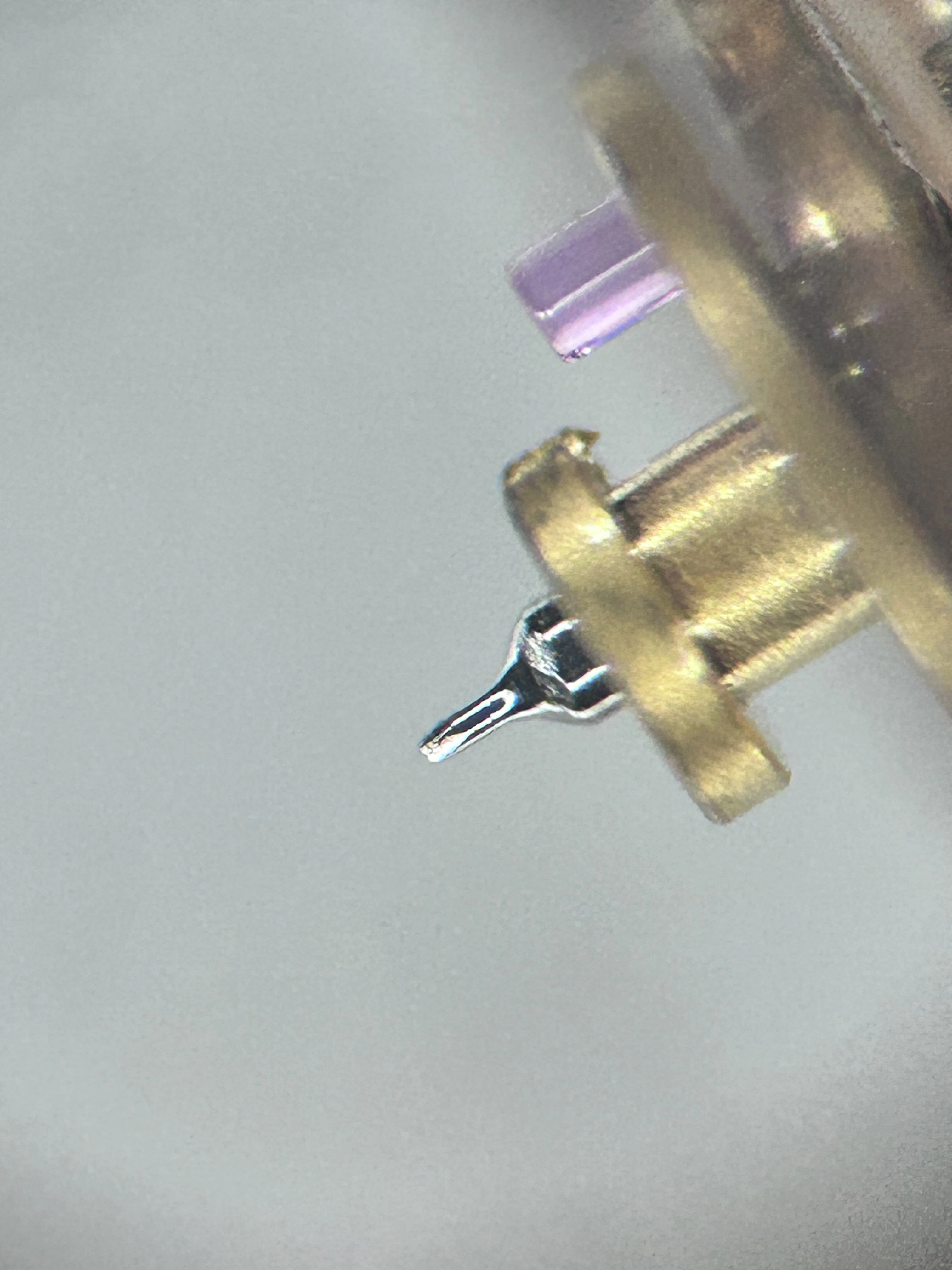

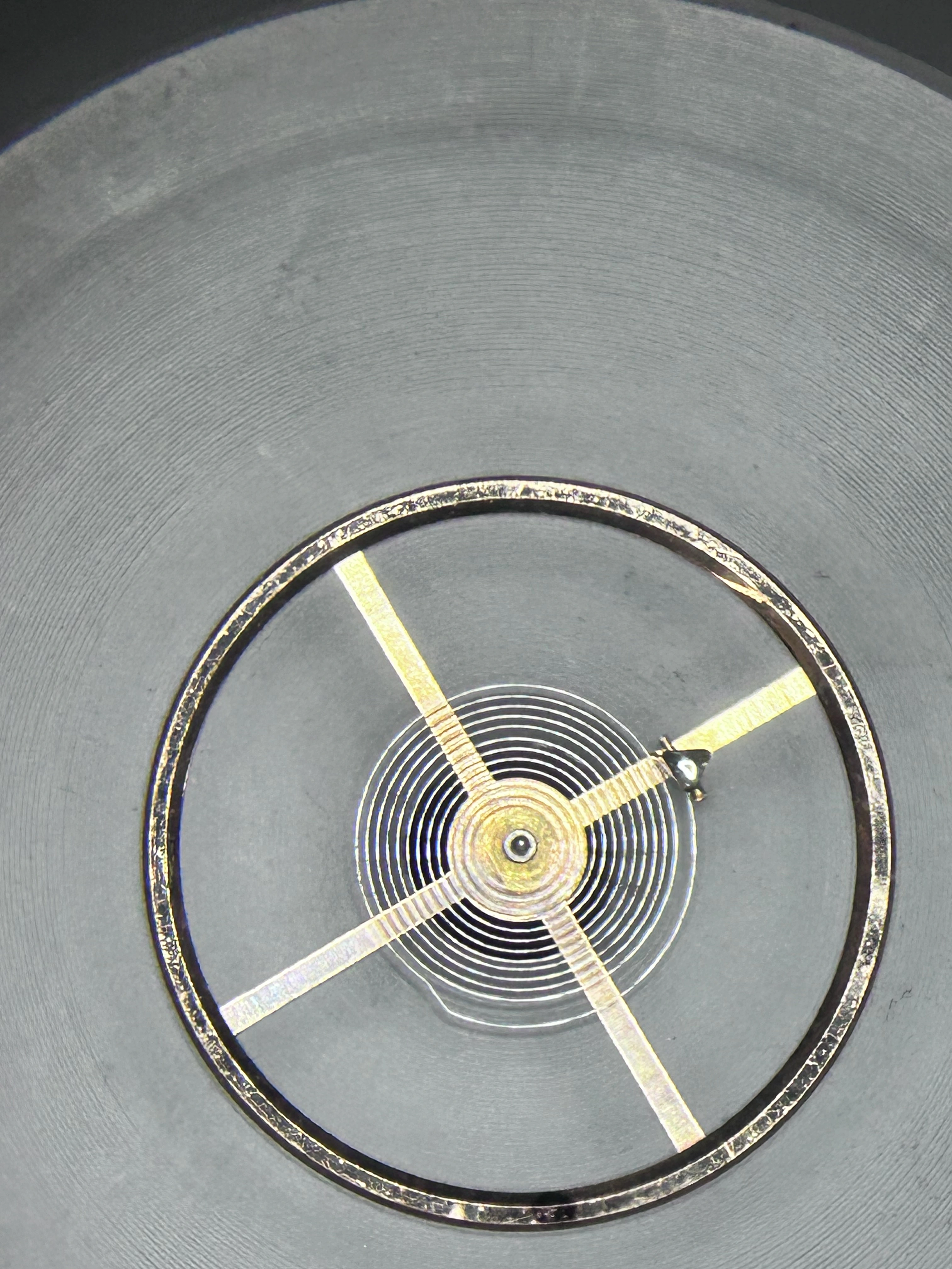

Thought I would update everyone on where I’ve landed with this movement. My attempts to repair the balance staff ultimately ended in disaster. I managed to get the staff out without any issues but riveting the staff back in was where it went wrong. My inexperience made me not realise when to stop trying to rivet the new staff and I damaged the wheel.
So I bit the bullet and sourced a balance wheel from eBay that was NOS. I likely should have done this to begin with, but I’m happy I gave it a go, even though the results were not successful.

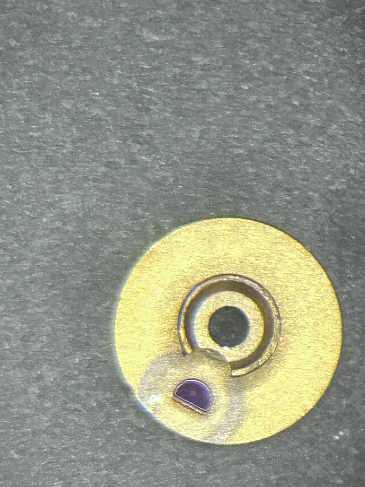

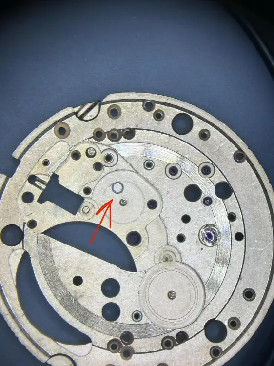

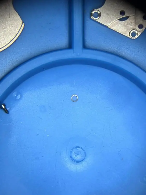

The only thing I need to solve is where/if this washer came out of the movement. It was in the movement holder underneath the main plate when I found it, but it seems to be too big or too small for all the posts on the main plate. @Archer I don’t suppose you would know would you?
I just noticed you're using Hercules sanger bags. Aussie at all? Or are Hercules bags global?
44
5
Yeah! I’m based in Sydney 😀
If this was not a date version it might be a dial washer, but that's not used on the date versions typically.
The only other washer is the one under the crown wheel...
44
5
Thanks Archer. It’s a date version, so not a dial washer and it’s way too small for the crown wheel (plus I definitely installed that one). I thought I could be under the setting lever but it doesn’t fit that post. I’ve left it out and the watch is running beautifully.
