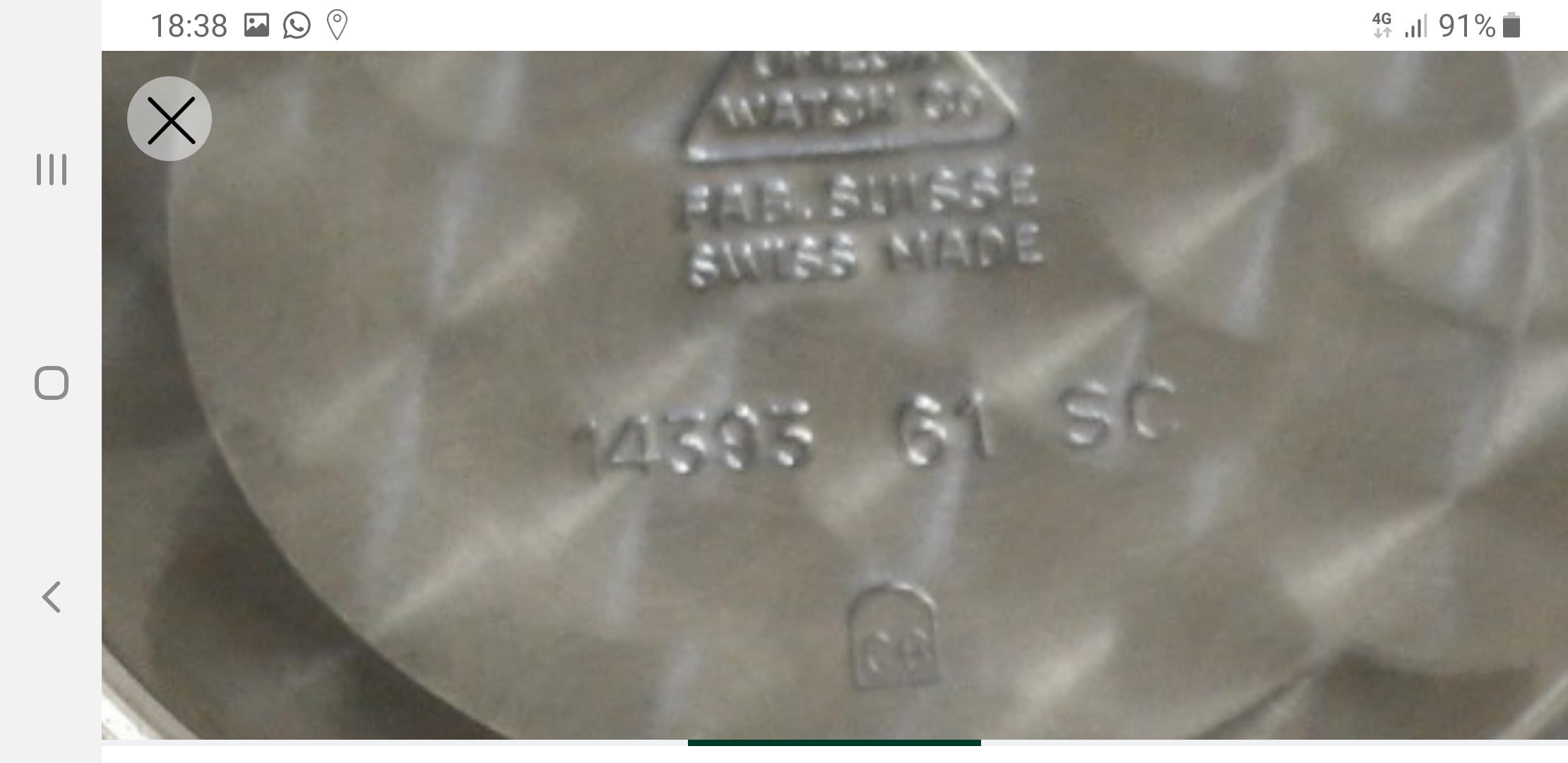

Can ref.no 14395 61 SC and cal.561 with production no. 19967532 be a combination?
To me it seems to be two different years, 1961 and 1962. Is it possible? The watch is Gold on Steel and the Conni on backside in gold.

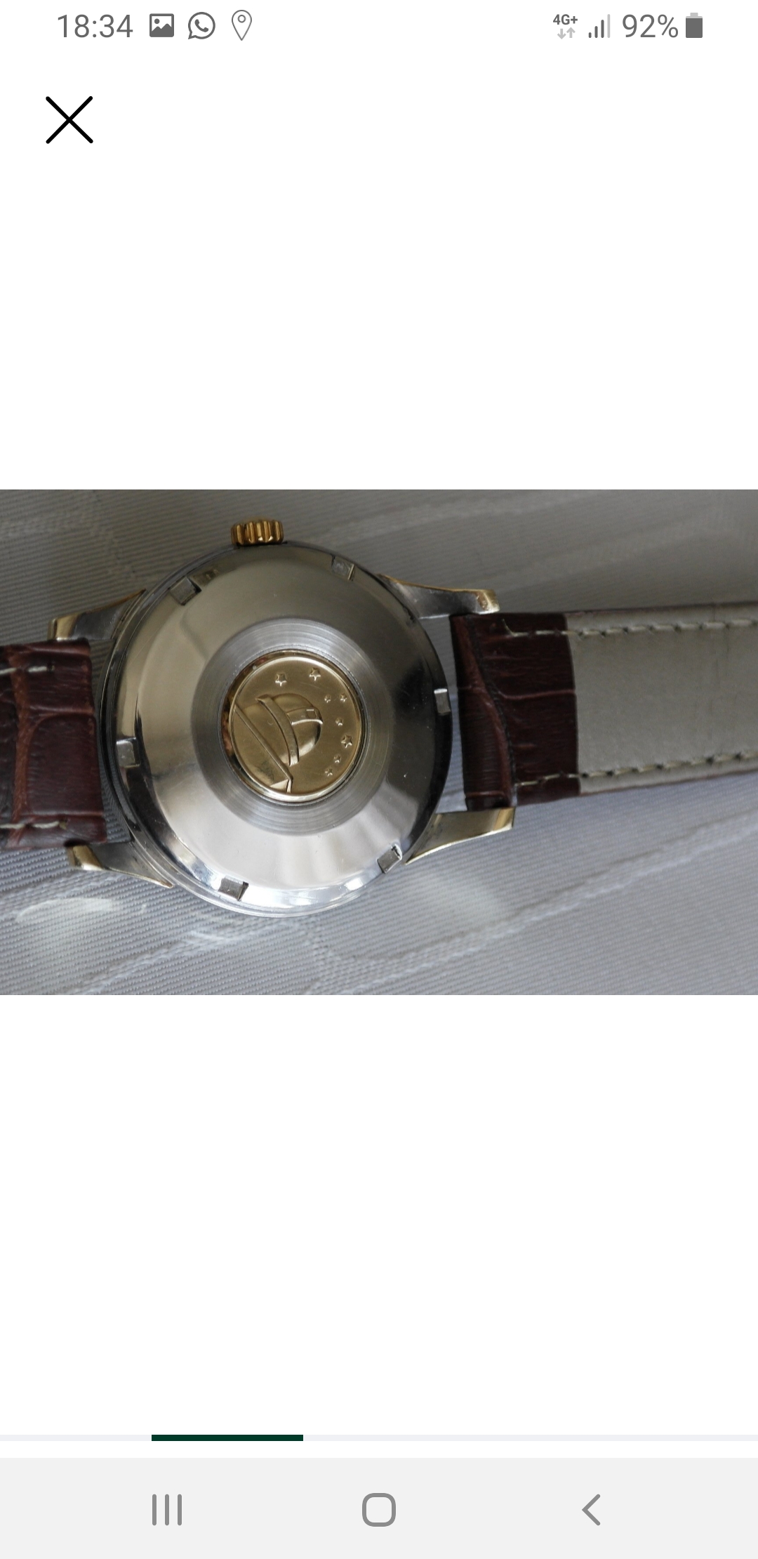

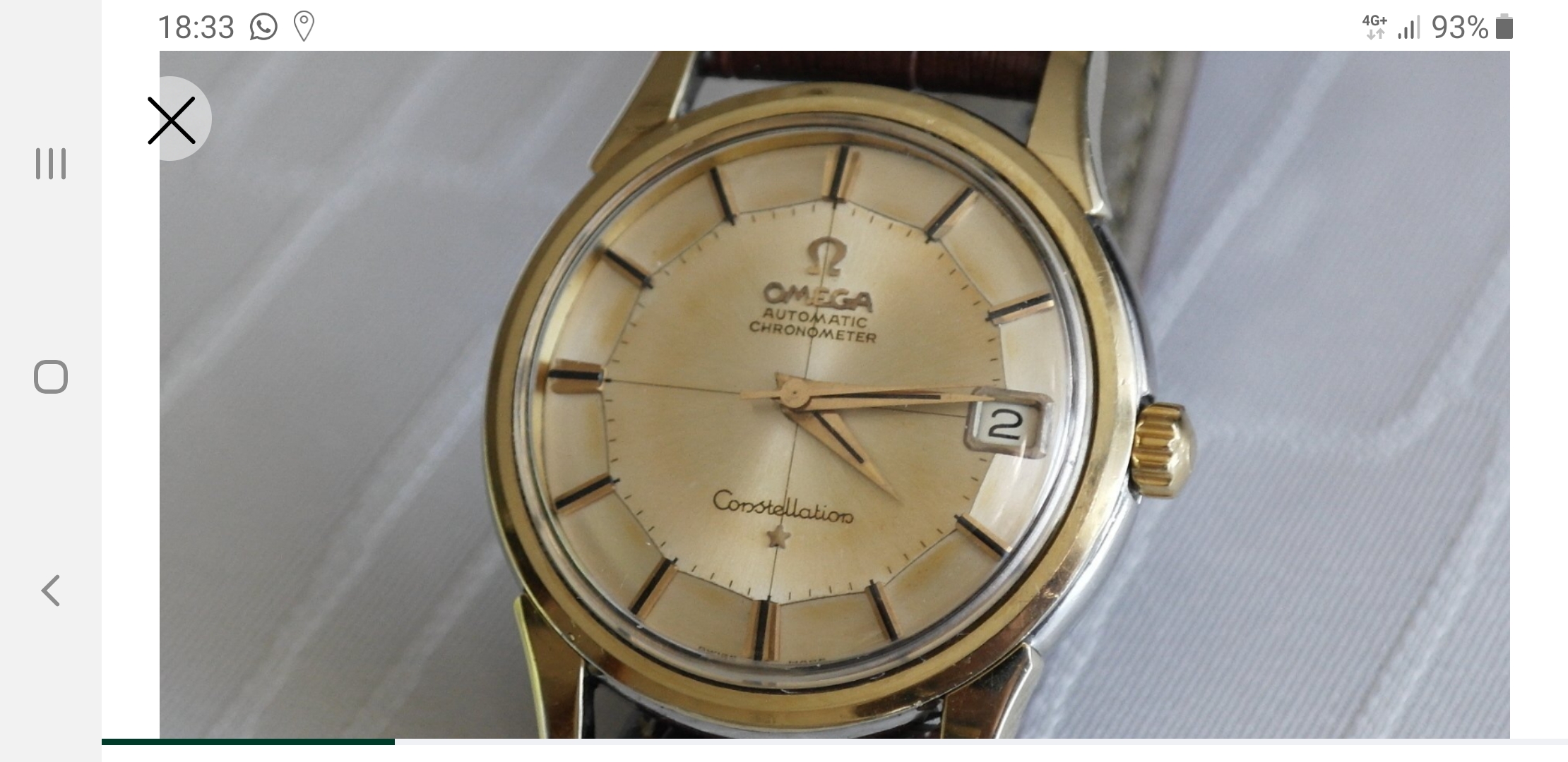

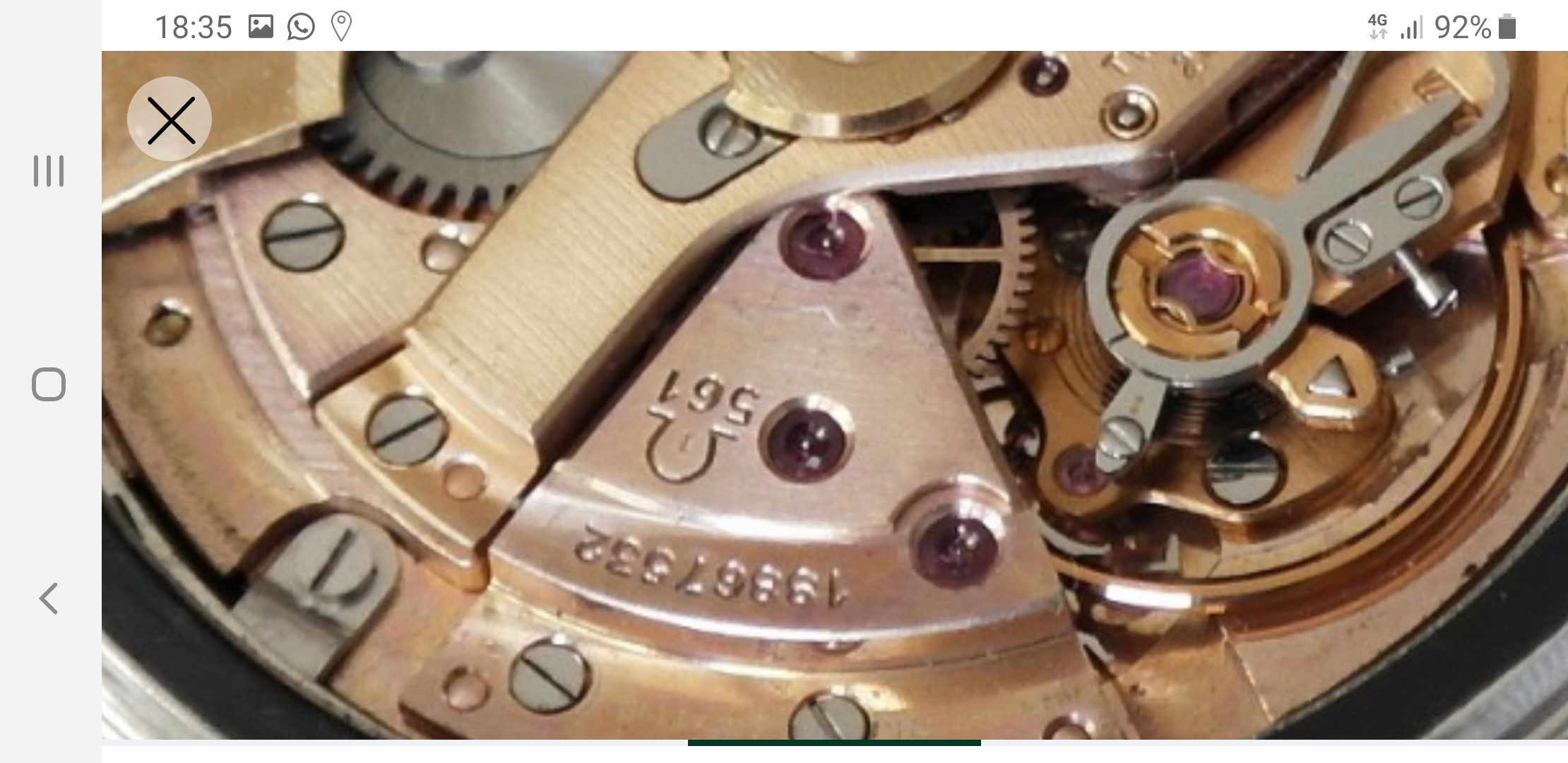

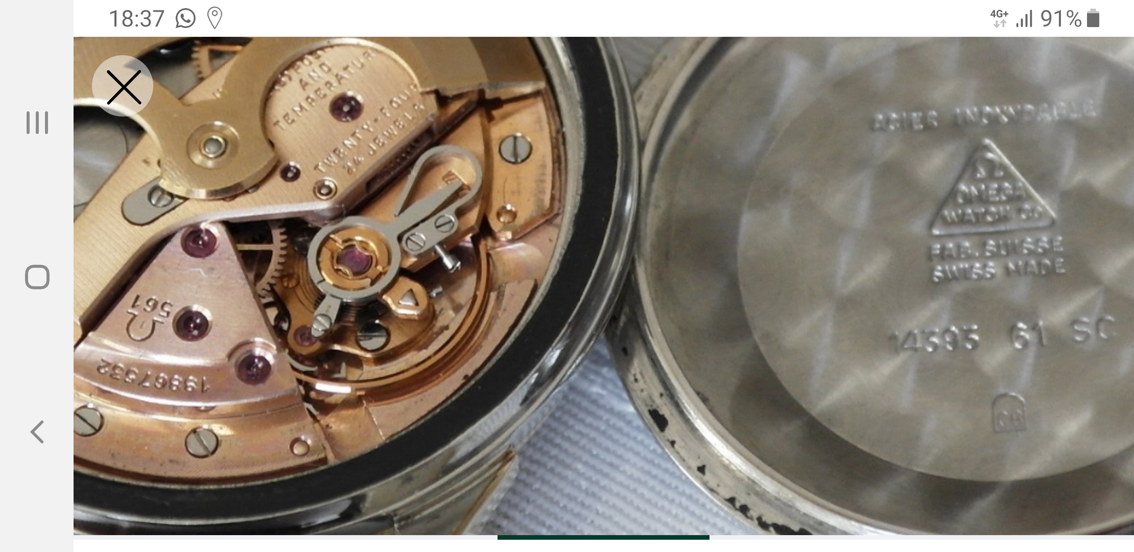

I share the photoes I have so far. This is my first time here. Hope these will help. Greatfull f枚r all comments.
https://www.omegawatches.com/en-us/watch-omega-constellation-calendar-ot-14393
Cal. 561 is correct for this watch. The date on the case back should not necessarily correspond with the date of the movement. Neither are entirely accurate, and Omega had a tendency to use compatible parts until their inventory ran out.
