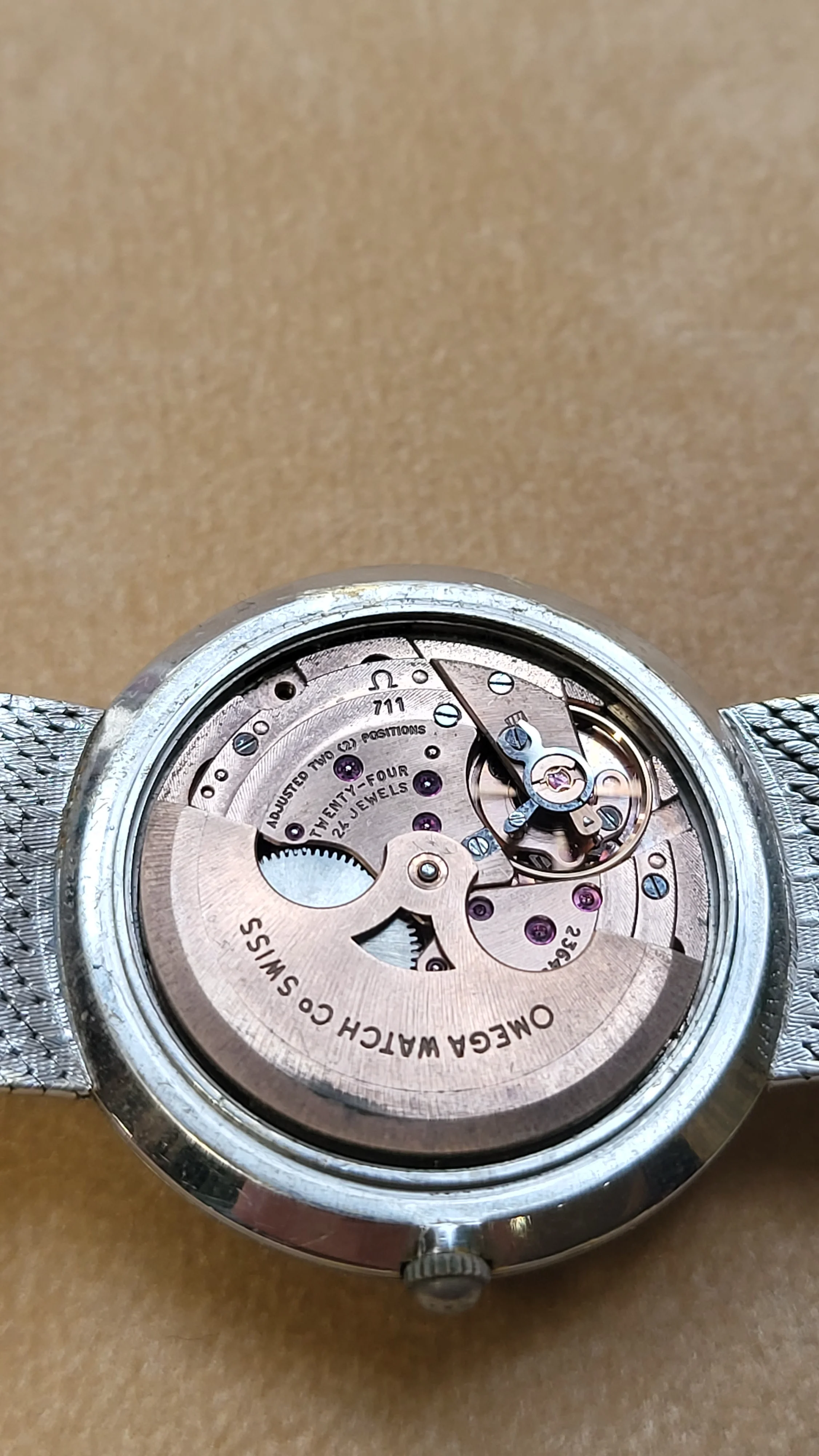

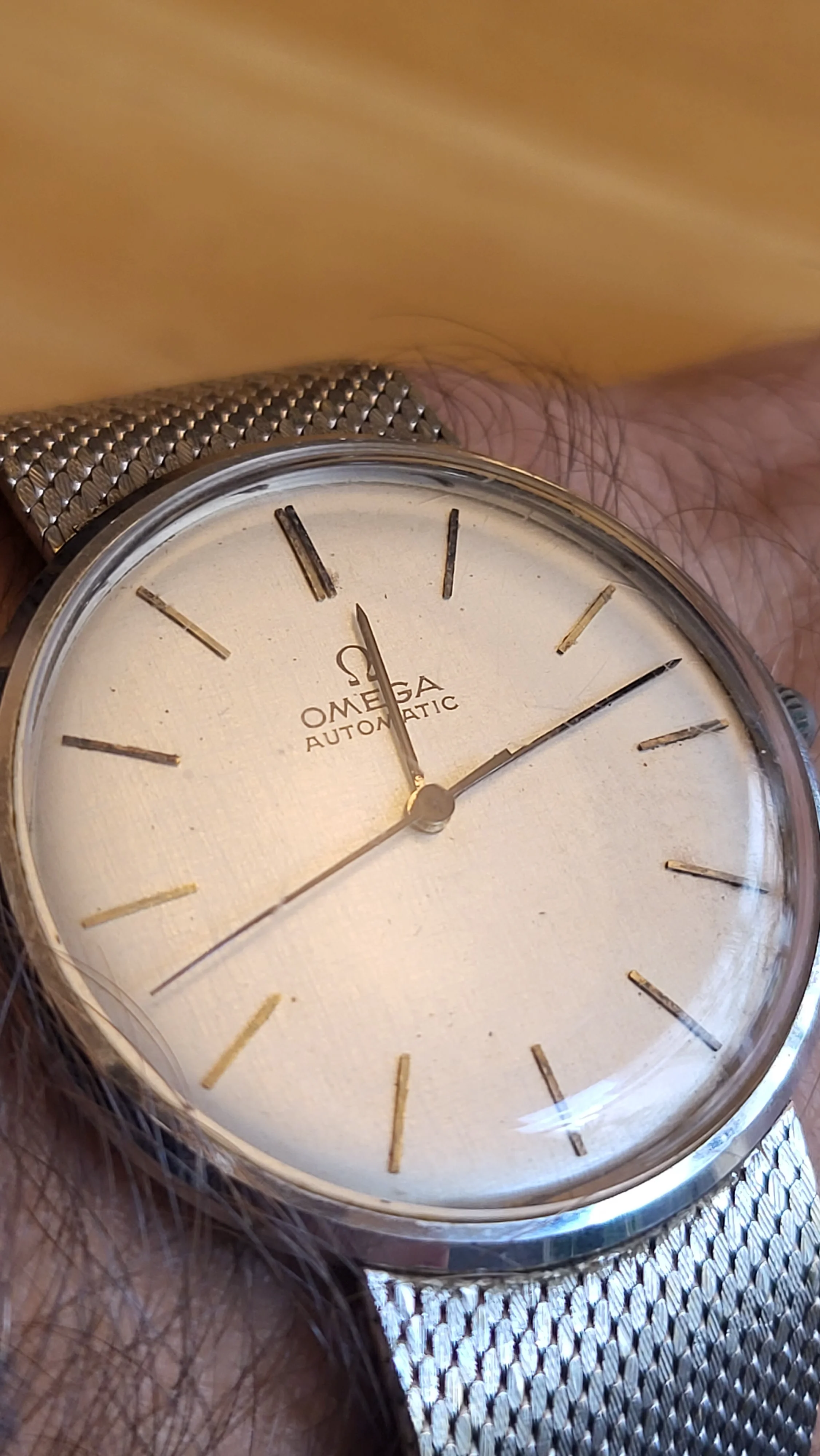

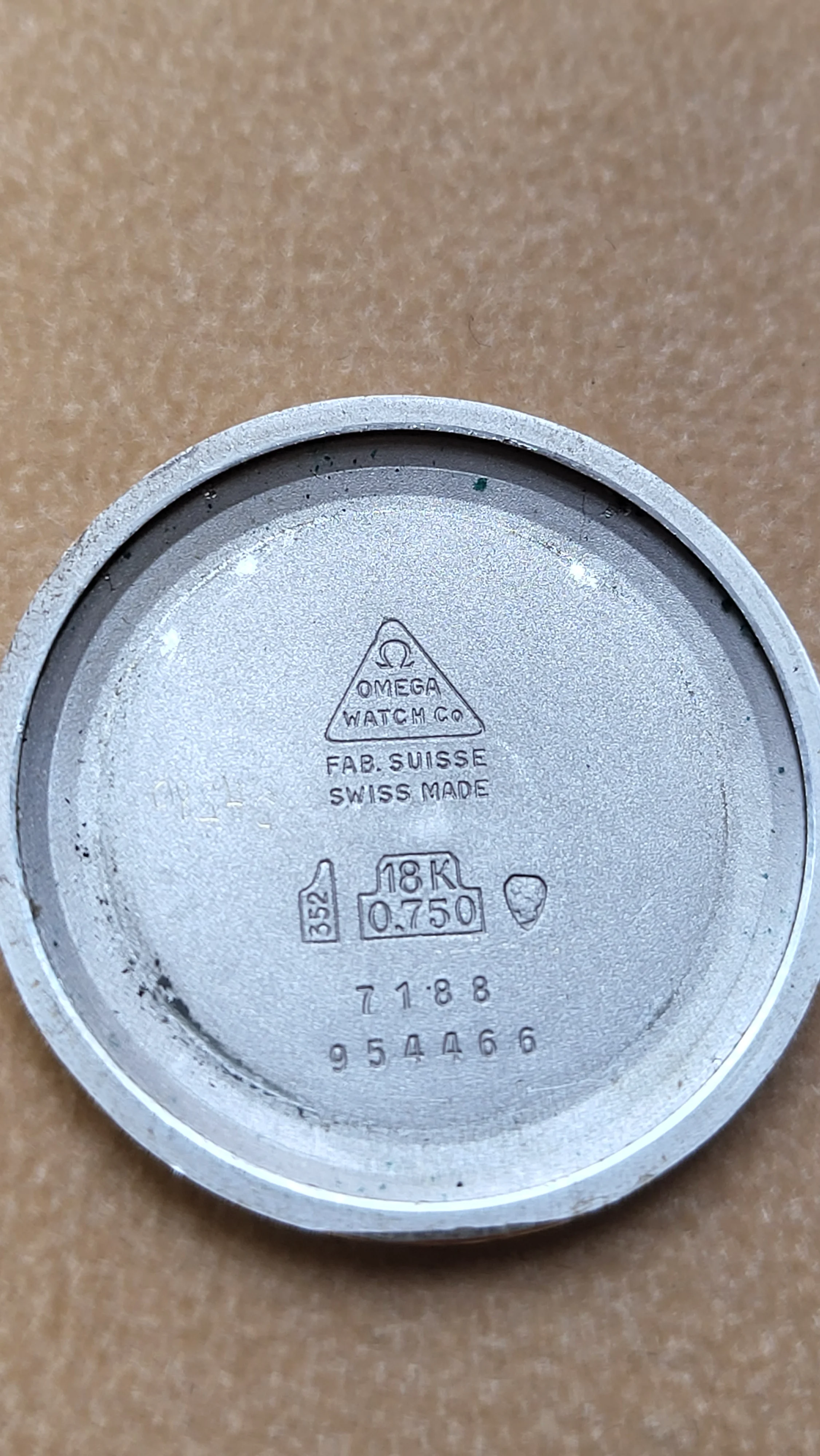

I bought this watch from a lady who has it from her father, without knowing something about the timepiece. Nothing on the internet. It tested positive for gold. But I'm not sure if it's white gold or yellow gold Rhodium plated. Why anyone will plate yellow gold???
I'm not sure if it's original.
Do anybody knows something about this watch?
Ref 7188 with Cal. 711.
I was thinking to go to an Omega shop.
Thank you in advance.

It's a genuine Omega, although not marked this model was also sold as a De Ville.
The case was made for Omega by Serva S.A. of La Chaux-De-Fonds.
The case may be Rhodium plated (see yellow mark on the case opposite the crown).
Movement looks very dirty and may be missing a case clamp and screw.
Rotor bearing/bushing is worn allowing the rotor to wobble and touch the caseback.
It needs to be serviced.
An independent watchmaker with an Omage parts account would be a better choice rather than sending it to an Omega service centre.

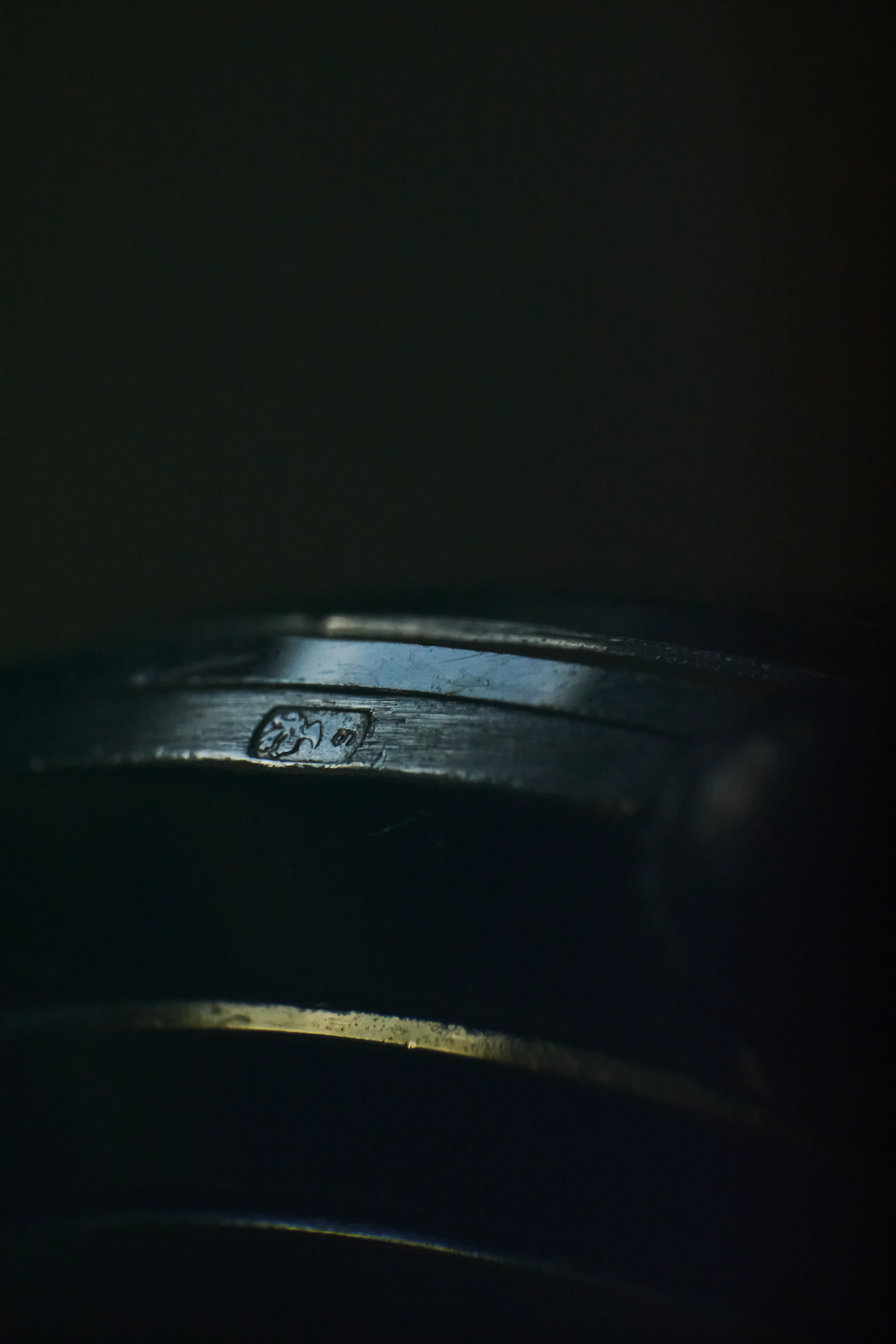

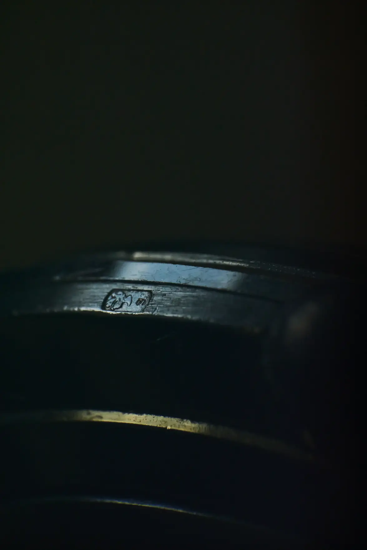

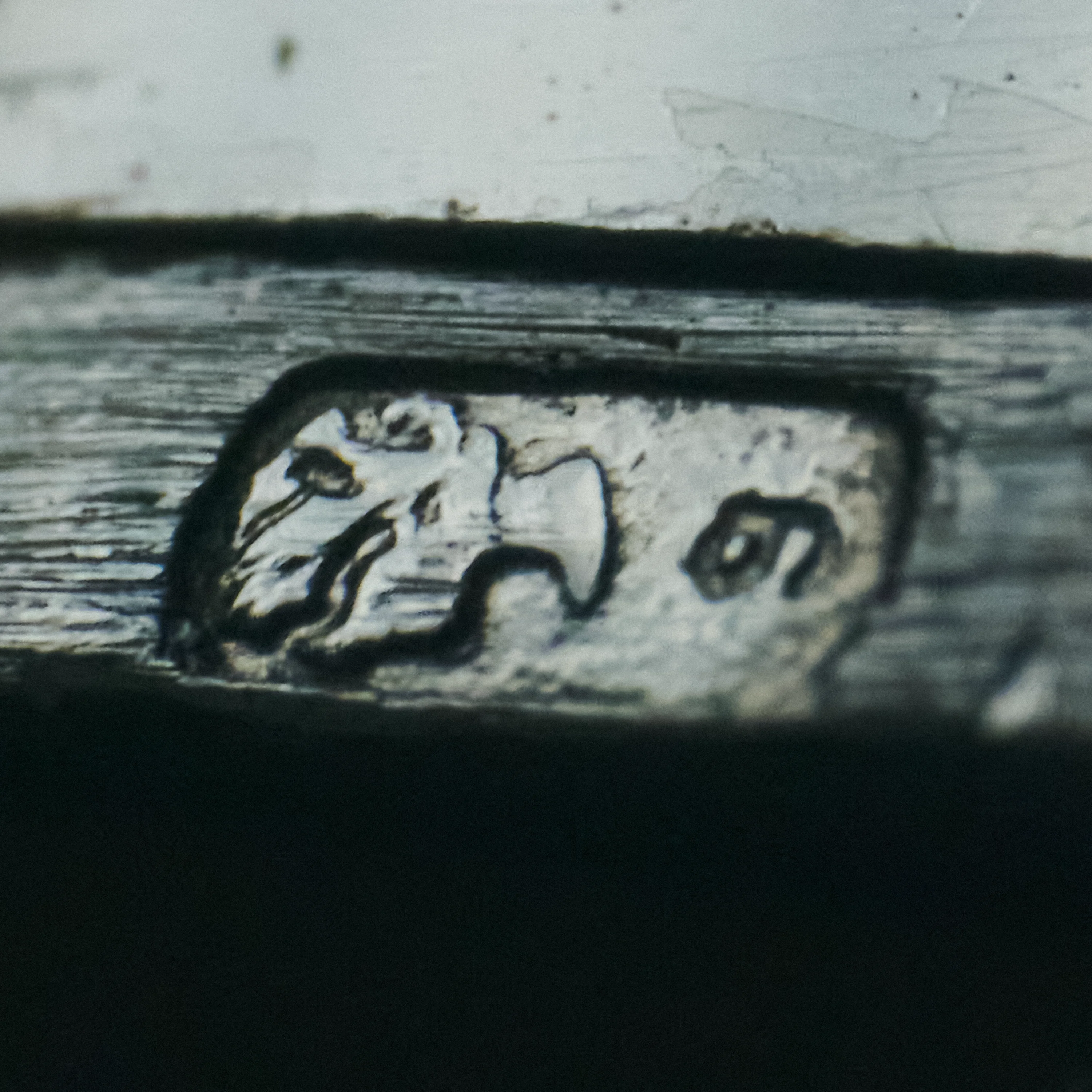

Here is the small mark near the Crown. It's the Helvetia head.
