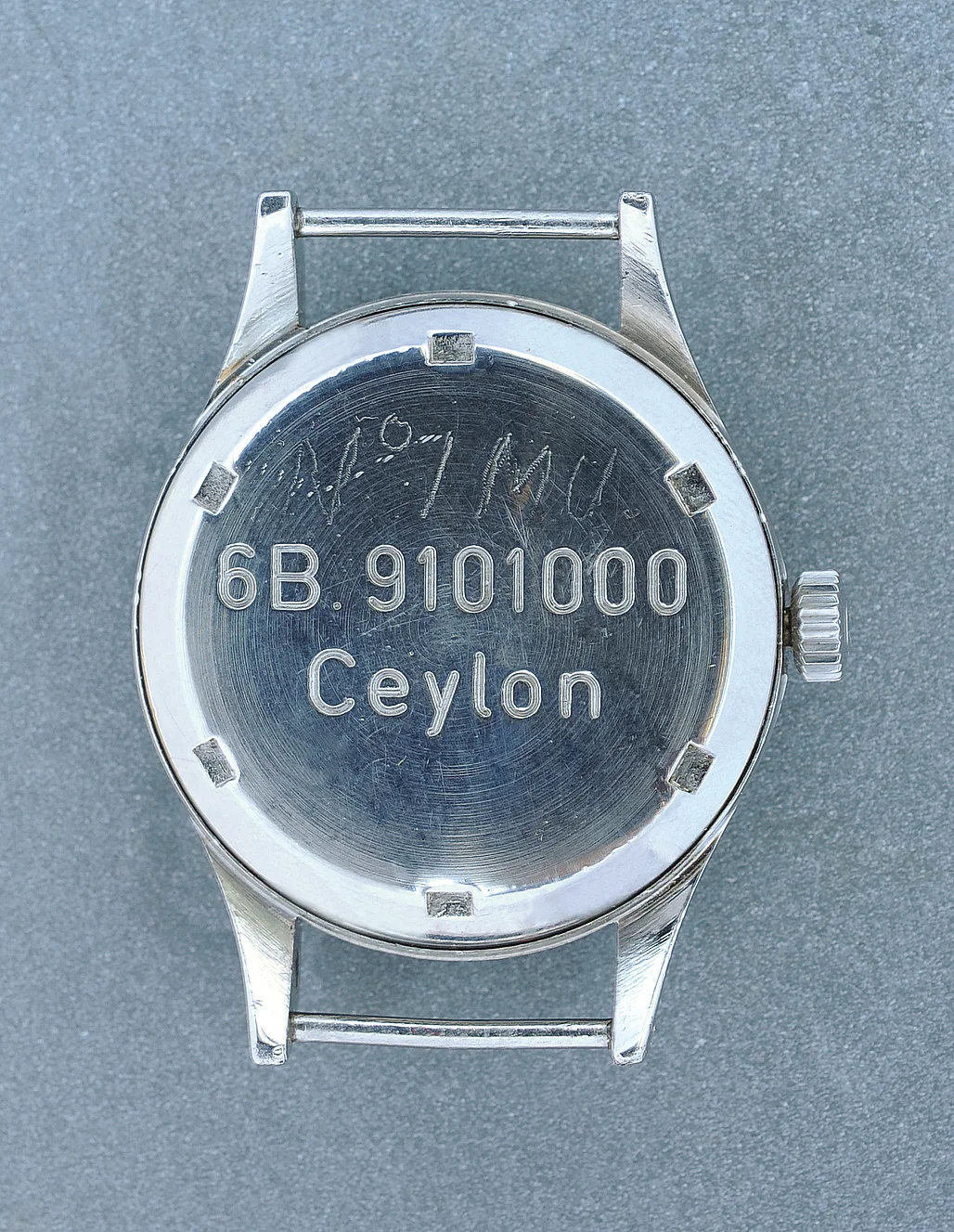

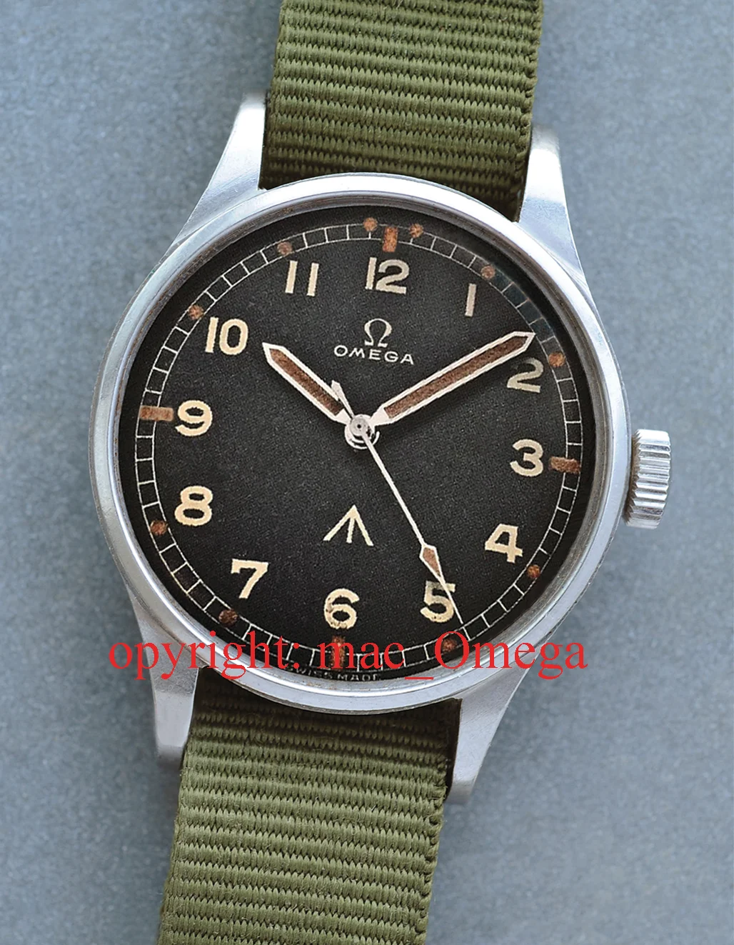

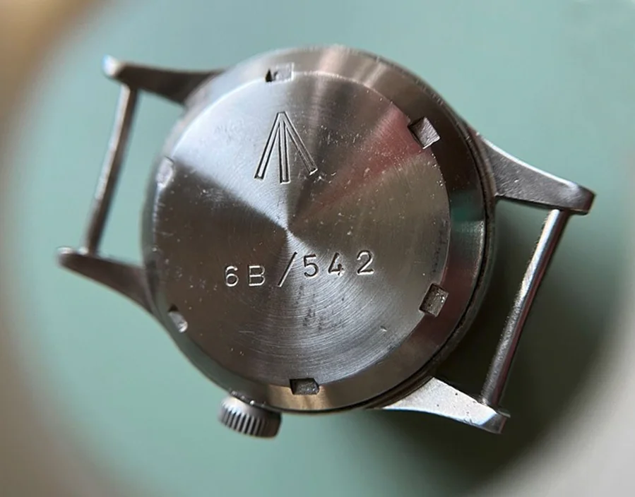

61. OMEGA antimagnetic “RAF” watch, 1953: Model specially designed for the Royal Air Force equipped with chronometer calibre 30 SC T3 - 283, protected by a double case made
· outside of a water-resistant Staybrite stainless steel case with back screw-in on a lead gasket and
· inside of a calotte, a casing ring and a dial (1 mm thick vs. 0.4 mm for a standard dial) in mumetal - or soft iron - forming a screen against magnetic fields up to more than 900 Oersted in any position, instead of 60 for an ordinary antimagnetic watch!
Special paper disk between case and calotte. Matt black oxidised dial with the British army's typical “Broad Arrow” at 6 o'clock, radium skeleton stick hands and hour markers, back engraved with a registration number 6645 101000, 6S/542/53 (6645 being the NATO code and /53 the year in which the order was placed) and the same characteristic arrow as on the dial at 6 o'clock, soldered attachment pieces. 5900 pieces produced. (CK 2777).
