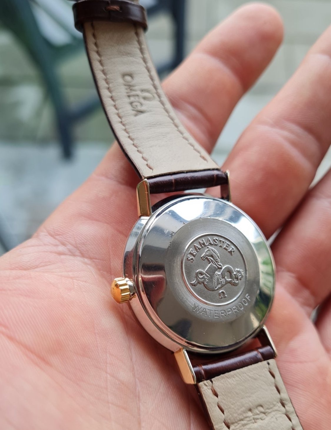

Any movement photos? Caseback photos?

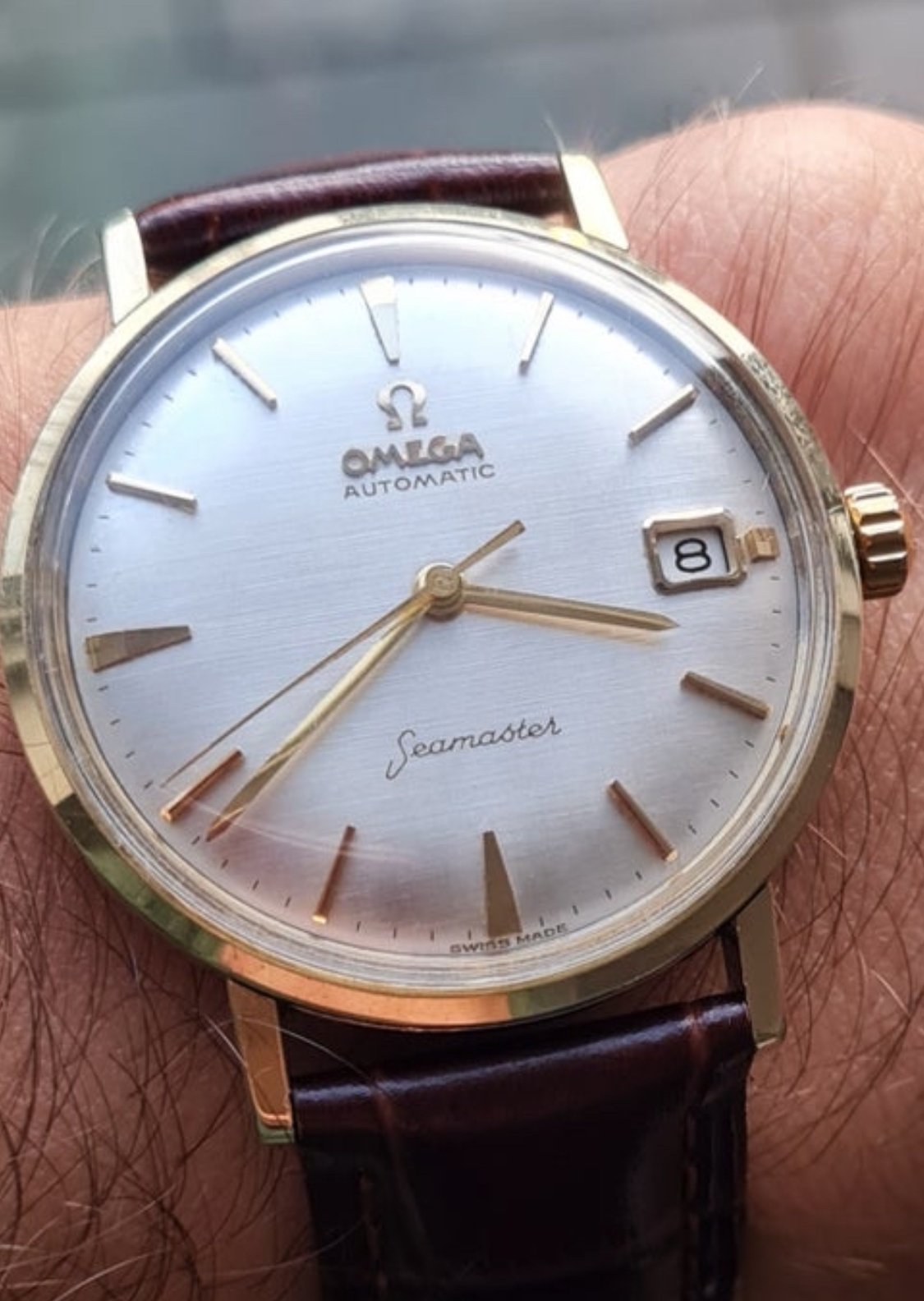

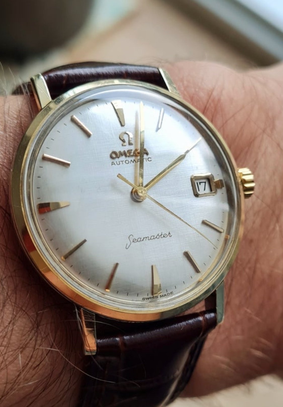

Nothing jumps out to indicate a redial. But the price does not seem like a bargain.

What is the case material? The dial looks good, but also the price isn't that fantastic.

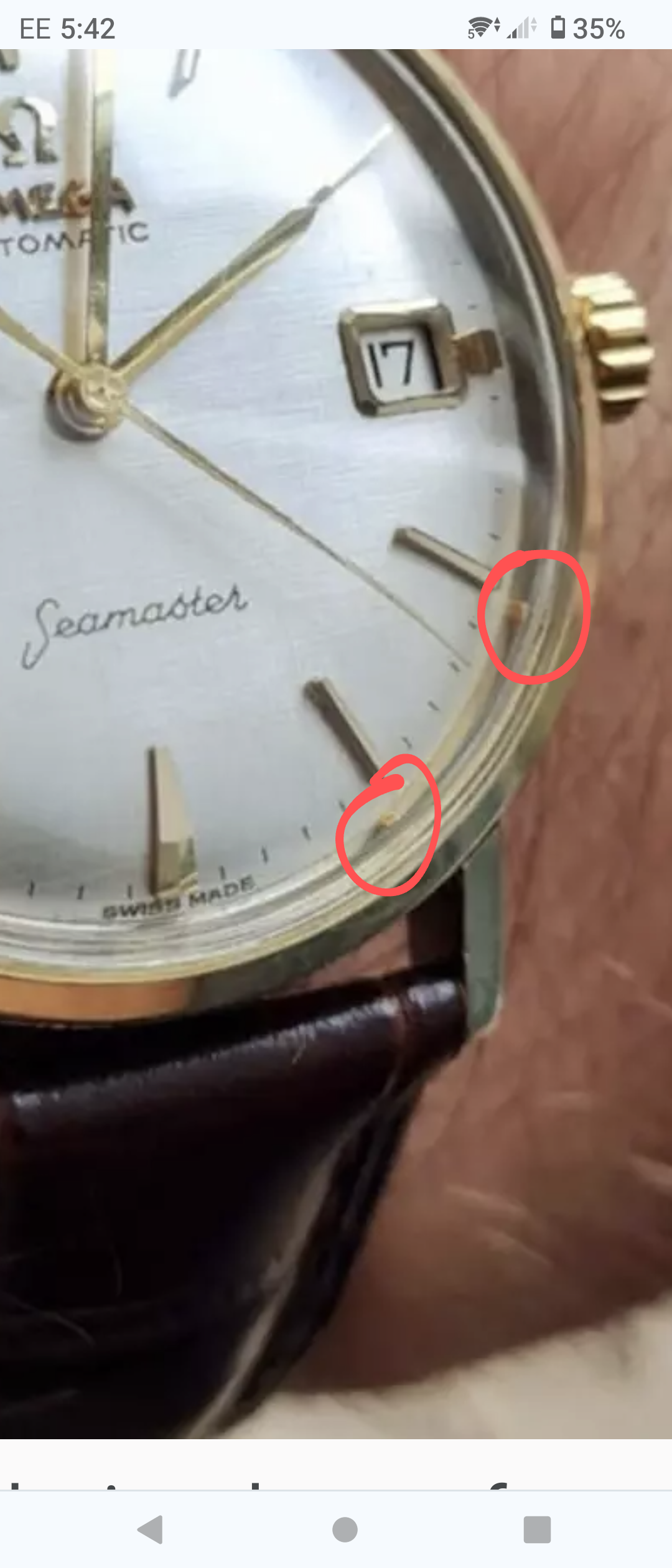

What are these bits fallen off the dial ??
Those appear to be reflections on the tension ring.

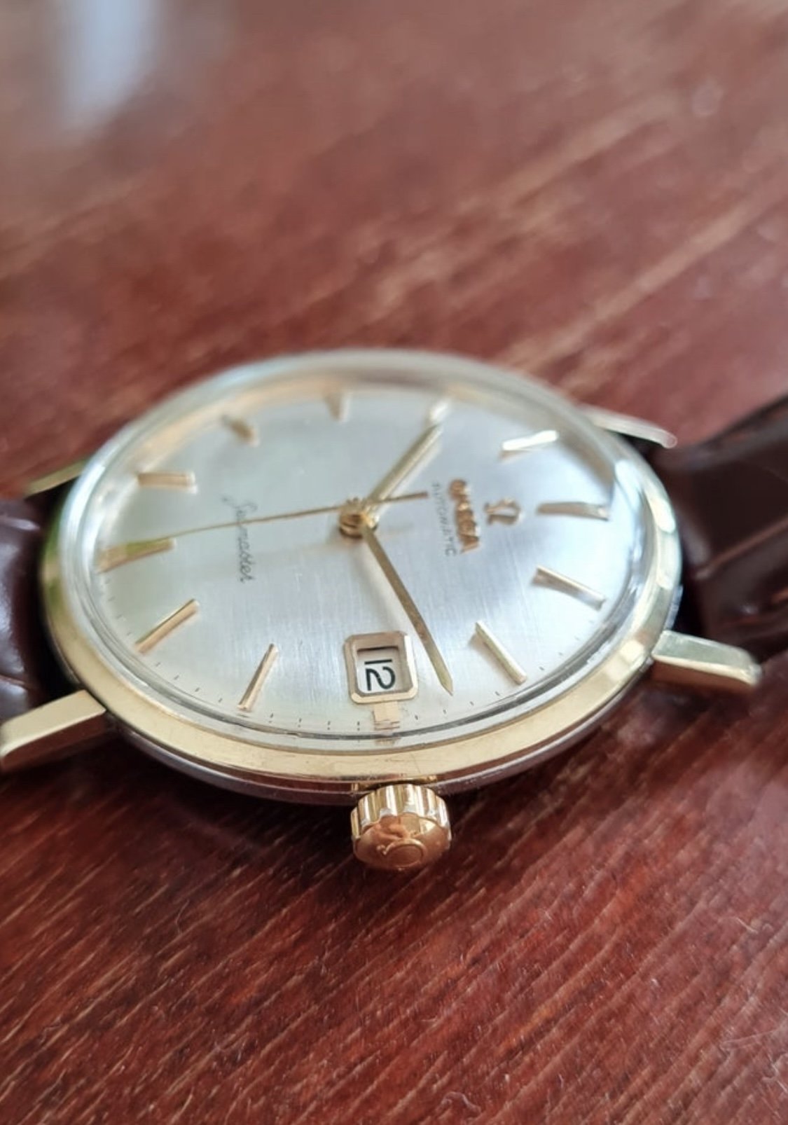

Does look like it's got the original crystal I think I can see the engraving on the first picture

No movement photos available at this moment
For 1300 clams you should insist on a few well-lit, clearly-focused movement and inside caseback pictures. You want to make sure that the movement hasn't been swapped out (that is, that the movement serial is in the correct range for a watch from 1961 and is the the expected caliber), that the movement is clean and the regulator is in a neutral position (which it should be, after a service), and that the caseback is correct.
