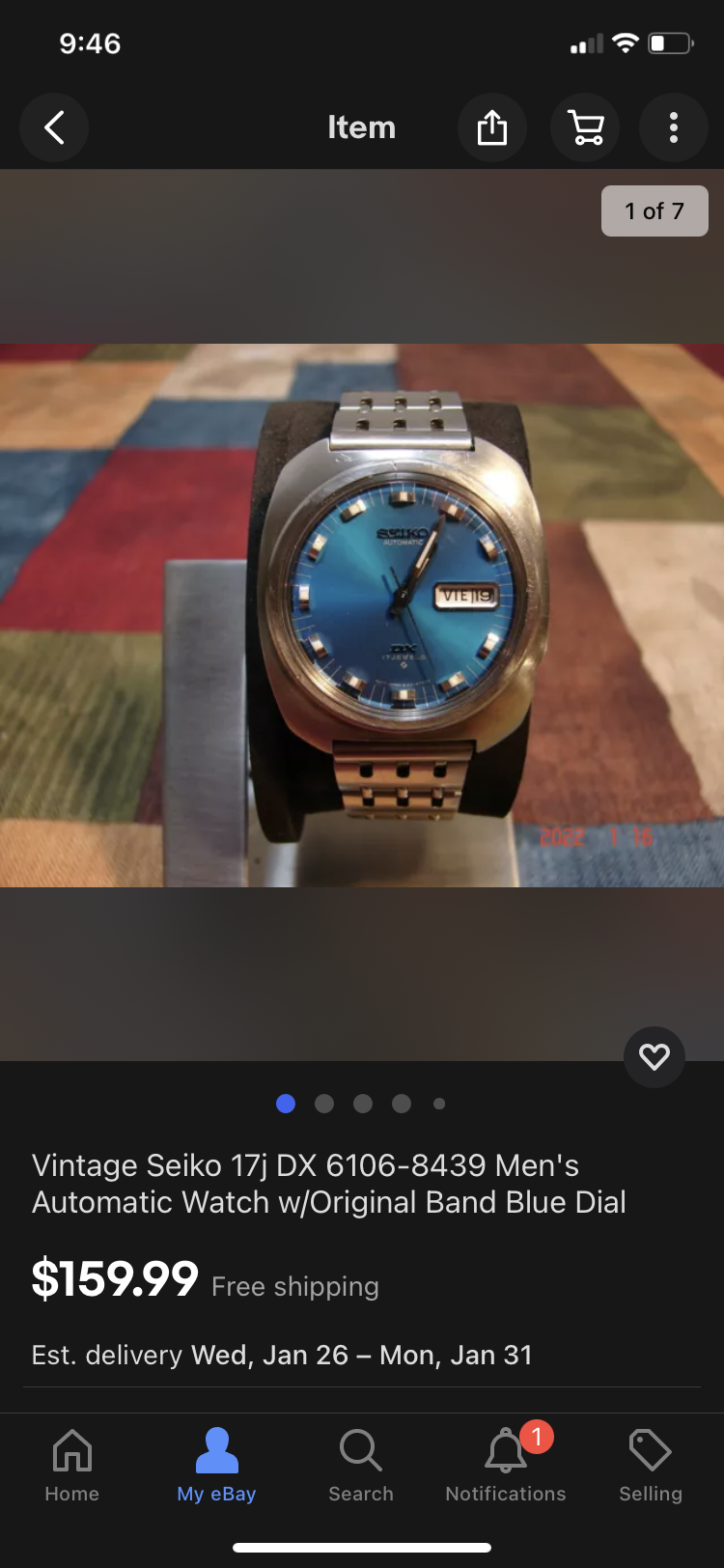

Early 70’s Seiko’s with stainless cushion case and bright electric blue dial! This thing is like a beacon of joy! Seller says running and bracelet fits his “average” wrist. Fun looking watch for $160.

That electric blue dial is mesmerising 🥰
I'd be very tempted to buy it if I didn't already have a blue dial Seiko on its way to me.

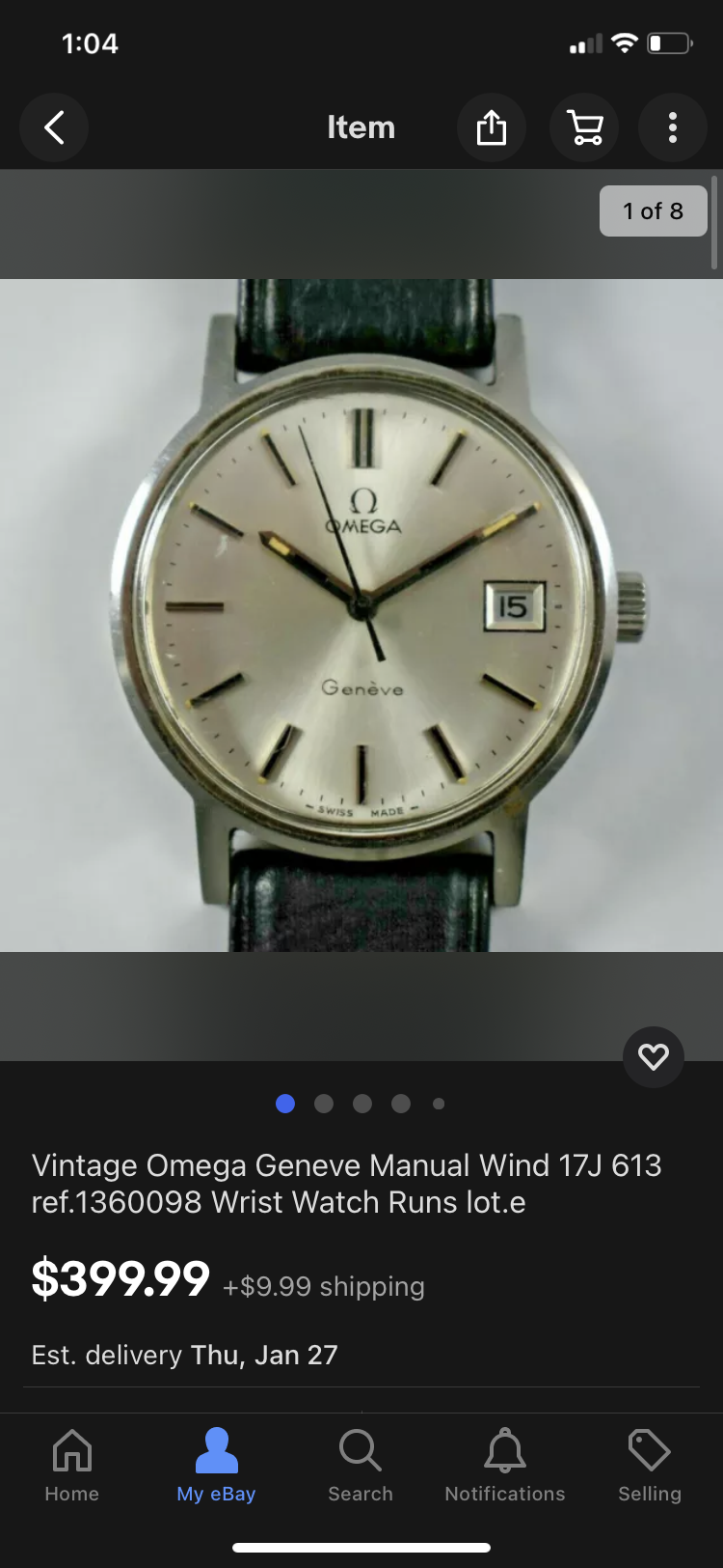

Very nice Omega Geneve with sharp stainless case, lovely dial and nice bright yellow lume.
This isn’t a particular noteworthy model, but it’s got a lovely sunburst silver dial and looks to be in great shape (although need a good cleaning with a damp rag-yuk). If you don’t want to hunt around for a nice 35mm Omega, this should do it.

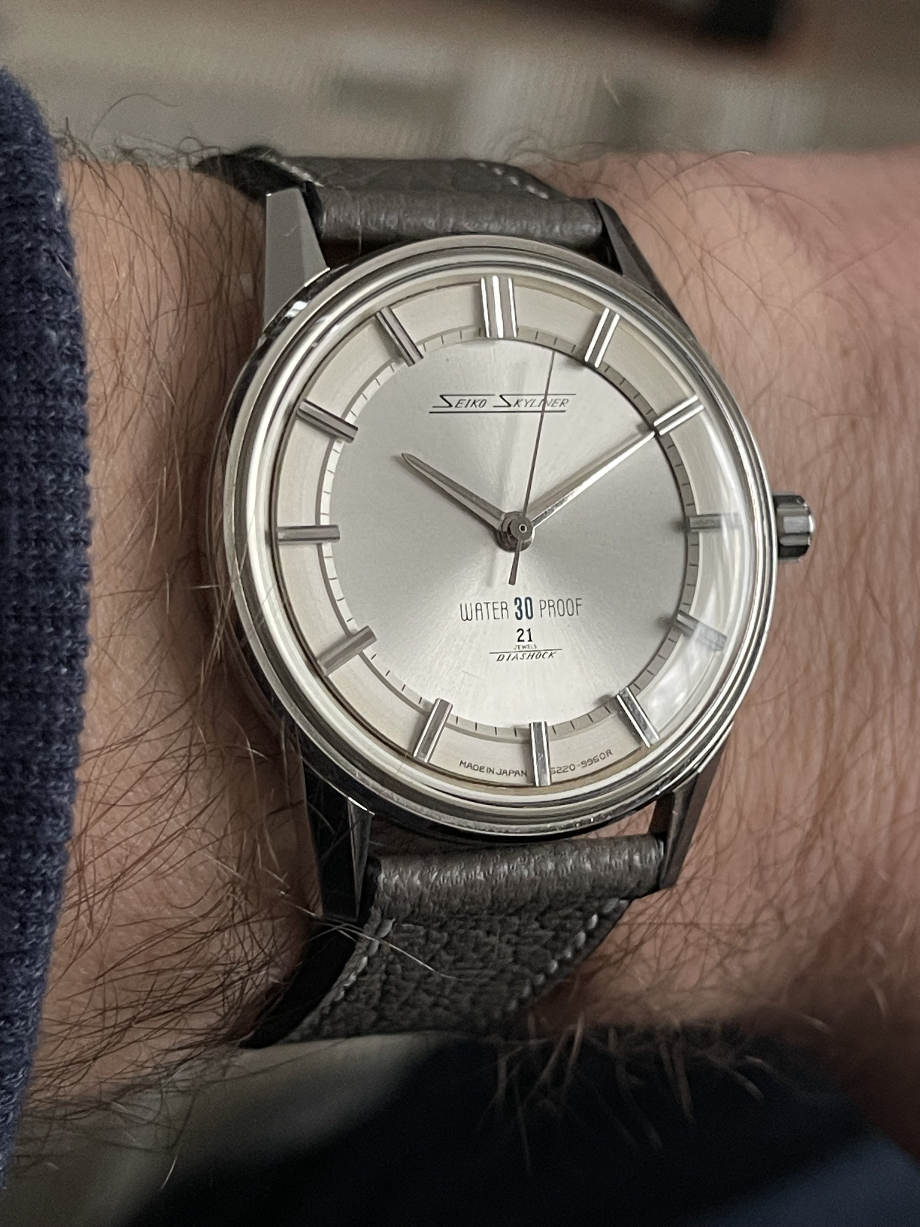

Inspired by the Skyliner upthread I couldn't resist one that came up locally. Mine is a bit earlier than that one it appears, as it has the older caseback type without the precise date. Thanks for the tip on this dial/model!
963
1,252

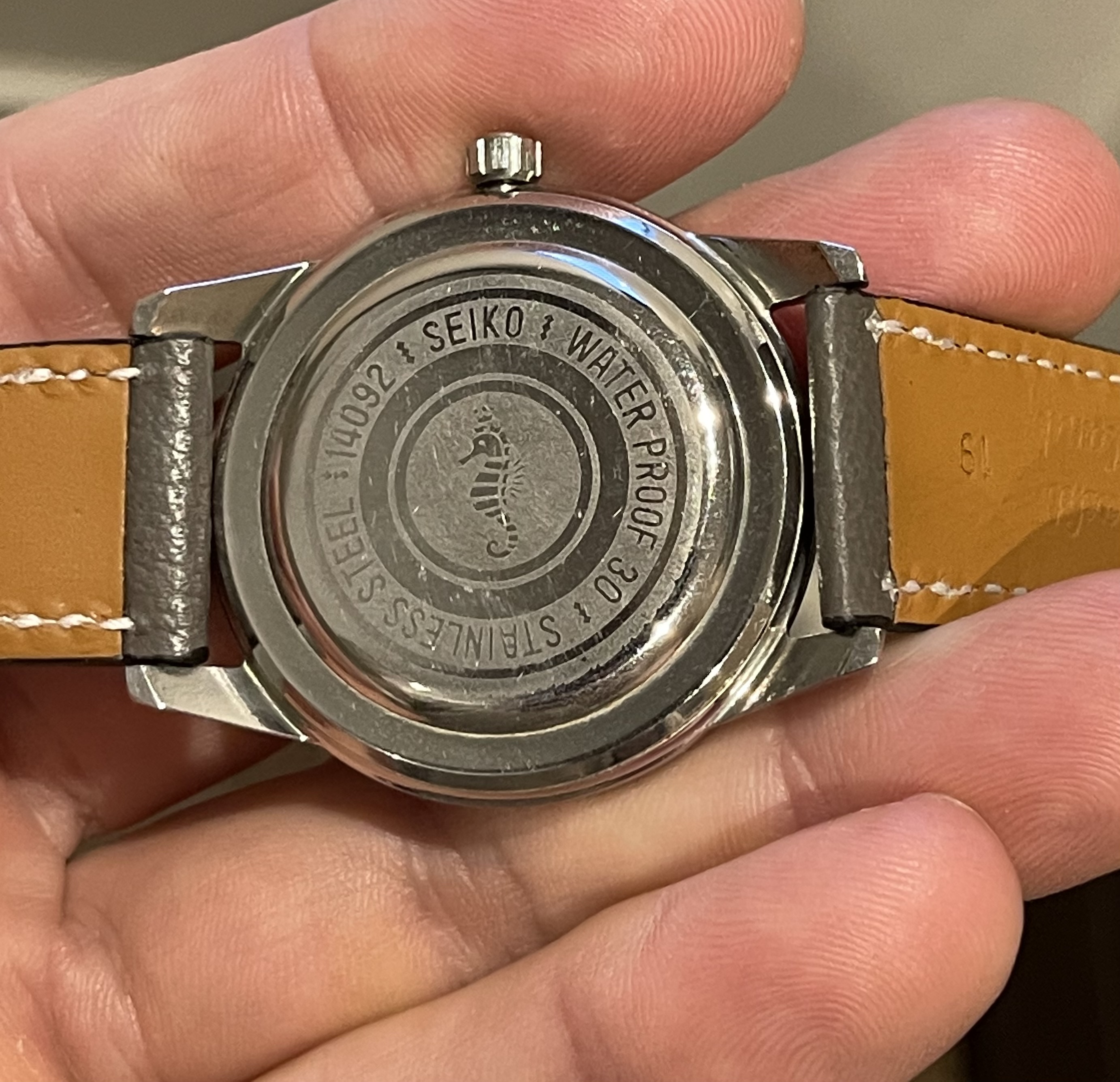

Dibs! Case back pic please?
Here you go. I note also that the hands on this model are fairly unique for classic period Seiko (rounded tips). I can think of one Seikomatic 39J with something similar, but little else.
16,305
45,025
That crowned seahorse needs to be someone’s avatar
