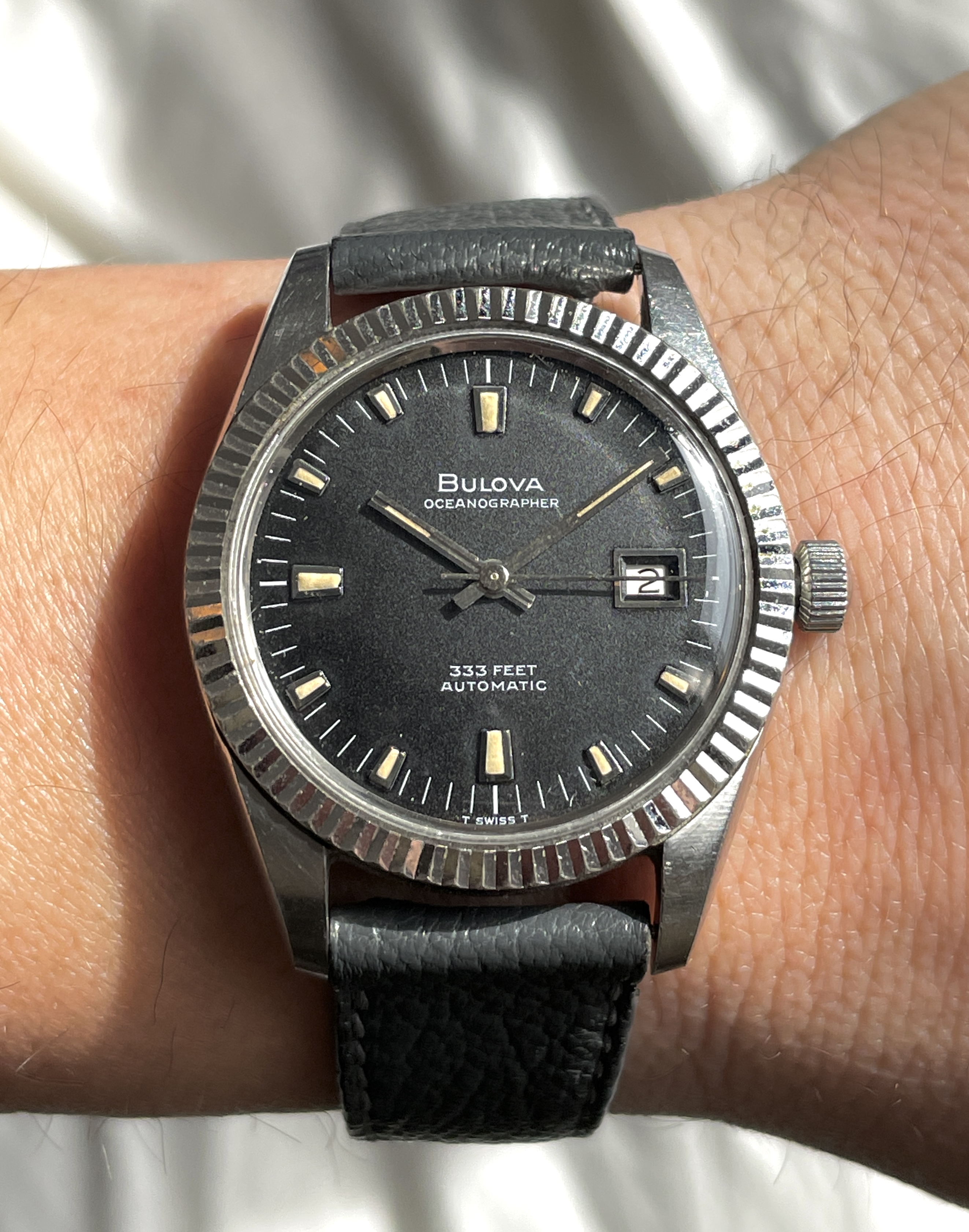

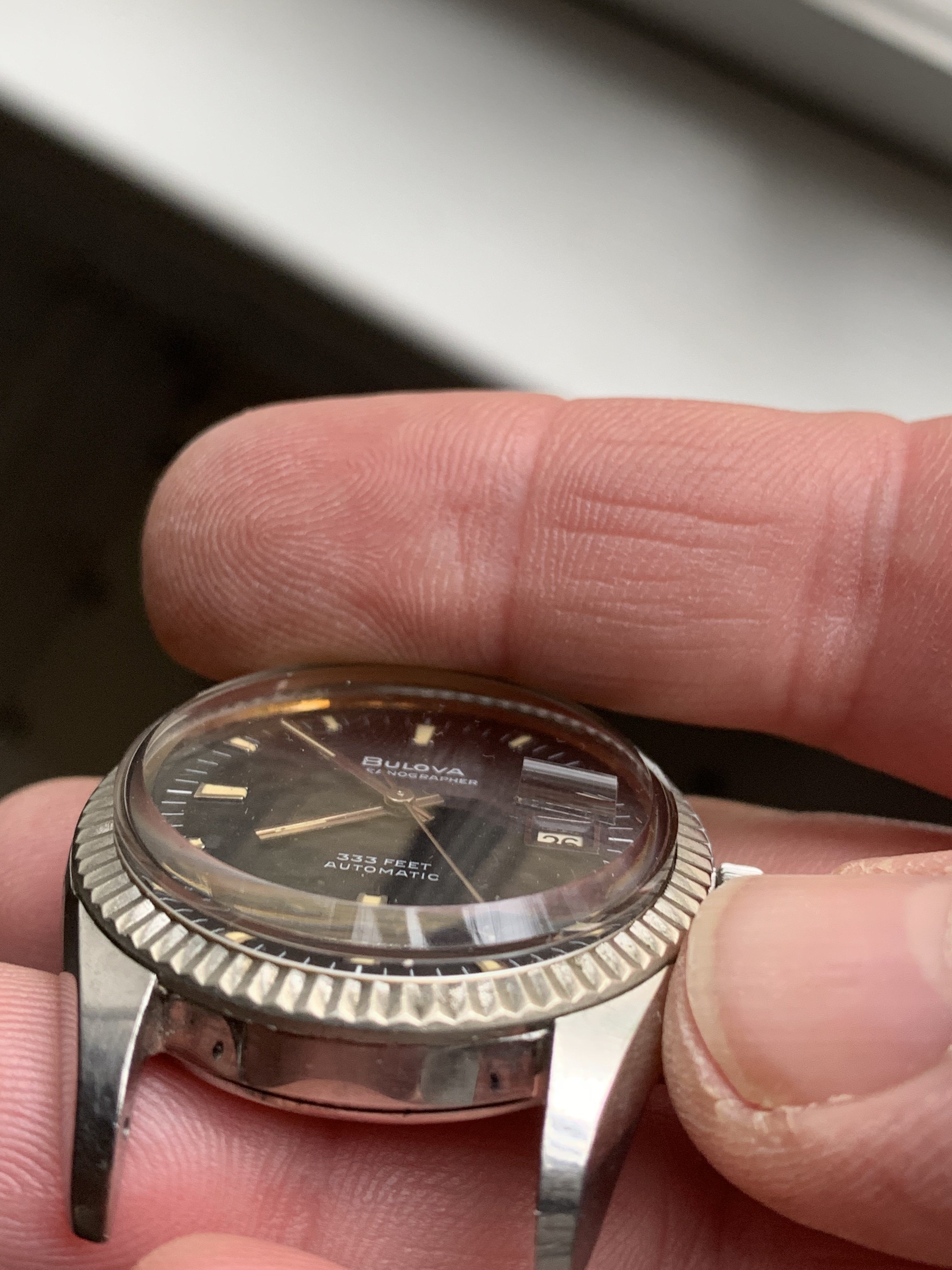

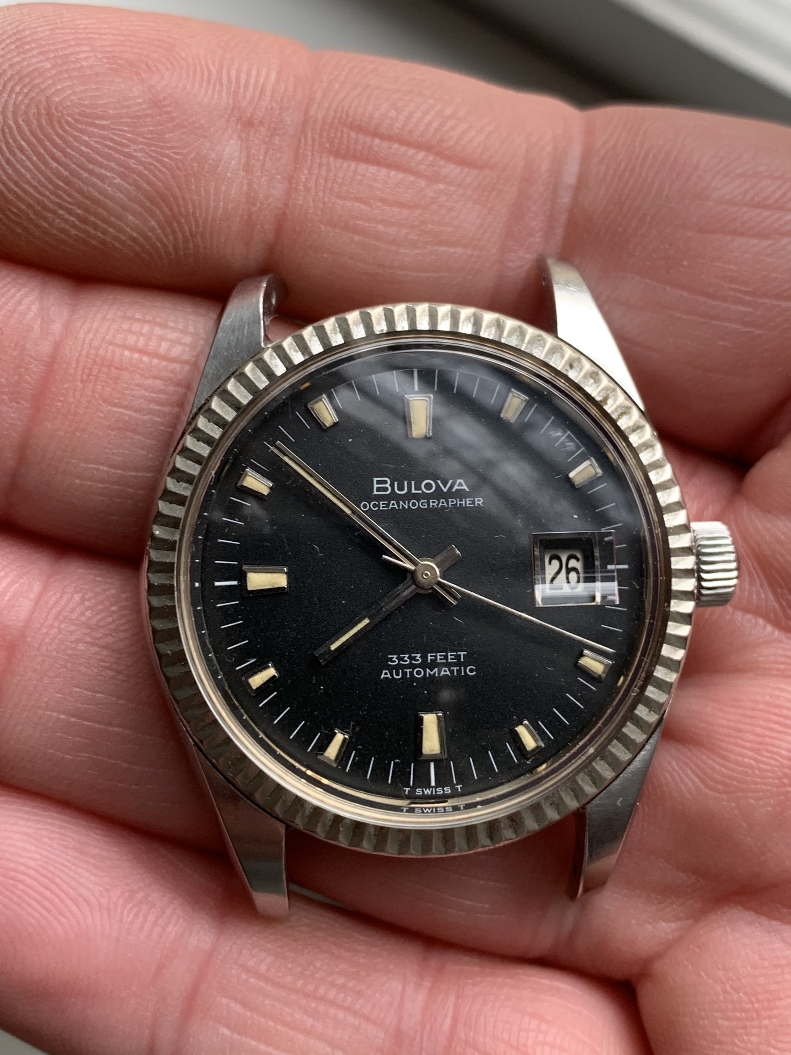

Bargain cautionary tale- always scrutinize the photos…more than once.
This popped up last week and I made an offer- and it got accepted!
I already own one and have a parts watch as well, but the dial on this one is flawless, so had to have it.

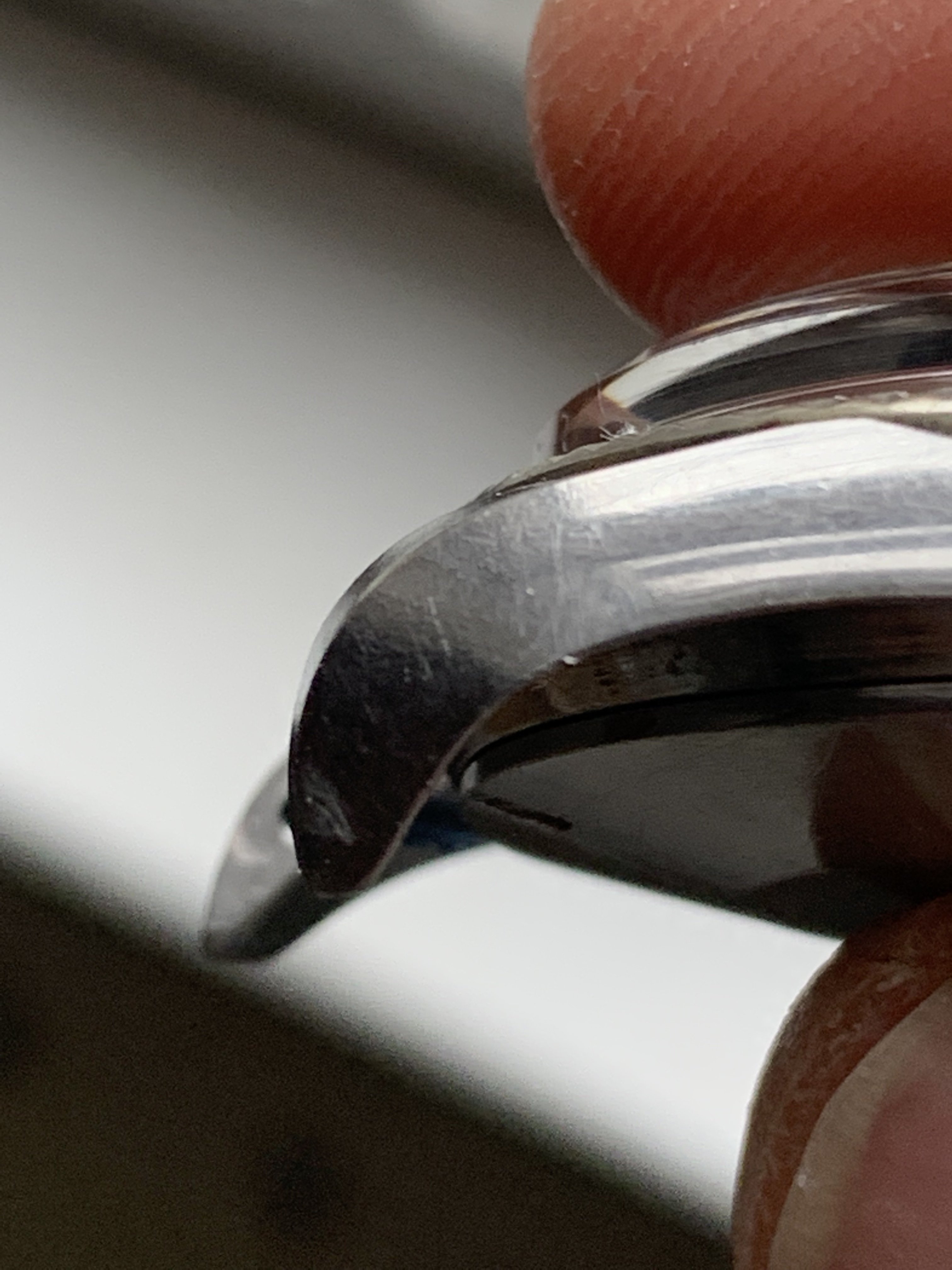

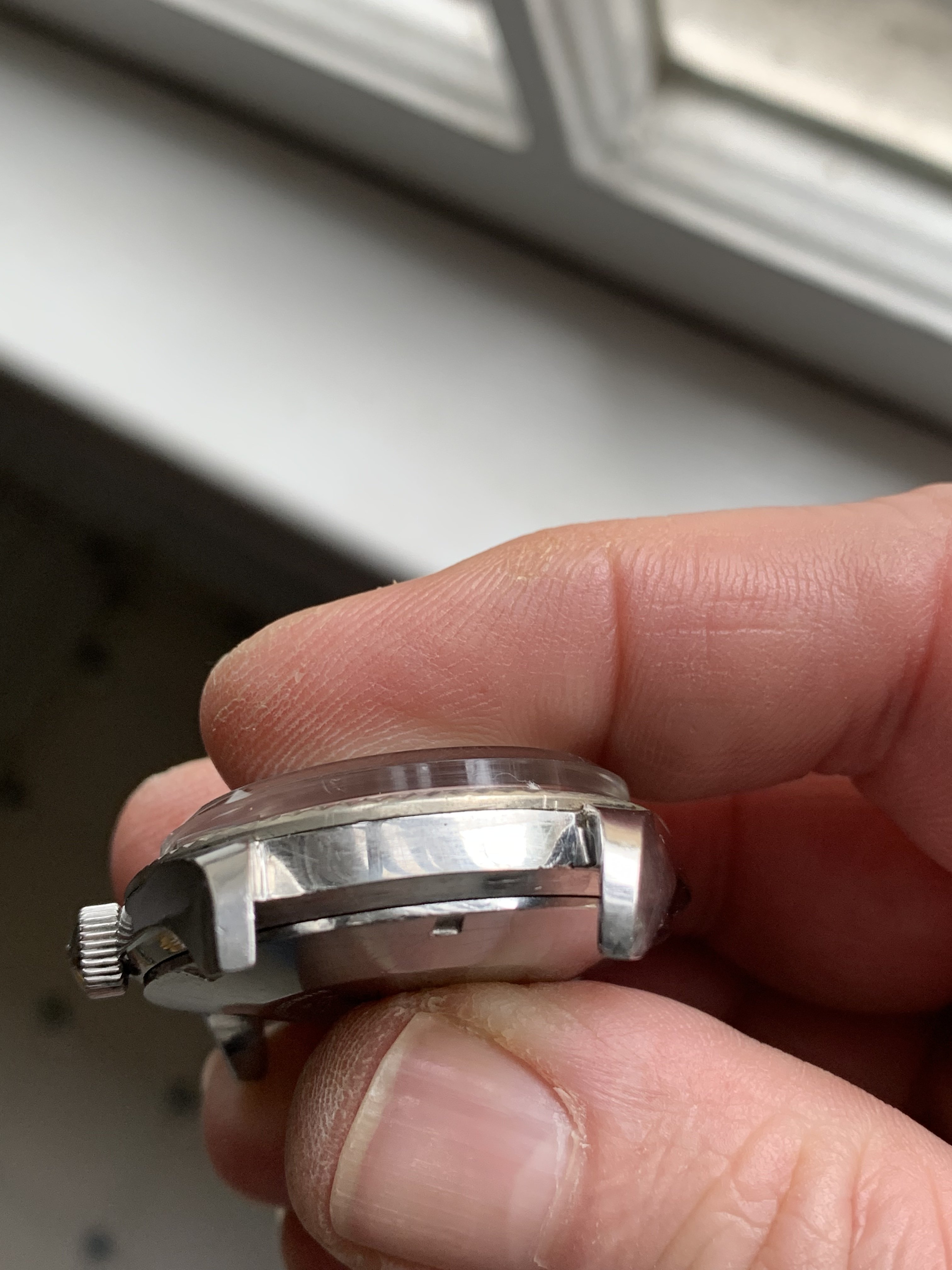

It arrived today and I excitedly opened the box- and was thrilled to see the original crown, original finishes on the case and a very clean faceted crystal with magnifier- I hadn’t seen that before!

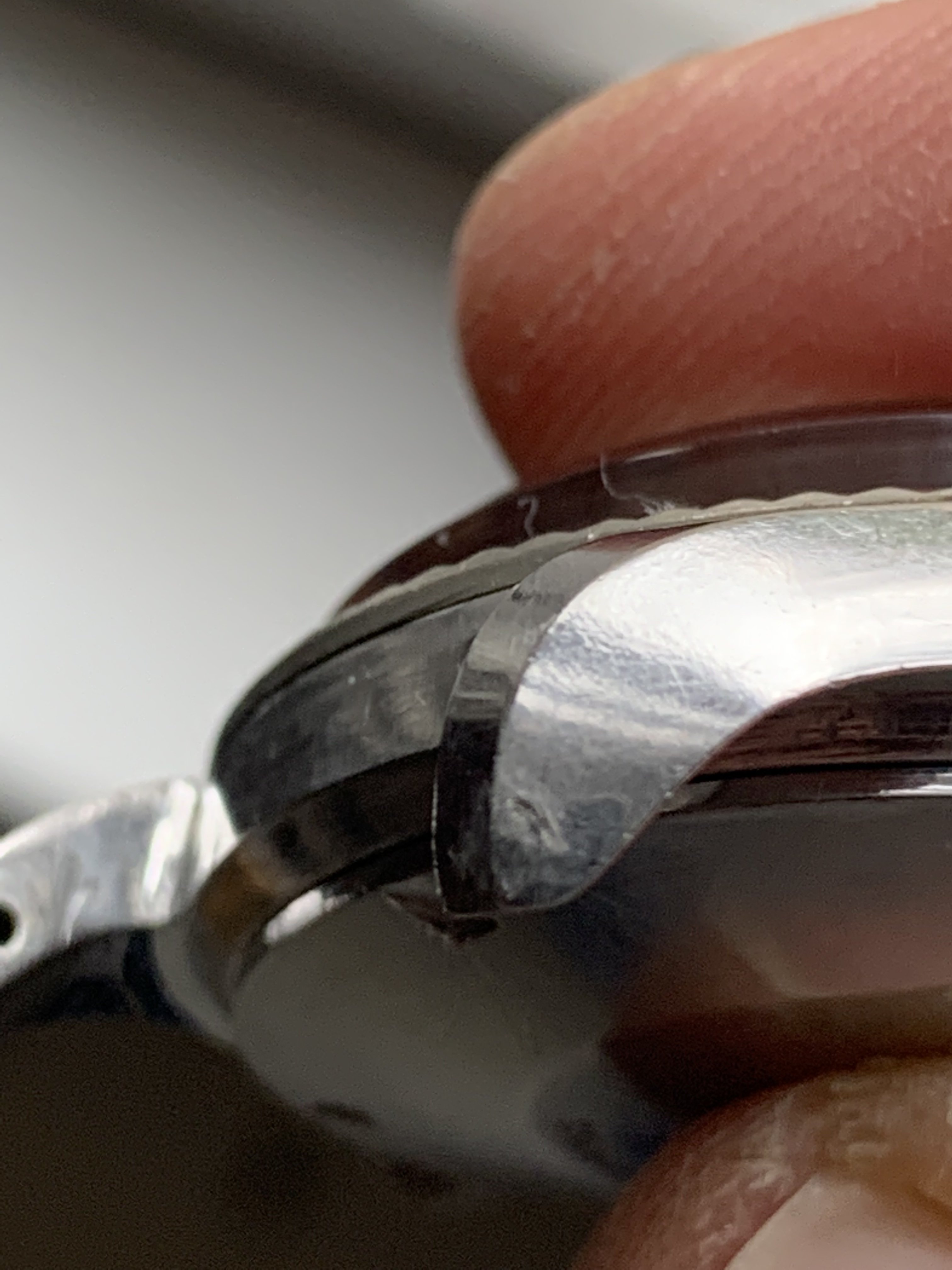

But then I saw it…oh no…
That’s a bad bend in that lug….ugh!!
Luckily I have a nice spare case so I can do a swap if an attempt at straitening it fails. But sometimes we can’t see (or are so excited we overlook) these things in photos on eBay.

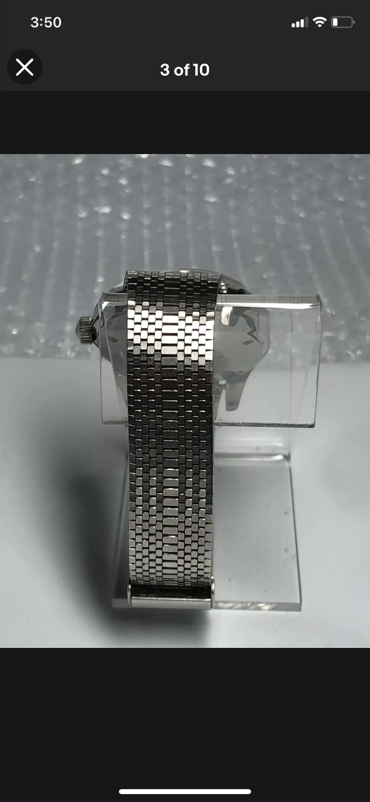

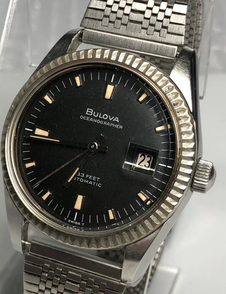

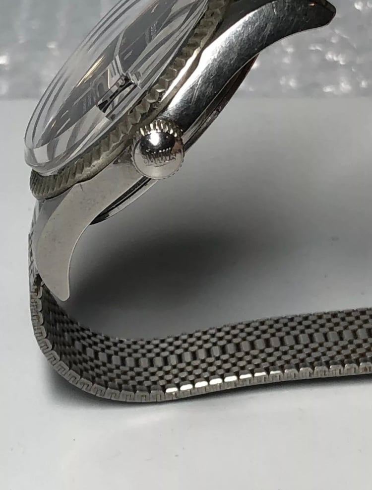

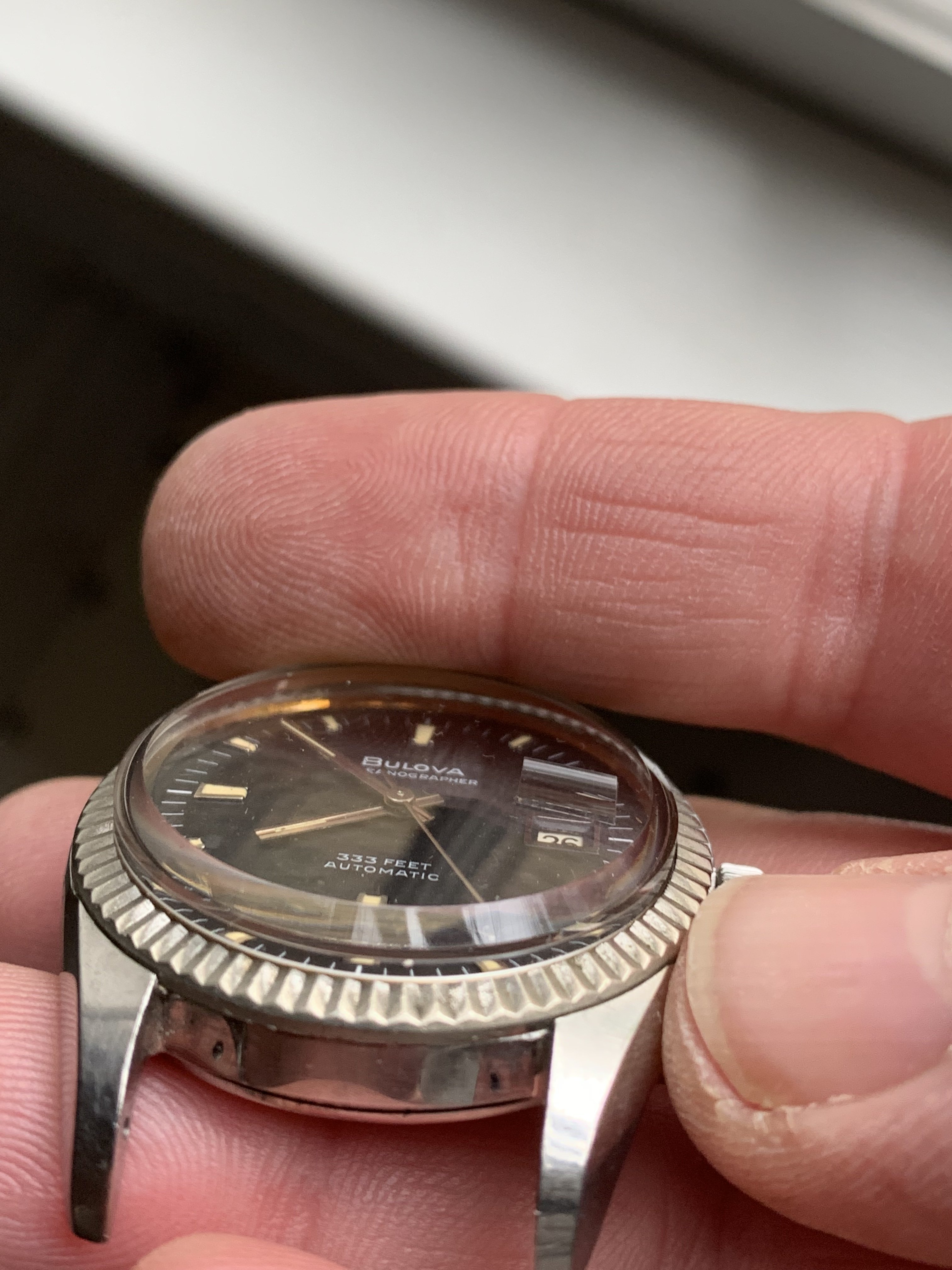

I went back and rechecked the listing photos.

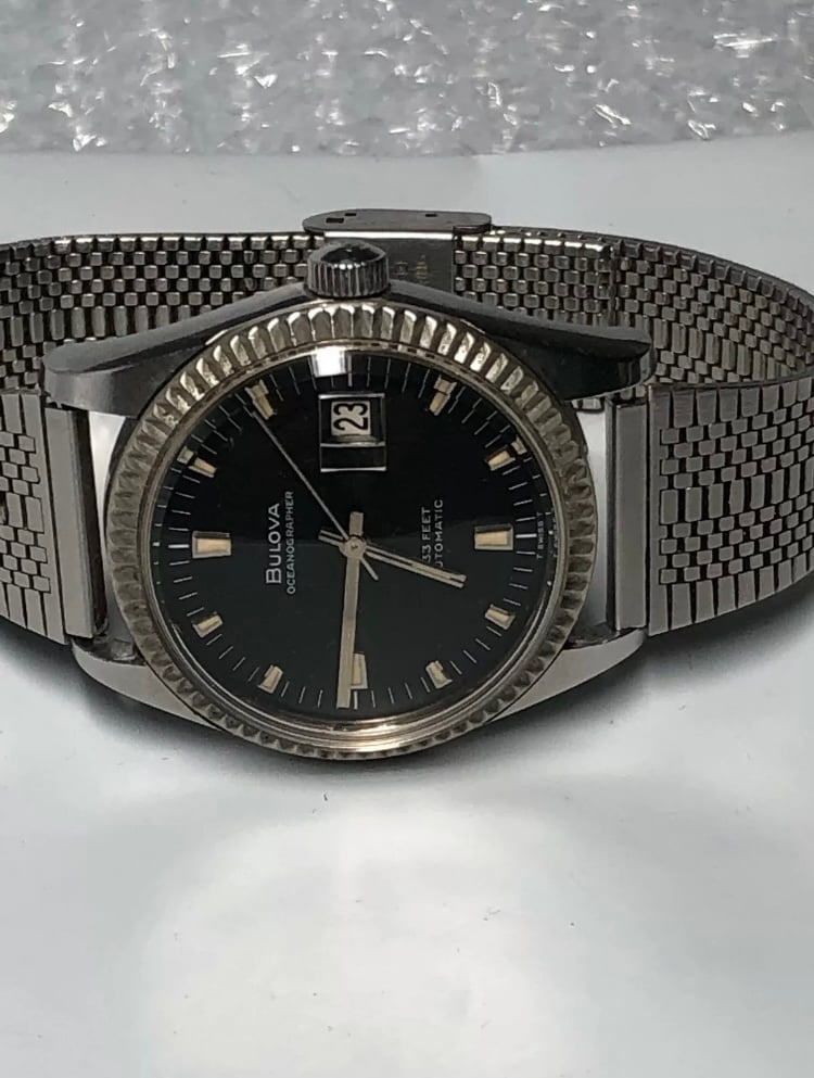

It’s the 11 o-clock lug…looks ok here, that bracelet really hides it
Of course nothing to see here
This looks ok…but wait!
There it is.
Unless I knew what I was looking for, I would have missed it in that shot- in fact I did.
If I didn’t have a spare case, I would be sending this back- sadly too as I have never seen this variant of an OC333 look this good.
Always good to have spare parts…that may be the second take-away from this.

I'd have thought with something that obvious the seller would have mentioned it. Not doing so seems, IMO, intentionally misrepresenting the condition and hoping a buyer wouldn't notice. No way would I have spotted that without knowing what to look for.
16,305
45,025
I would tend to agree with you. But with the bracelet on it, it was hard to tell. Getting it off proved a challenge (I realize why in hindsight), and once I got it off I realized the issue.
As I had said, if I didn’t have the extra case, I would have returned this due to the damaged lug- it’s beyond fixing. But since the dial is spectacular and it’s running incredibly well, I have the luxury of keeping it.
The crystal is also not original to the watch, but I had luckily saved the listing for a NOS factory replacement on eBay when I got my last one (crystal on that cleaned up well), so just dropped another $50 on that. In for a penny, in for a pound!🙄🤨

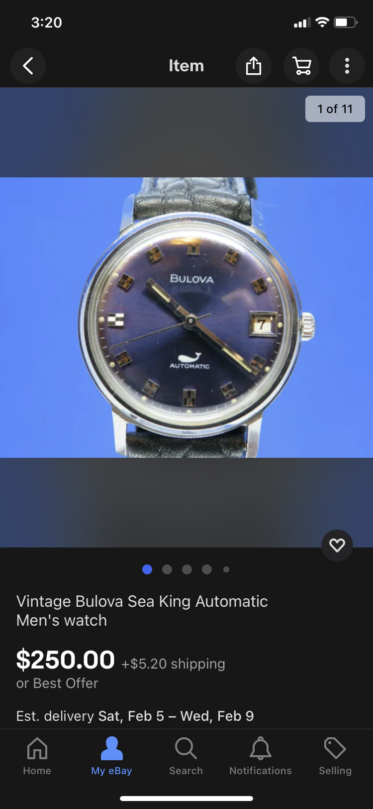

1970 Stainless Bulova Sea King (seller says 33mm but I’ve seen these more around 34mm) with stunning blue dial, bright puffy yellow lume, faceted indices for that little bit of bling and wait for it….WHALE DIAL!! Everyone loves the whale.
Asking is on the high side for one of these but as we all know, Bulova are highly undervalued for what they are and seller has make offer so may knock a few bucks off.

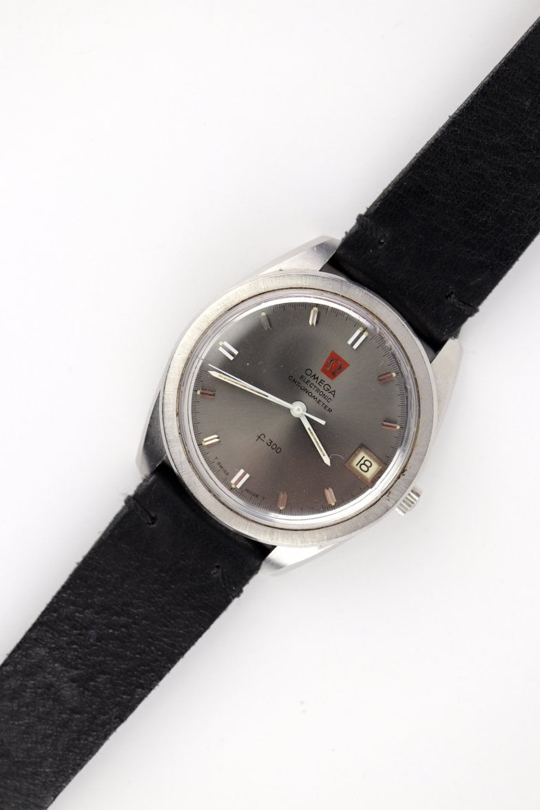

OF mega-bargain alert from our own @Toishome :
$150 for an Omega hummer. No the date doesn’t work, but it’s right once a month which is close enough these days. Get it fixed, live with it as is- who cares, this watch is awesome.
https://omegaforums.net/threads/omega-constellation-f300-ref-198-001-200.141409/
And the 18th is a good date as is, no need to get that fixed!
P.S. I've had a couple great transactions with @Toishome, excellent member of the community!

Yeah, he always has good values but he’s giving this one away for a token amount.

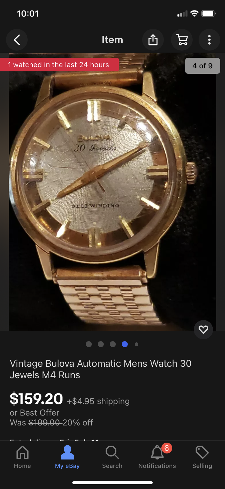

Is this you?
Then we got one for you- 1964 Bulova taking a solid shot at the Polerouter…and in true Bulova style- they knock it out of the park. Gold plating seems to be in decent shape (don’t see any wear-through) stepped dial is spectacular with spiral pattern and bright puffy lume. This is probably smallish at around 31-32mm, seller doesn’t specify, but it will gleam like a beacon on the wrist. Rip that flexi off and put it on some well deserved leather or suede and give the crystal a wet-sand to see that dial is all it’s glory. Seller has make offer so let’s see what he really wants for it.
https://www.ebay.com/itm/Vintage-Bu...=p2349624.m2548.l6249&mkrid=711-127632-2357-0

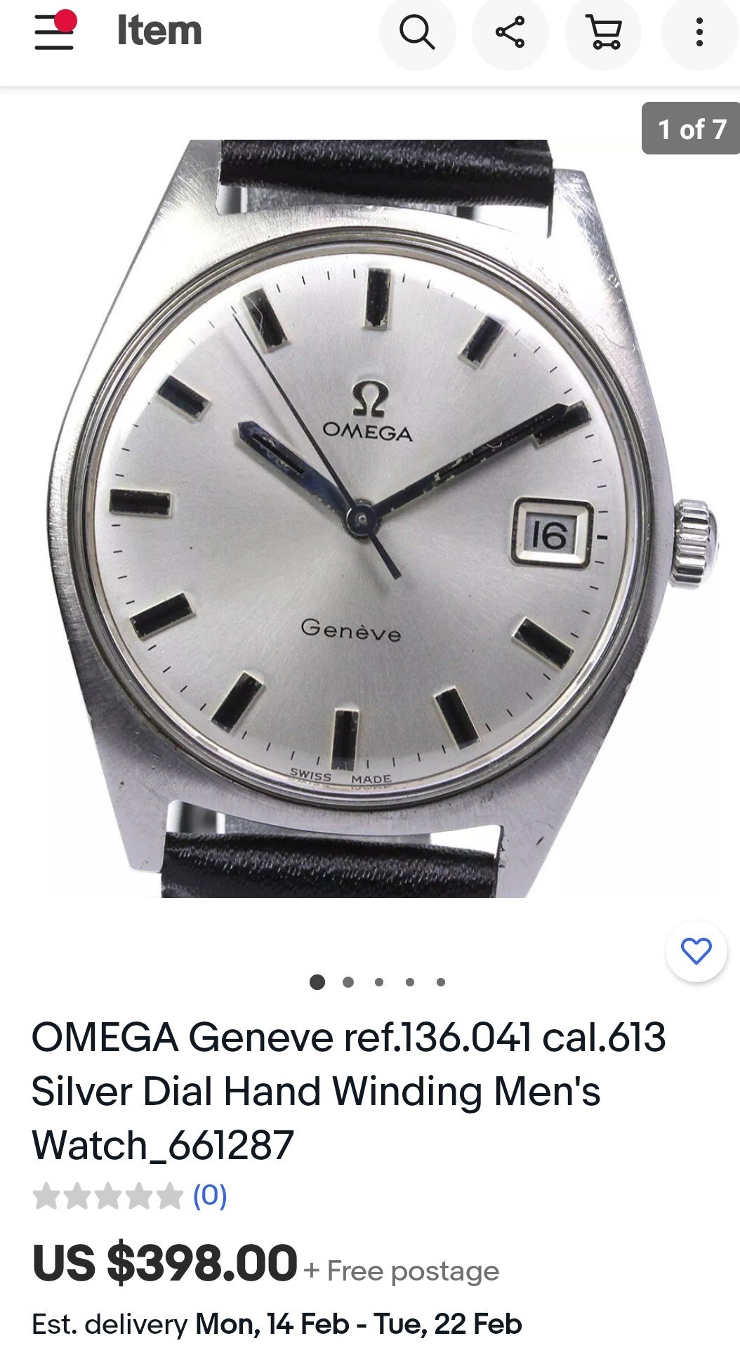

Nice manual wind Omega Geneve with classic 613 movement. Dial and case in good condition so great value below $400 Inc. delivery. If I didn't already have a similar piece I'd be tempted to buy this one https://www.ebay.com/itm/OMEGA-Gene...2349624.m46890.l49286&mkrid=711-127632-2357-0
This is a better shot of the dial
Well priced BIN at £293 including postage (but remember that if you’re in the UK, there’ll be another £40-50 duty to pay).
And I rather think it may still have the original signed crystal too.
