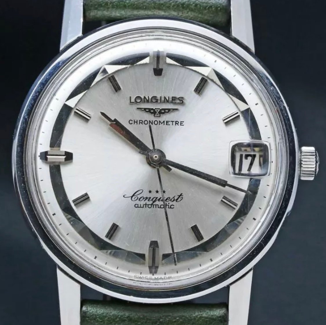

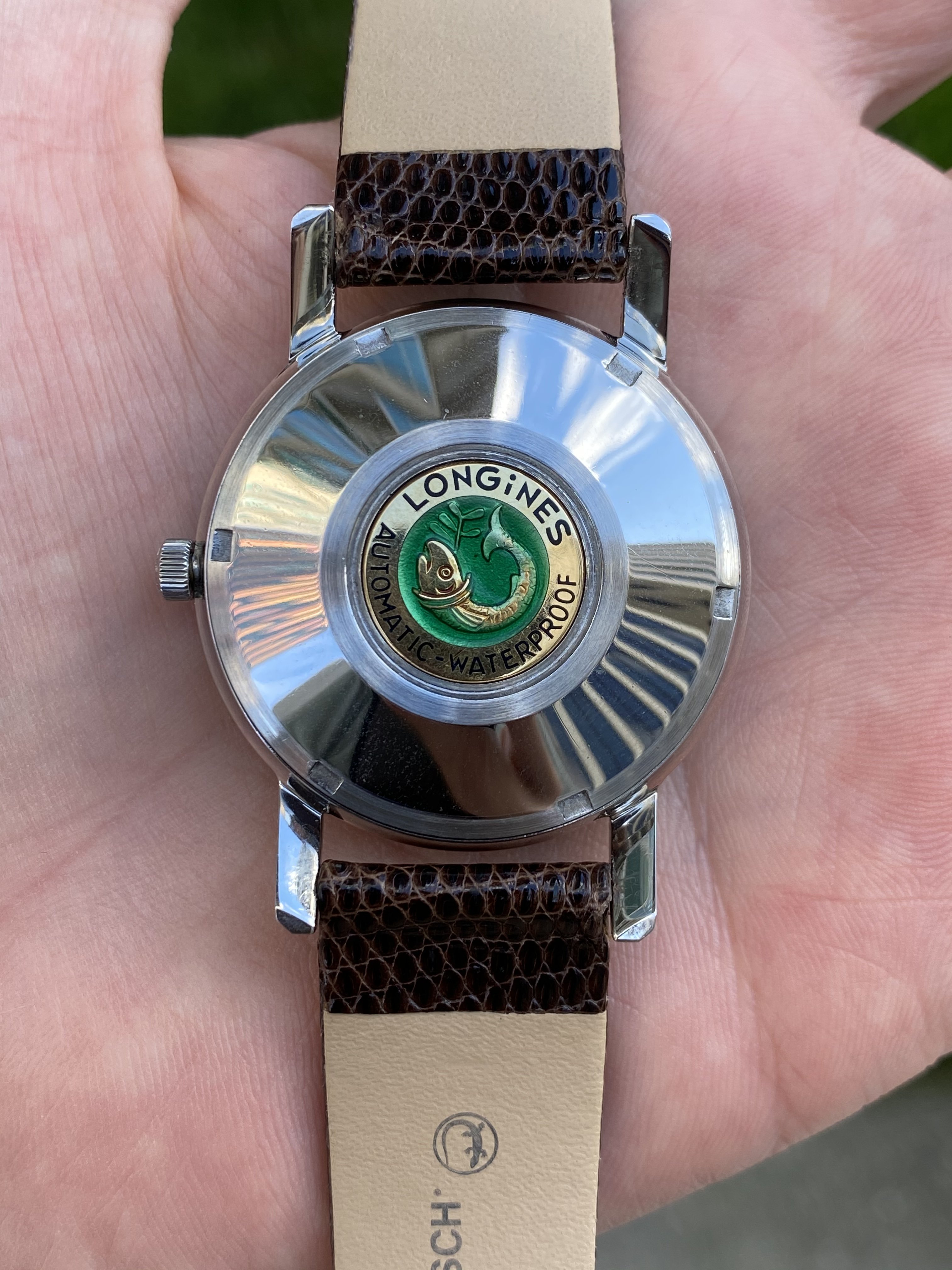

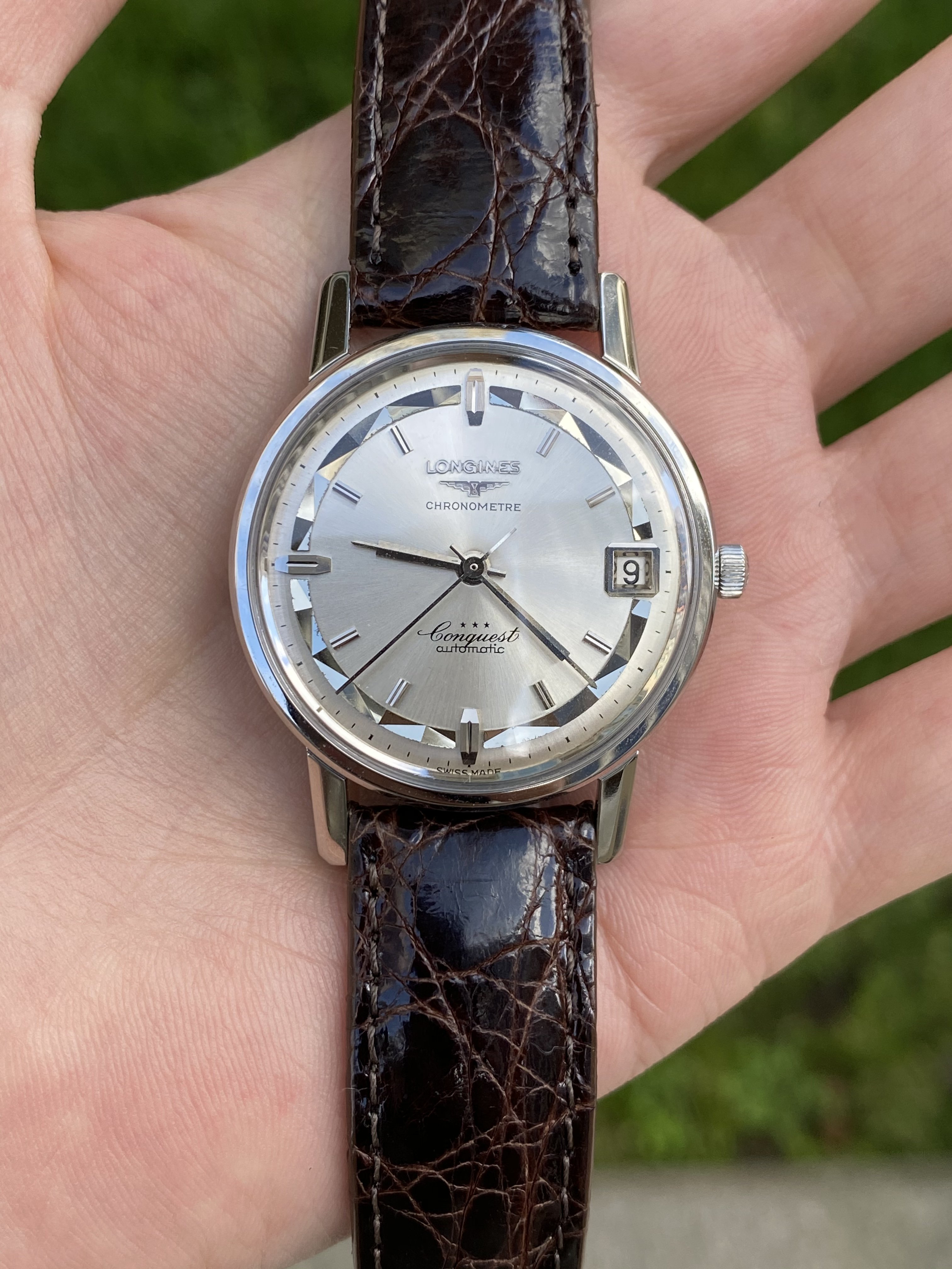

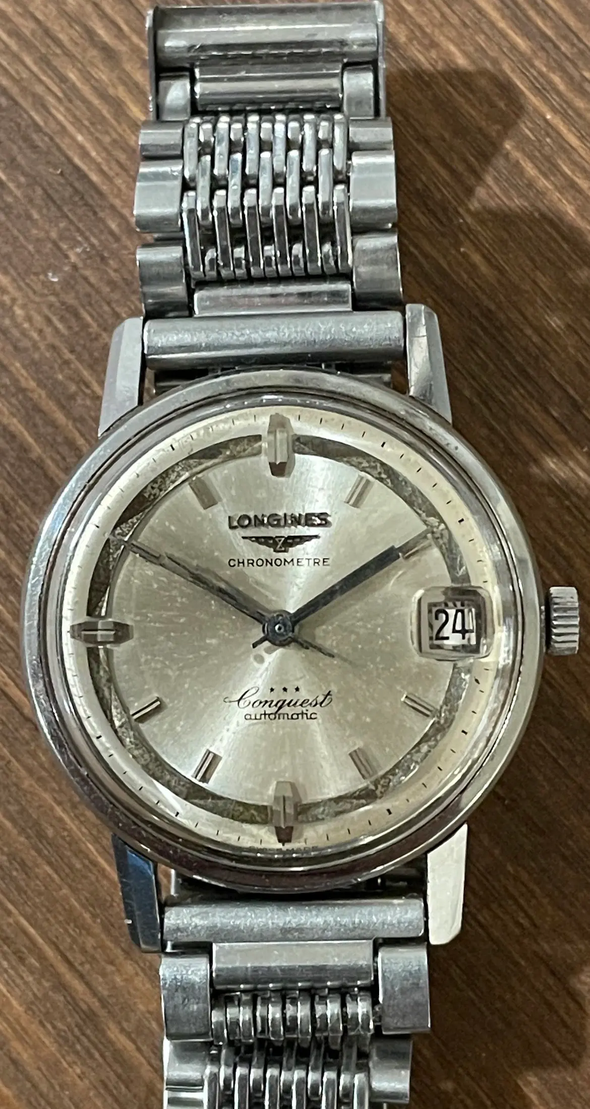

I'm excited to share this Longines Conquest Chronometre I recently picked up. I'm smitten, however I'm also struggling to find much information on it..
I've seen (now 7) others (photos and info below). I've pressed the Longines archive pretty hard, but they can't seem to find any information about the chronometre status or the deluxe-style dial variant.
That said, of the eight I’ve seen to date, three of them (including mine) were delivered to Hattori in Japan on 8 July 1965, two were delivered to Hattori in Japan on 7 October 1965, and one is a franken watch (also delivered to Hattori in Japan, though). The others I don’t have archive info.
Edited the above (and below) with additional examples
Perhaps a special order?
Anyone have any info or recommendations?
Perhaps @Rumar89 @Tony C. @JohnSteed @gatorcpa @Andsan @dougiedude @Bill Sohne given this thread?
#1 - mine (bought from Stetz & Co) - serial # 12,850,821
Invoiced on 8 July 1965 to Hattori

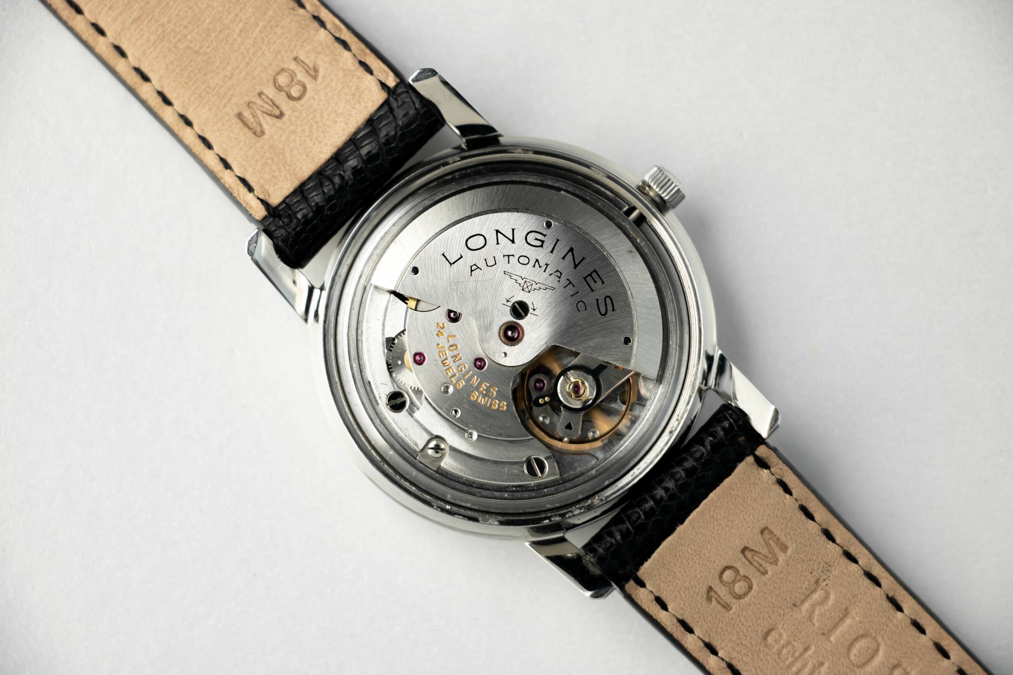

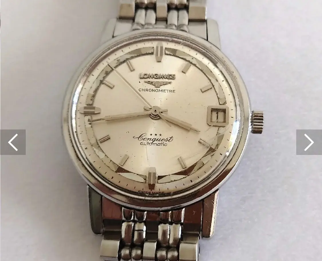

#2 - from eBay (listed twice..) and previously posted on OF - serial # 12,851,126
Invoiced on 7 October 1965 to Hattori
https://www.ebay.com/itm/173846257884
https://www.ebay.com/itm/273877064621

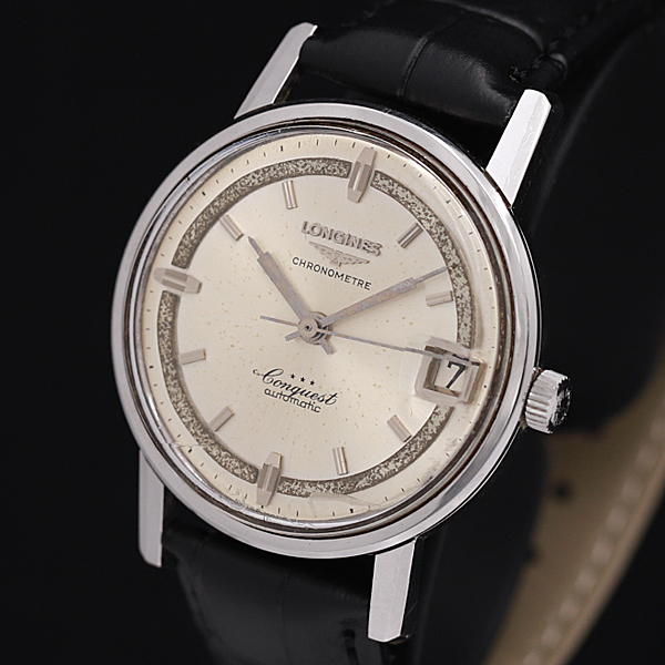

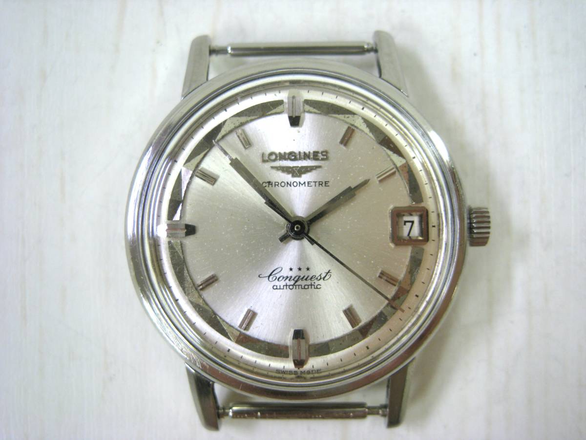

#4 - sold on Yahoo JP in July ‘21 - unknown serial #
https://page.auctions.yahoo.co.jp/jp/auction/b564853764

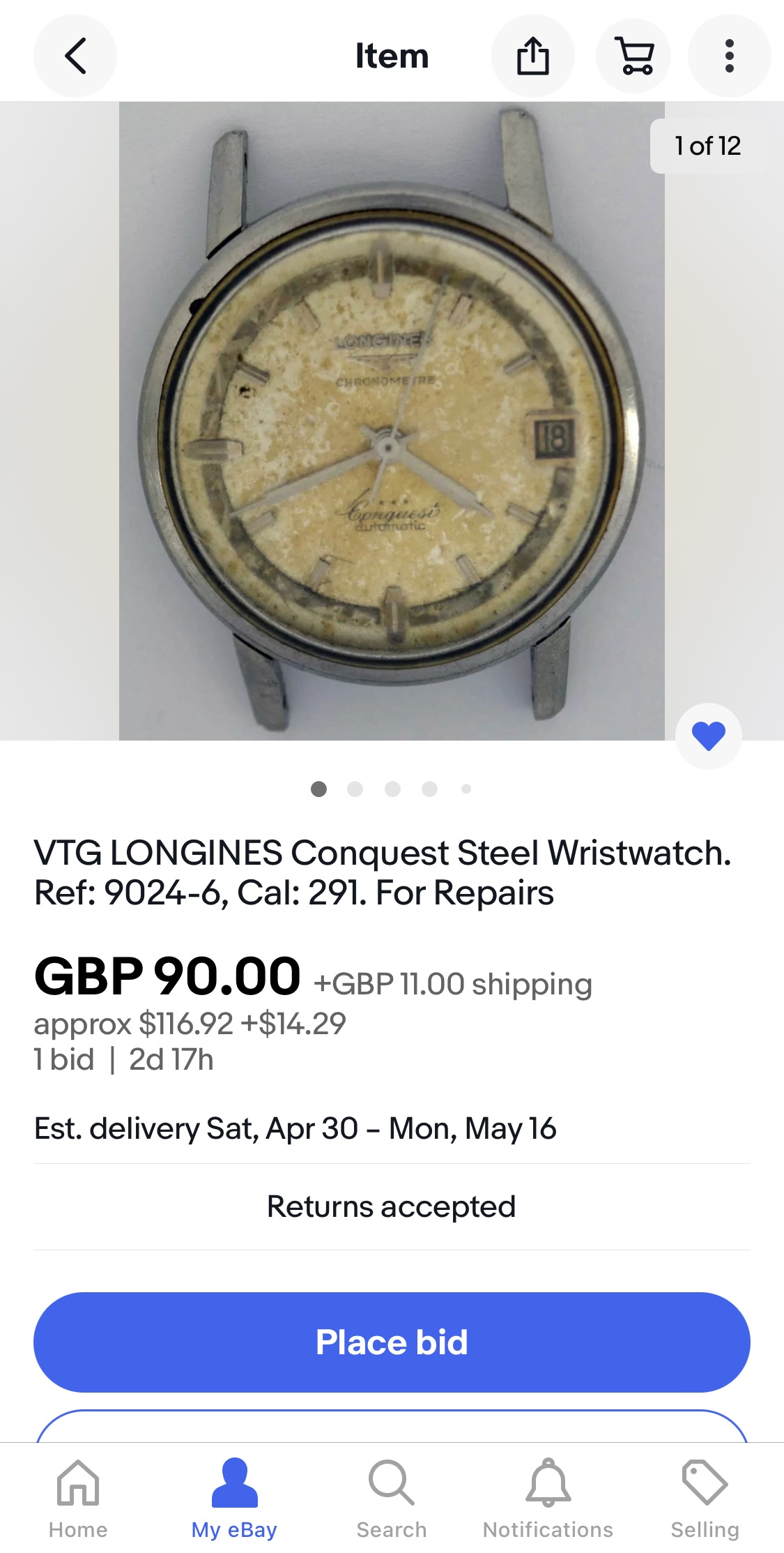

#5 - sold on eBay (UK) in April ‘22 - serial # 12,849,746
https://www.ebay.com/itm/255492695219

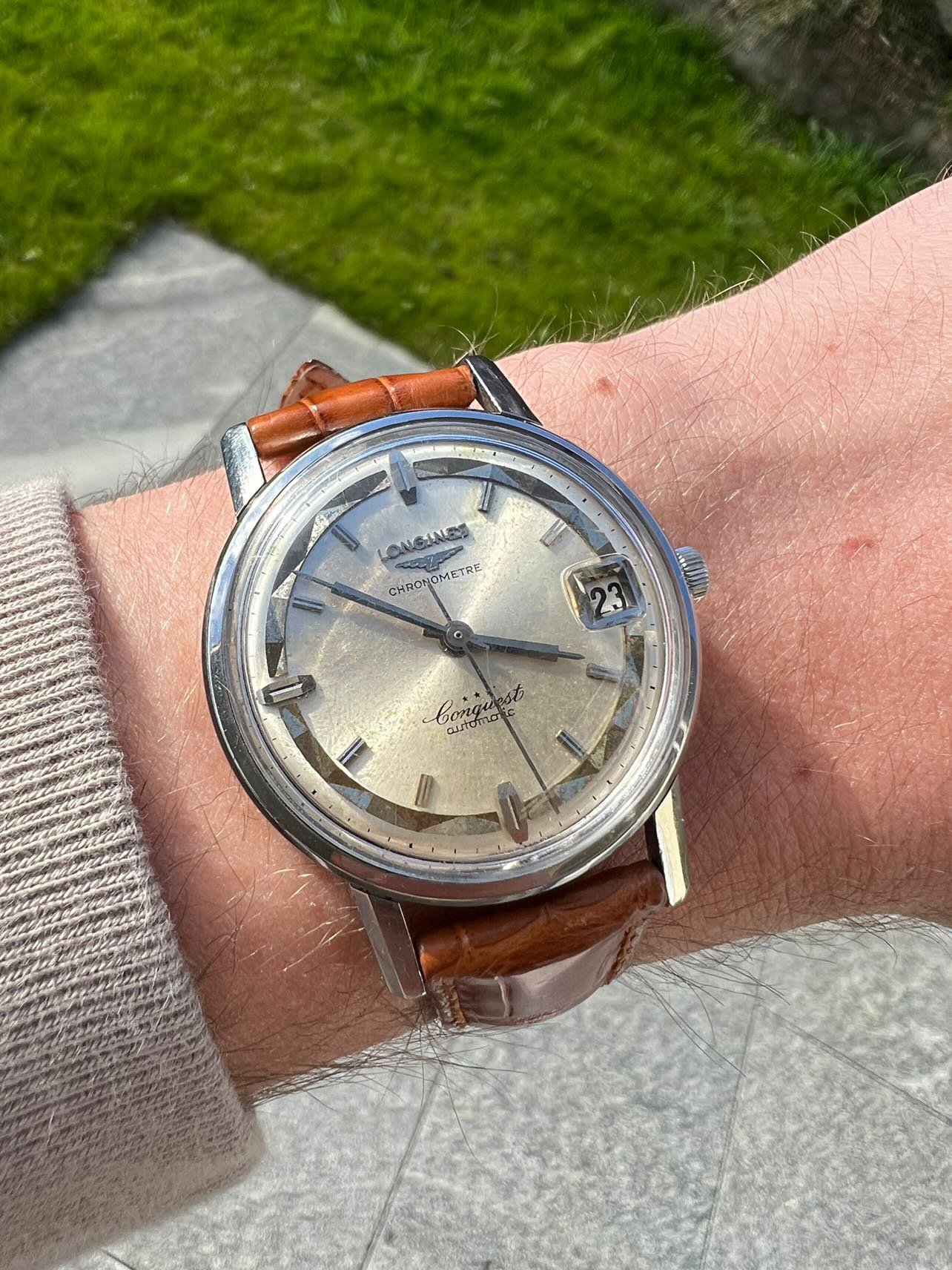

#7 sold on Yahoo JP in Feb ‘24 - serial #12,850,928
Delivered on 7 Oct 1965 to Hattori
https://page.auctions.yahoo.co.jp/jp/auction/1092179067
And owned by @WatchHeaven44
#8 sold on eBay in May ‘26 - serial # 12,849,897
Owned by @amuscare87

When you contacted Longines, they minimally should have been able to identify to what country it was originally delivered. What did they say?
8,283
29,288
The first two links to other examples are of the same watch, which, among other things, doesn't bolster the likelihood of authenticity.
2,816
6,951
I should have been more clear. Longines was able to provide all of the usual information, just nothing “special” regarding the Chronometre or the dial style. This is how I got this info:
All three I've seen are 9024 references with a 291 caliber movement and all were delivered to "Hattori" in Japan between July 1965 and September 1966 according to Longines.

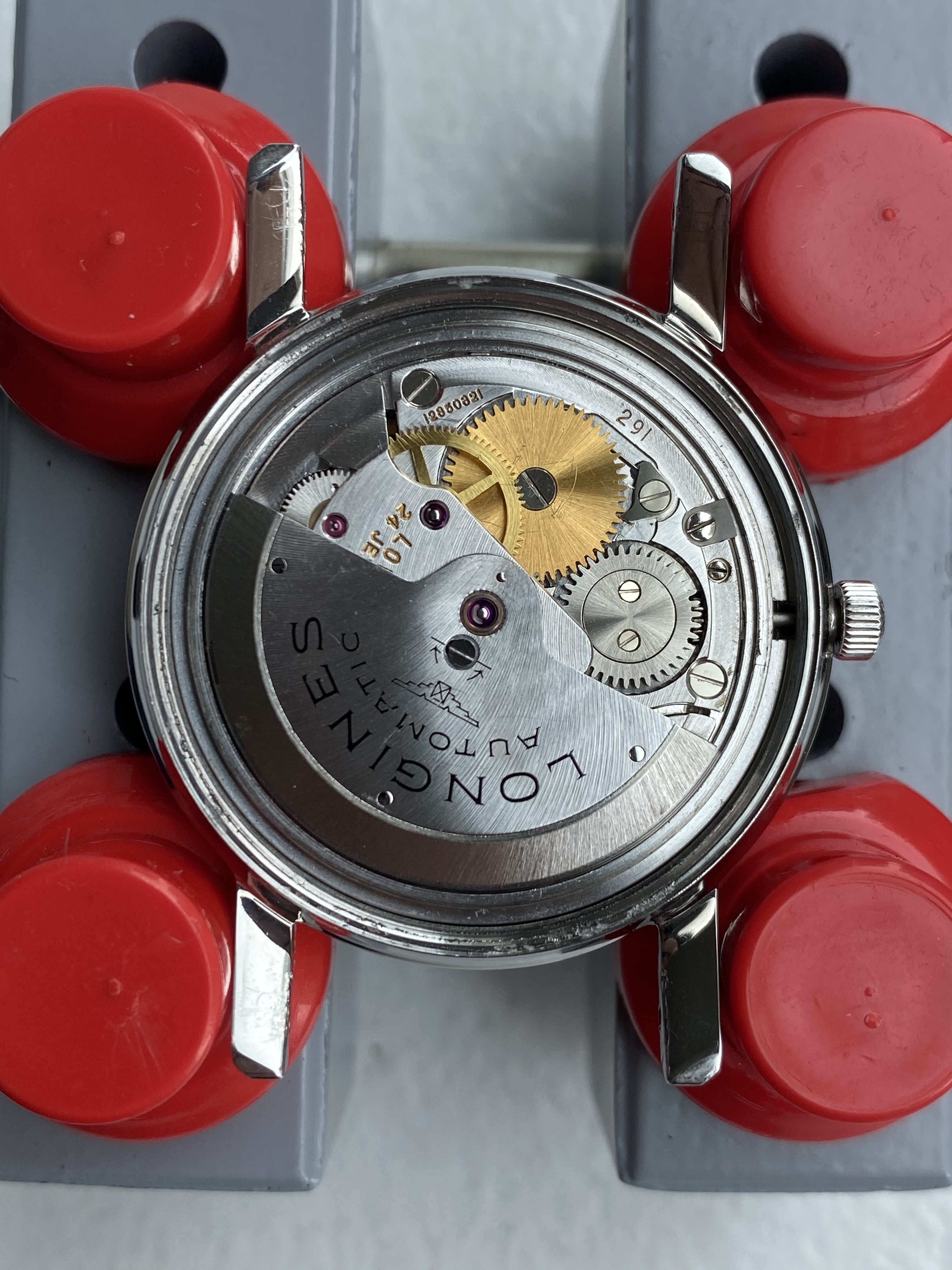

Not that this is a smoking gun necessarily, but I'm wondering if you can identify any movement modifications, such as a fine regulator adjustment, or overcoil hairspring.

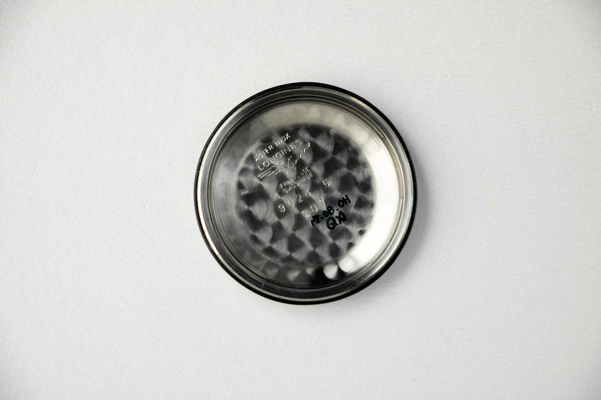

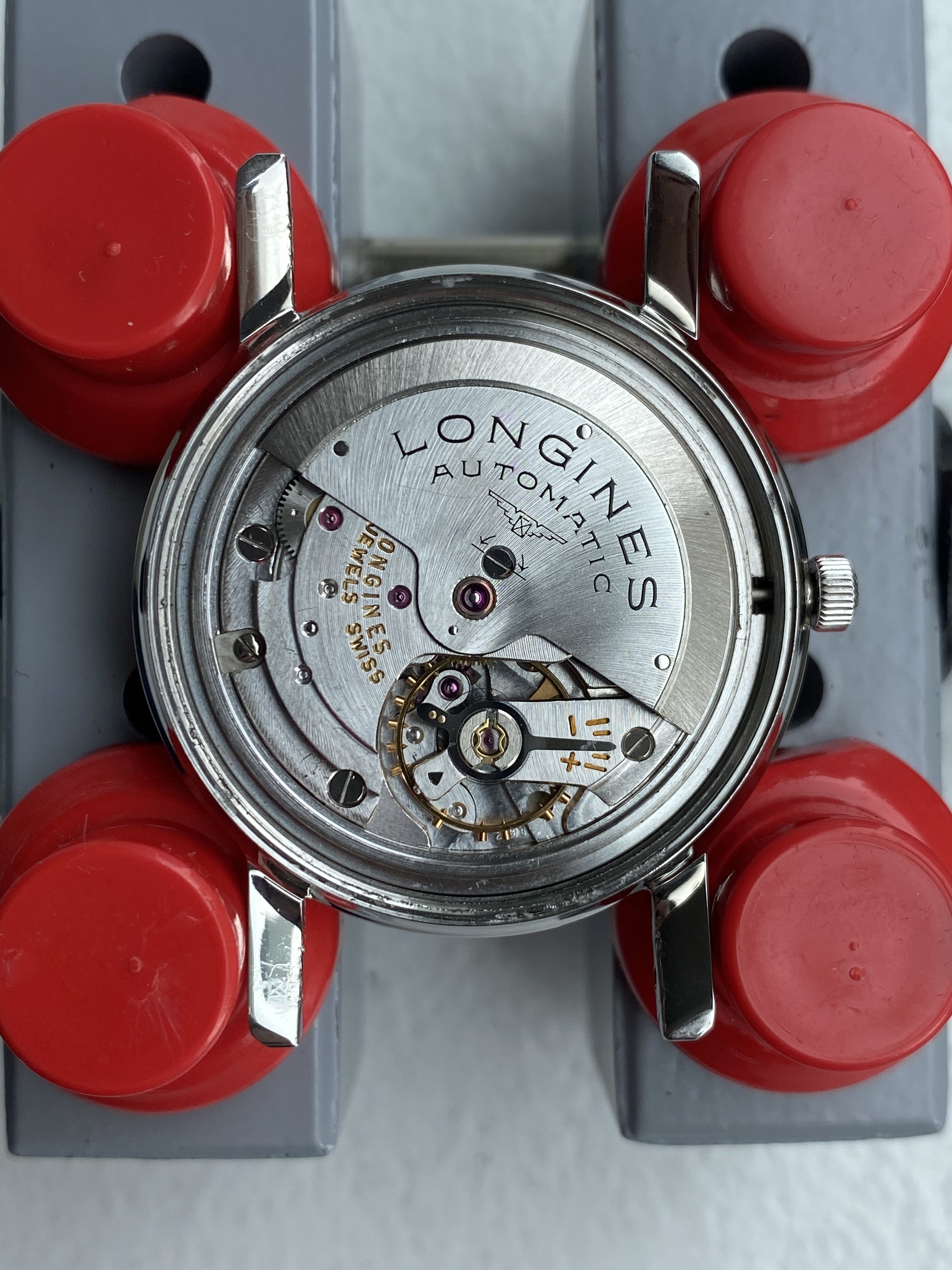

Do you happen to have a photo of the other half of the movement?
2,816
6,951
Anything interesting above?

Thanks! I can see nothing, with the exception of what Dan noted (i.e. the normal regulator), to suggest that it might not have been a chronometer.
I'm going to say that it is likely genuine, and, while counter-intuitive, that Longines' records may not have been quite as complete, or well organized, during the sunset of the Golden Era of Swiss watchmaking.

Yeah, I was hoping to see a fine regulator adjustment, since that would have pretty much been a smoking gun. But the absence of it doesn't tell us much.
