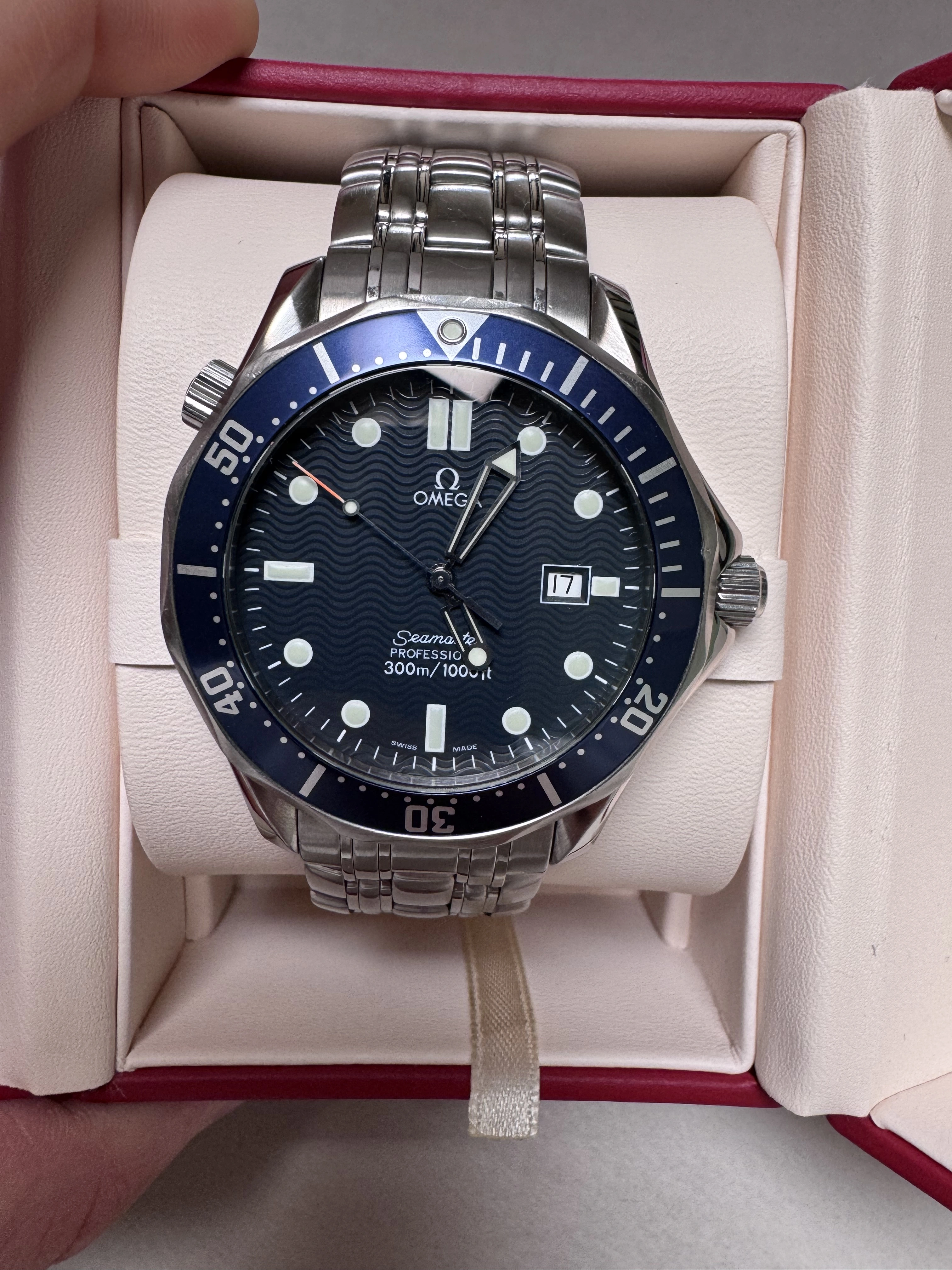

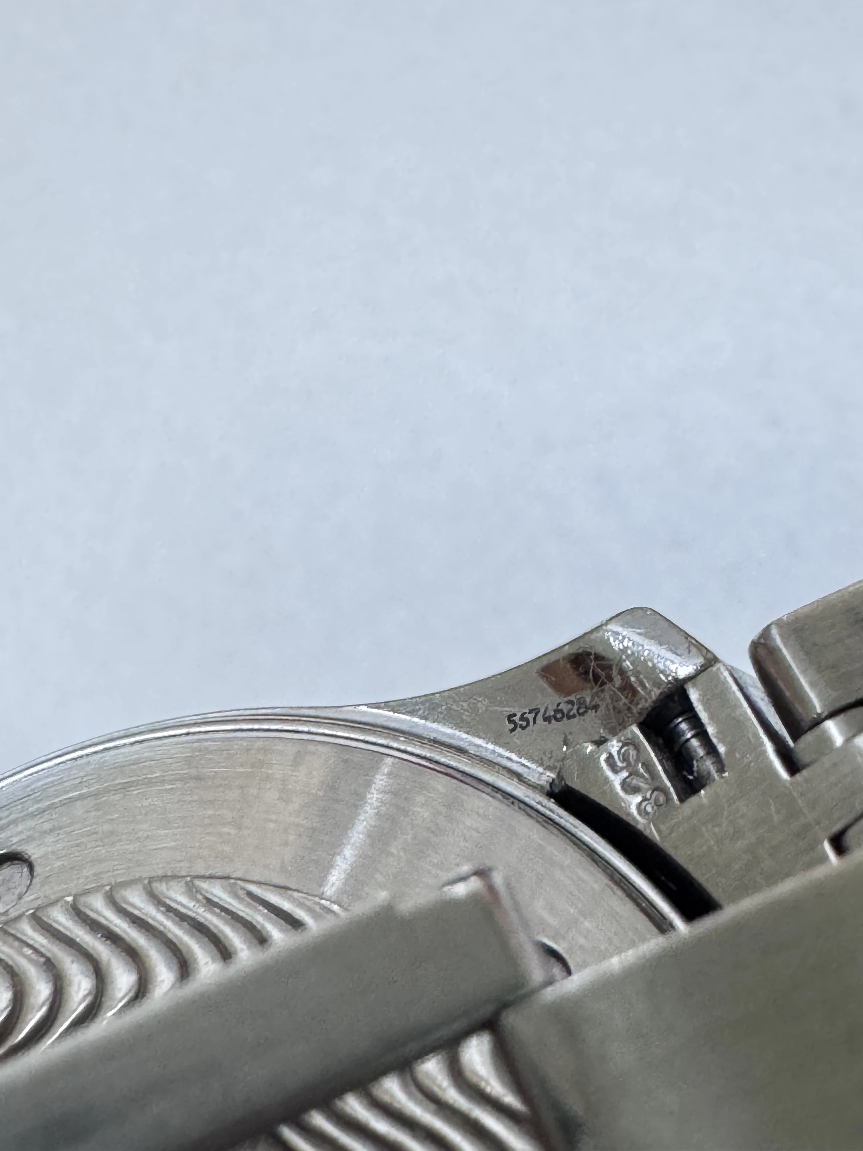

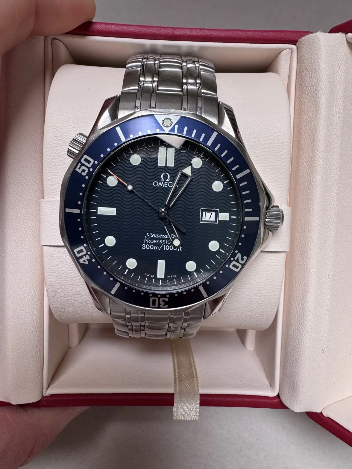

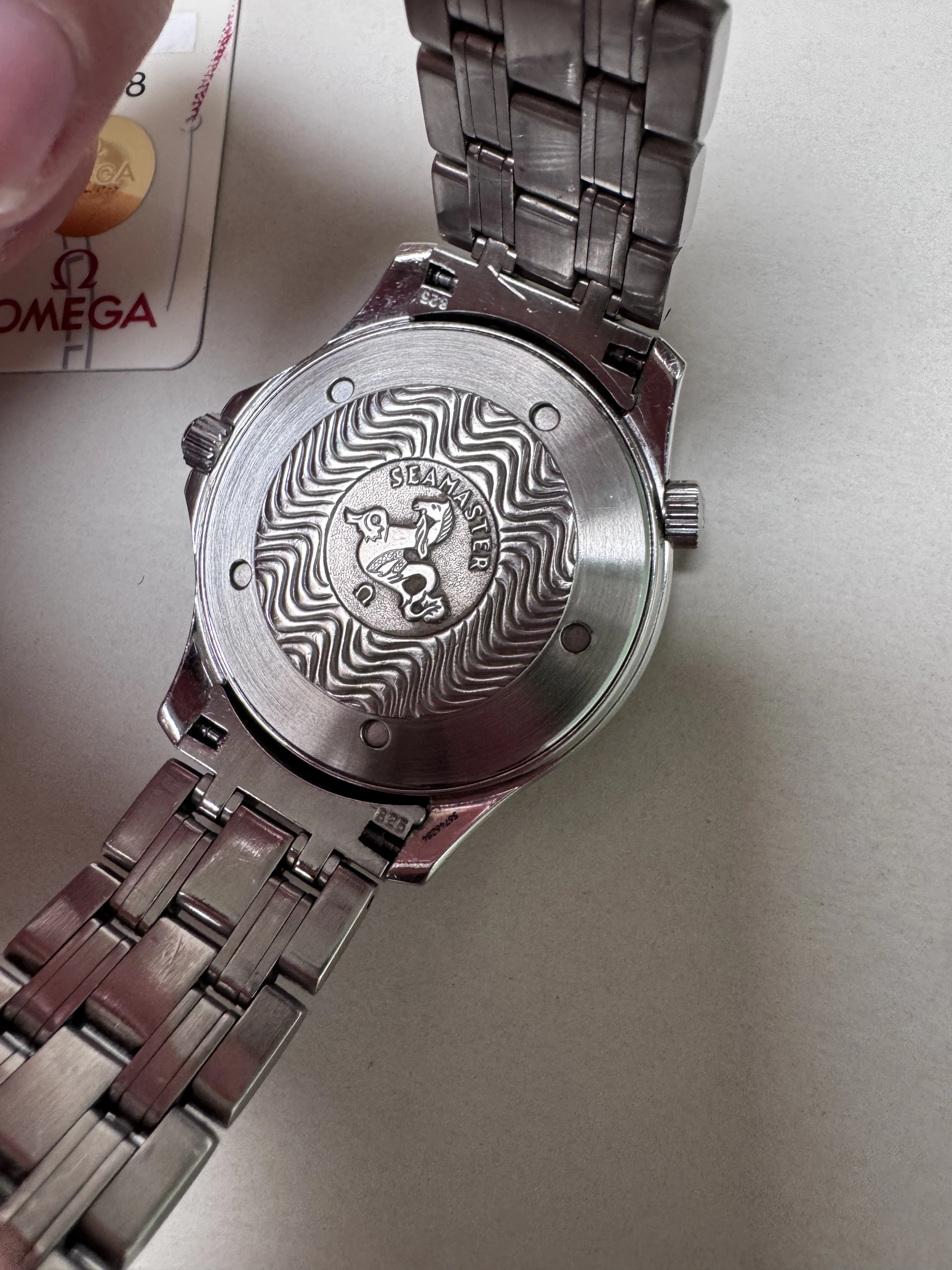

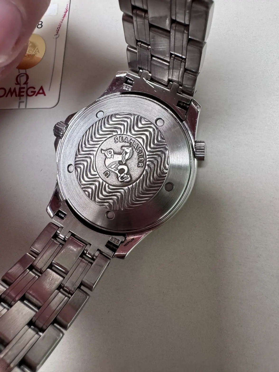

Can someone please help me identify if I have bought a real or a fake watch? Thanks in advance. It’s for my boyfriend and I want to be sure.

Thanks a lot for taking the time to reply. I don’t understand why chat gpt keeps telling me it looks like a fake…
6
chatgpt is just a human too. 😉
Well yes. But I personally don’t have any expertise in watches, so it really made me second guess
Chatgpt sucks information from the internet and then regugitates it without having the ability to filter incorrect information from valid data.
I only look at AI reponses for amusement, not for an educated response.

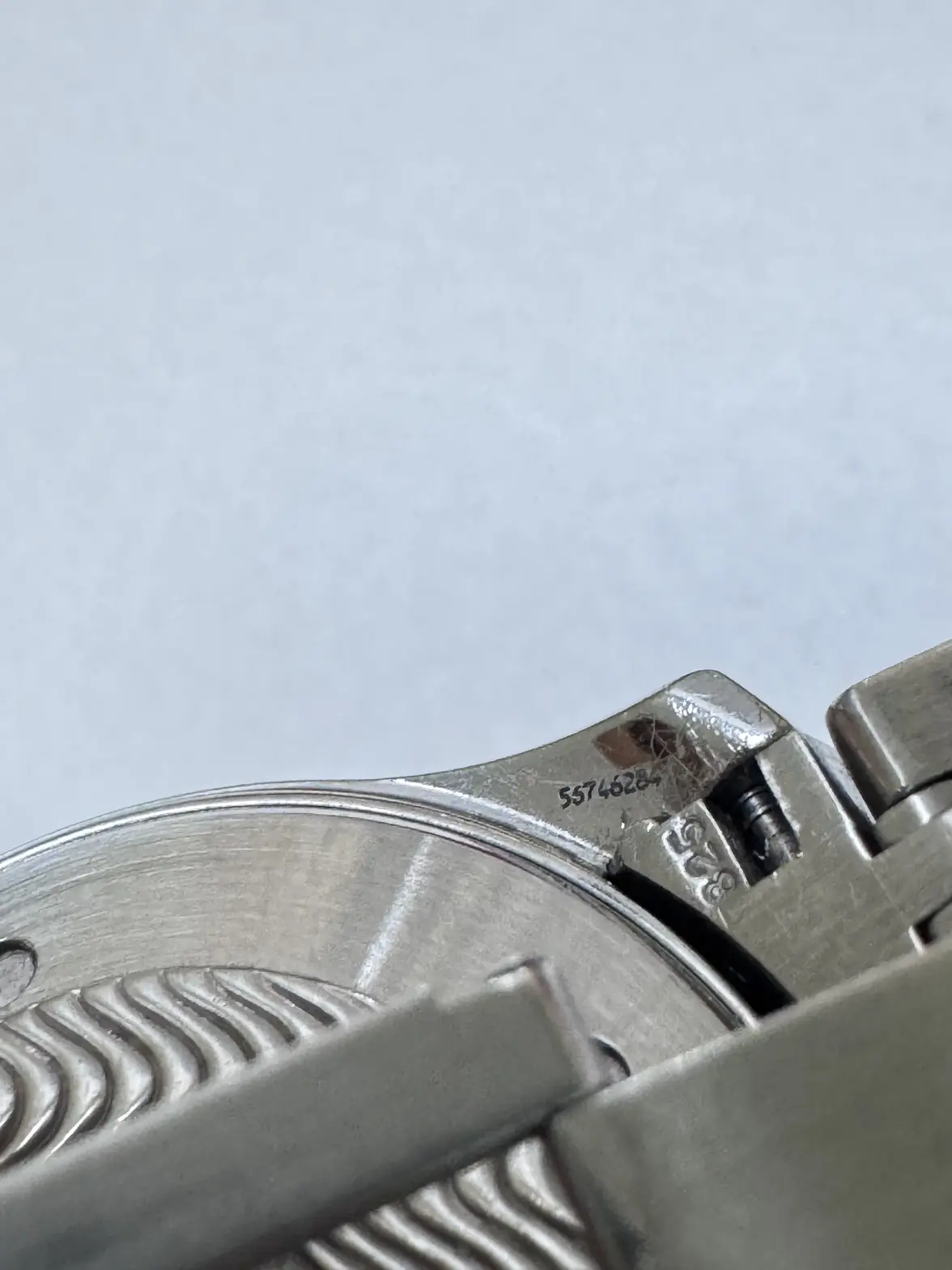

Your watch is fine, your boyfriend is lucky.
As it was purchased in Tokyo in 2019 and tested for water tightness last year by Chronoworx it may be due for a service (if not noted as serviced).
Let him enjoy it for a while before sending off for service though.
10,558
16,498
Not fake in any way but the bezel insert has been perhaps removed and replaced at some point. Normally the pip is inline with a peak on the scalloped bezel shell, yours is not. This is enough to have perhaps made an AI cry foul. Often this would indicate replacement with an aftermarket part but I don’t see that here, it looks genuine, so it’s easily fixable in the unlikely event he spots it.

Thank you so much for taking the time to respond. That makes me much more calm

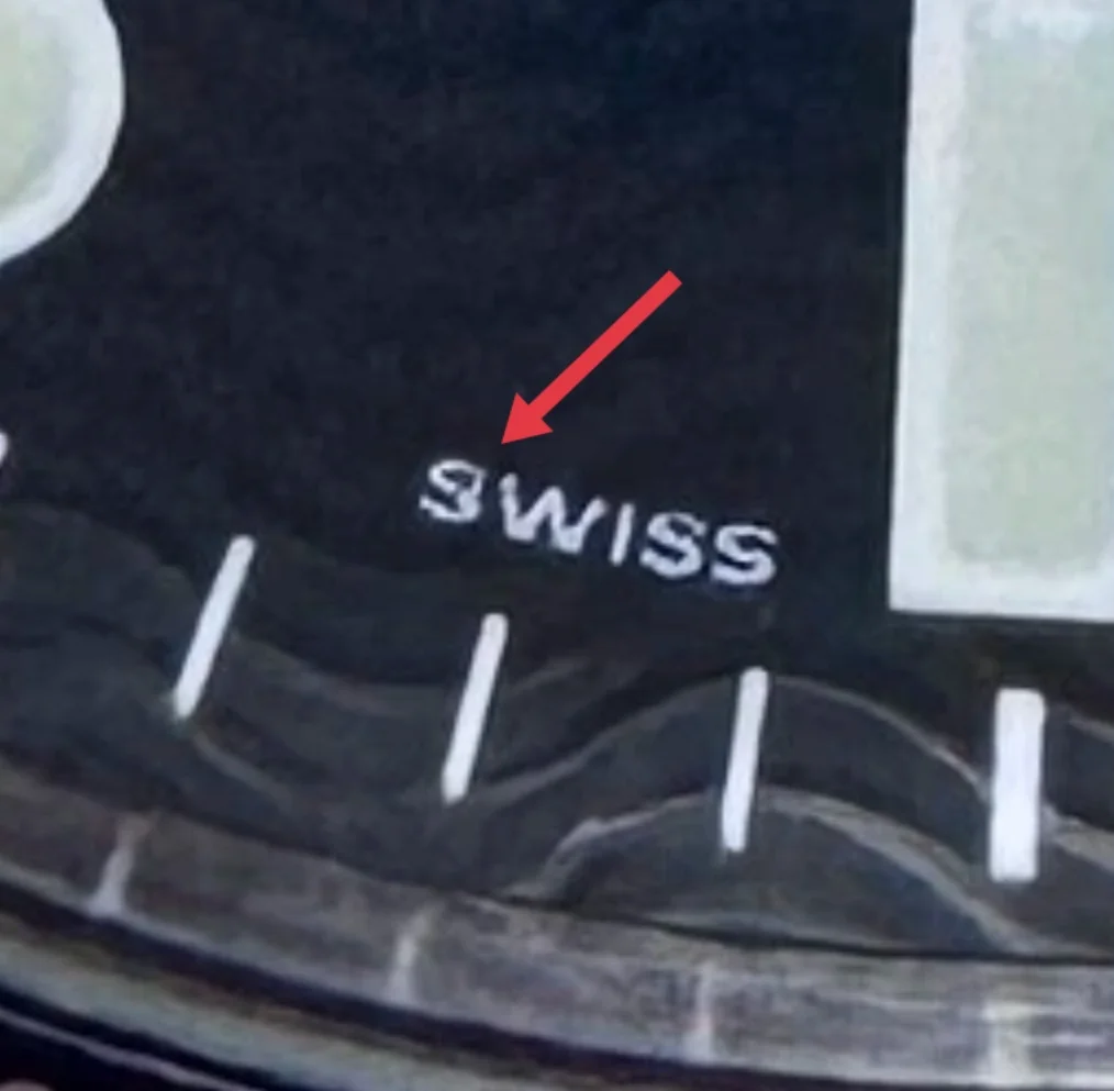

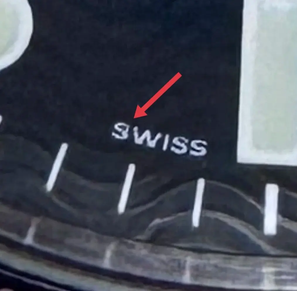

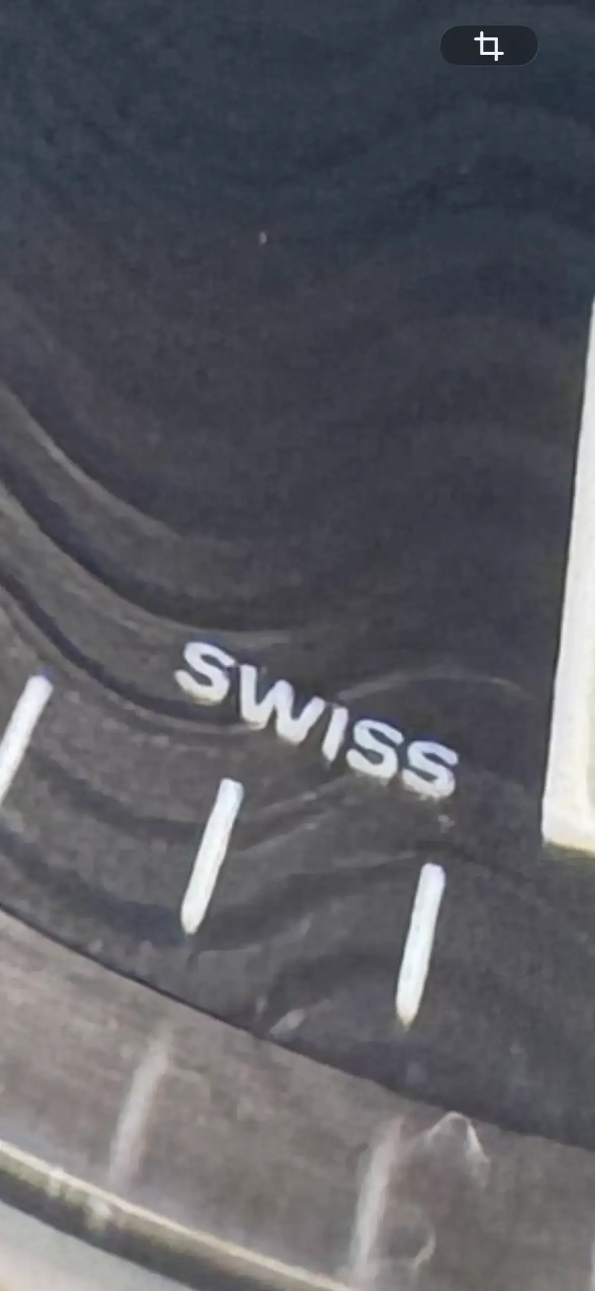

The "Swiss Made" seems badly printed. But others who have commented have more knowledge about these new refs than me, so I trust their verdict of authenticity.
(That lower quality print is so small font that it doesn't reduce the real life using experience. Just something I noticed from the close up photo.)
2,692
5,489
There maybe some slight distortion viewing through the crystal, but in the photo the printing looks fine.

The printing on SMP dials follows the waves which have depth and can look odd at times. I see nothing to worry about here.
I mostly meant the section where the "S" on the "Swiss Made" seem to have inc bleeding making the "S" have its upper arc connected to mid section. But like said I'm not that familiar how crisp these prints are usually.
6

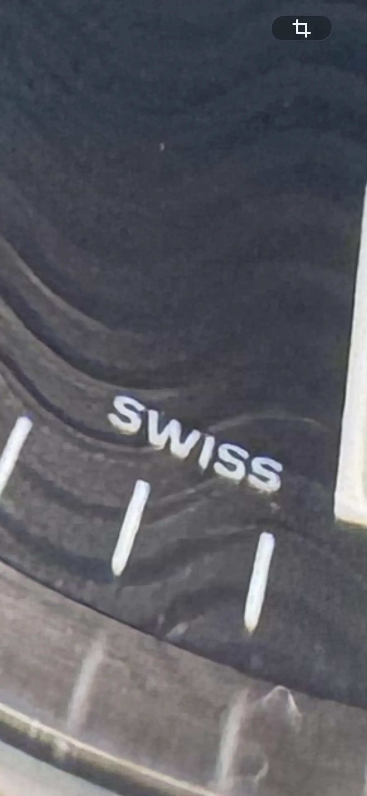

Here is another photo of the print. I guess Maybe the picture quality or the glass makes it appear like its bleeding in certain angles?
104
58
Ah yeah, looks nice and clean on this one.
