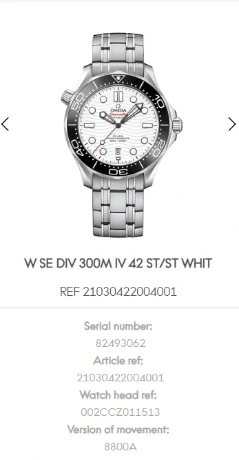

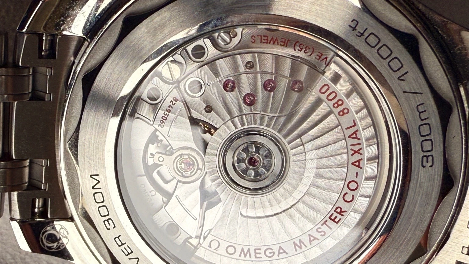

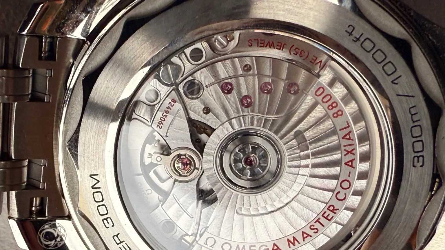

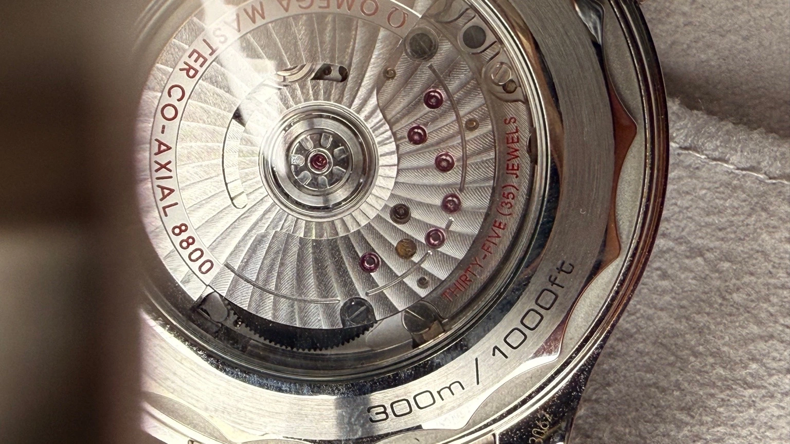

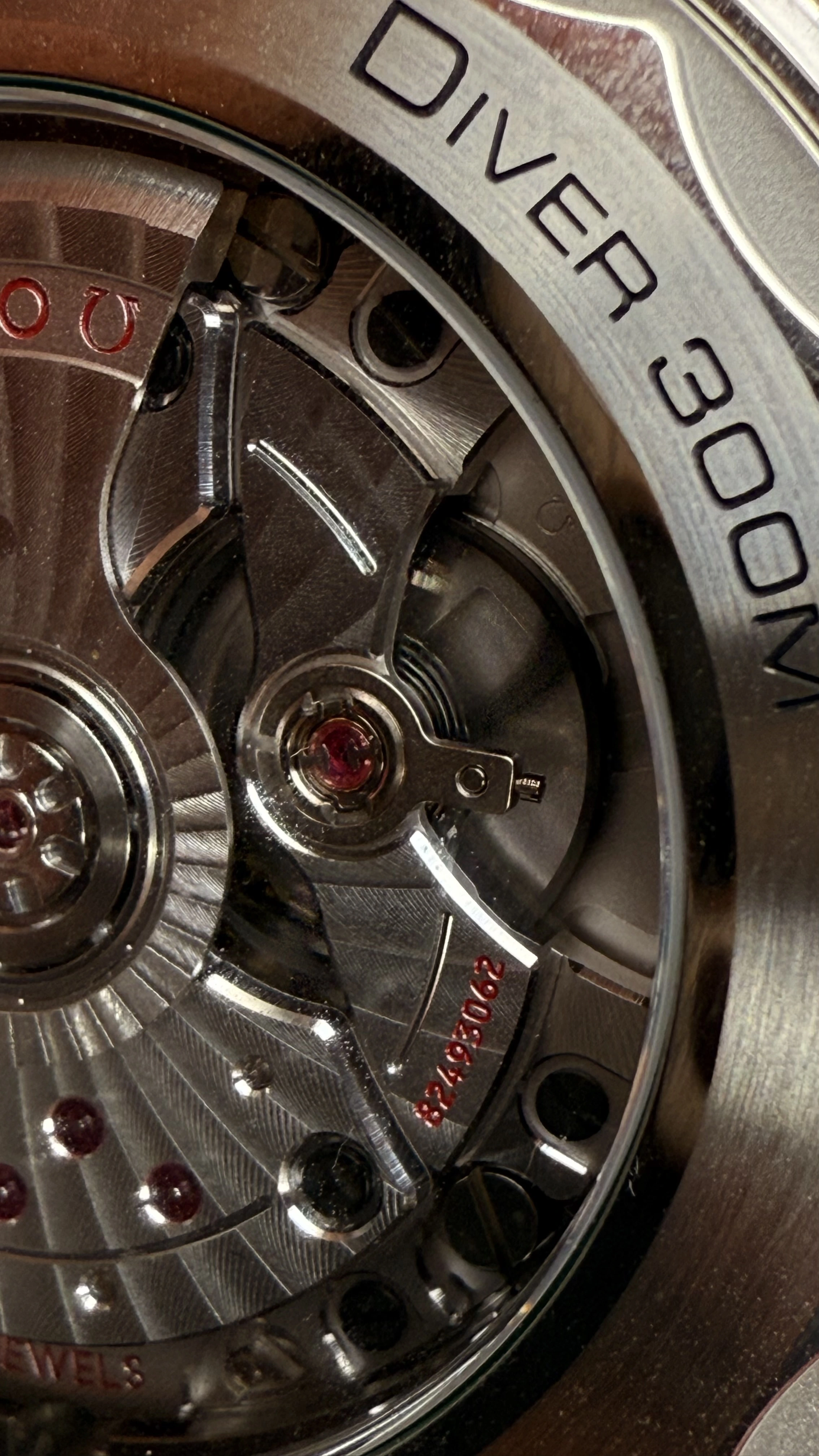

Hi guys ! What’s your thoughts on this movement, I was able to find the cronometer certificate using the card! Based on all my research looks legit, what you think ? Cheers

What concerns do you have? It looks right to me. I'm wearing the same watch right now, and everything in the movement looks correct as far as I can tell. The biggest give-away on these (at least when I was shopping) is that the fakes have 2 studs for adjustment, but real ones only have rate adjust.
So it is either real, or a REALLY good fake. The fact that the serial matches the correct watch is another that says authentic to me, rarely do the fakes get the serial number correct (or they just use the same one over and over)
