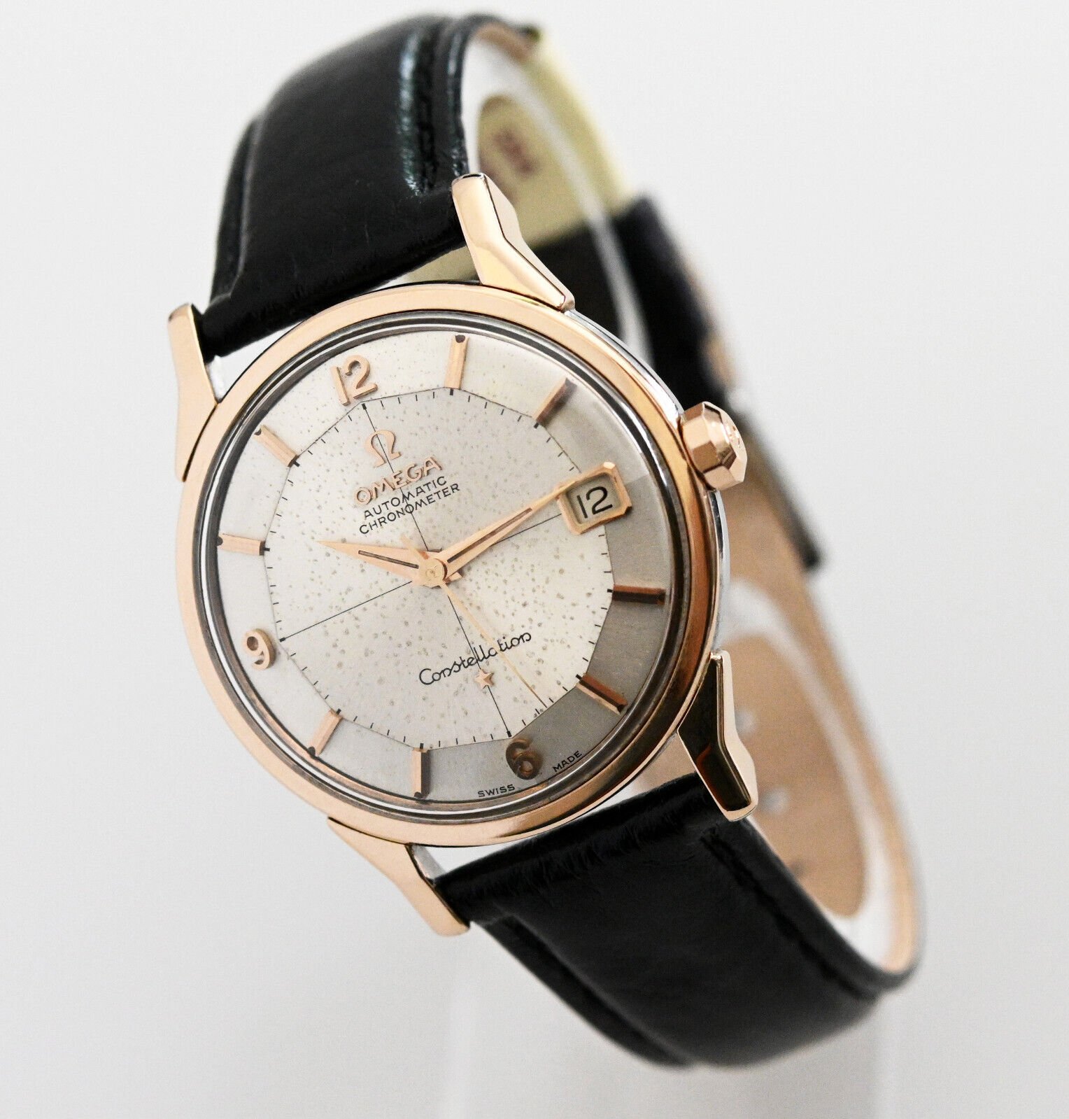

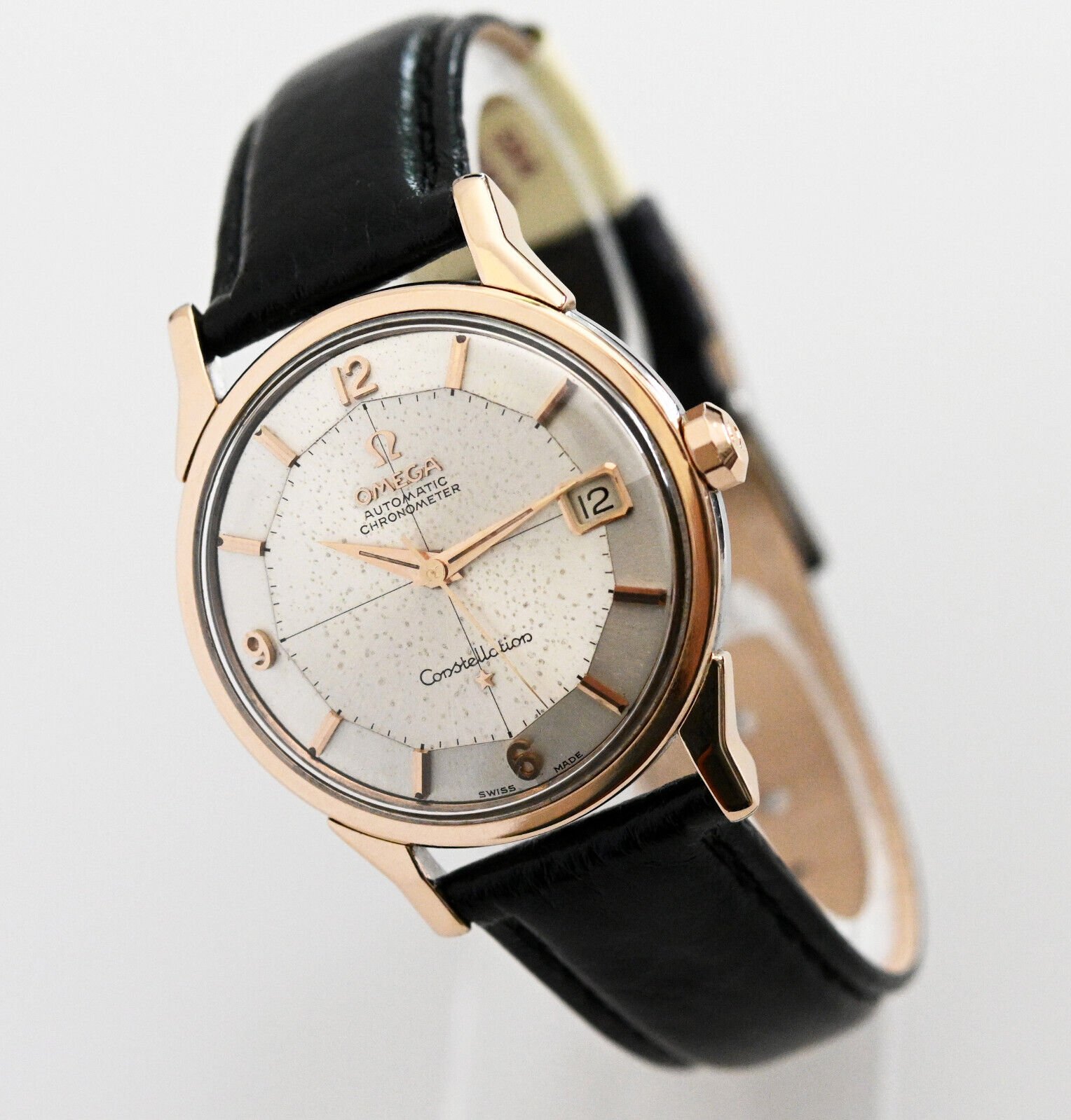

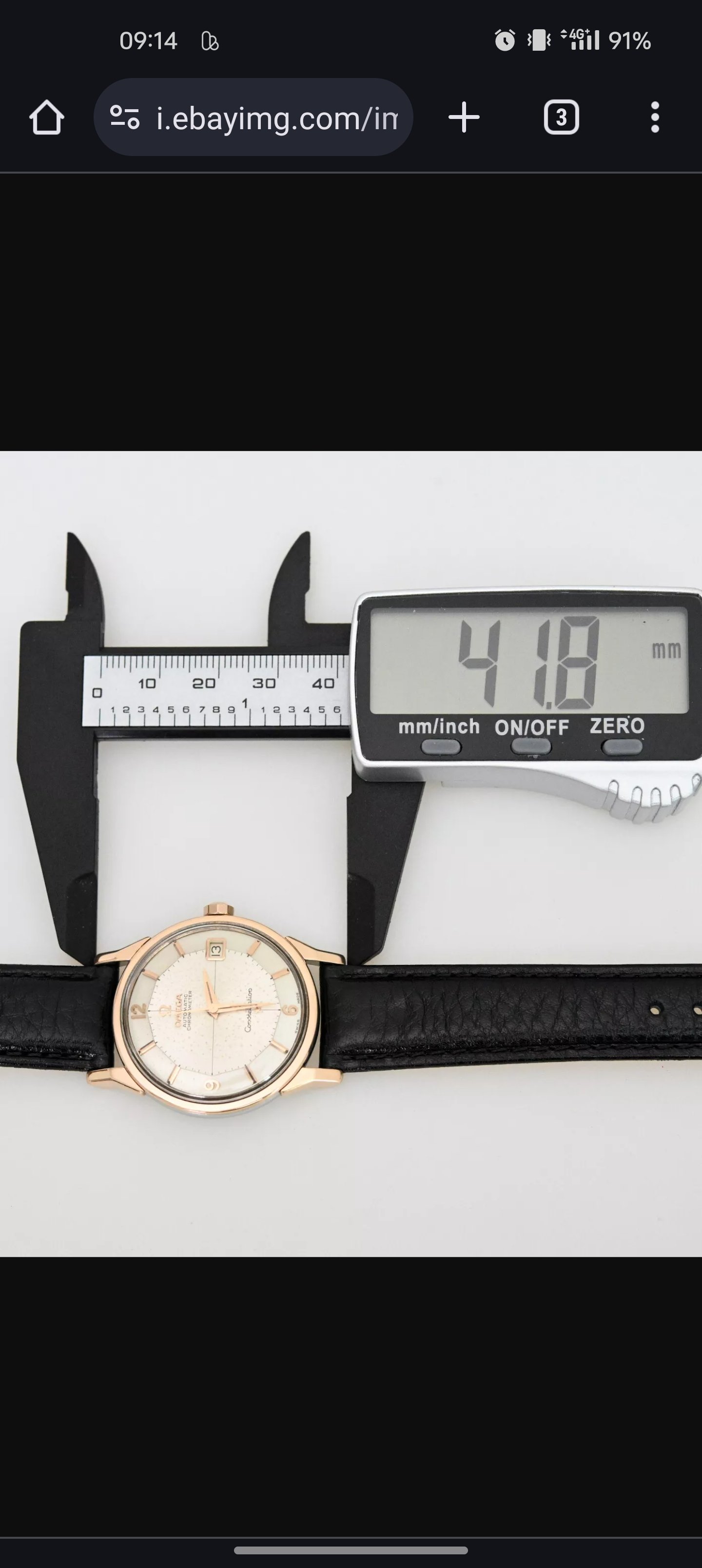

hello friends!
as here are many professionals on omega vintage watches i would like to ask if this one could be real?
couldn't find any similar to this one...
the crystal, crown and movement seem to be original but the rosegold dog leg case and the crosshair dial with arabic numerals throw me a bit off...
any help is appreciated!

Quite genuine. The Arabic numerals while fairly uncommon are legit as is the rose gold.
Lugs are quite soft and the dial is unattractively aged and probably looks worse in person.

What a shame that it’s not in better condition. 🙁
24,835
55,249
I think it's legit, but in poor condition. You should probably look around more if you are considering a purchase.
234
245
The case seems to have lost its sharp edges and been subjected to too much polishing. Hate to see this. Why don't some people just let the cases be!

how do they actually menage to polish it out that much without removing the gold plating?

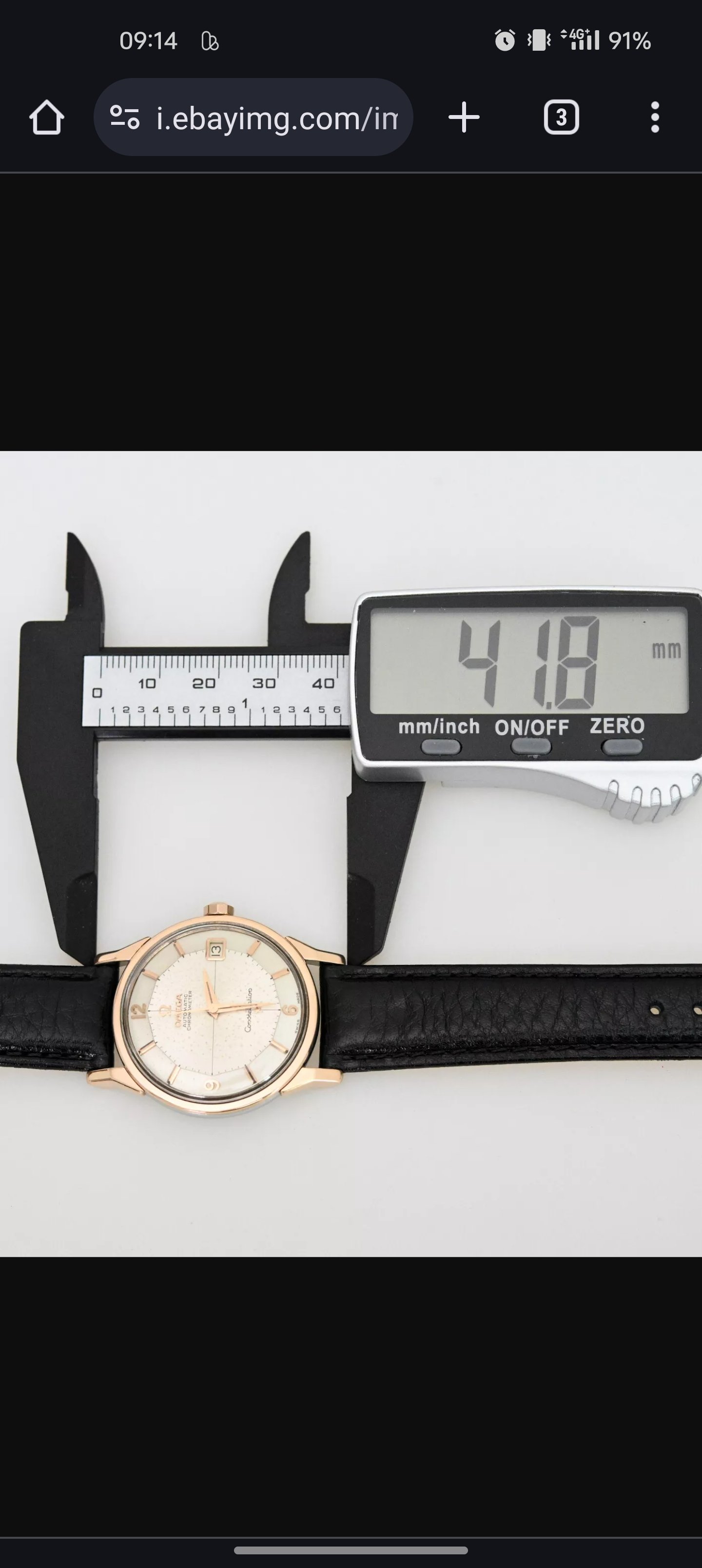

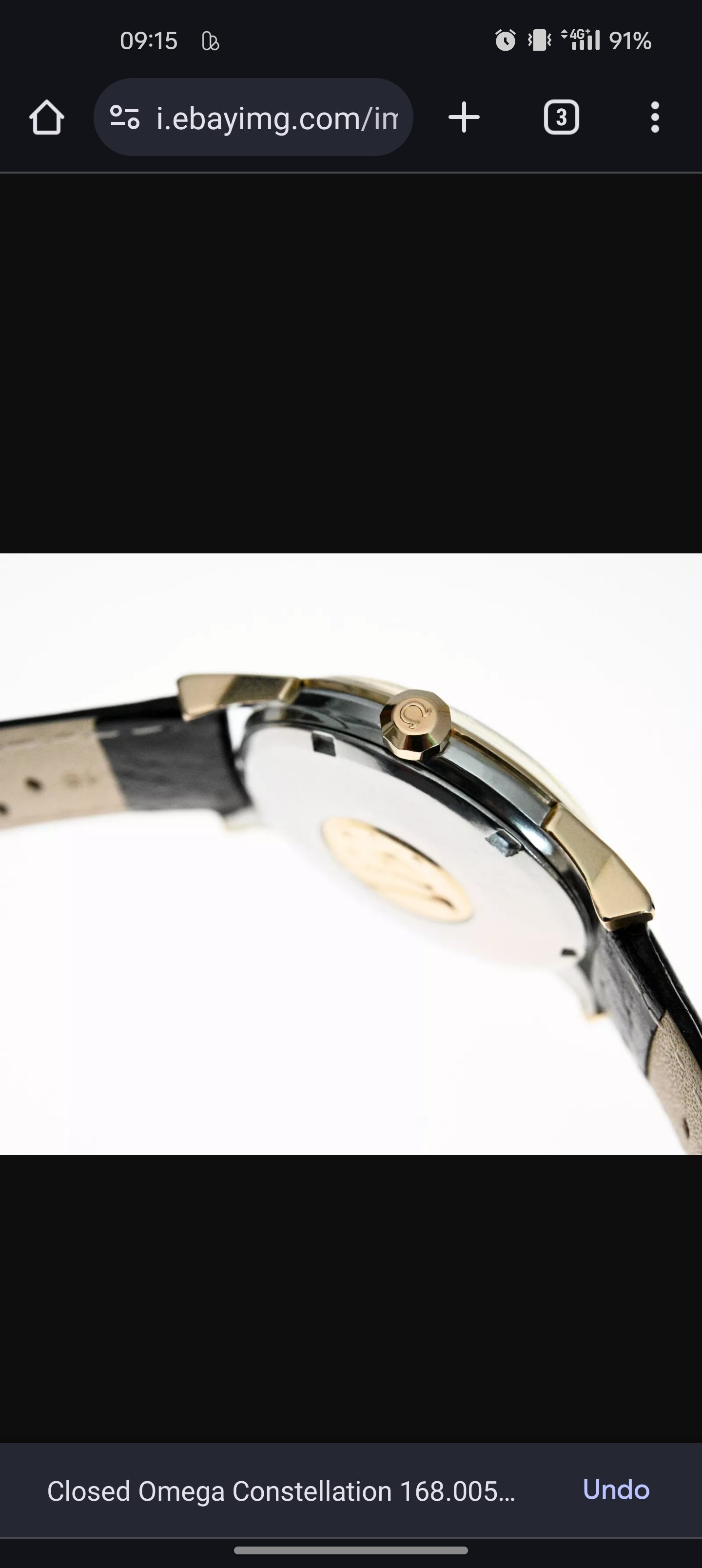

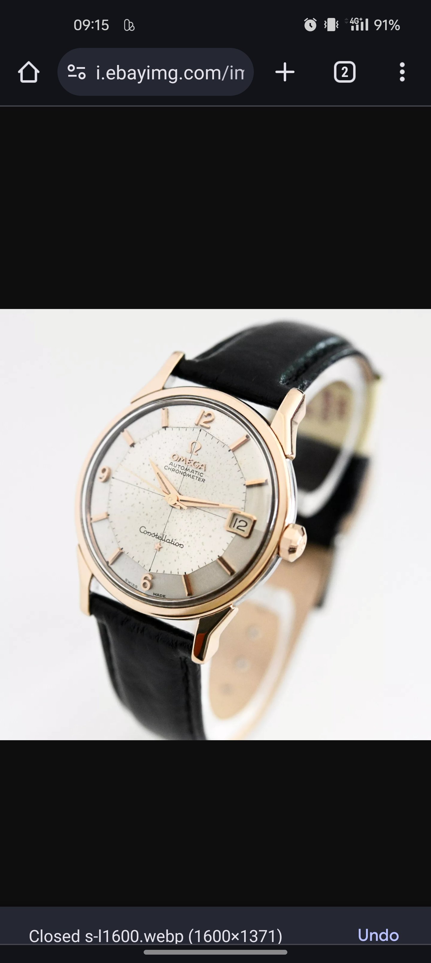

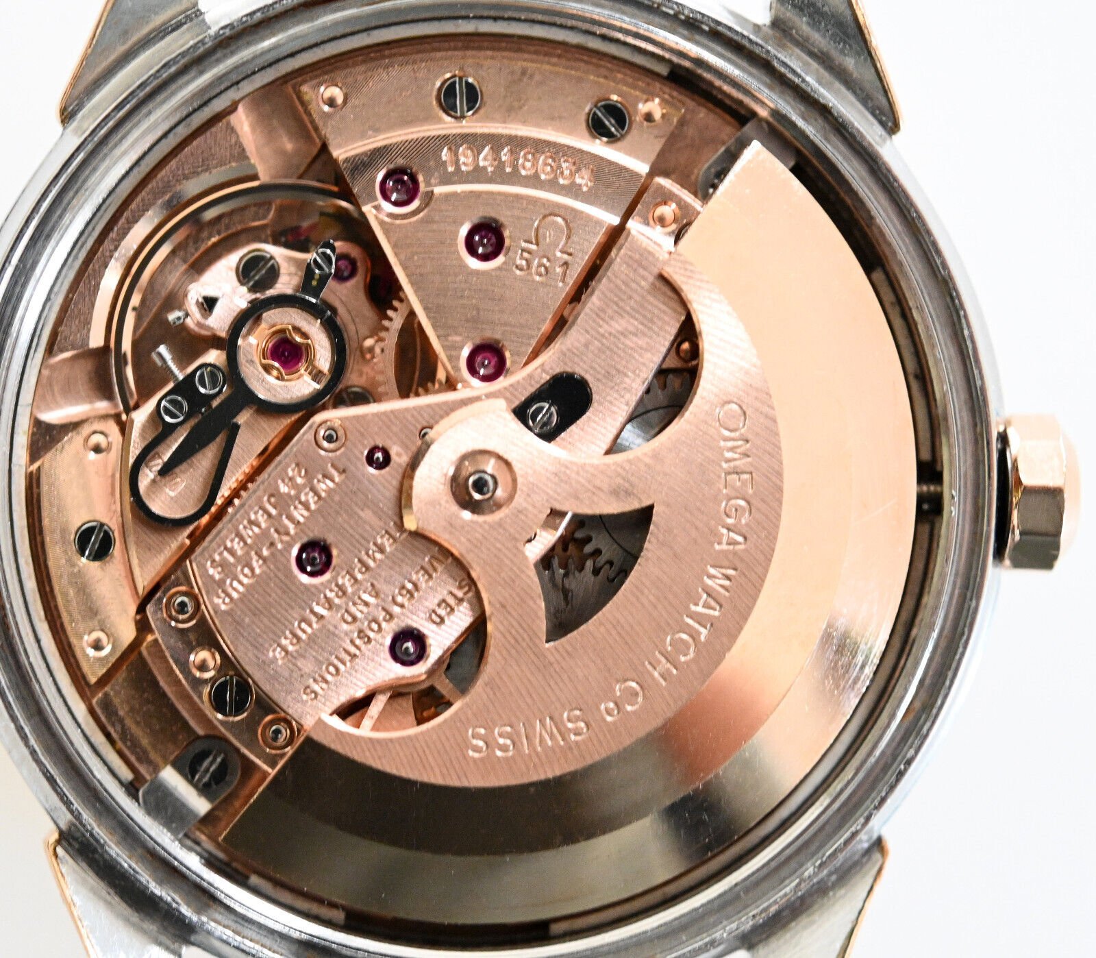

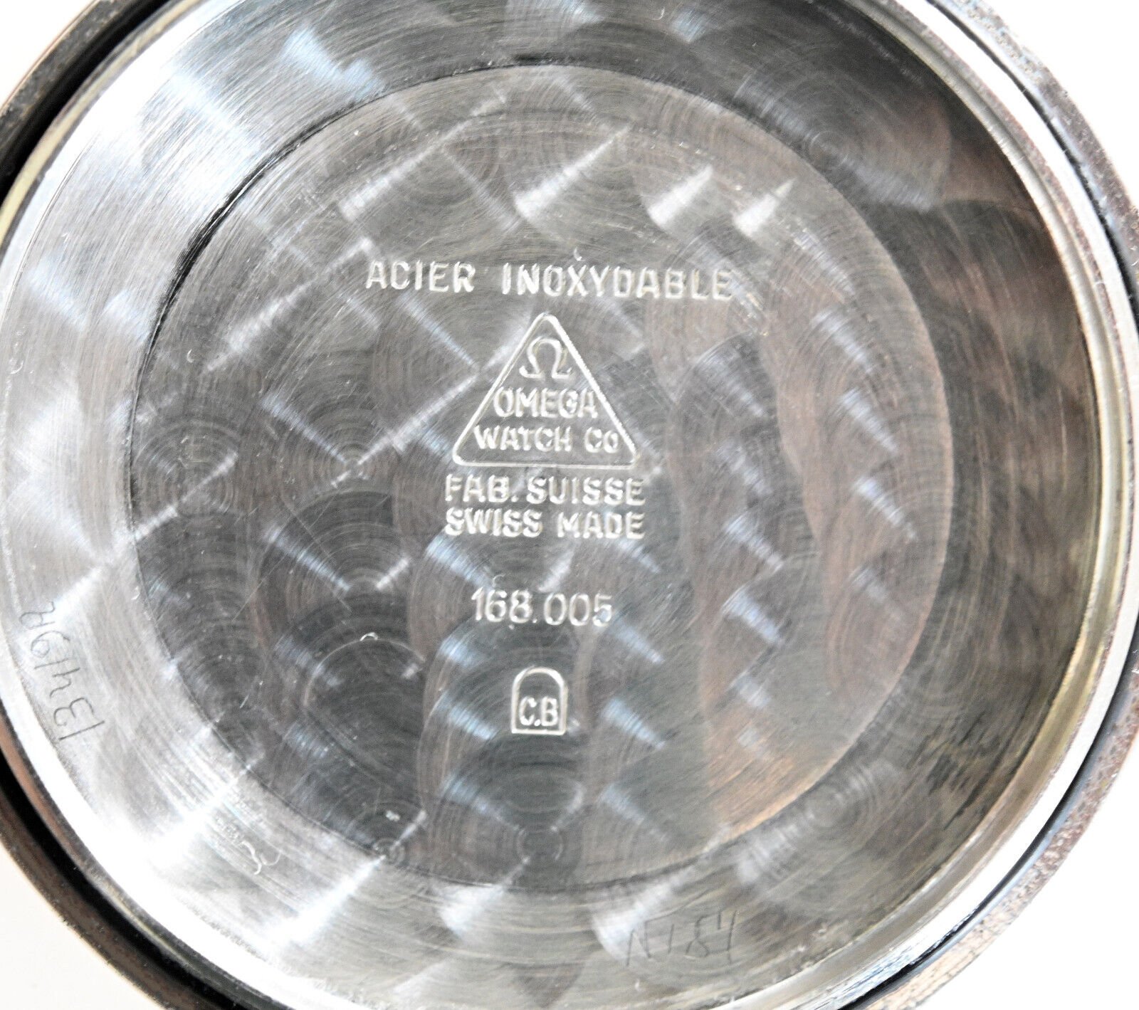

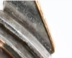

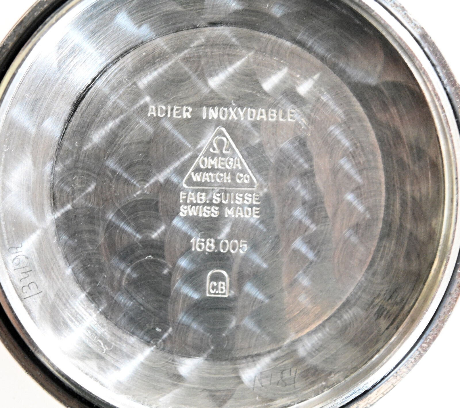

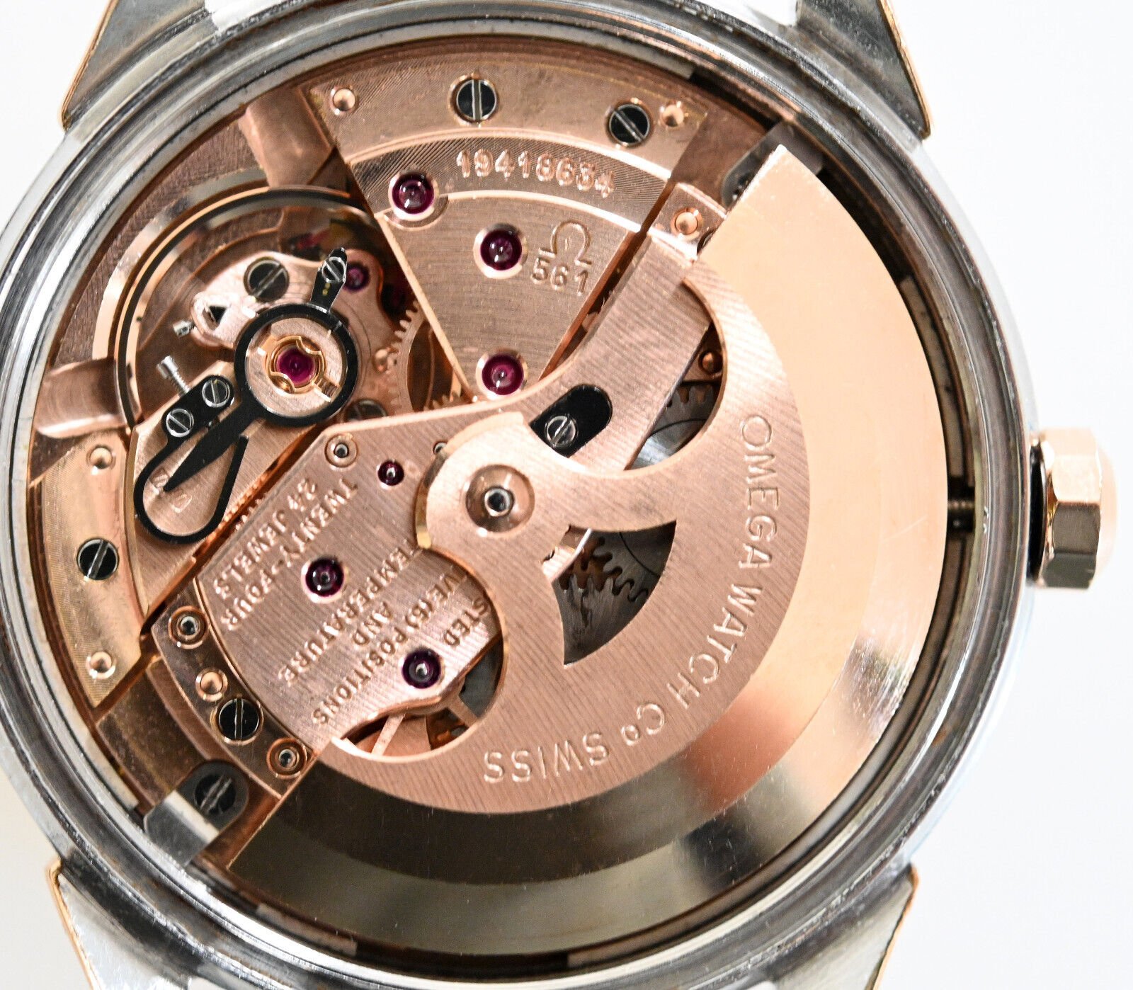

here's more photos...

Because it is not gold plating - it is a gold capped case.
A much thicker layer of gold bonded to the case (200 microns IIRC, against 20 microns of typical gold plating)
You can see the thick layer of gold on the side of the lugs in the movt pic posted above.
18,835
39,172
Although gold capped cases are generally "softer" than the sharp edged gold and steel versions, this one has seen too much time on the calico wheel.
somewhat thick gold capping / cladding over steel
thick enough to be heavily polished a few times before wearing through

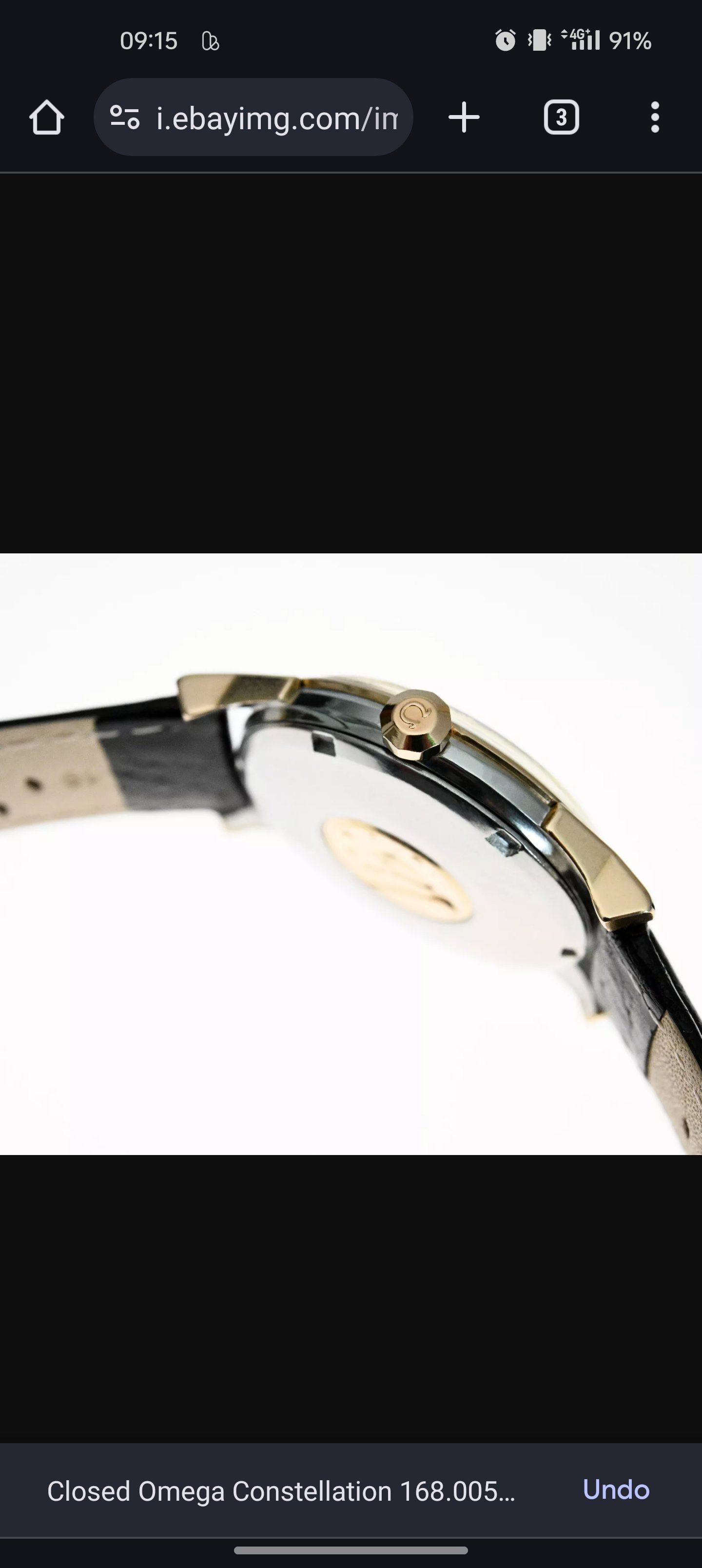

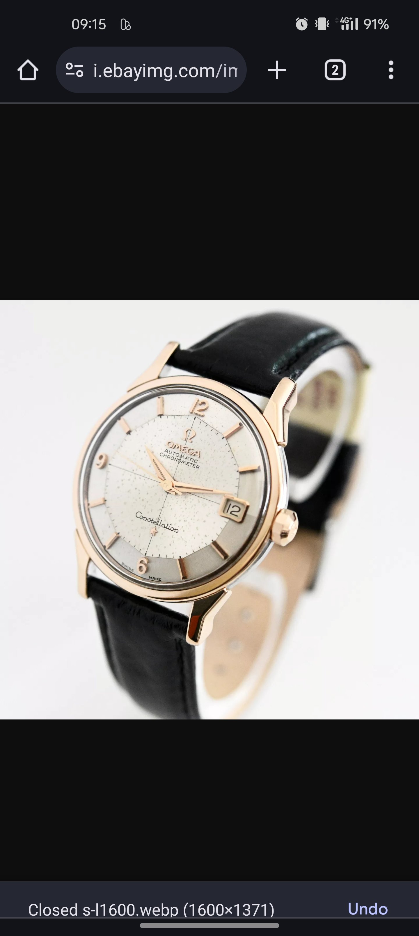

https://www.chrono24.com.hr/omega/constellation-pie-pan-18k-cal564--id33318708.htm
saw this one the other day, massive gold, serviced and the price seems bit low comparing to others... any thoughts?

Hey hey, could be nice to open another thread about it with pics uploaded but here we go, my opinion is:
- The dial looks aged and not very well (signs of corrosion as small dots all around)
- Crown looks like a replacement and not an aesthetically pleasing one.
- The case doesn't look too bad. Somewhat sharp edges. But it could've been nicer if seller added more picture of the hallmarks on the caseback. We would also like to see more about the hammer no of the case maker etc. beyond the 18k engraving.
For that price, not sure if it would be a worthy deal.
