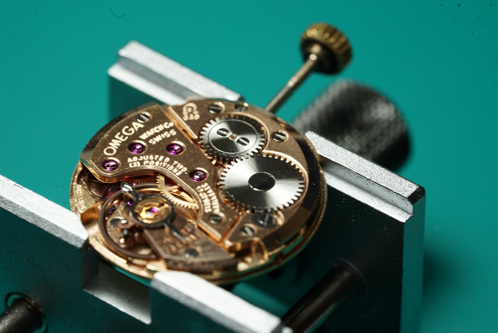

Having just finished my first ever overhaul of a mechanical movement, I want to find a nice home for it so that I can actually wear it!
The problem arises that I chose an Omega 620 movement due to the comparably low price that these movements can be found at due to them being featured predominantly in ladies watches.
I am aware of the De Ville 111.077 case that had movements this size mounted in them, however I have been having trouble identifying other mens sized cases that I could mount a 620 into.
As this is more a learning exercise for me than a collecting exercise, I have no concerns about this becoming quite the franken-watch. I would just love to be able to use my first ever serviced movement.
Any suggestions of how I might find a way to mount one would be greatly appreciated. dX0gyKO

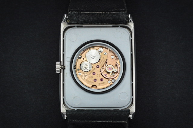

Cal. 625 is used in men 111.0116. Here’s a photo how it’s mounted if that helps you.

Thanks, I'll add that into my auction searches
Might be a challenge since the crystal isn't round and finding a nice crystal for these ones looks pretty difficult.

I have recently bought case with crystal already fitted. I think there will be more problems with plastic that keep movement in place.
