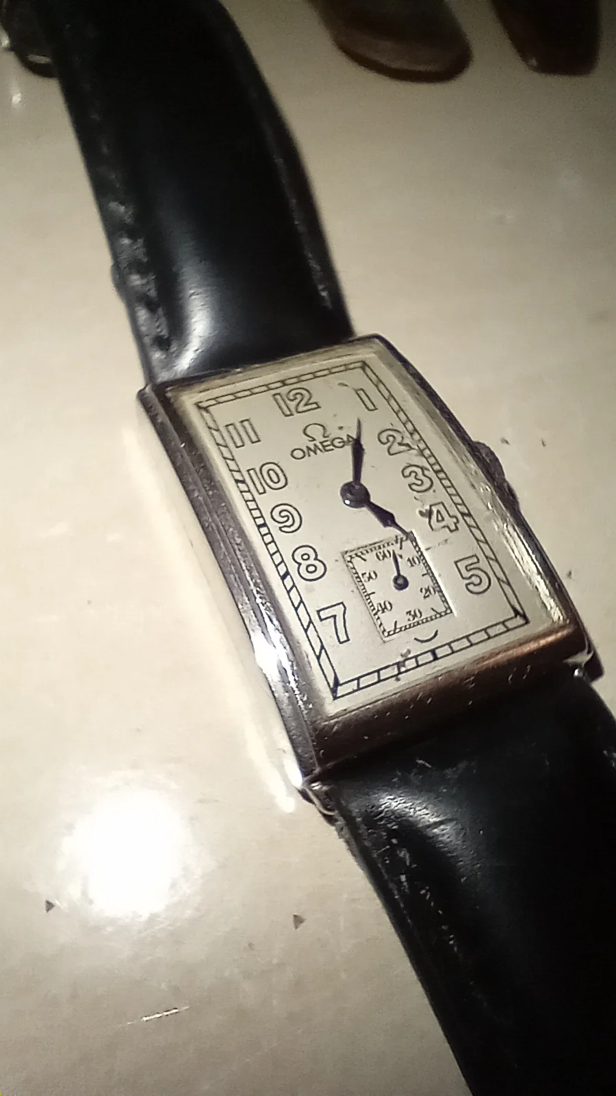

When I was 17, my father gave me my grandfather's Omega 20F in a derelict state. Aged 50 and with a little more money in my pocket I had it restored, but as an heirloom it's too precious for me to wear every day, so I set out to buy a similar watch I could wear. I bought a T17 again in a terrible condition and had that restored. The dial has a new style logo, which is fine - I'm not trying to hide the restoration. Recently I spotted a dial on a well known internet auction site that was advertised as being for a T17. It was expensive, but near perfect and very nice indeed - so I took a chance and it turned out to be even sharper than the photos. The only problem being it is for a 20F movement not T17 as advertised. When I had grandpa's watch restored, I struggled to find parts, so when another derelict 20F appeared at a reasonable price, I bought it. I now have a fabulous face that I suspect was taken from a gold watch scrapped for it's case and a movement, both of which deserve to be used... Looking at the old catalogues, I suspect this dial would have been available in both a stainless steel and a gold case, but I can't find this design. Does anyone have an old catalogue that shows my dial on a 20F (how do you even know which movement was used in the 30's tank watch sales brochures). I'd love to find a case of similar design to match the dial.

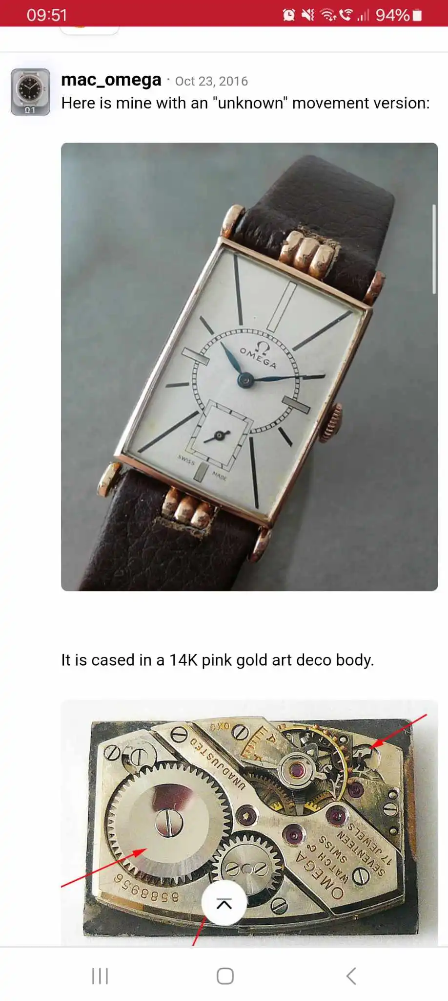

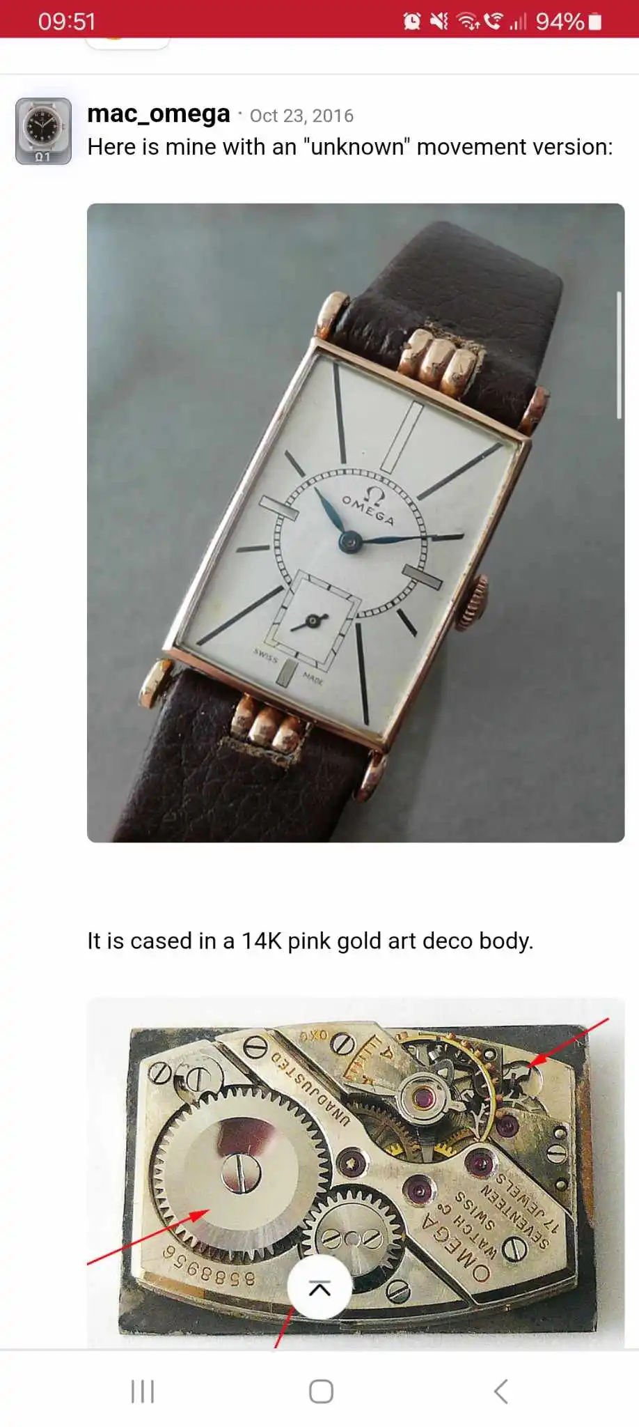

Having said I couldn't find the same design, I found this previous post and it is strikingly similar... The movement however is T17. It's very confusing trying to work out what references align with what movements in the old adverts. Are there any simple guides? Case wise this is nice, but I'm not sure I'd want anything quite so busy.

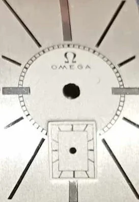

I would have done exactly the same as heirlooms are priceless to the recipient! I know the new style logo would always bug me too as it is not about hiding the restoration but you always have a sense of fooling yourself that something is not right or complete. Just bear in mind that for everyday wear, these models will require more care and attention than your average vintage piece as they would not be shock protected from lacking the incabloc/similar shock proof as the shock protection of that time just served as a dust cover. Also make sure that there is a case tube encasing the stem for additional dust proof measures as they were not mainstream inserts of the era! . At the time it was a common expectation that because of how these timepieces were structured ( such as non dust protected case) they required far more maintenance than what a more modern automatic/modern quartz watch of today. This would explain why a wrist watch was also a status symbol over an everyday tool not necessarily affordable for everyone.

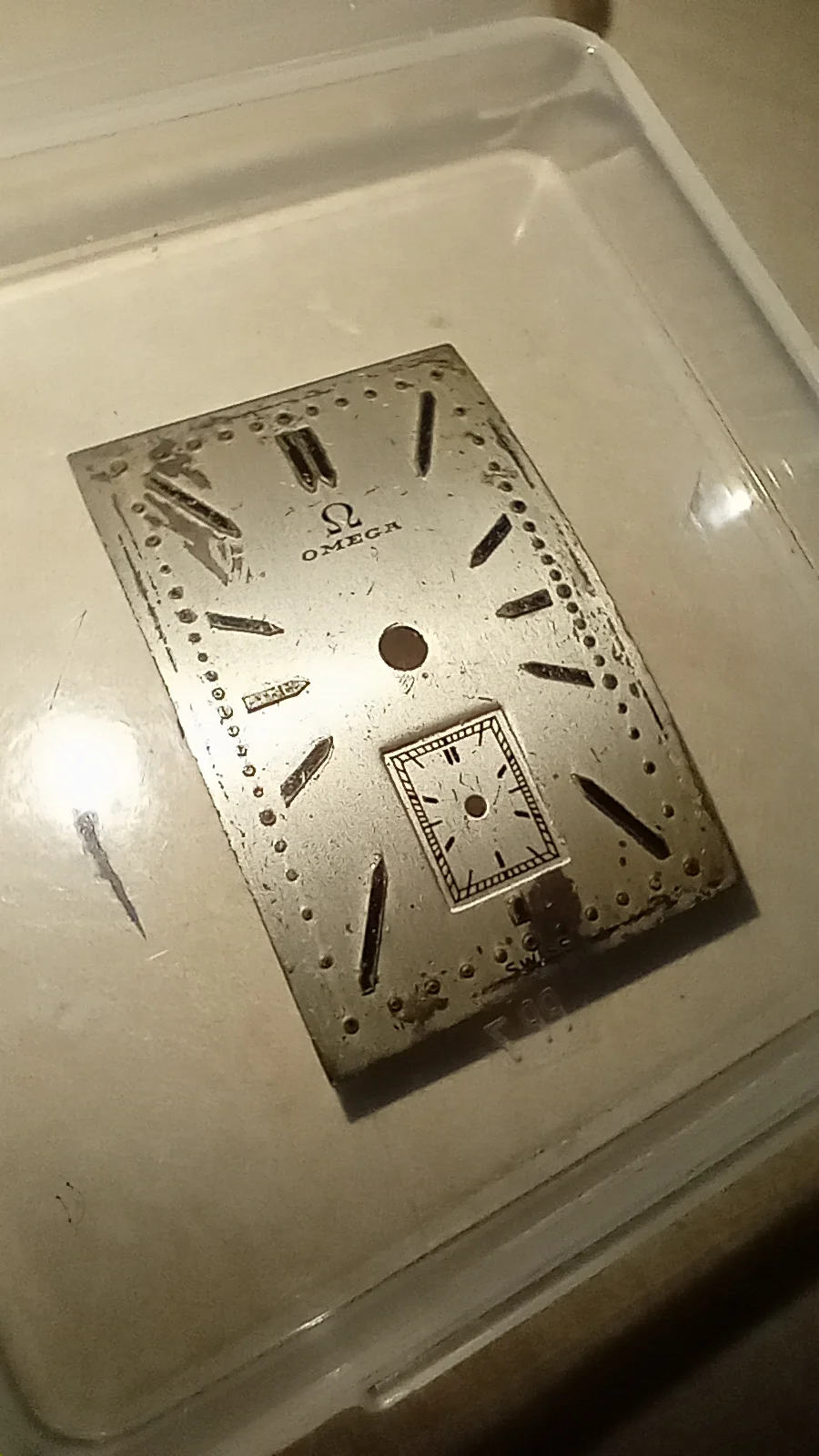

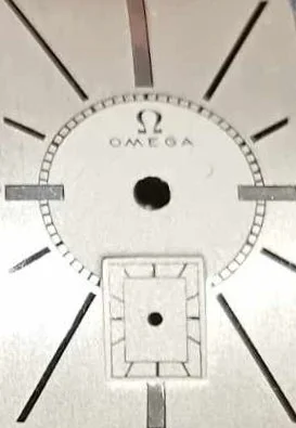

Is the image you provided of the dial you have recently purchased? If so, a clearer image would be helpful for others on this forum (to help you) that have a sharp experienced eye for verifying if it is a restoration or a mint original. I am no expert in commenting either way which is the case,. but before you go out incurring more (unnecessary) expenses I would want to make sure that it is an original and not a reprinted dial. If the balance of probabilities turns out that it is a mint original, then I would go to step 2 to continue the quest of completion.
This problem with vintage Omega models is not just restricted to 1930's models. Just like others who have worked on these projects, I have had nothing but expensive headaches trying to mix and match dials with cases even from the same series as no two models of the same series are alike!!!. For example a dial from a 56X caliber movement from the same vintage series reference number 166.002 will not fit into a 166,009, Even when using identical looking Seamaster cases and Geneve cases, you will find that it is the luck of the draw as different model cases had different shaped dials as well as different sizes.. This was a huge shock for me as I had worked on other brands including Rolex where the Datejust series have the same run of dial measures and case measures as long as you stick to that run of vintages. NOT Omega!!! As much as Omega is one of my favourite brands, it is a nightmare when mixing and matching parts unless you know just about every model like your hands. My initial horror reaction when I first worked with Omega models was that these watches of the time were built from parts that fell out of a raffle barrel and put together by trial and error, where what was left over sold as spare parts. Before I close off (sorry for being long winded), even if you do find a similar case that appear to fit both your movement and dial, you need to make sure that the case has exactly those dimensions to fit the dial as well as the housing for the drawer where the movement fits. As Don mentioned, you will be paying high premiums for these types of demandable pieces just to gamble on if the case fits. If else fails and you cannot live without wearing that same model you inherited, your best bet is to buy the watch already complete when it comes along at the price you are willing to pay and keep these parts as spares as you may never know!! Good luck and let us know how you go! I empathize with you!!

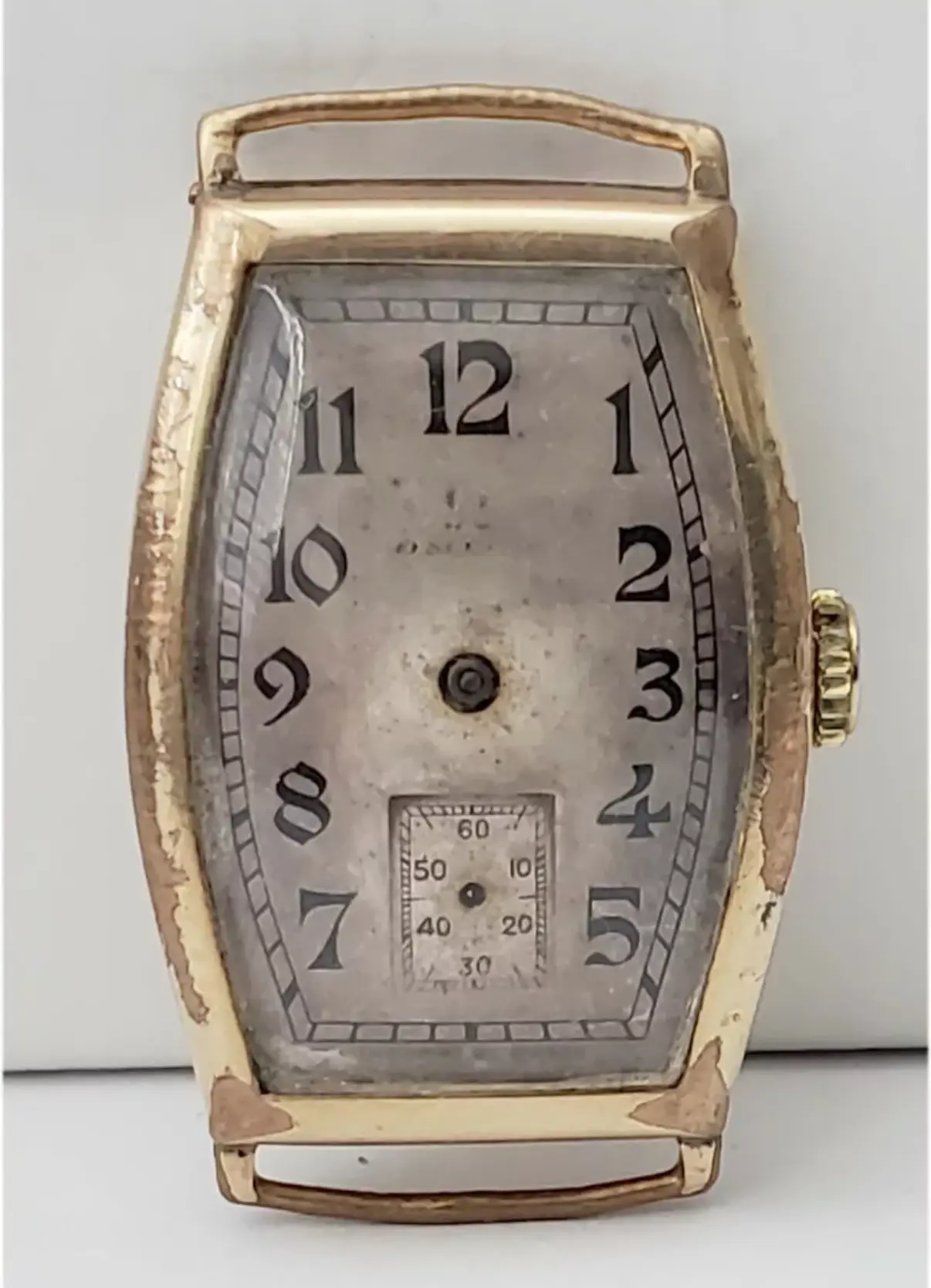

There is an omega 20F case, movement and dial for auction or best offer on the Italian Ebay site with eBay item number:286280068463
with starting bids starting from around USD150. If it is what you are looking for, make him an offer before the auction begins. It may solve your issue!!
(disclaimer: I am in no way affiliated with the sale of this item either directly or indirectly and purpose is for informational use only)

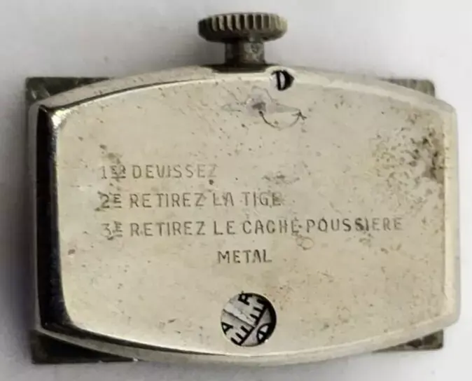

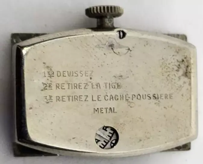

Good question!!! I have only seen the T17 and the 20F and one shown below encapsulated in a cage of some sort, which may be something different or could also be either one of them? I believe the OP now has enough ammunition's to find what he seeks

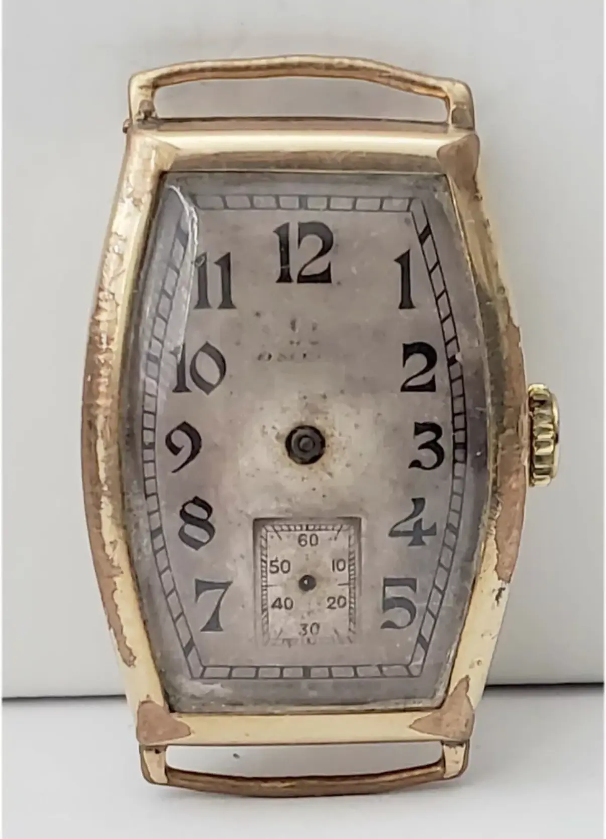

That case is in pretty rough shape:
If you buy it, you’ll need to become acquainted with ReplateIt.

That is the dust cover on the T17...

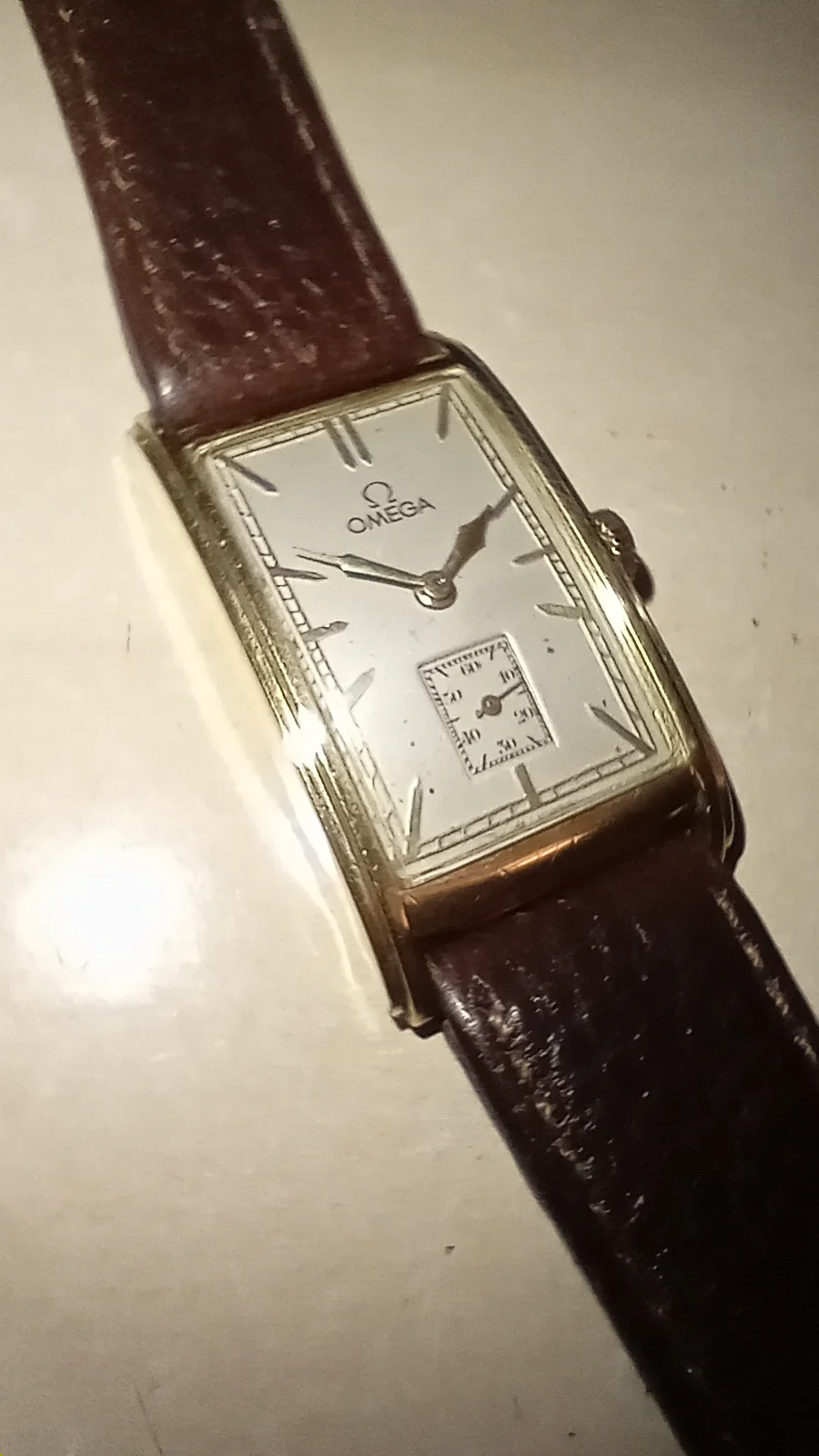

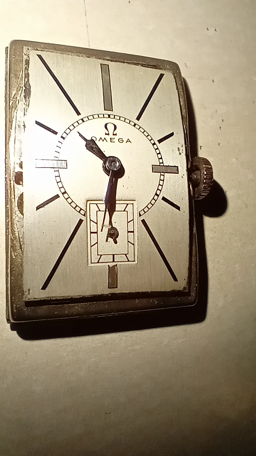

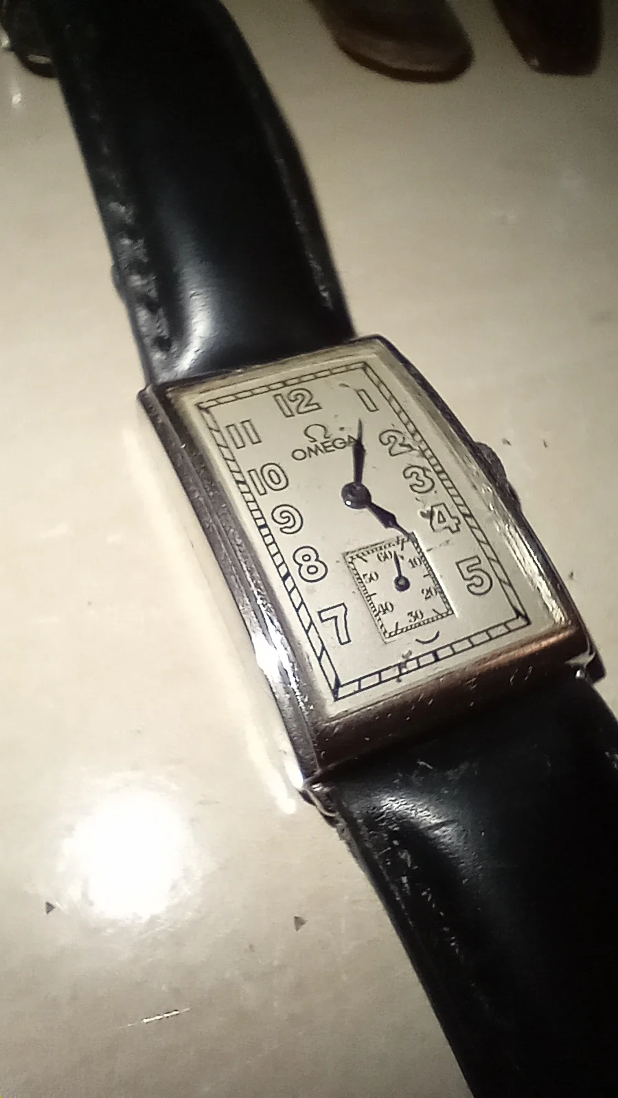

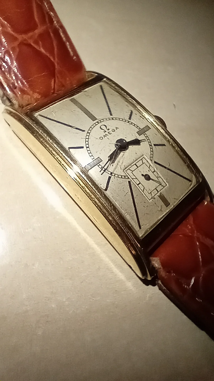

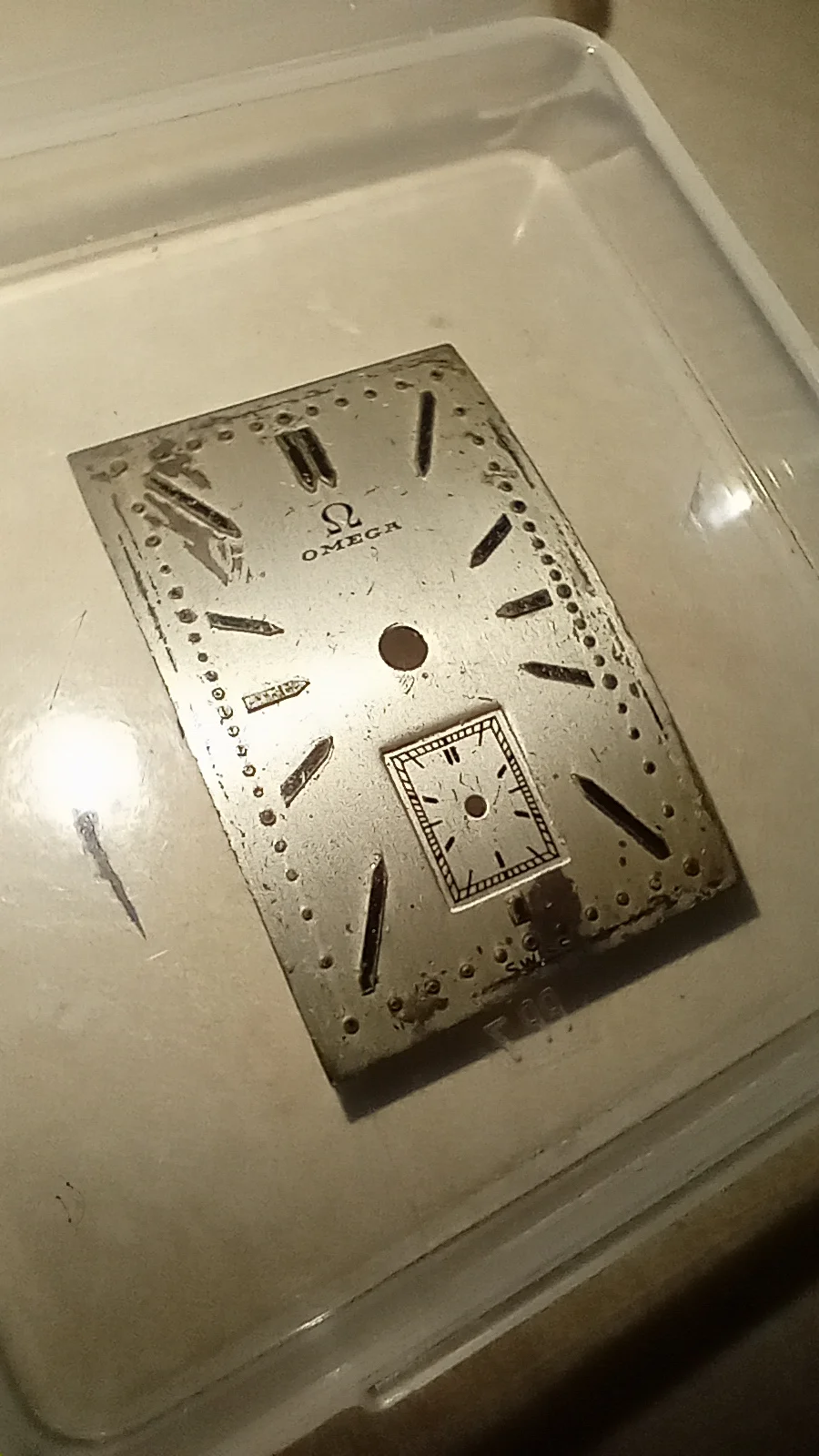

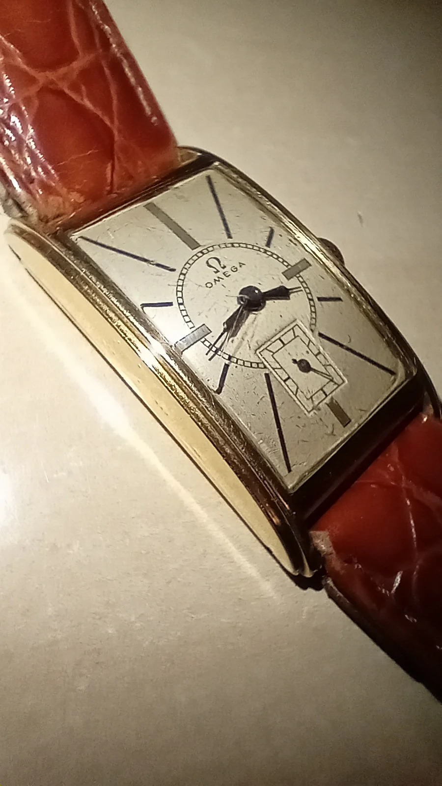

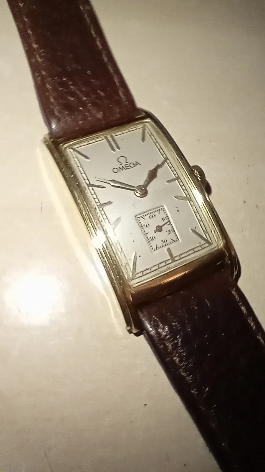

Now to be totally honest (with myself) my Grandpa's watch was just the start... after getting this T17 to wear more often...

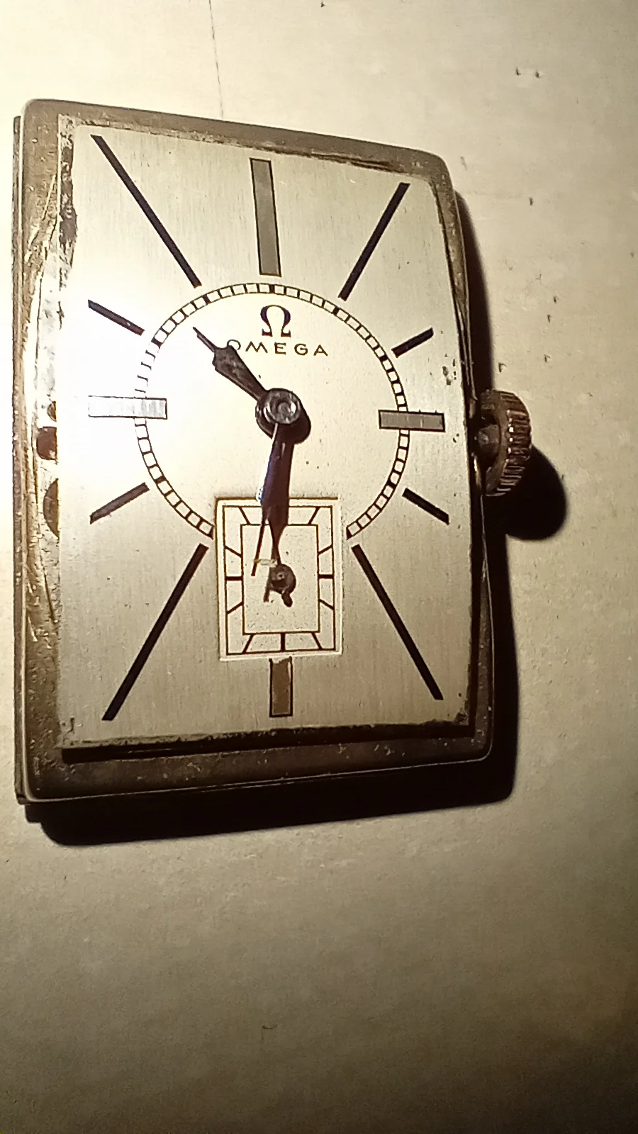

(both dials restored as you can see...) I bought a second 20F from eBay at a very reasonable price with a case identical to my original, only the dial being slightly different. It's in original condition with a little patina. I wore it for a while but the acrylic crystal is a little damaged. Having recently bought the dial in question, I had it fitted to the second 20F to see how it looks.
It seems a little in poor form to modify the watch, so I was hoping to get a pointer from here as to the case I should seek out for the dial, to revert the second 20F back to the slightly work but original dial. It seems unlikely I will get the correct case from what you all say, and an appropriate case that fits is a lucky find. I guess I'll leave it like this for now and see what turns up. From the light brushed lines on the silvering, early logo, mirror finish in the quarter hour markers and rubbing at the edges, I think it is probably original but do let me know what you think. What a shame it was taken from it's case.

Dial is original.

Yes I realise that!! I was trying to see what other movements Omega brought out apart from the two in mention as I have only worked with one of them.!
