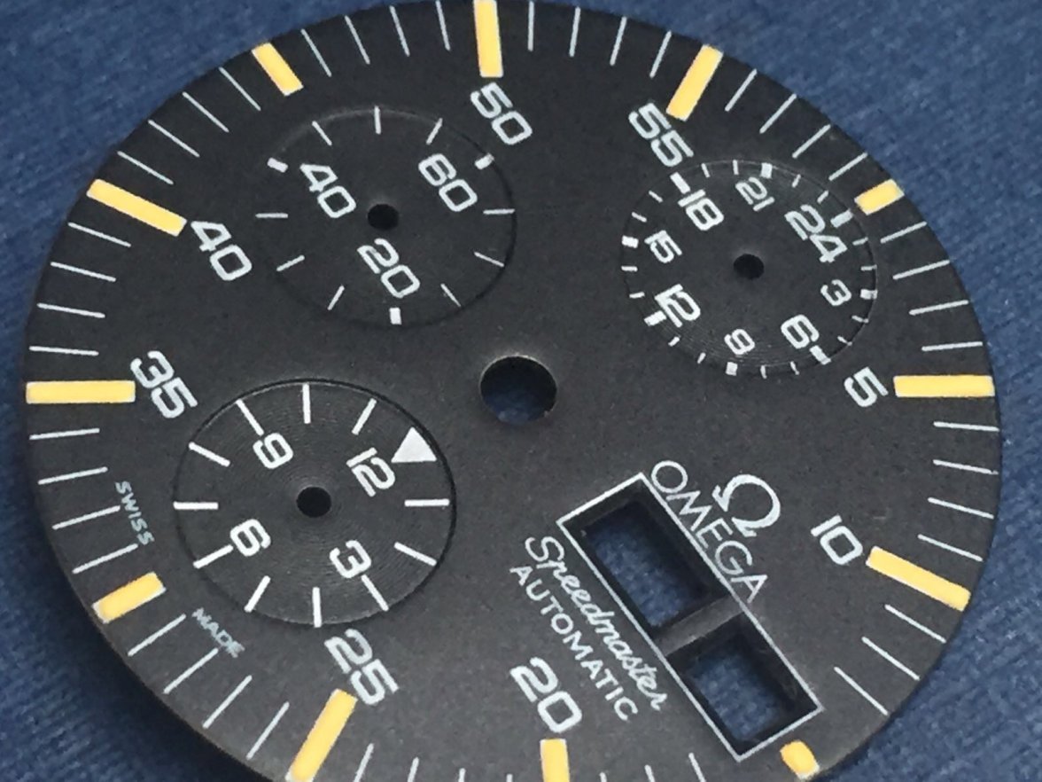

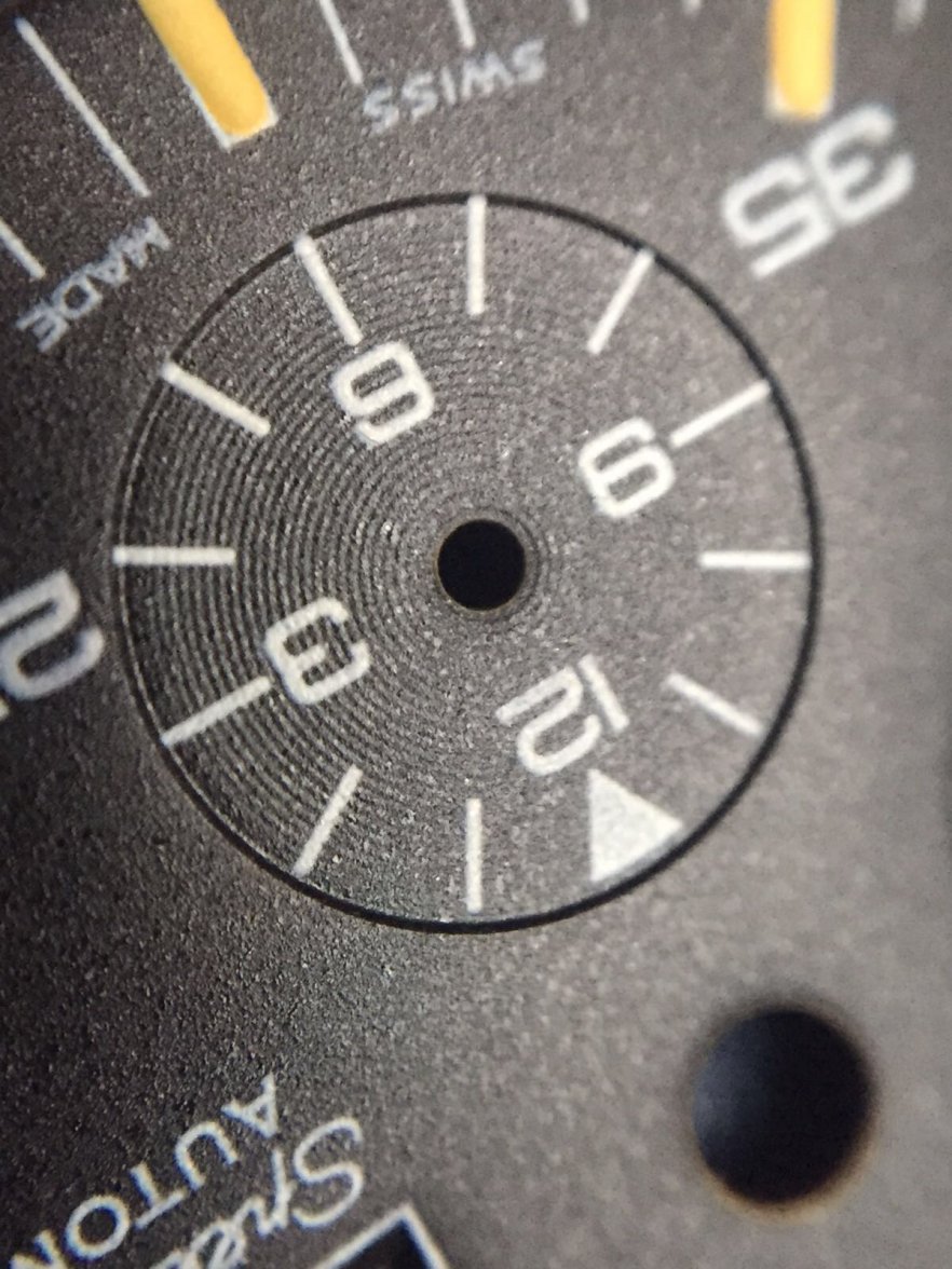

The Grail, as we know, is exceedingly rare to begin with. If it can be established that my dial has never been refinished, which I believe my photos indicate, this lends credence to the prototype dial theory.

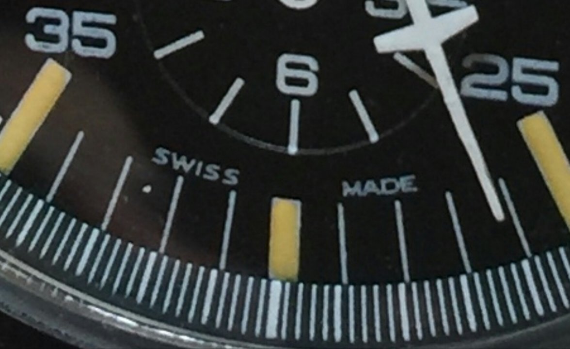

Just like @TsoloT indicated, the OP dial is a redial, poorly refinished one at that.
Uneven paint layer making the dial surface not flat (second picture below has the impression that the dial is bent). Poor print quality, wrong fonts, no serif on these words OMEGA, Speedmaster, AUTOMATIC and SWISS MADE. And Swiss Made specifically, very very poor quality with smear all over, can never pass for a quality original Swiss dial.

I must agree with my sharp eyed forum member and the merger of the 1 and 2 the 24-hour position with the low-density of the prints
Is clearly an example of the low quality referred to
I am also deeply suspicious as to the colour of the lume ......was this constructed at the time tritium was still around Because as far as I know nobody could have accessed tritium for the last 20 years or more And this lume is remarkably uniform in colour and texture And the usual lume printing from Singers where this dial supposed to come from is usually very very poor for this particular model Dial

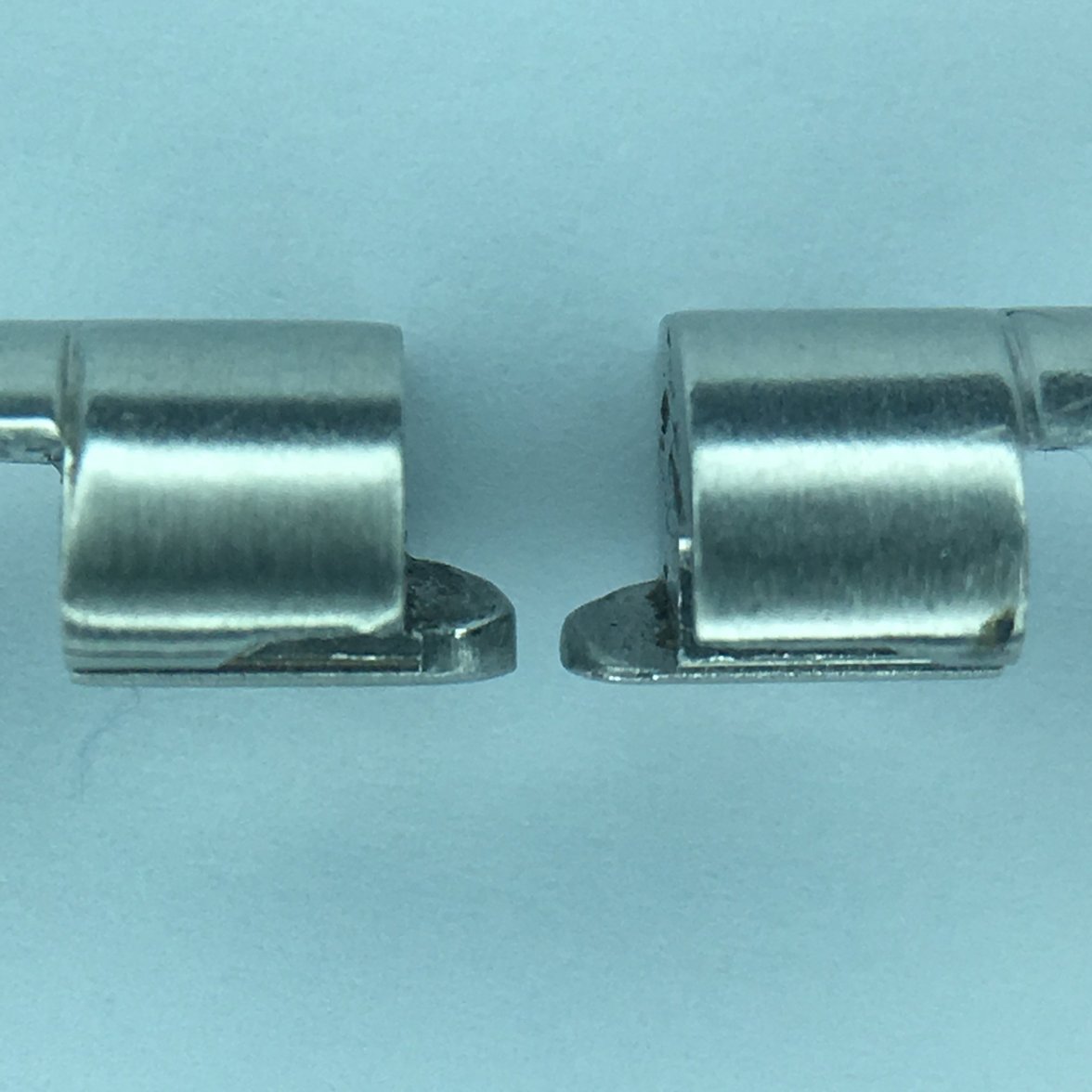

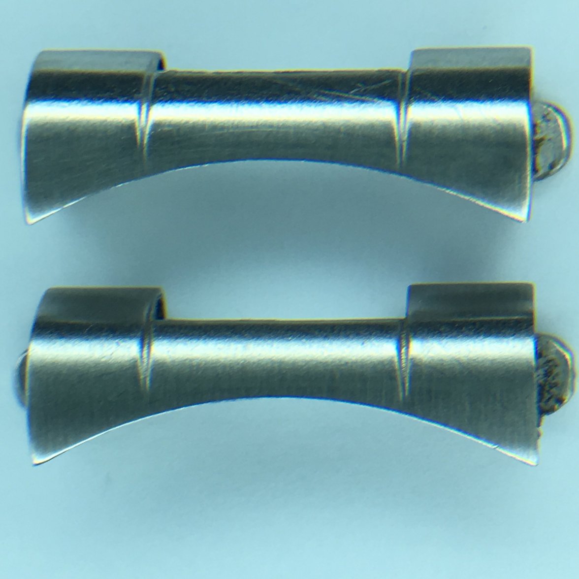

Whilst you are at it can you and the forum look at the following and tell me which is correct for the grail as an end link for the 1450 bracelet
And also whether the 1450 was the only bracelets

If you've been paying attention to this thread, you'll see that the plate is indeed completely different than the normal factory grail dial. Pay close attention to this detail, as well as the black pebble (non-matte) finish.
