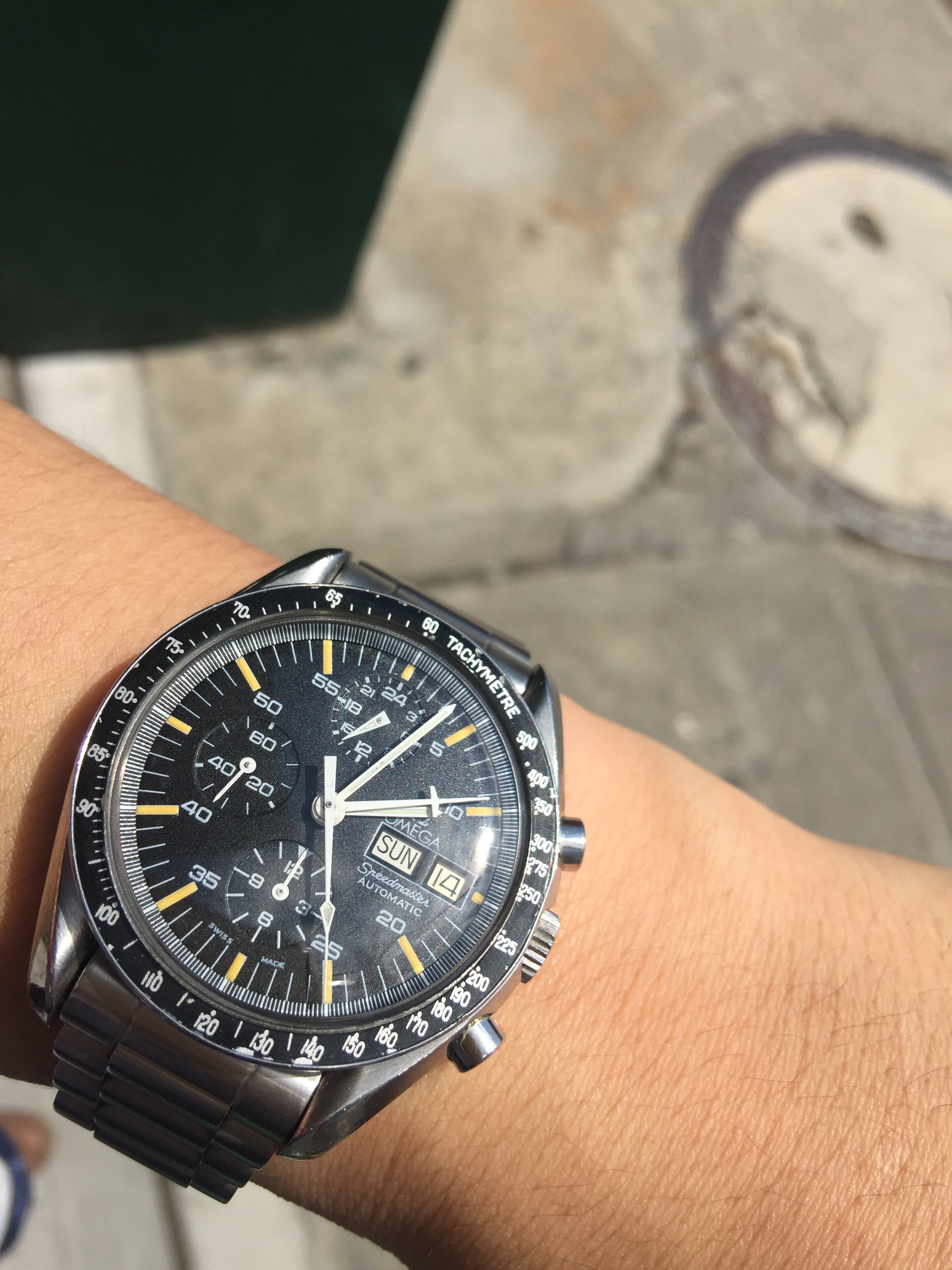

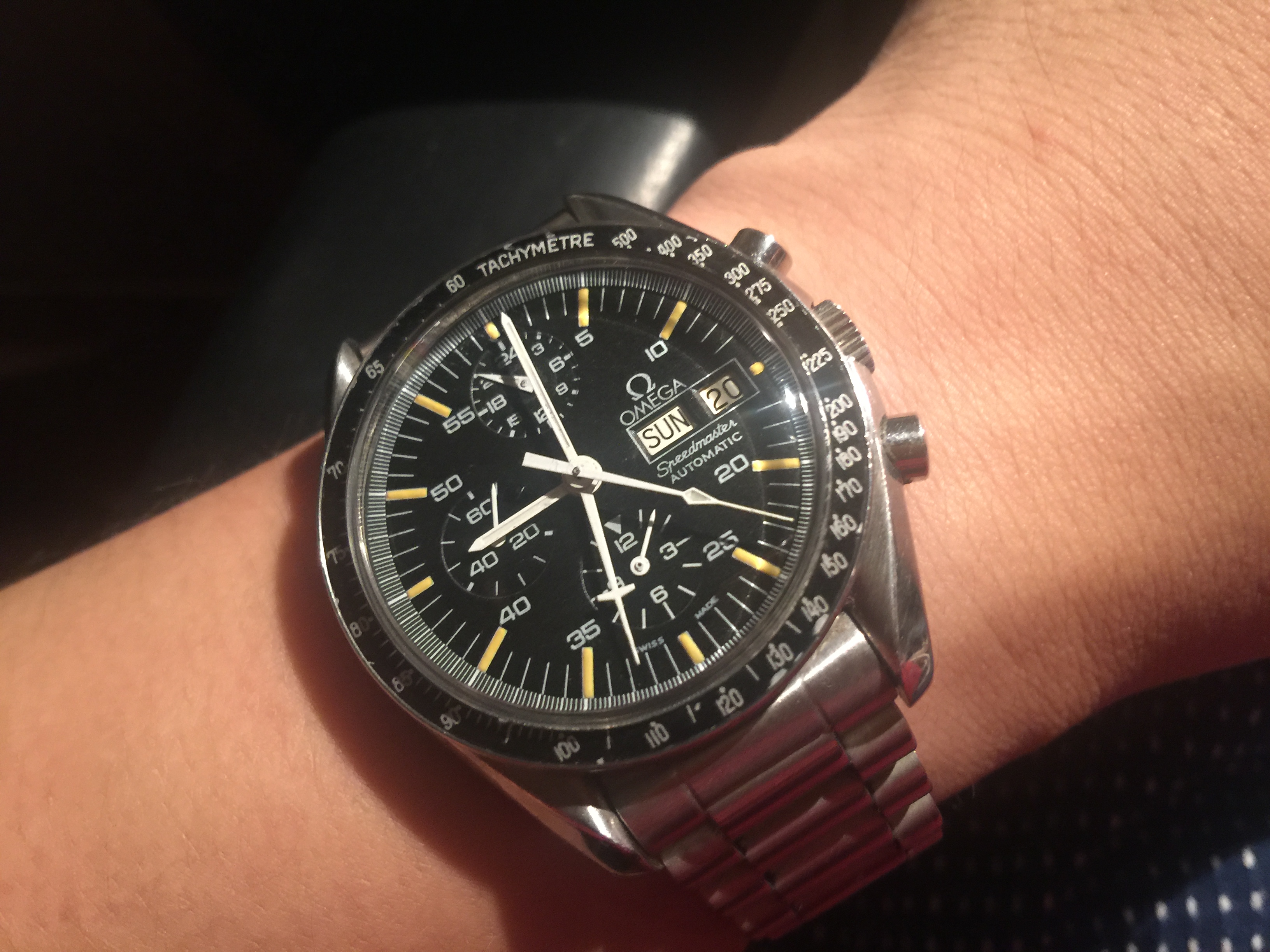

Everyone knows and acknowledges that the "wedged 2" is your typical factory original Grail dial. Nobody is disputing that -- I own 3 of these typical Grail dials myself. As I indicated in an earlier post, upon closer inspection, the concentric rings are present on all 4 dials.
I am trying to explain that this 4th dial that I own, which is the topic of this thread, is extremely unique and may possibly be one-of-a-kind or a rare occurrence for the Omega history books. This dial has NOT been refinished, is a non-service dial (10-marker intact), and has a correct faint "SINGER" stamp on the backside. What's special about this dial is the deep shade of black finishing used on the surface. Also, the texture of the dial surface is NOT matte like the traditional Grail dials, but rather, very light-grained -- a very fine pebble finish is the best way I can describe it. Highly unusual and the only example I have ever seen in my 5+ years of pursuing the Grail. See my pics above of this dial mounted into my Grail watch. ^^
And would you care to explain the none wedged 2

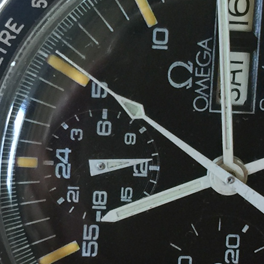

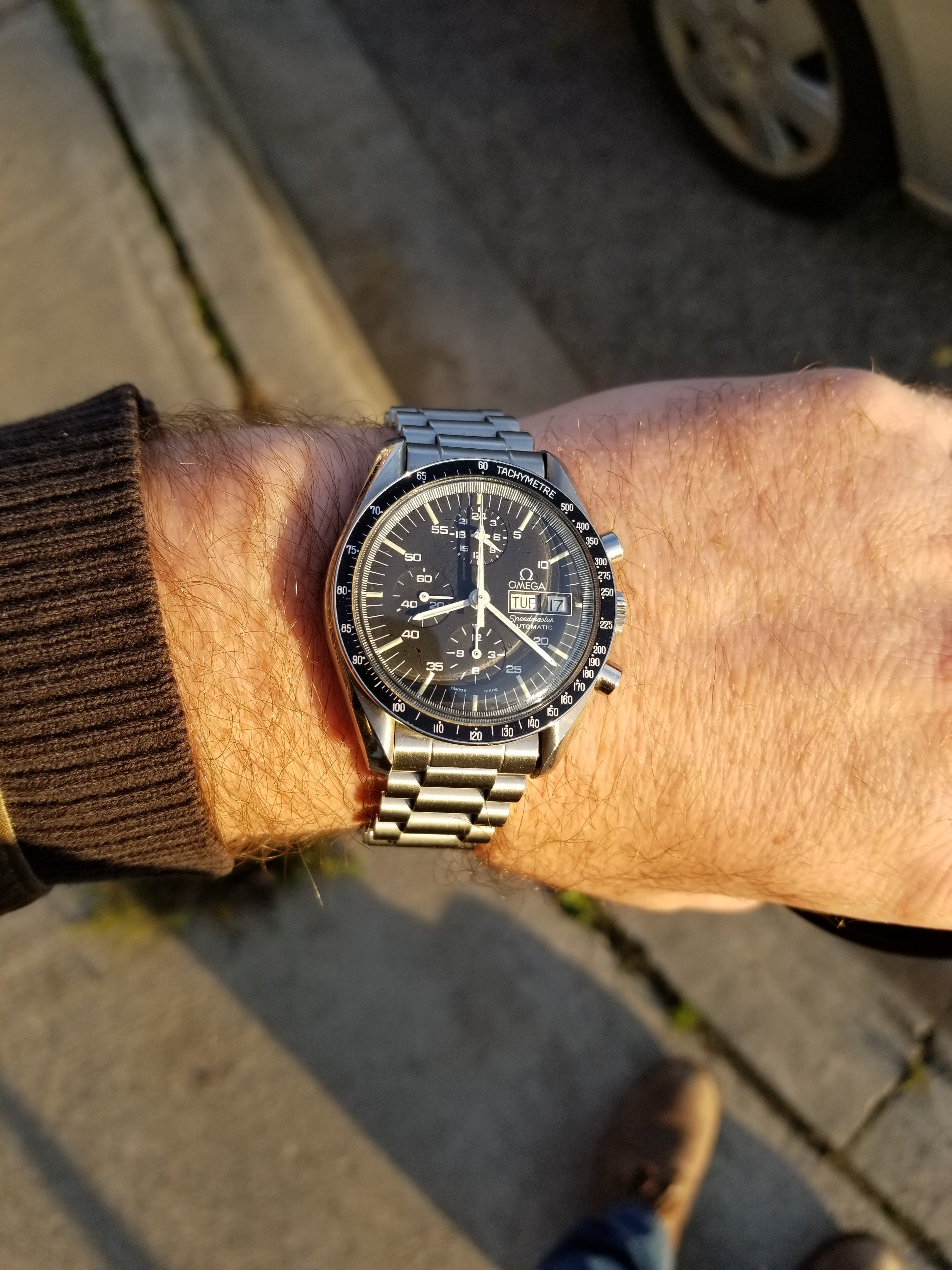

OP's 24 hour subdial
my 24 hour subdial
definitely different with regards to spacing between the 1 and 5|12.
@OmegaRolex, when we get into "one of a kind" territory, there is one explanation that is much more likely than the other.. it can be painful to accept, but a prototype is, IMHO, unlikely.

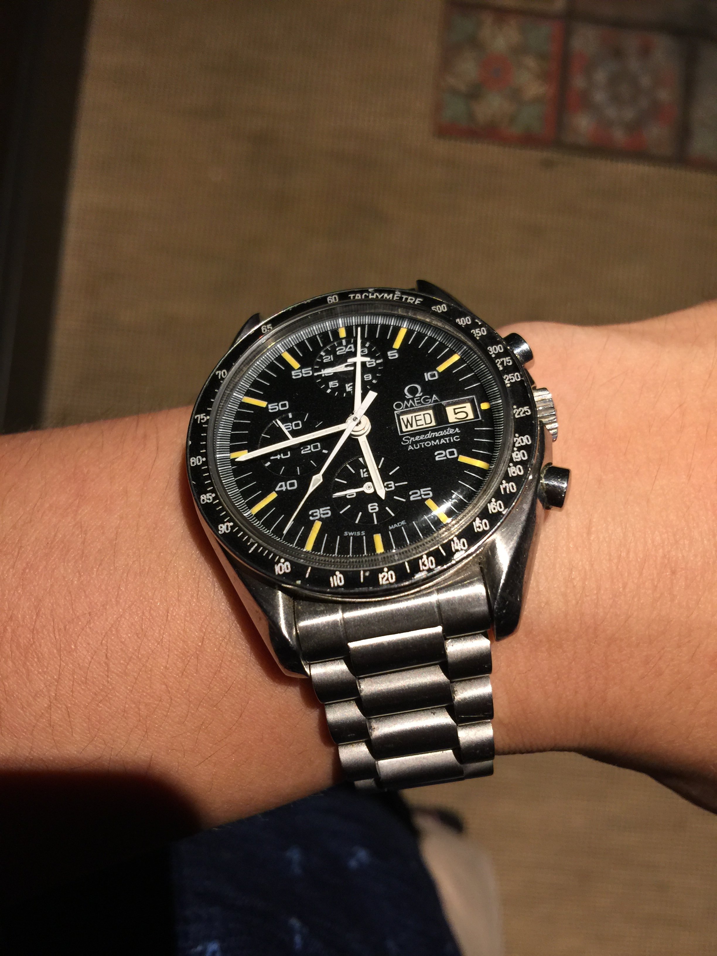

Well firstly thank you for the photo ..secondly IMHO this is a reprint and a relume ...sorry it sounds a bit over analysed but the 2 are not always present
The density of the white print is insufficient and I am otherwise impressed by the scale and position of the fonts this is better than some I have seen and of course it is a none wedge 2
The lume plots look slightly disproportionate especially at the vulnerable 3 o’clock but the 24 hour counter seems to be the most obvious tell tale as there is print over run at the 3 6 9 and 12 could I have you permission to reproduce this photo
Small point ...Your top Pusher looks to be a bit deeper set than normal ....might be the photo angle
Thank you in anticipation
This is not meant to pick on you OmegaRolex. I normally refrain from criticizing
anyone's watches. But these 376.0822's do not have much discussion about them
on the internet and the knowledge base on these is slim. This thread you started is important
for posterity and information purposes. Consequently, I feel the need to weigh in on this
dial. The print quality is Very poor. There is black showing through all the white printing
on the dial, so it is very thin. This is not Top tier watch manufacturer quality and would never
be used by Omega. The prints also don't have clean straight edges. If viewed from an angle
with a loupe, dial printing should be raised enough to reflect light. I see no evidence of that
on this dial. Since the watch wasn't mass produced, using the original Singer dial plate to
re-print one would almost be a necessity.
Just a guess from observation but I would say at least 30% of the 1100 Grails have non-original
dials.

There's nothing "painful" for me to accept. I own 4 authentic dials and this is merely 1 of 4.
I repeat again. This dial has not been refinished.
my 24 hour subdial

How do you explain the pebble finish and darker shade of my dial? By your own acknowledgement, you seem to agree that this is an authentic Singer dial, "reprinted" or not. Pay careful attention to the intact 10 marker which is missing on all known service dials. The printing on this dial is completely uniform -- it has not been touched up. Your point of using a loupe is nonsense, as close inspection of any factory dial will expose underlying (normal) defects with manufacturing. I have yet to see macro examples of dials other than my own.
At this point, I am leaning towards the conclusion that my dial is an original and rare prototype factory dial. As I mentioned before, in my 5+ years of searching for and owning the Grail, I have never come across another example like this one.
the modern service dials have the 10 as well. see my post above where i show a Mark V dial (missing the 10), a modern service dial (with the 10) and an original (though unfortunately relumed) dial. Some service dials do in fact have the 10.
Easy way to prove it. Get the extract.

No service dial is tritium. Mine is.

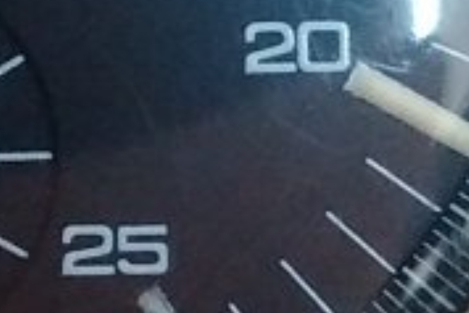

Here is one of Oddboys pictures from this thread.
See the light reflecting off the raised print only on the right(light side) of the 20?
