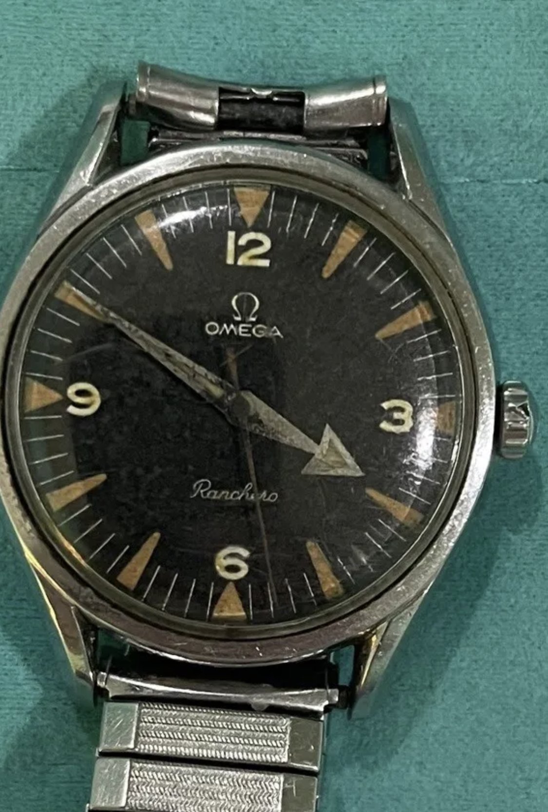

Ranchero with unique dial layout

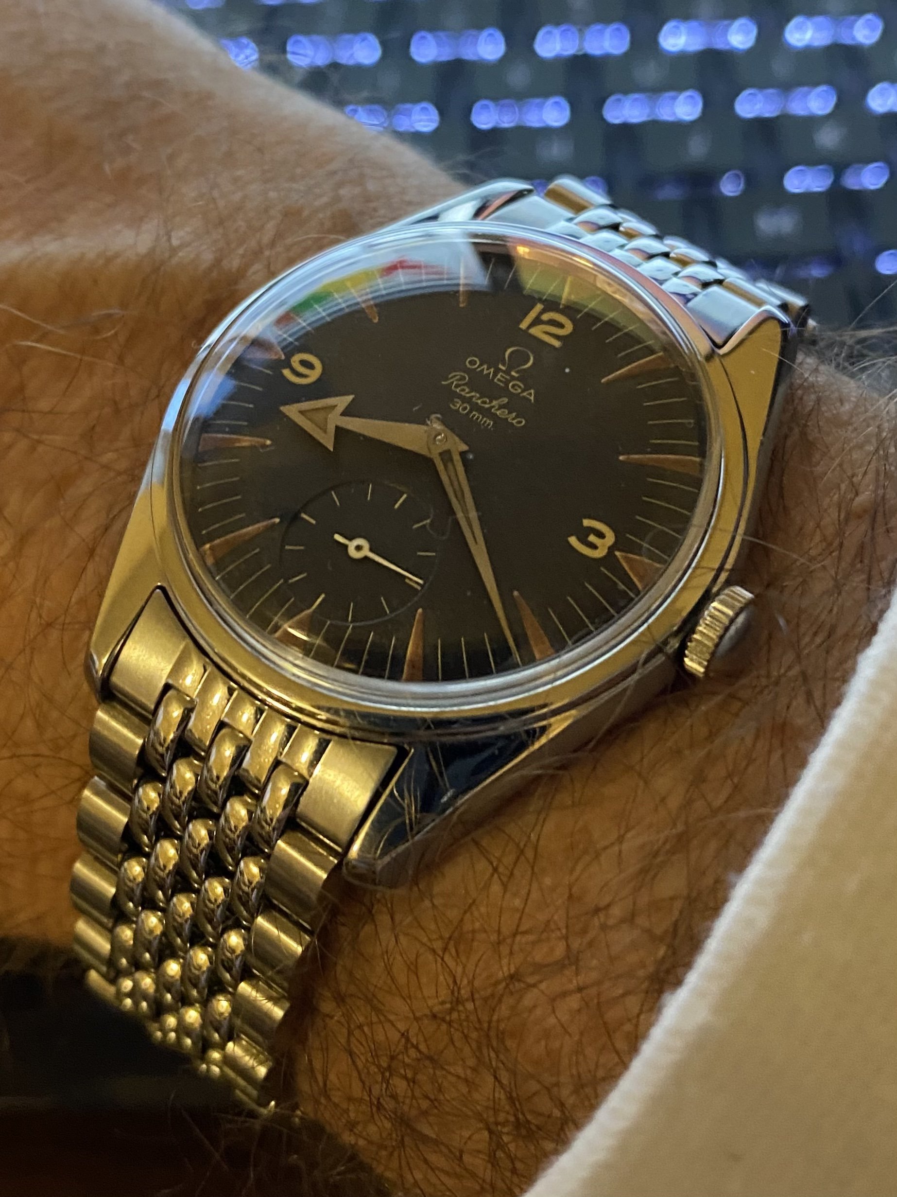

Looks like a 2937 case (an authentic Ranchero would have a 2990/2996 case) with a redial. Ranchero font is suspect and I can’t recall ever seeing one without the 30mm dial text. My CK2990 Ranchero for comparison:

Agreed I thought it was strange to not have the 30mm text but the piece overall looked convincing.

Fairly confident it's a redial; I'd been watching that since it posted as well.
