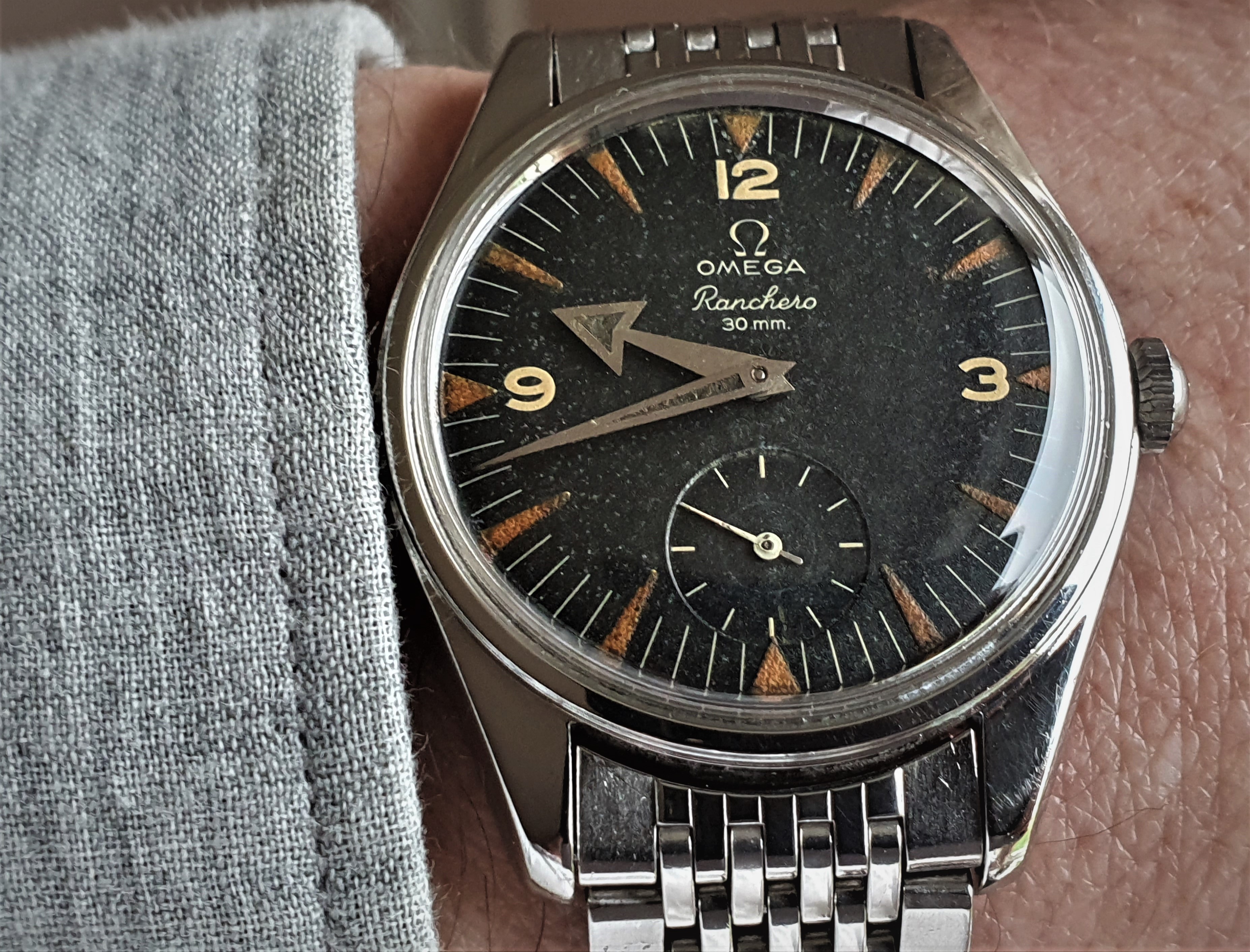

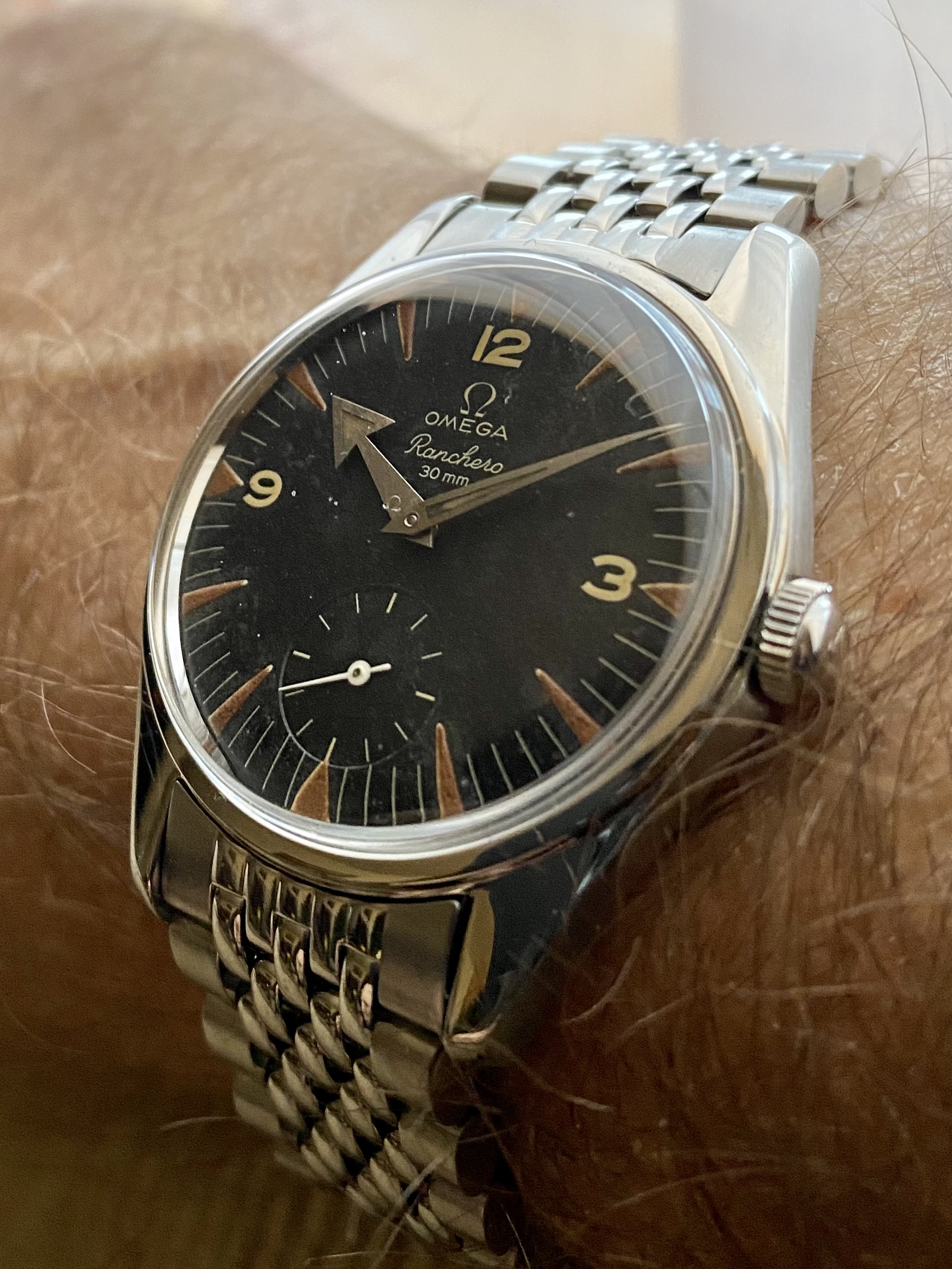

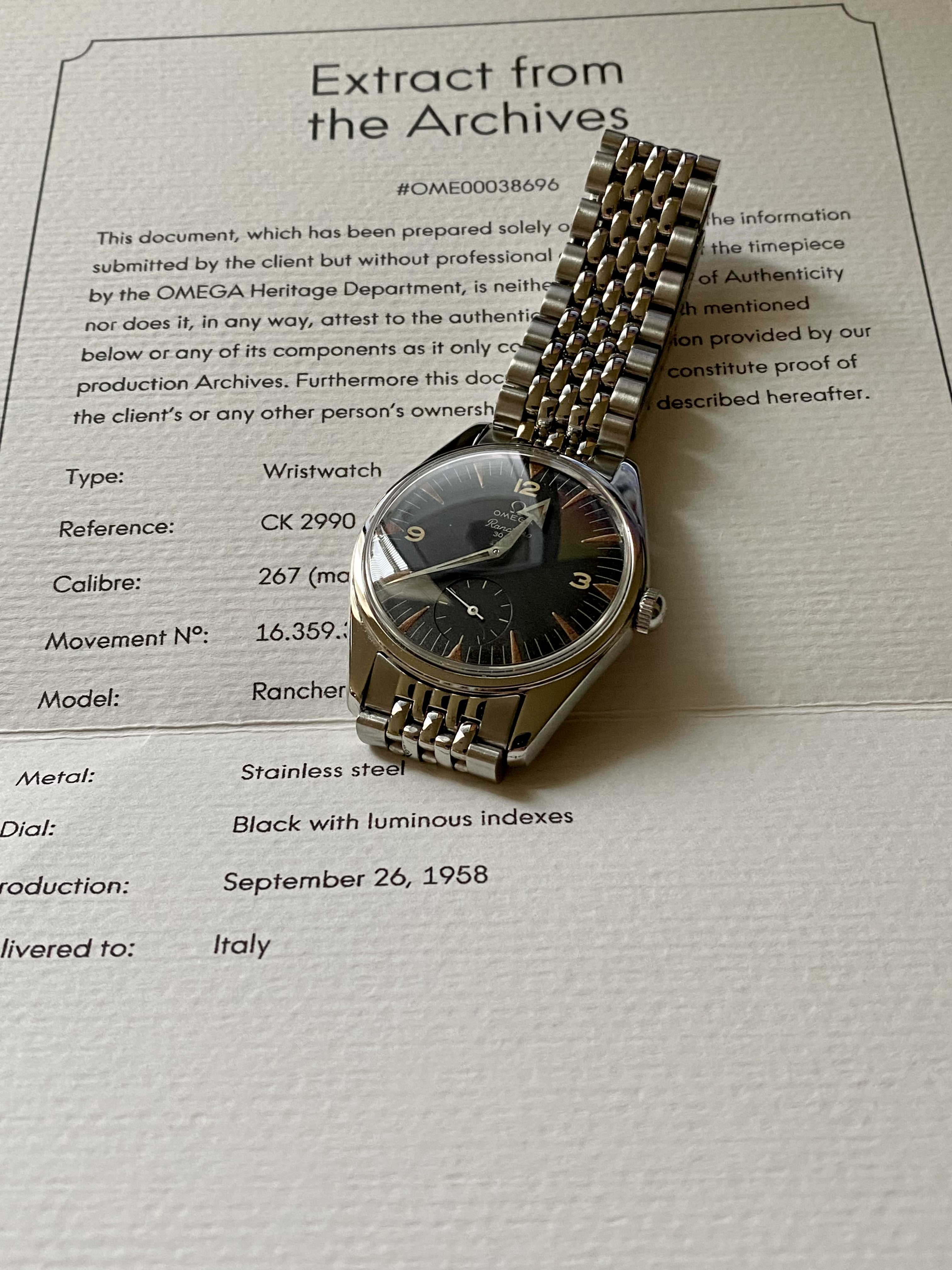

Hi there,
Great, thanks for sharing. 馃榾

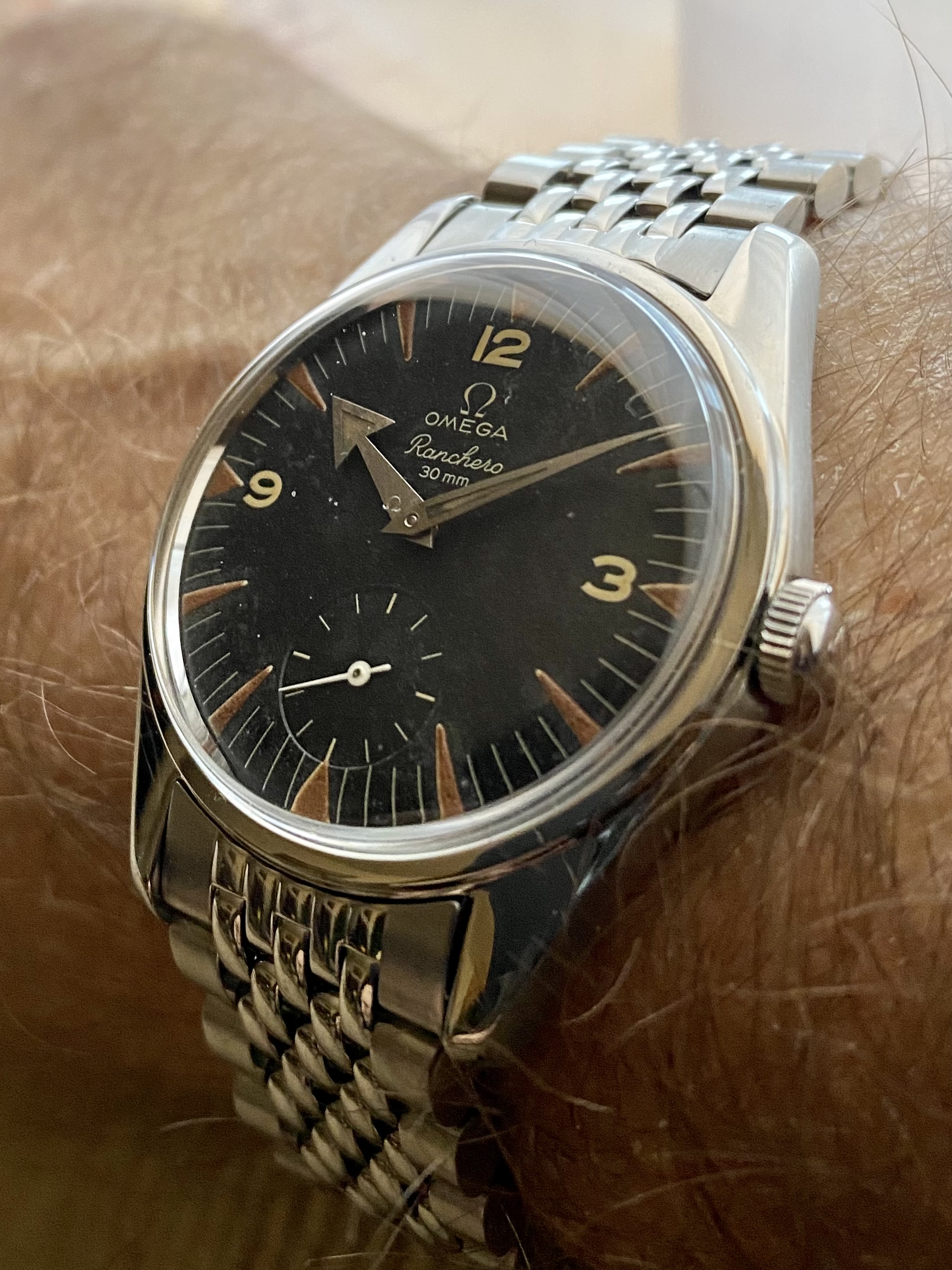

Nice bracelet, Rancheros look superb on bracelets despite never being supplied with one originally.
I believe I have the details of the Portuguese delivered one, was it delivered 30th January 1959 ? Details of the other would be appreciated 馃憤
398
2,224

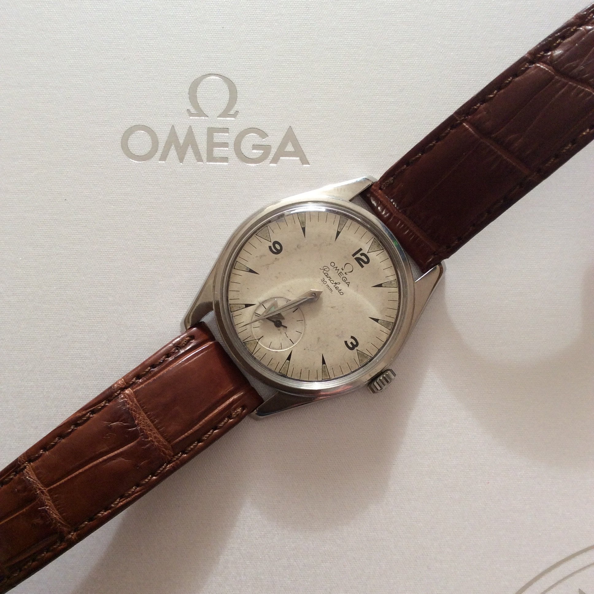

Hi
yes! is the same sold from Bulang and Son
end link 4 are not for Ranchero models?
I will give you the serial of the other one, it is from Venezuela but I don't remember the details now.
M
308
965

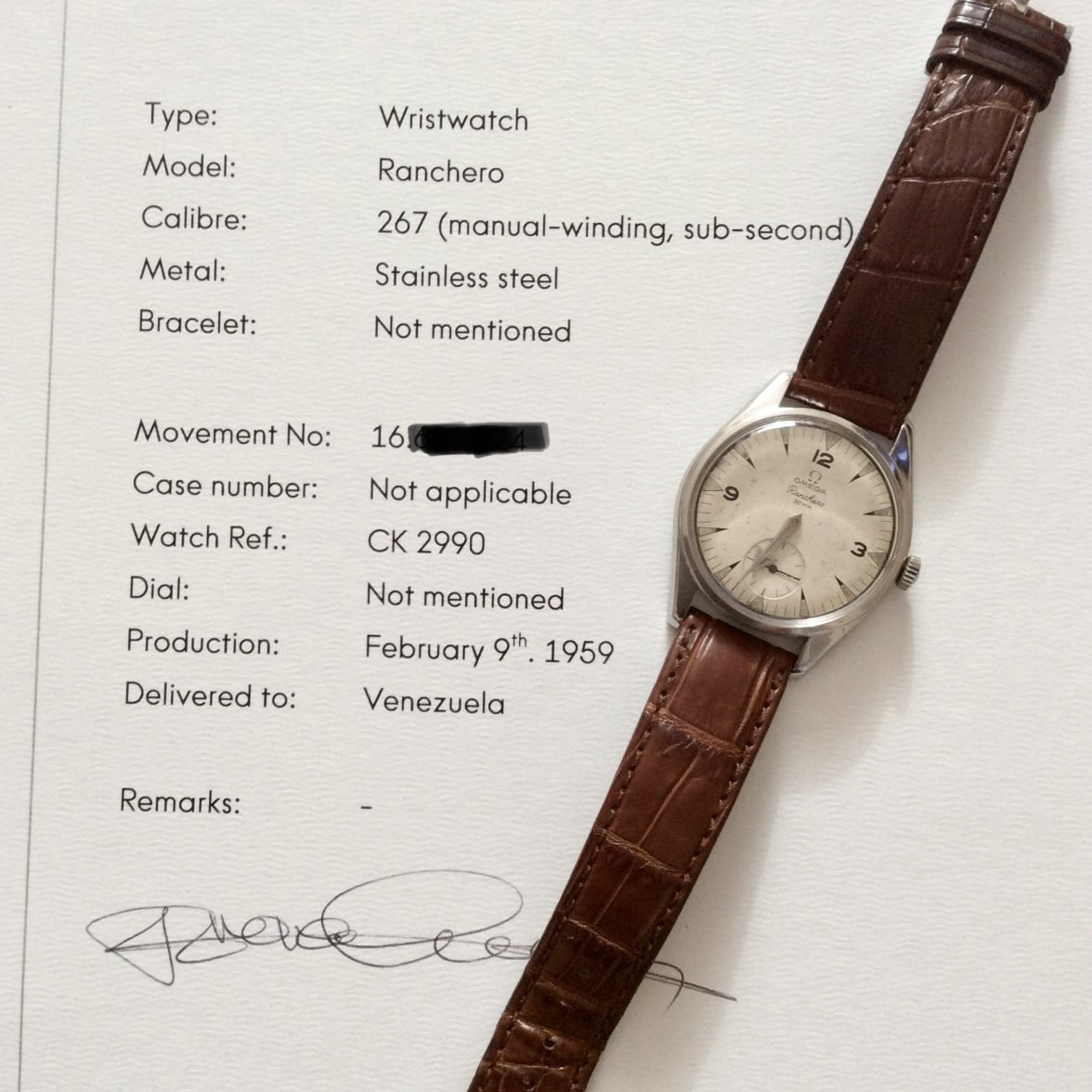

Great, many thanks. I have records of 3 currently delivered to Venezuela, 2 white 1 black so fingers crossed. Italy currently holds the record for most deliveries recorded with 16 馃榾
End link 4 may fit the 2990 case but the Ranchero was not supplied with a bracelet. The 2990 case was also a Seamaster reference so matching end links and bracelet were likely associated with that

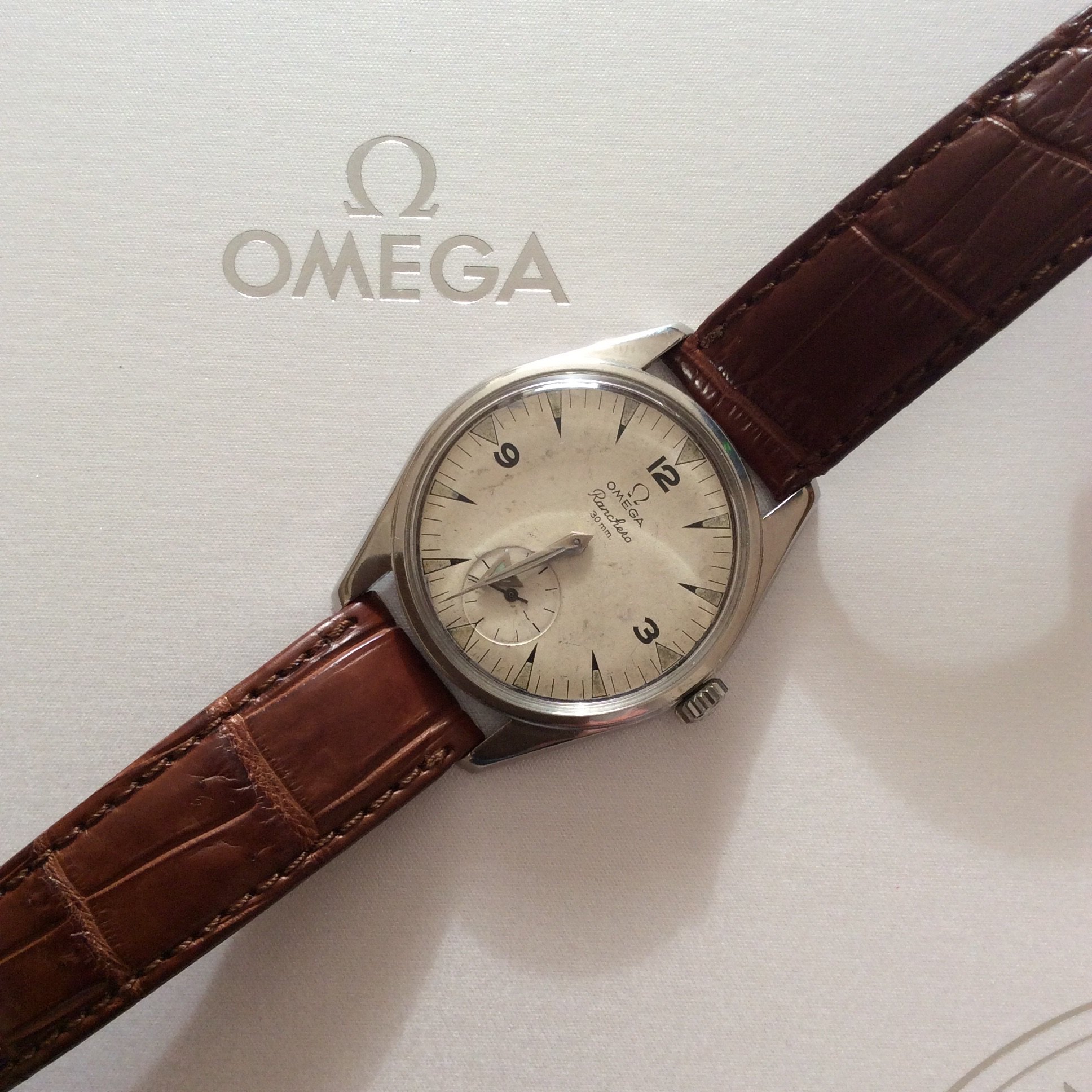

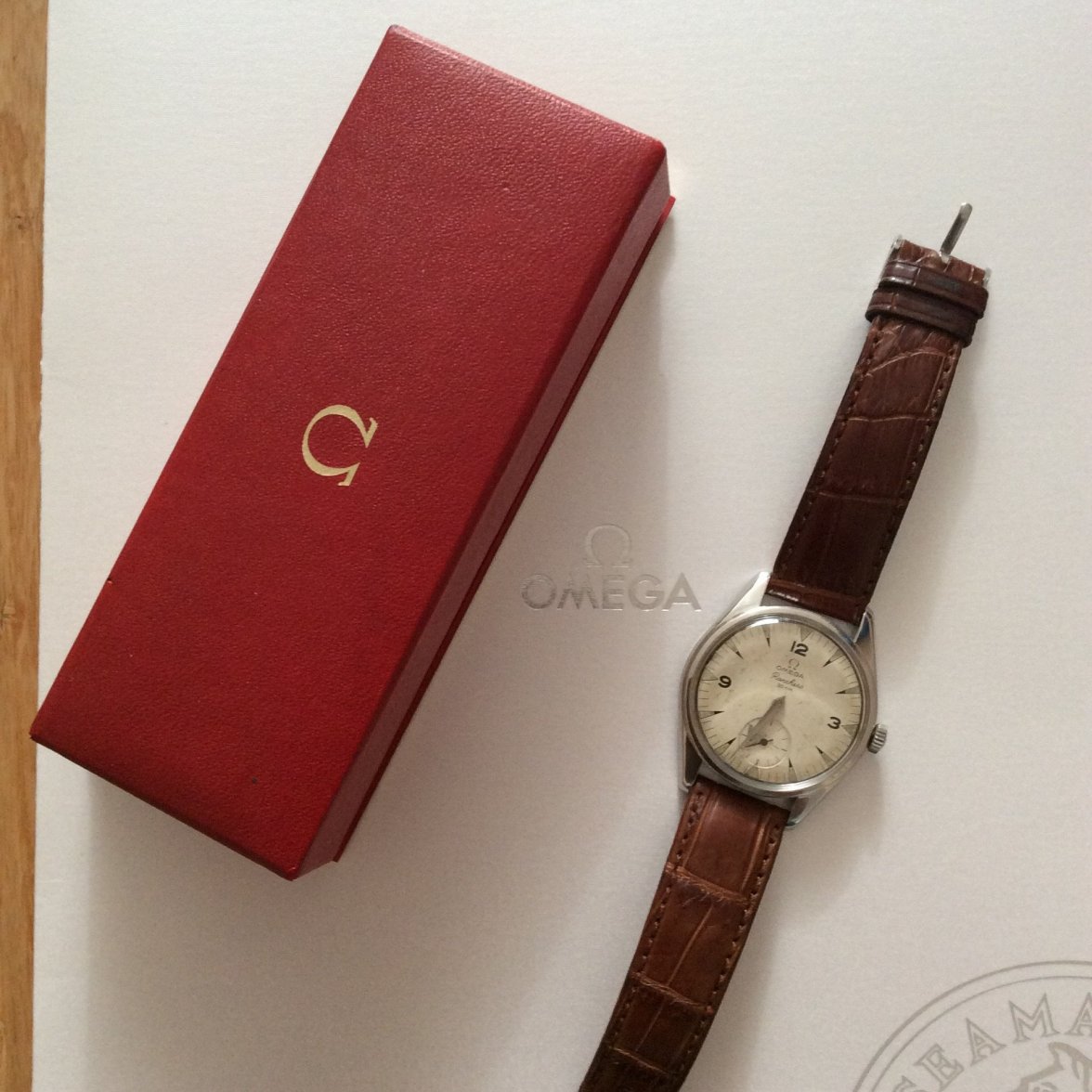

Would this be considered a white dial ranchero? Pretty close to NOS - original strap, buckle, box and hangtag.
I have a couple of these dress types. The hands always have the flat cut on the hour hand toward the center of the dial on the luminous. The Ranchero is very thin font. No markings on crown. My dials were extremely worn as far as lettering. All of the originals seemed to be marked 鈥渟inger鈥漮n the back. My 2996 had a silver dial with silver markers. This seemed less common.

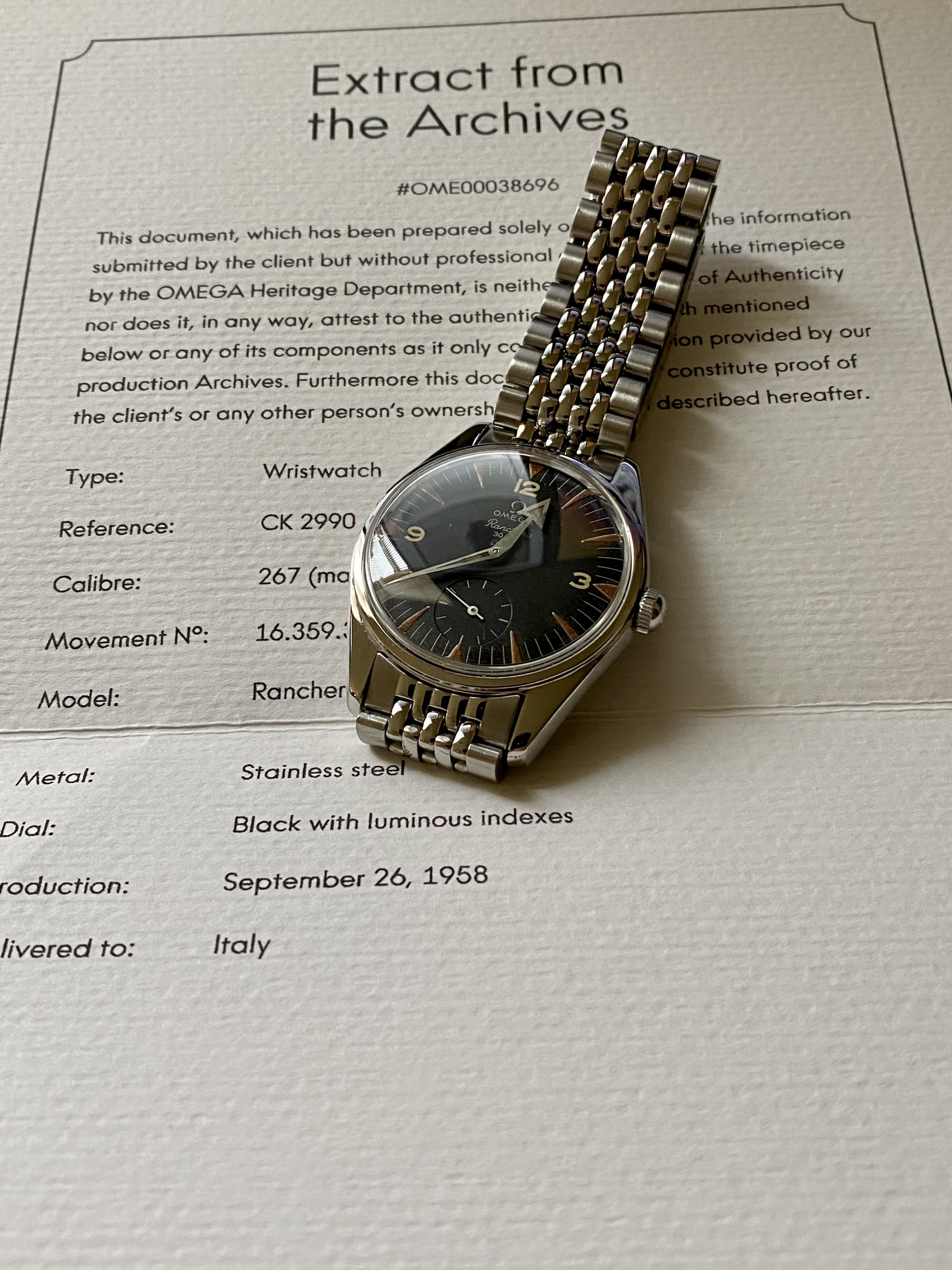

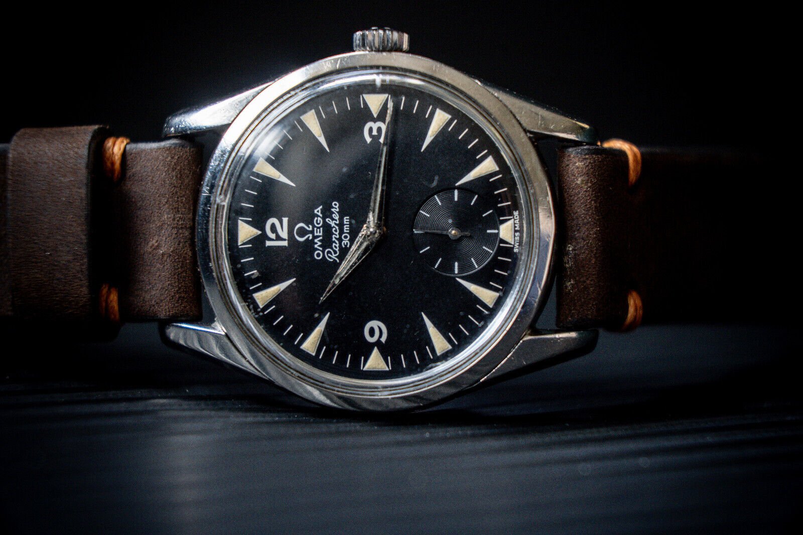

Here鈥檚 mine. Delivered to Italy in September, 1958. Far and away my favorite from my collection.

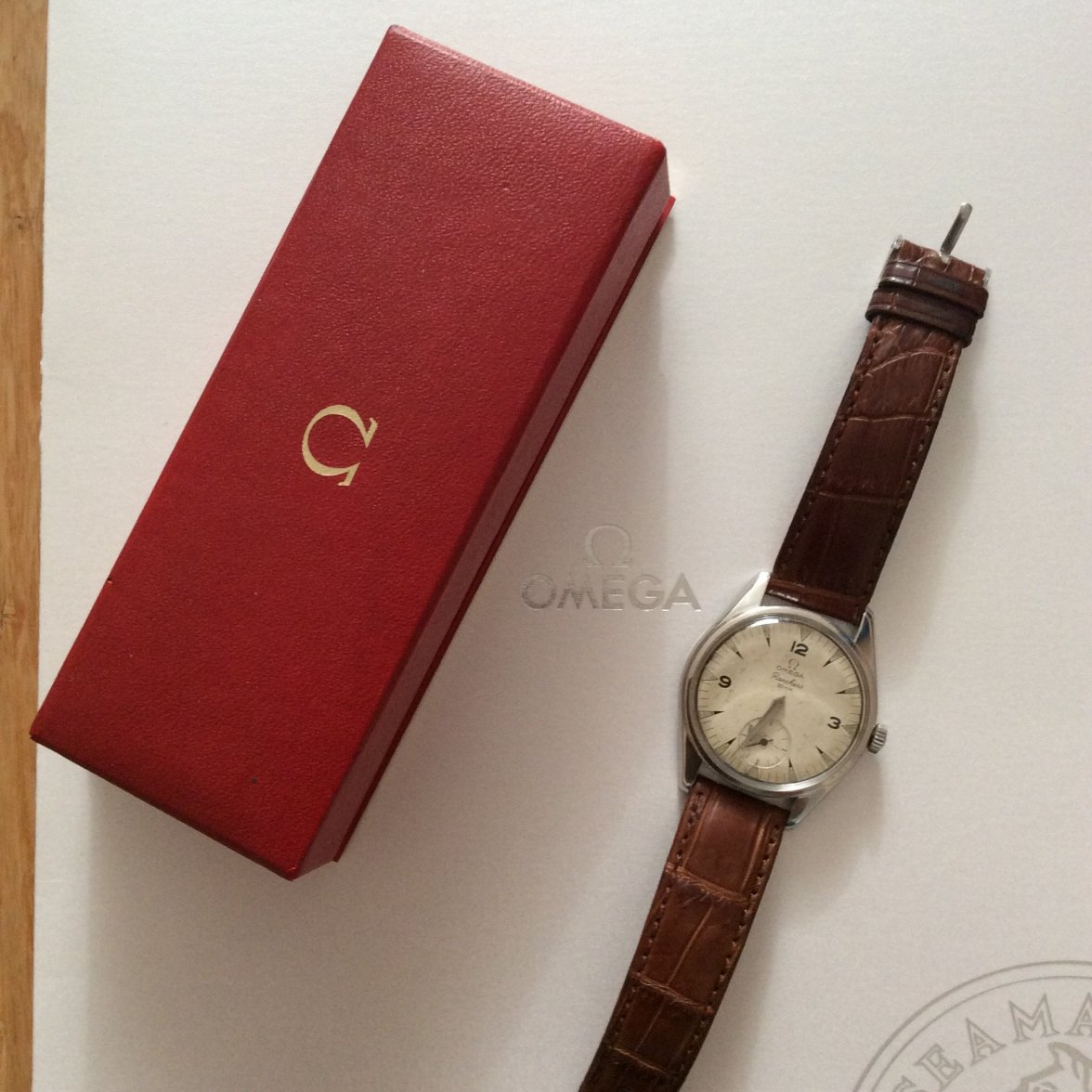

In for a penny in for a pound delivered to Venezuela in February 1959 .if you would like anymore information just PM me .
