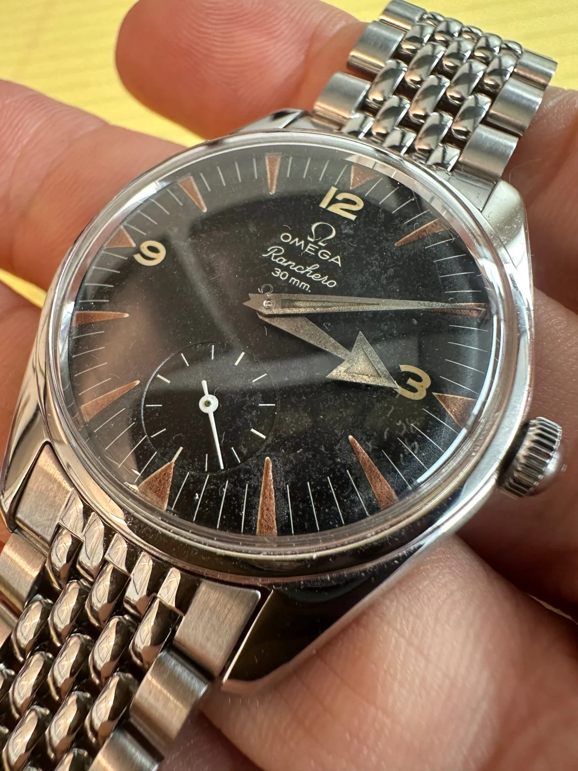

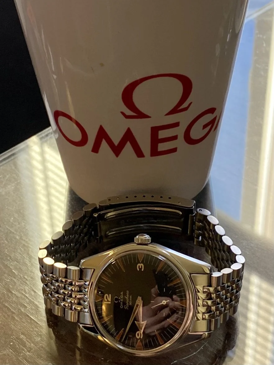

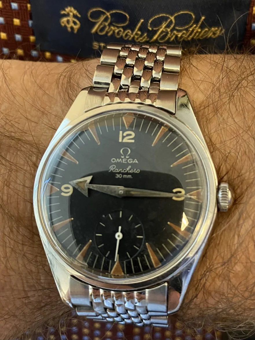

Although incorrect, a modern option that works very well and looks great on the Ranchero is the Omega 3010 five row beads of rice bracelet with a pair of 512 end links, both of which can be ordered by any independent watchmaker with an Omega parts account. This is also a far less expensive option than the 7077 or the 1035. Here’s what that combination looks like on my Ranchero:

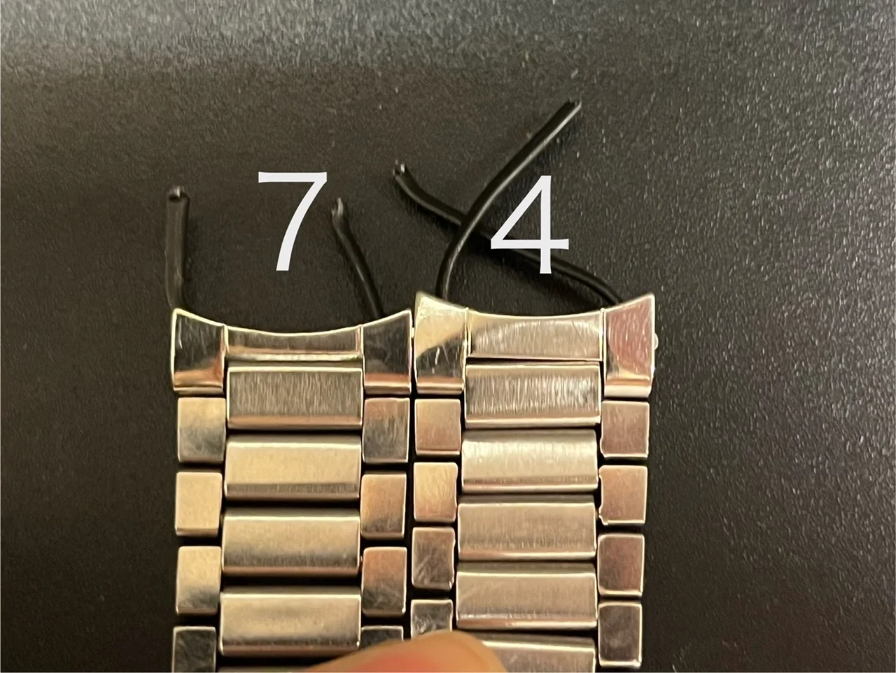

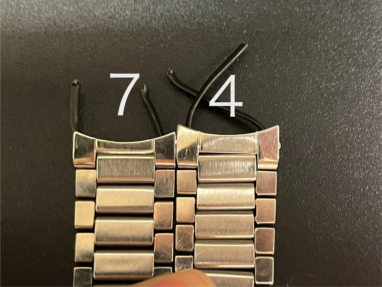

More info from my friend about the #7 vs. #4 end links for the Ranchero:
Here are side by side photos of #7 and #4.
You can post them on OF if you wish.
Apparently different sizes and thus 7 will not fit Ranchero.
I suppose 7 is for late 60’s or early 70’s Geneve or Deville.

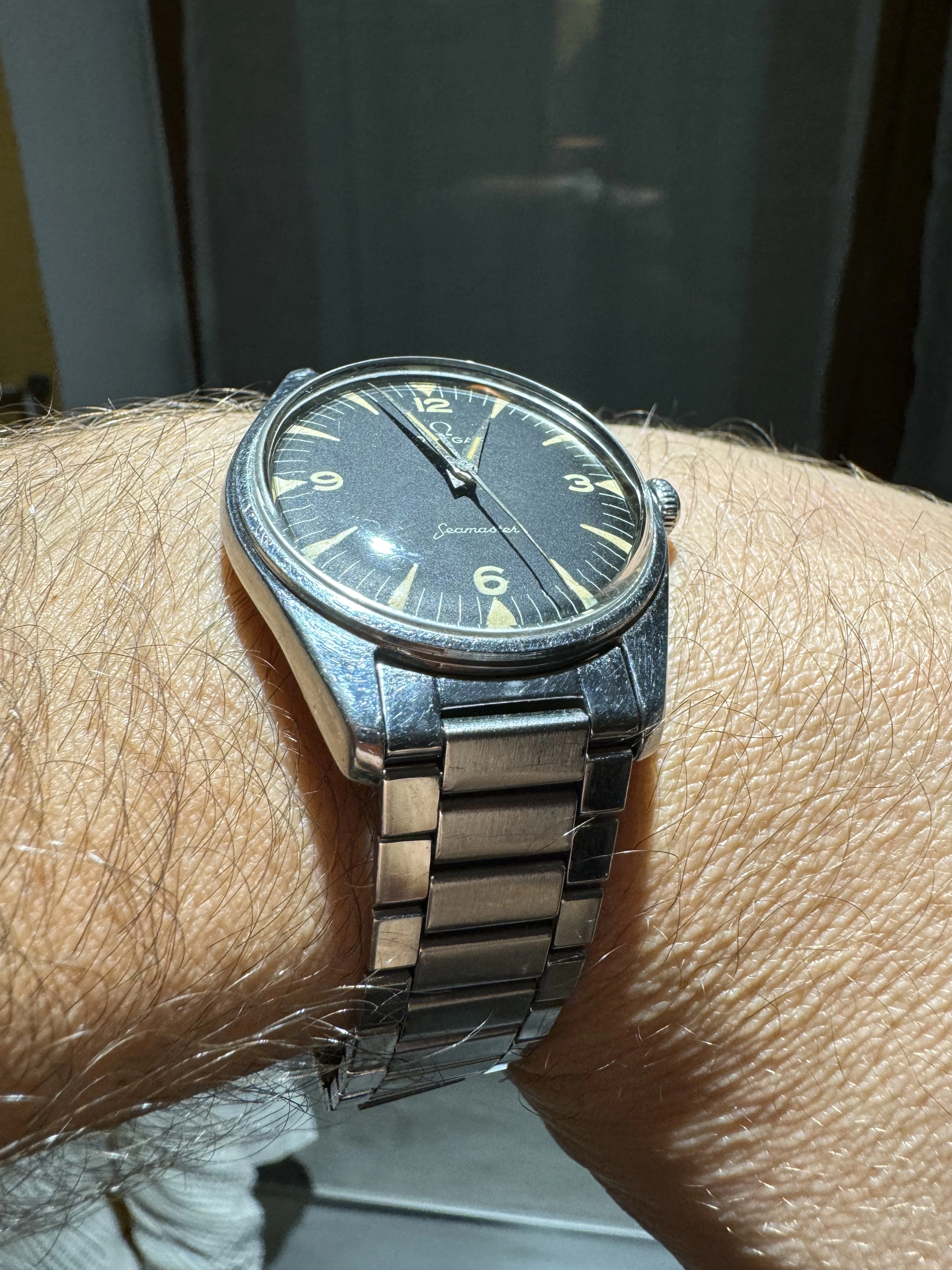

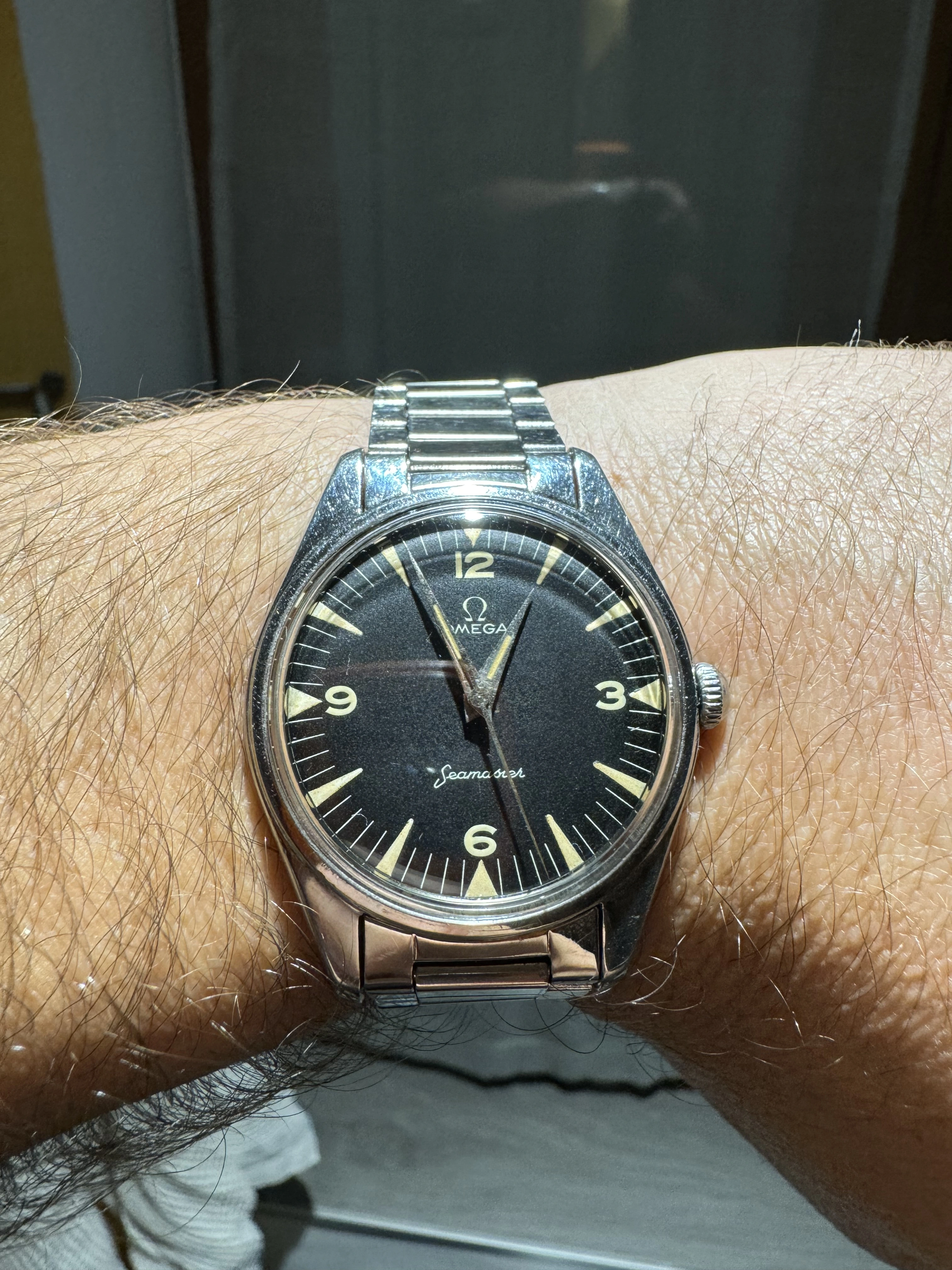

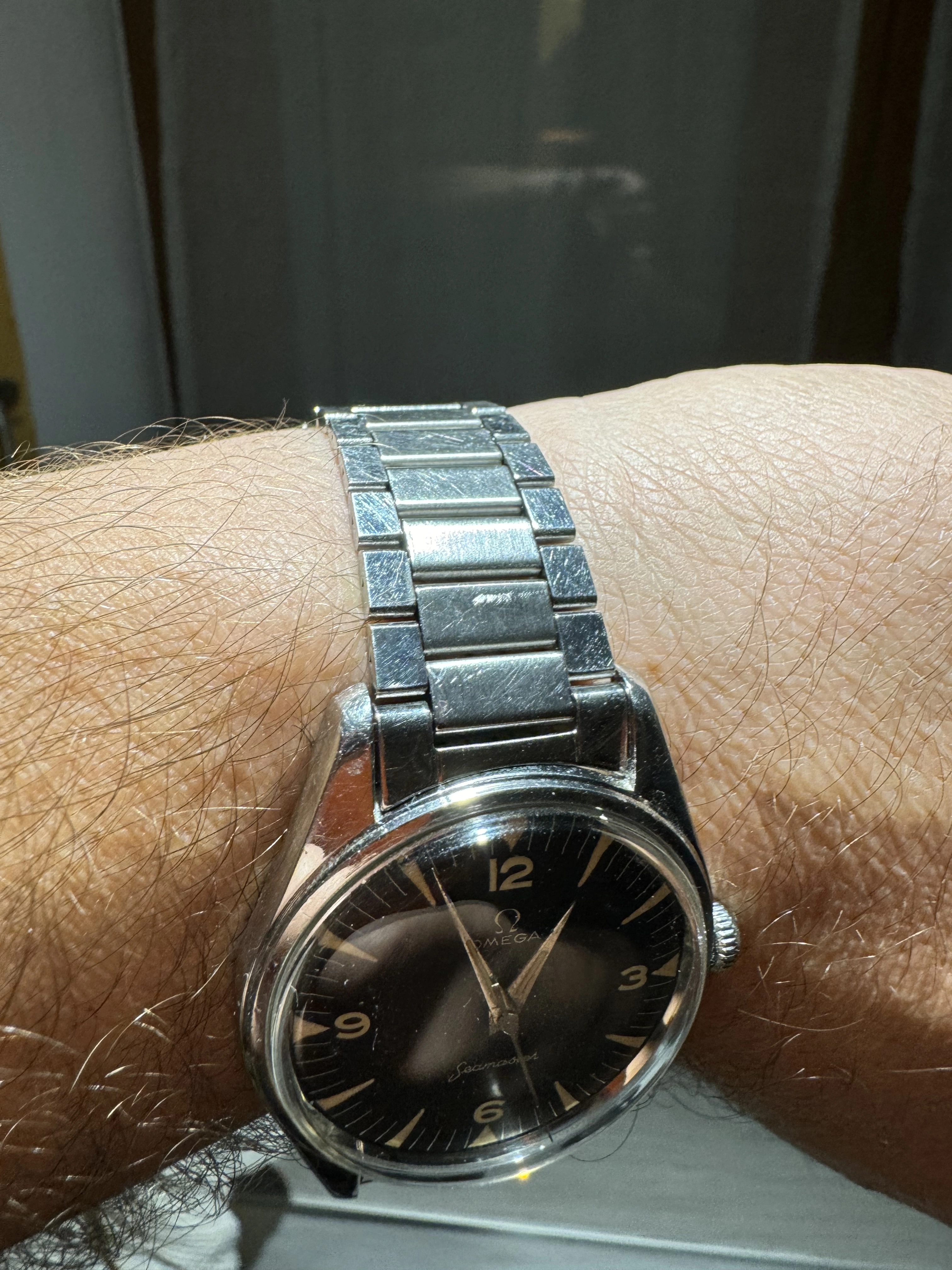

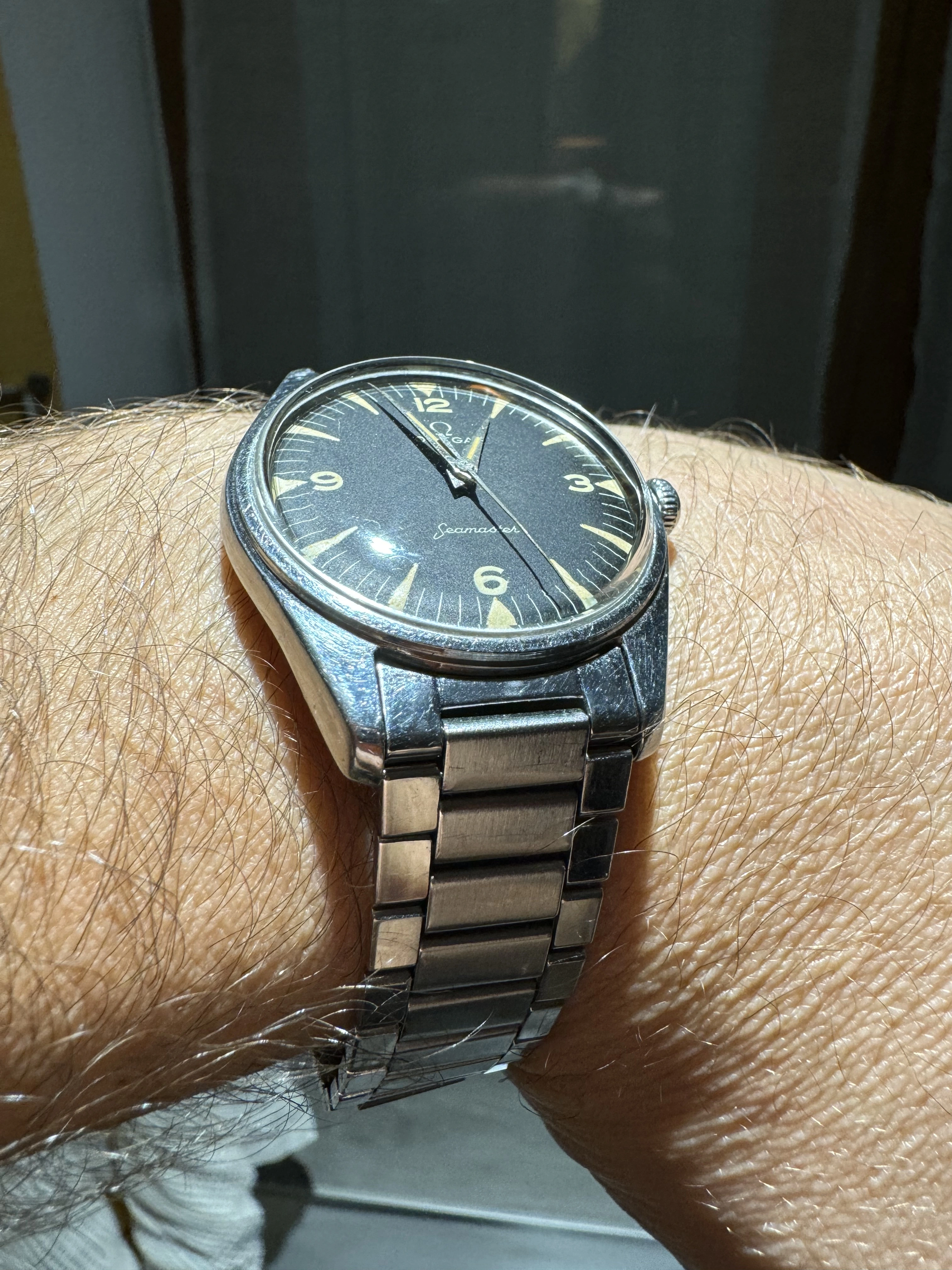

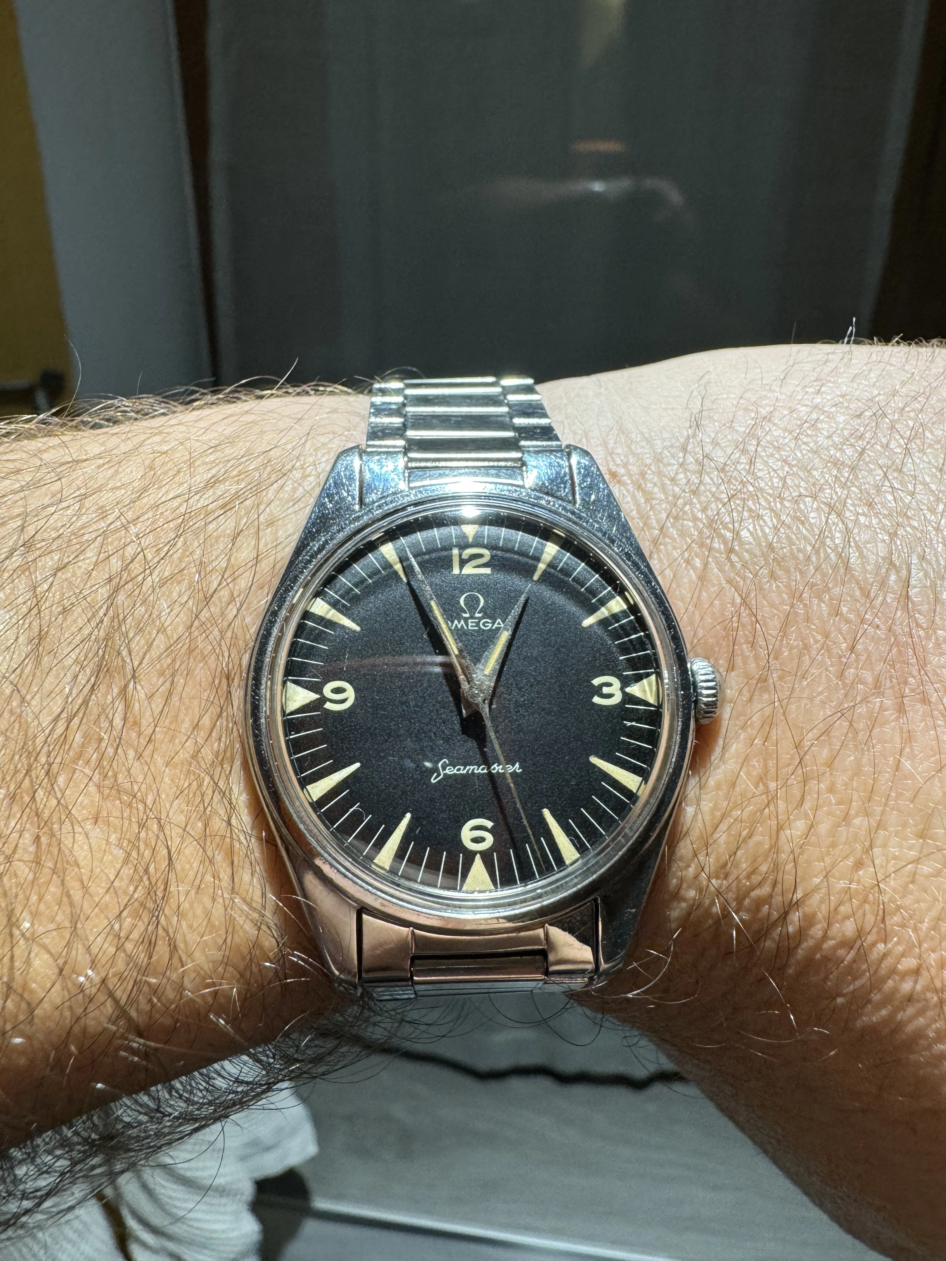

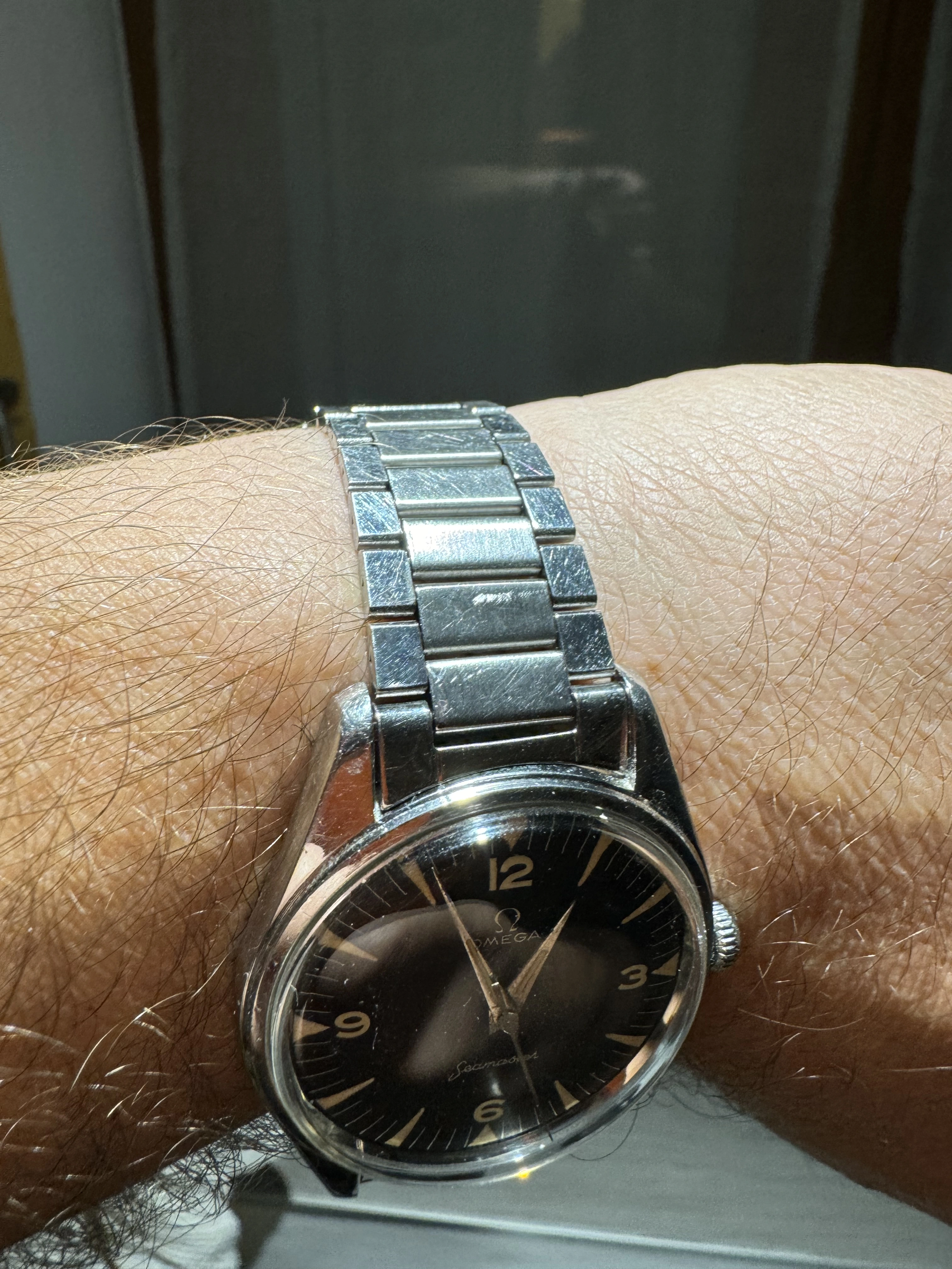

Sorry for the bad pictures, nighttime here and light is horrible but here is my 2996 with a 7912 and #7 endlinks
Curvature is perfect. On the other hand, I have never managed to get such a nice fit with #4 endlinks and I have 3 or 4 sets lying around (not all similar btw) 😅
1,322
1,826
OK, well then, I (and my friend) stand corrected! It looks like a great fit....thank you for the heads up!
