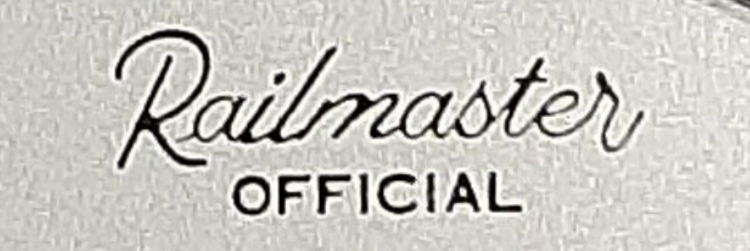

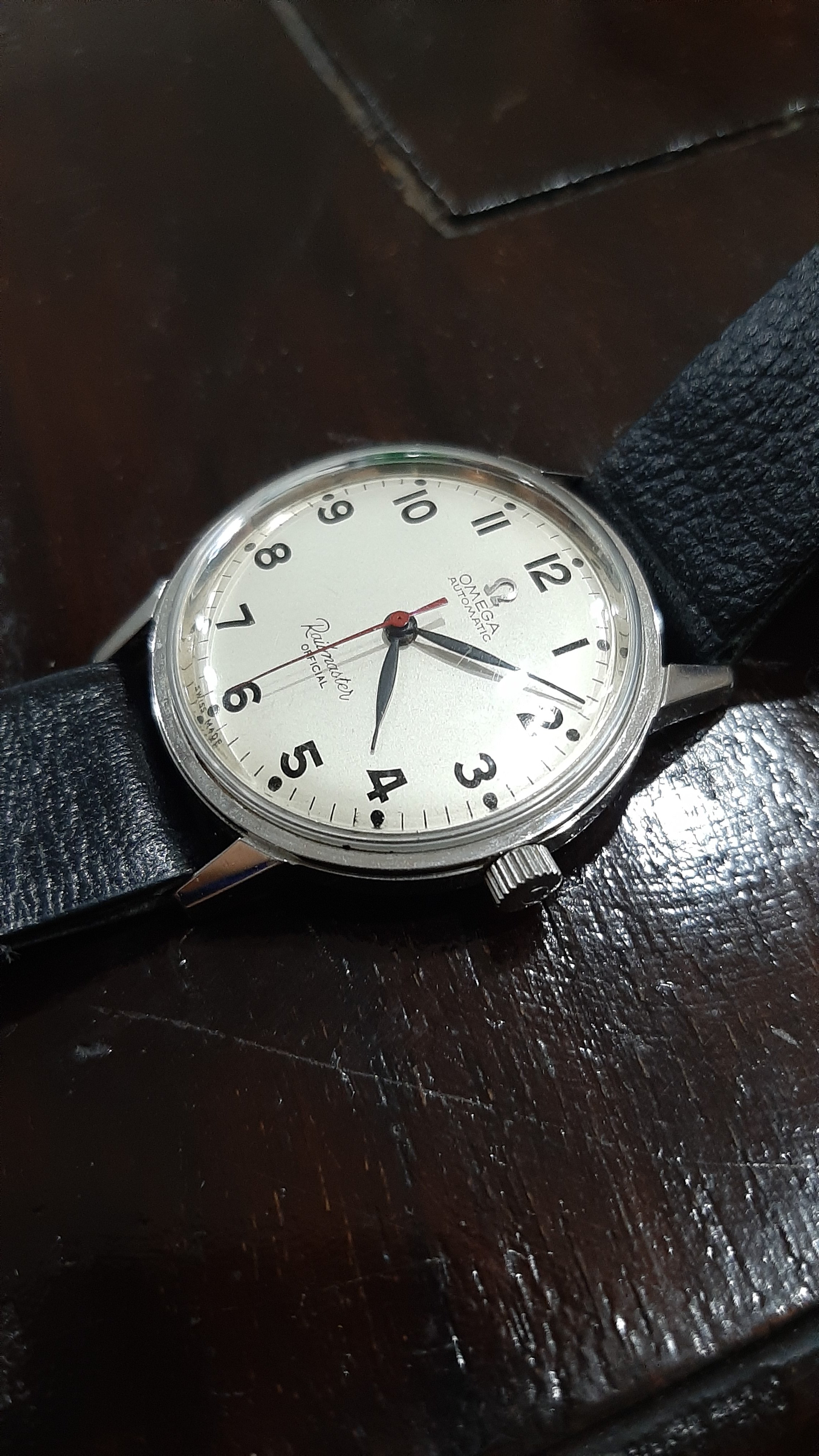

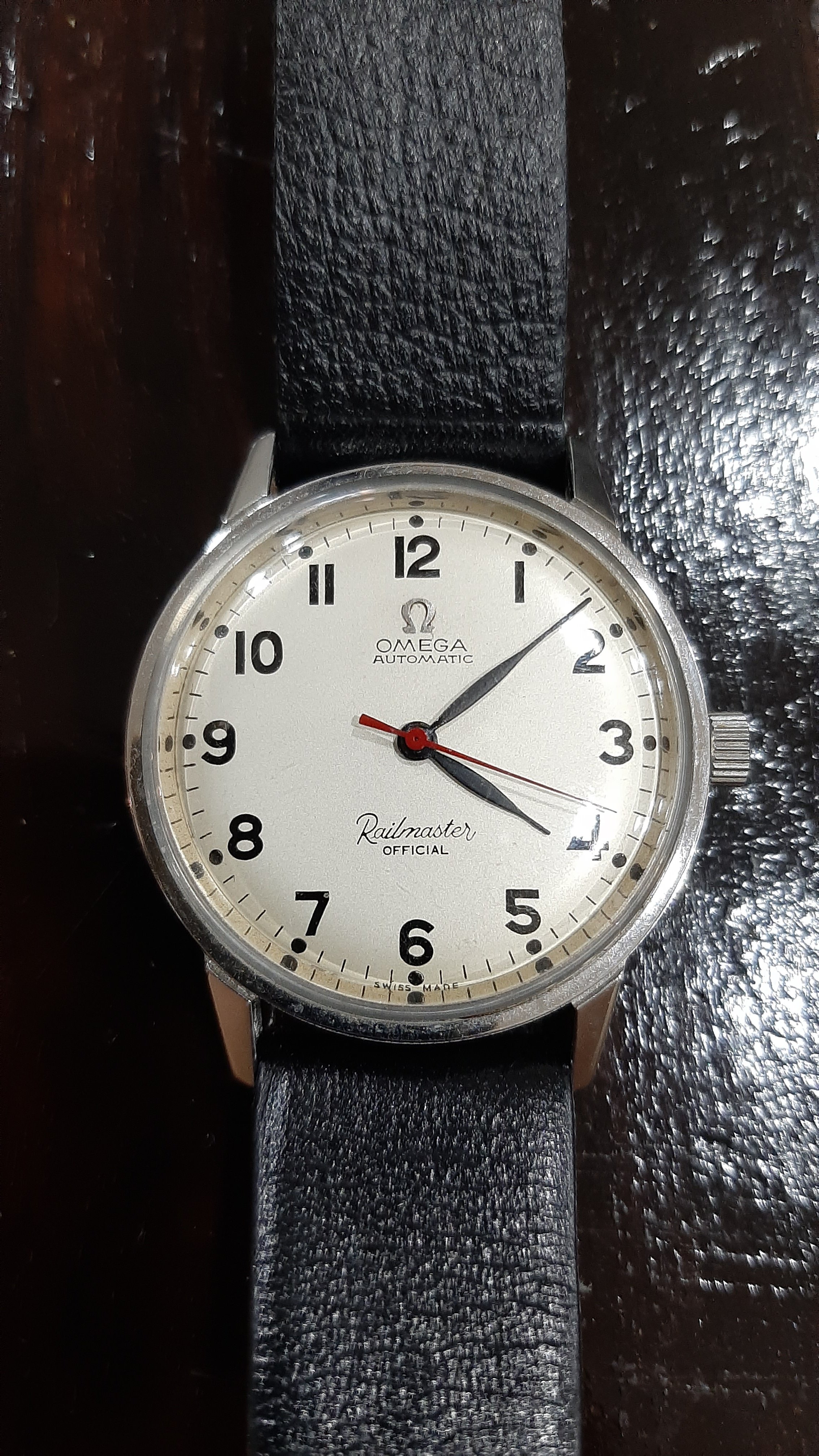

Hi all, I'm fairly new to the world of vintage watches and would like to know if this watch has an original, untouched dial. Is it possible to tell from these photos? I'm also trying to determine a valuation for this watch -- if anyone can PM with this thoughts on that it would be appreciated! Thks.

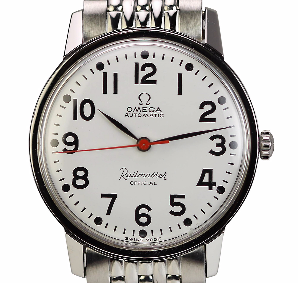

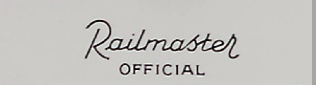

Hi and velcome. We do publish information for all members on the forum and not by PM. Compare your watch with the one I posted and I also enclose a link to a website with a lot of material to study, regarding the Railmaster. (Hint; look at the applied OMEGA logo to begin with.)
https://thespringbar.com/blogs/guides/omega-railmaster-a-collector-s-guide/
Correct one.
Thank you indeed! The owner will be very disappointed to learn he has a fake/re-dialed Omega Geneve or similar. I'll inform him -- but I don't expect a response as he'll likely be rather embarrassed...

Difference in Railmaster font
Yup, I thought it might be a dial variant at first, but clearly not. Cheers,
