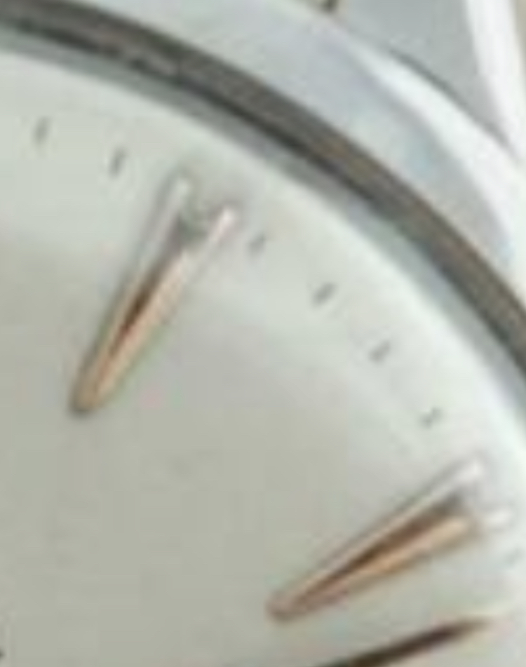

Looks like the dial has been cleaned if it’s lume. You would see little “pips” or round dots of radium in the recessed at the top of the indices here.
It does affect the value for collectors but as far as radium, looks like you’re clear.
24,810
55,144
The dial has been repainted and all lume removed (and not re-applied). The hands are not original, and have no place for lume. This is why we encourage photos.

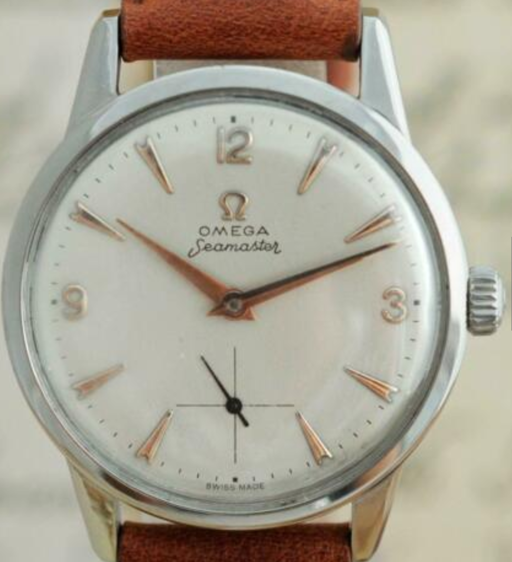

Since the dial originally would have had lume dots at the ends of the applied hour markers, the original hands would also have had "slots" to be filled with lume. These hands are solid, with no lume slots, so they are not the originals. They may very well be authentic Omega hands, however.

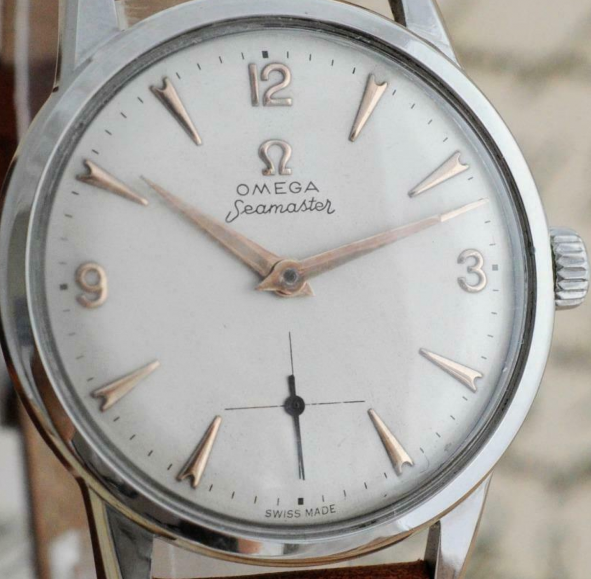

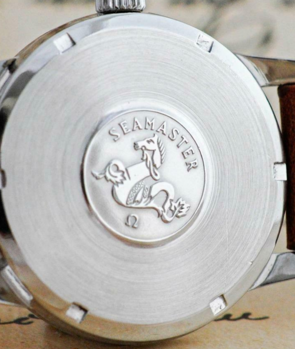

I only have the pictures sent by the seller, I can send more once i have the watch, but this is what the seller mentioned -
Classic Original Omega Seamaster.
Original Omega Crown,
Professionally restored Dial,
Round Screw-down back embossed with Seamaster logo
Aftermarket leather band and buckle
Serviced before putting up for sale.
16,305
45,025
Well, he didn’t inaccurately describe it. If you want us to pick it apart as an exercise for you- we can, but since it’s already inbound and you like it, then wear it in good health. As for what you paid, it’s on the high side but you didn’t get screwed. refinished or refurbished are bad things in the watch world- but some sellers use them as lures to new comers. The only thing that should need “refinishing” is a service on a movement periodically...and if that wasn’t done on this watch, you will need to which will add about half- 2/3 of what you paid.
