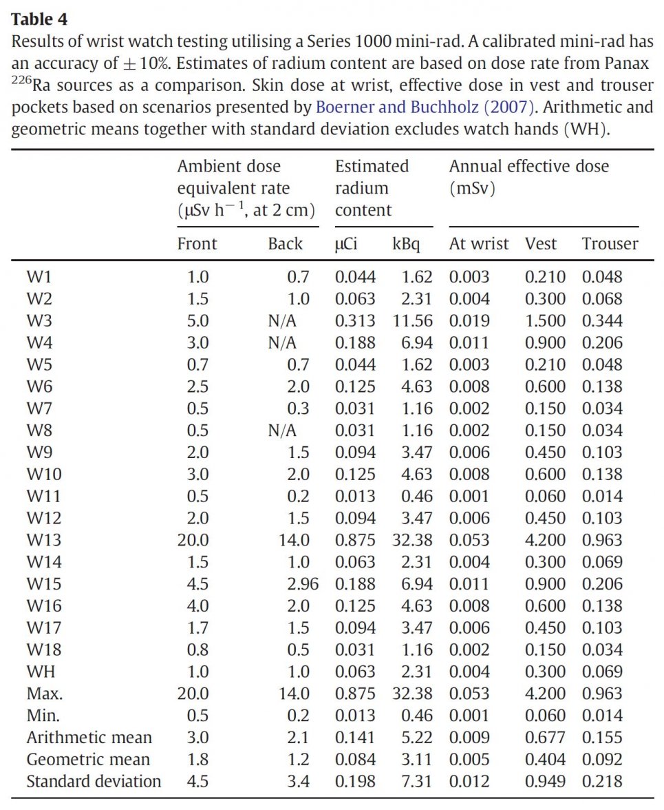

To give you some context, here's Table 4 from GK Gillmore et al. (2012) from Environment International; 45: 91-81. He's the same professor from Kingston University who published the report that caused a resurgence in anxiety around radium watches in 2018 (see links below). As you can see, for wristwatches, measurements 2 cm above crystal usually range 0.5-20 uSv/hour range, with 20 uSv/hour being really atypical and high (it was a military watch from the 1940s).
The articles posted below (Hodinkee, W&W, etc.) I believe are mainly sensationalist. The conclusion from the study is that the radiation levels are acceptable, particularly from later watches post-1950s and non-military watches. Pocket watches are larger and so more radium = higher risk. They concluded the emitted radon levels were the greater concern.

To be clear though....135 uSv/hour is extremely high. That's > 1000 mSV annual exposure at the wrist. You'd likely get a substantial total body dose from that as well...If that reading is true, I'd suggest getting rid of the watch.
But I doubt that's an accurate reading.

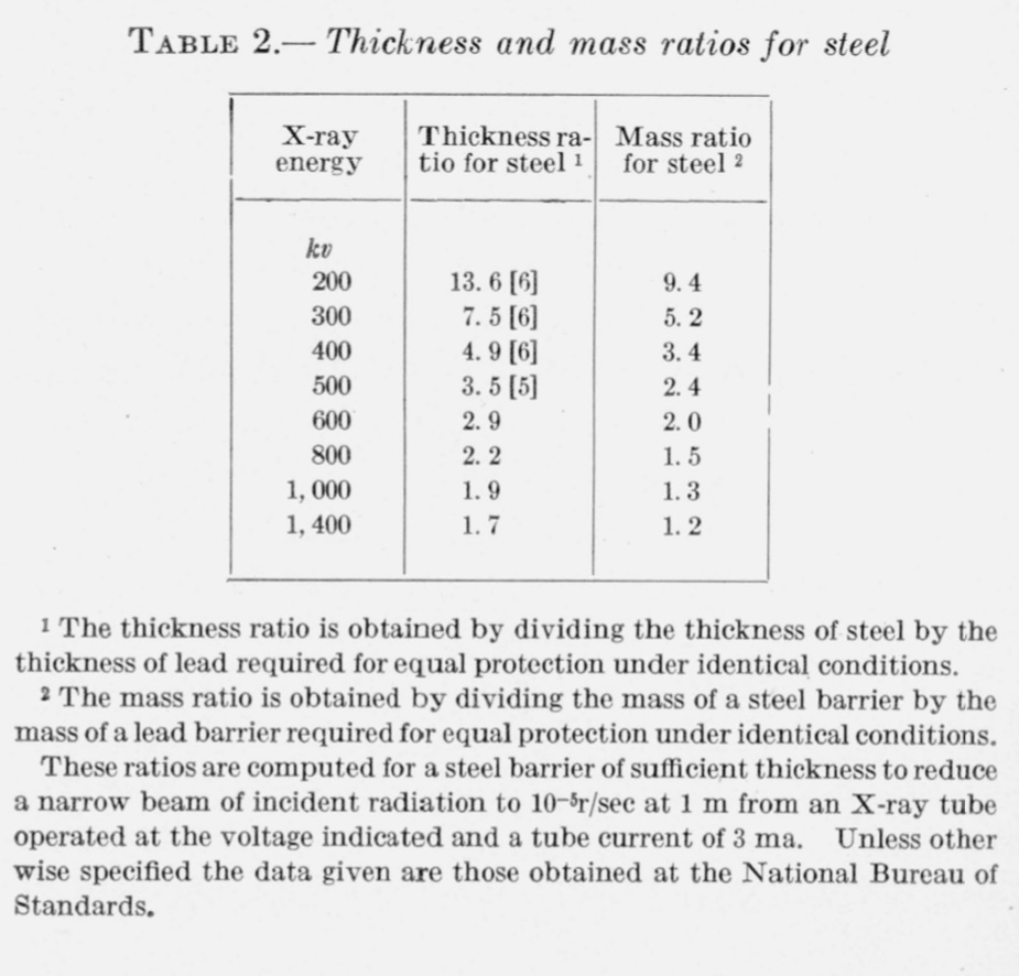

Steel (at a greater thickness than lead) will do the trick too! 馃槈
From US Dep't Commerce Nat'l Bureau of Standards
22
8
l
i put at 4cm stainless steel metal on top of it and it measure 2-2.3uSv/hr in 3mins testing.

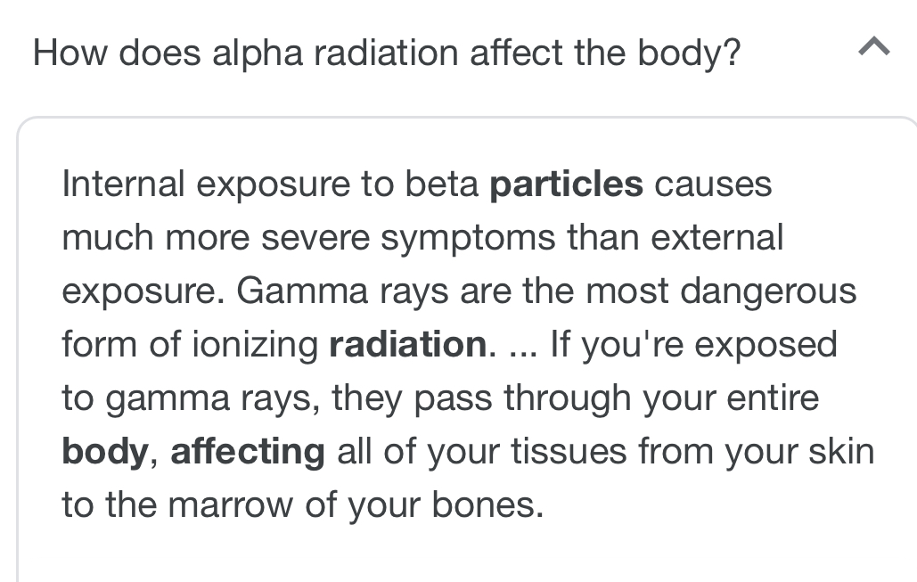

not inhale , ingest or contact with wound
but do they travel like dust?
7,176
23,251
If you open the back of a radium-lumed watch, where there is degradation of that material, there is certainly that possibility.
