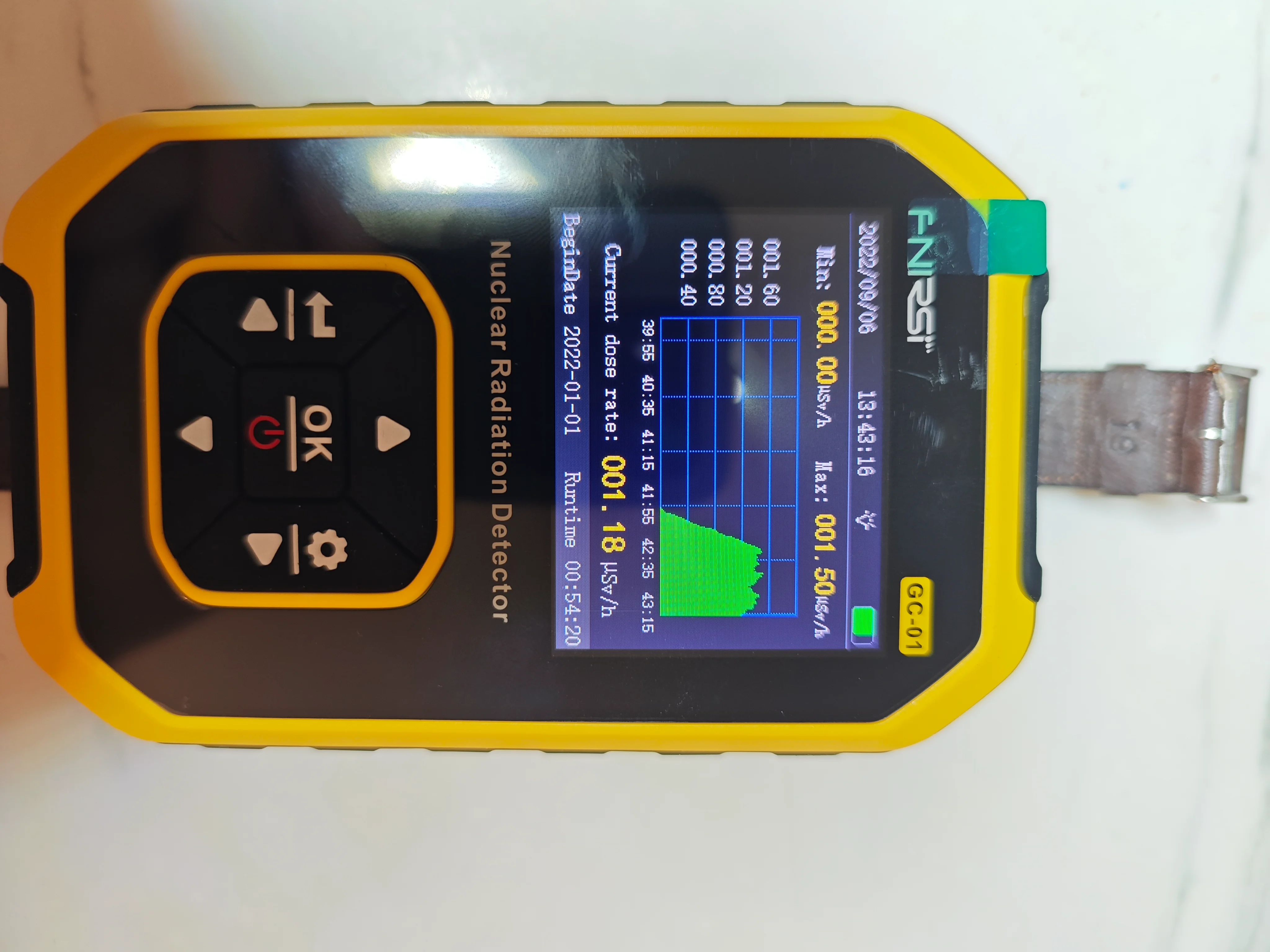

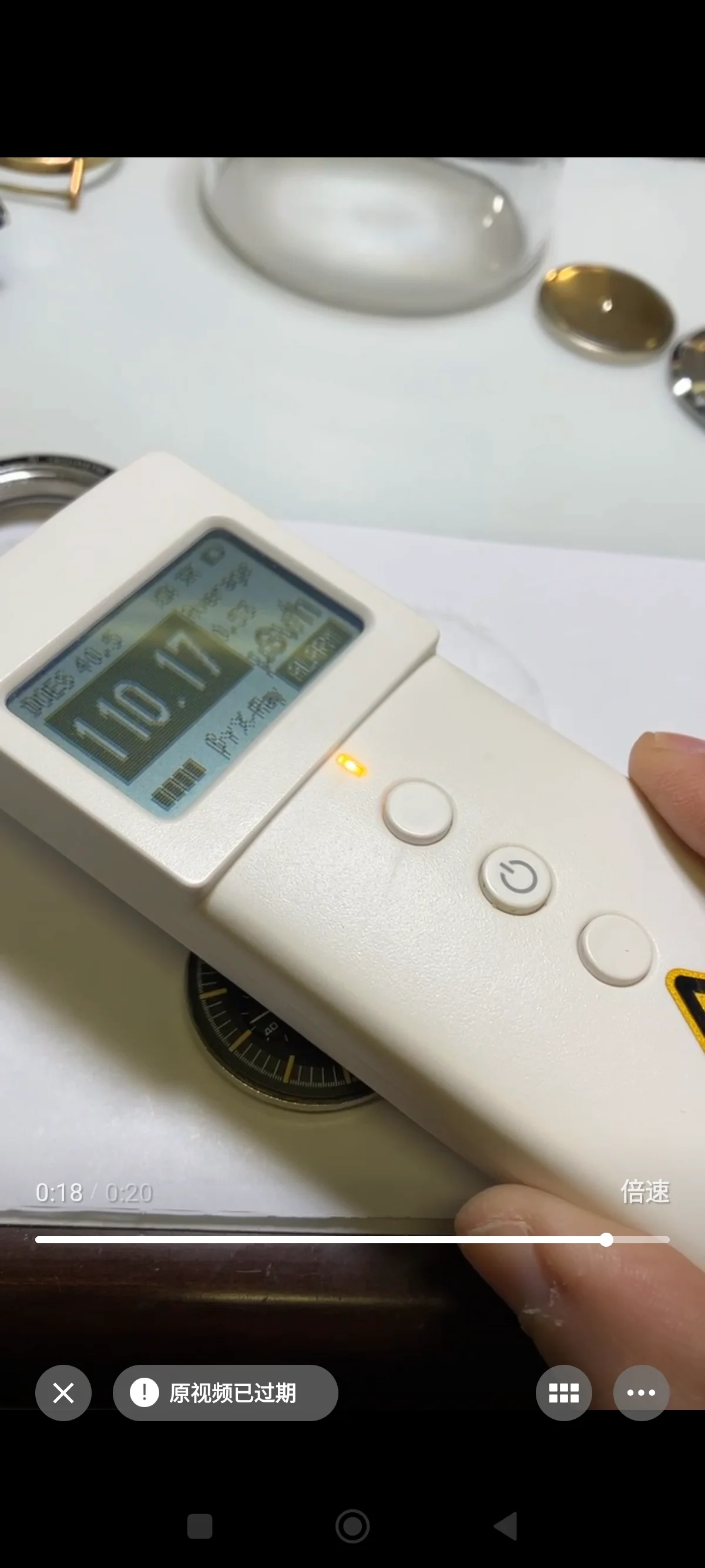

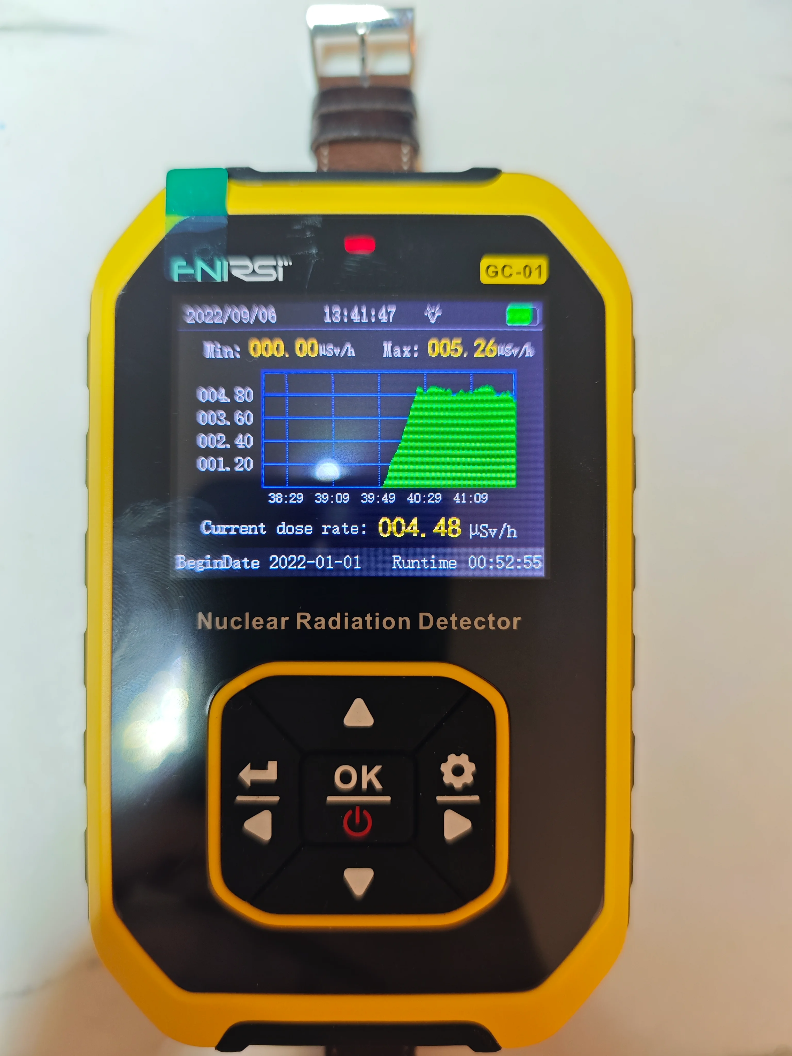

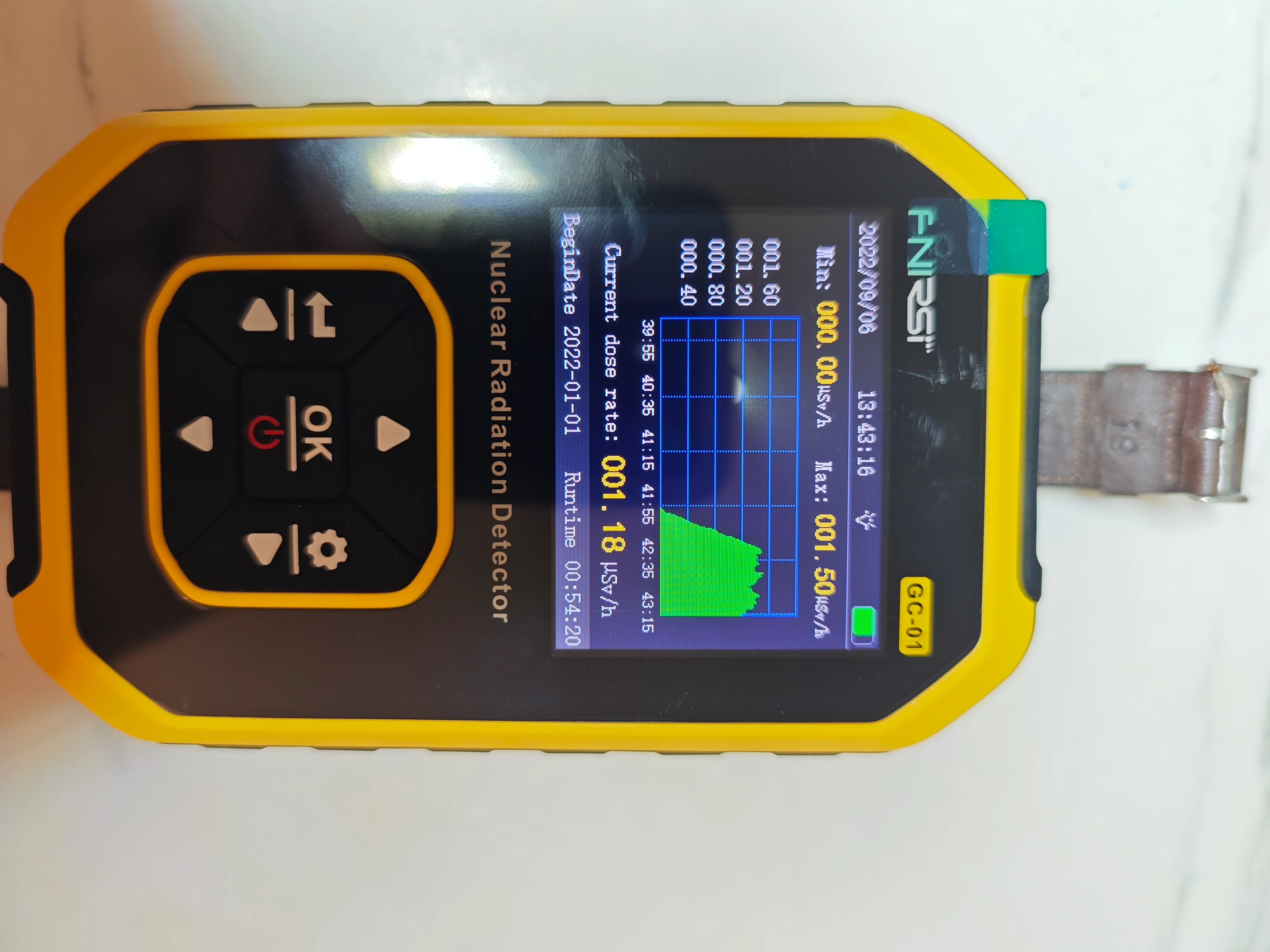

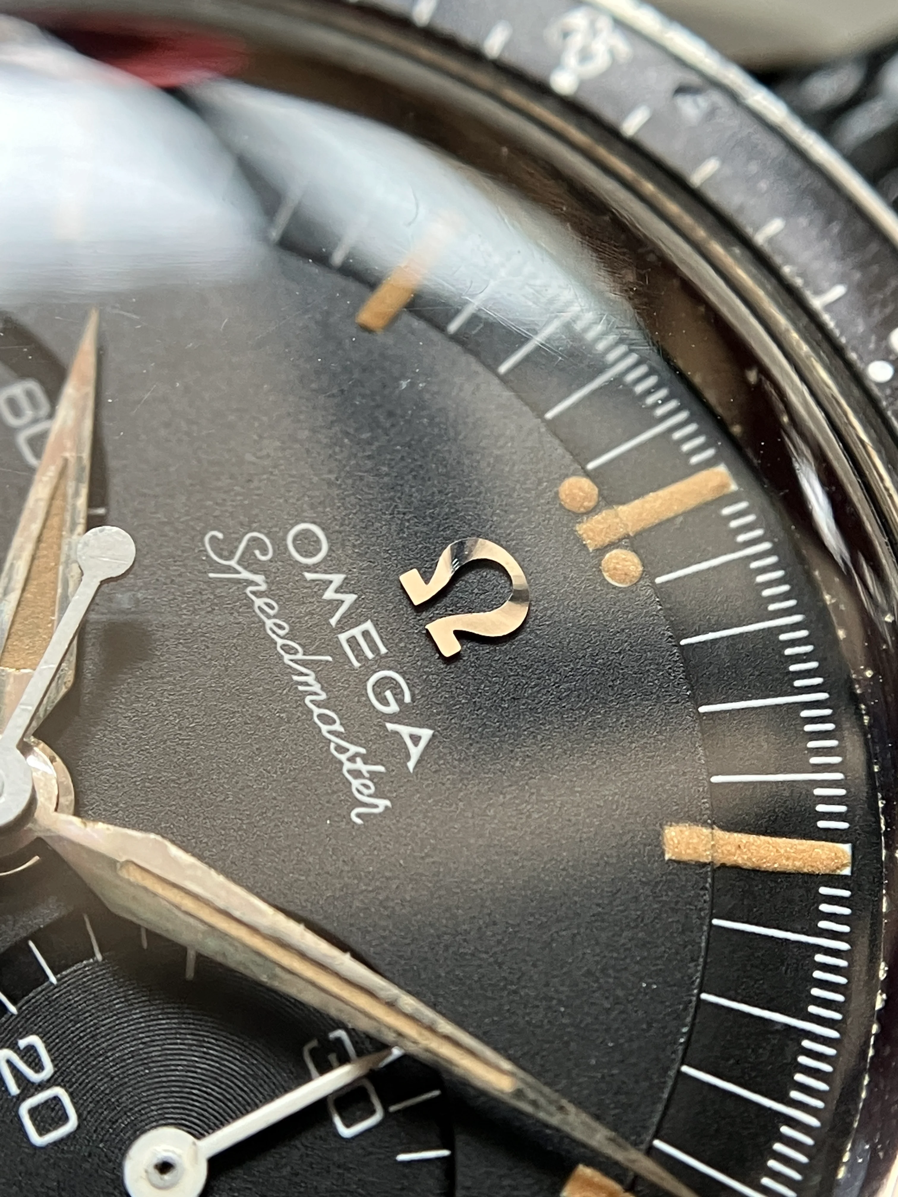

Would like to share the Geiger Reading of a 2998-4 with potentially original radium lume. I have several watch with radium lume and none of them has the same level of radiation.
Front(with crystal):
Back:
Front(without crystal):
The front without crystal reading is from my watchmaker. I'm wondering if the crystal can block that much of radiation?
752
887
Radium emits alpha, beta, and gamma radiation. Alpha and beta can't pass through metal and most of it won't pass through the hesalite. Gamma can pass through both.
The real danger with radium is ingesting it as the alpha and beta radiation will directly impact internal soft tissue (alpha for example is stopped by your skin).
4.48 micro sieverts per hour is equivalent to 0.448 mrem/hr. For context, a commercial airplane flight can easily expose passengers to ~1mrem/hr but that's to the whole body. Wearing a watch would only expose your wrist to the radiation... which is much less sensitive to stochastic effects.

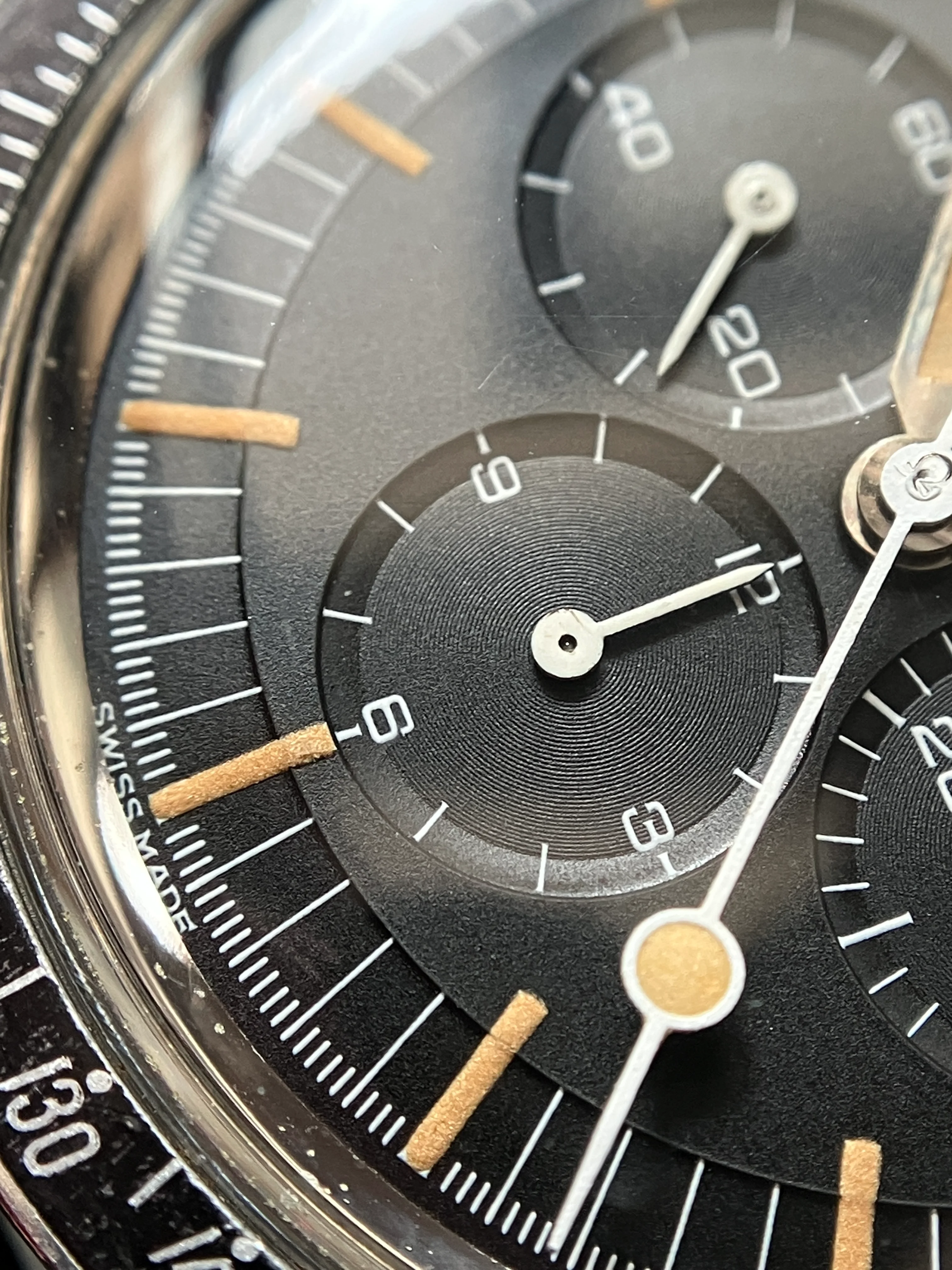

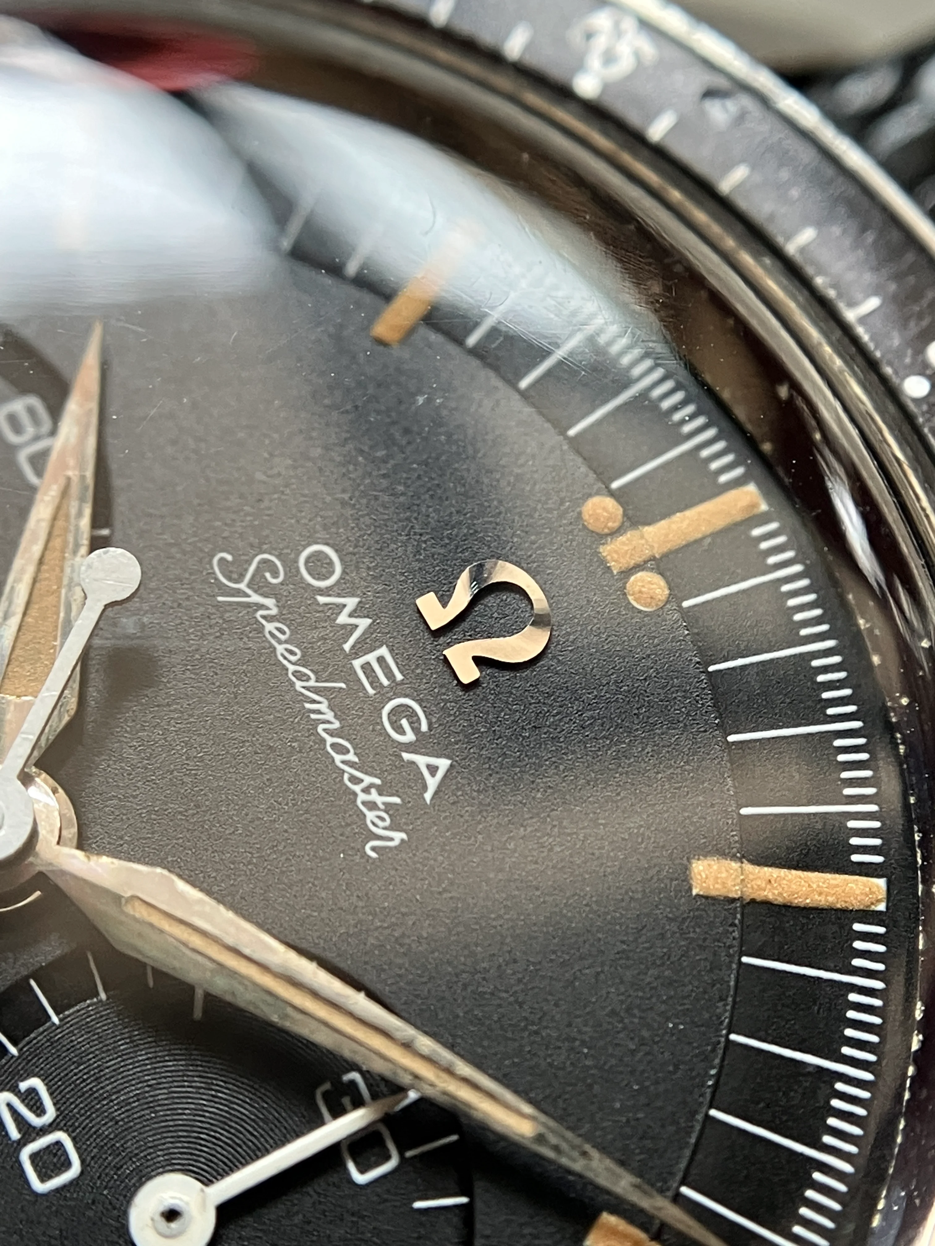

Geiger readings of early (Radium) Speedmaster dials can very based on the batch in which they were manufactured.
Some have higher readings than others.
Shows us actual images of the dial and lume to determine its originality.

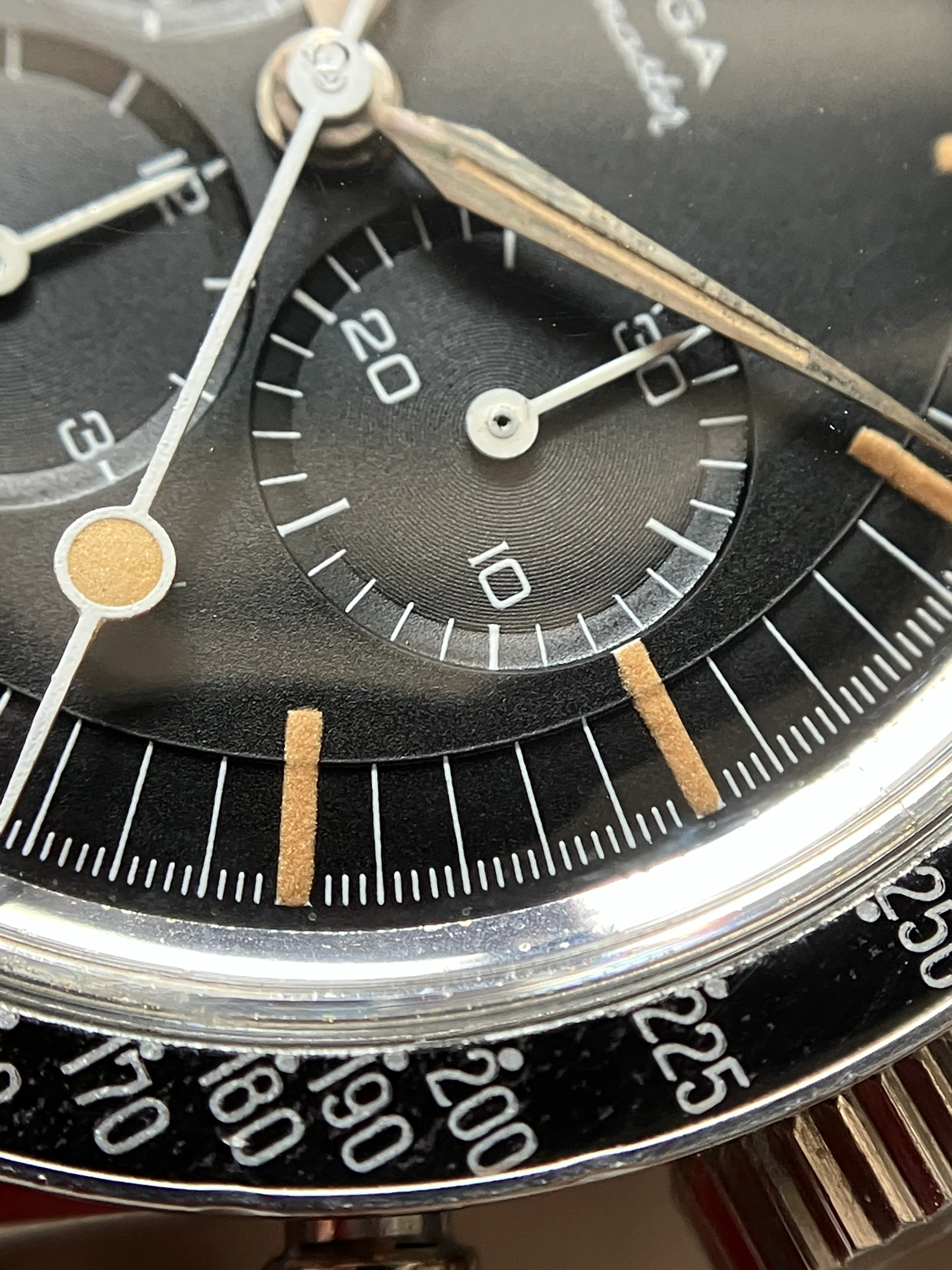

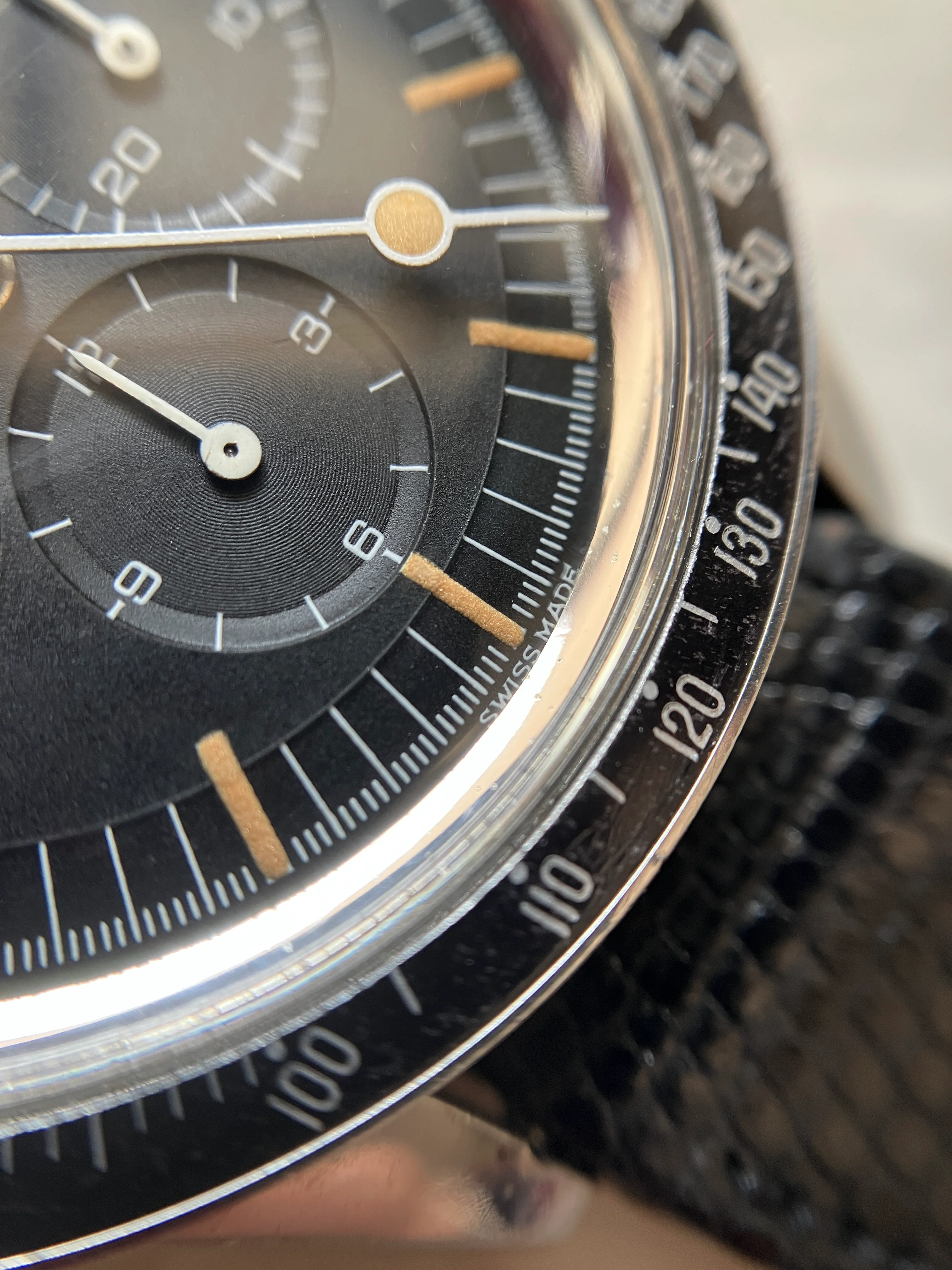

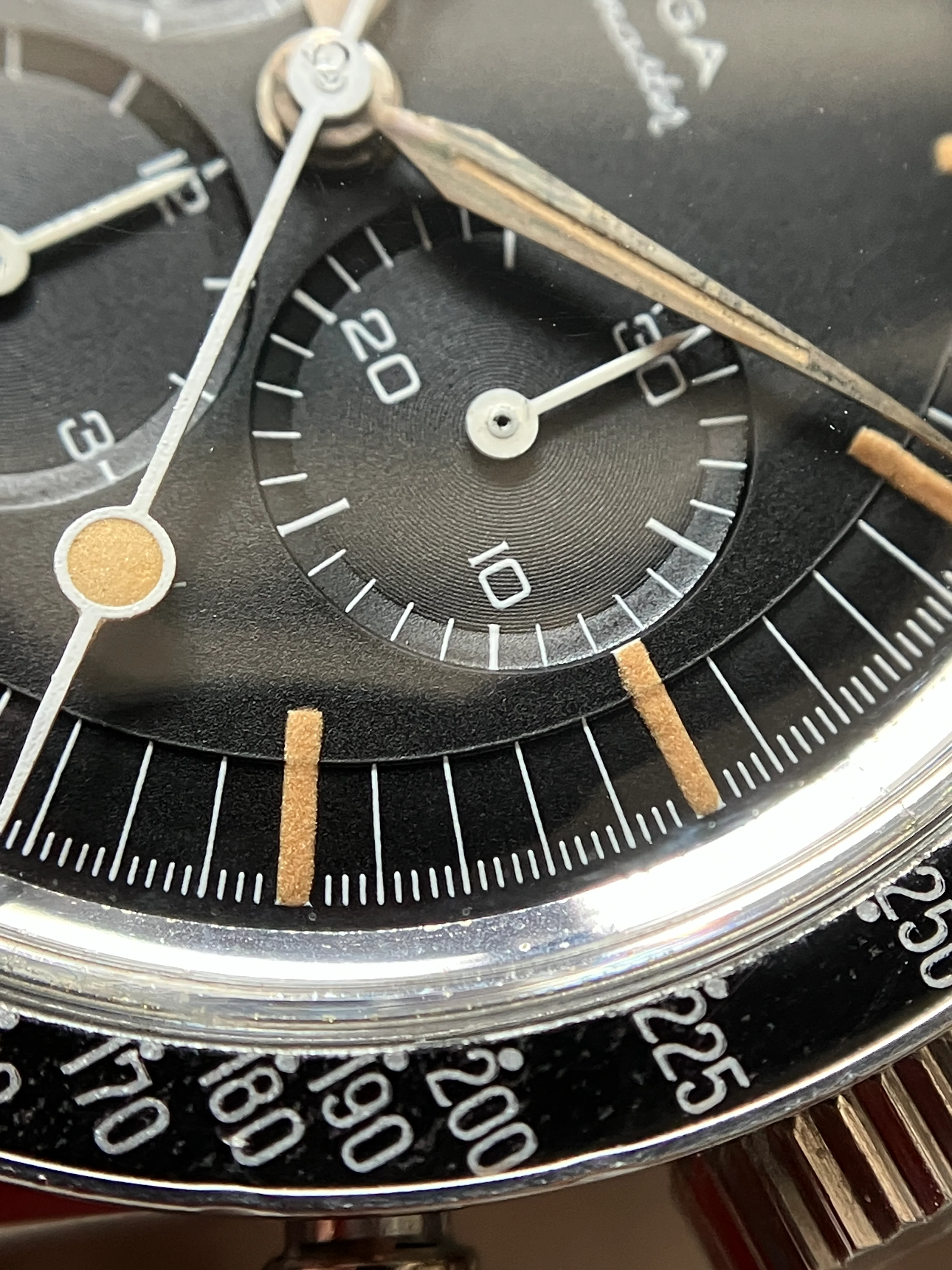

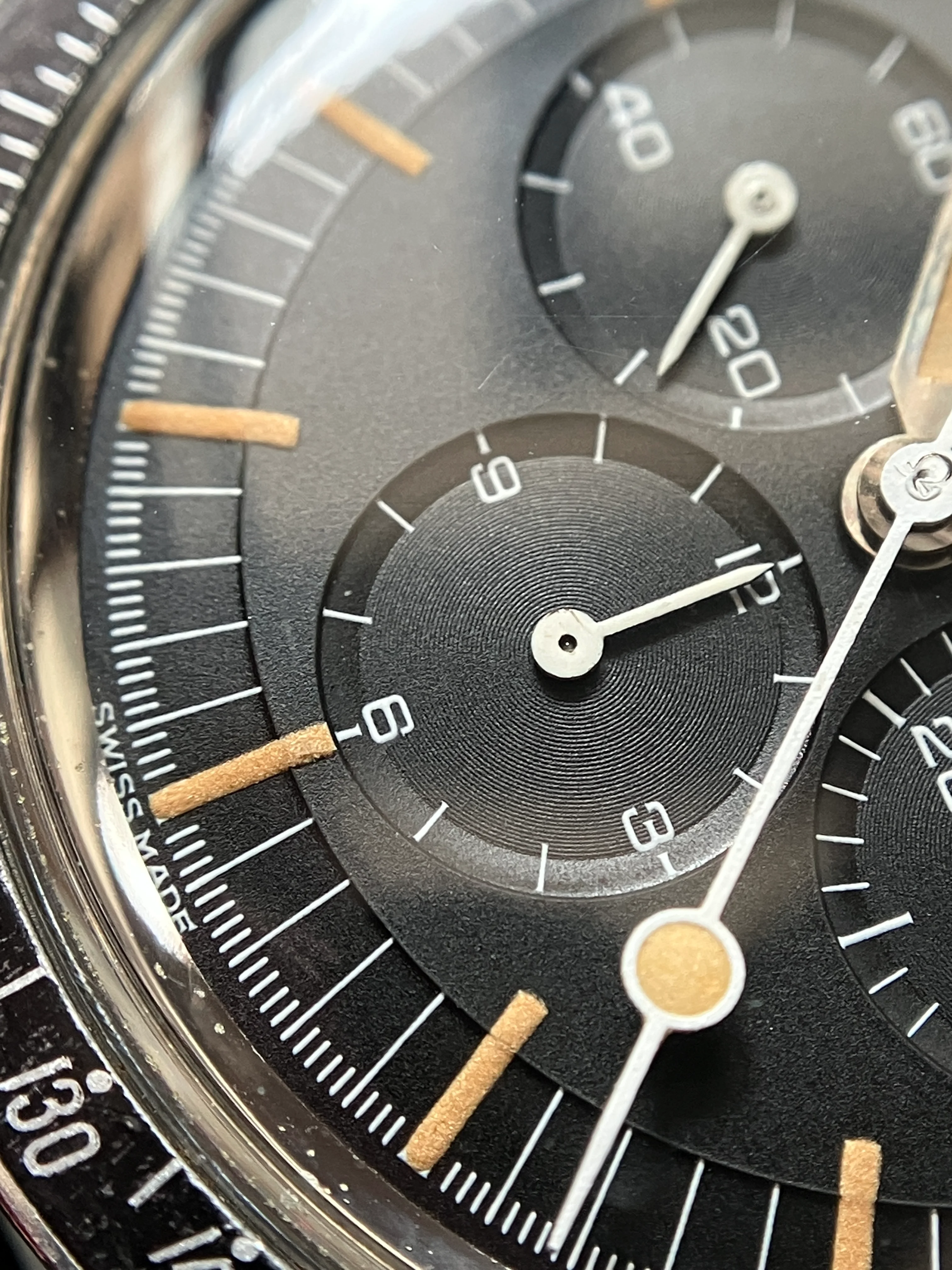

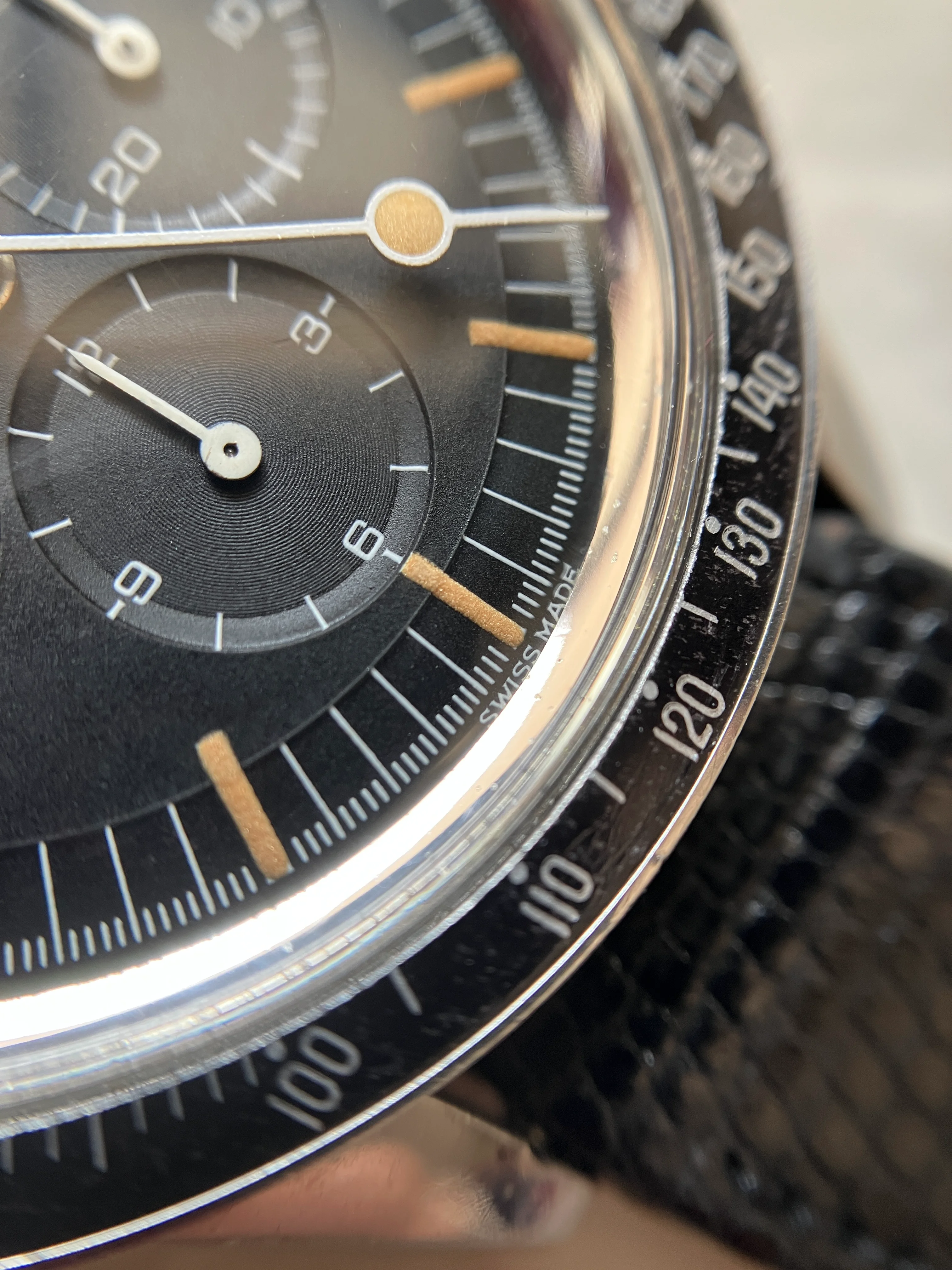

Some images of the lume.
This is the same dial as the one pictured in your previous post? (which looks to be outside of the/a watch) 🤔
562
2,722
Yes, same watch, pictures taken by my watchmaker.

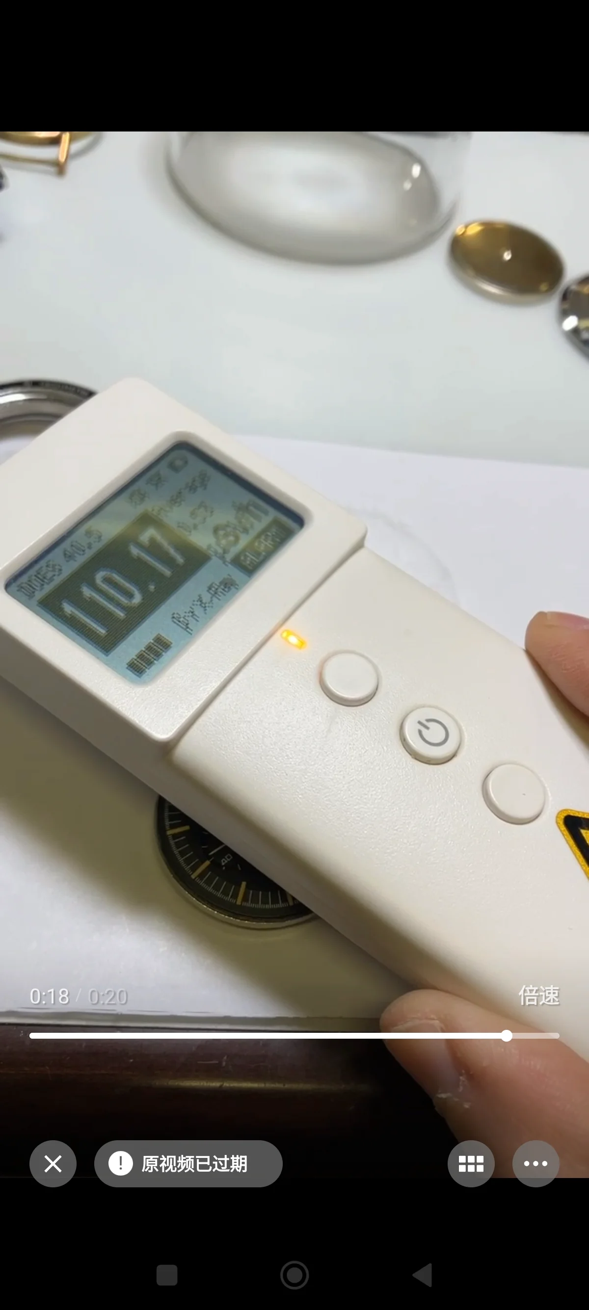

Back:
As others have stated that the danger of Radium {if it is Radium as other radioactive material and varying rations have also been used in the watch industry} is ingesting micro dust either through the mouth or nose!!! Be aware that if it is Radium 226, the watch case would also have Radon gas build up in it when opened as Radium also breaks down to Radon gas. Your body also will confuse radium for calcium which is another issue. Both Radon and Radium are aggressively carcinogenic.
Most Geiger counters cannot confirm Radium, as Radium emits alpha particles (which are Helium Nuclei that are heavy and can easily be stopped by your crystal or a piece of paper). In general Geiger counters will not detect Radium as it is not in their job description. You would need an alpha particle sensitive Geiger counter known as the Geiger Muller which will detect not just Beta particles ( like electrons and positrons) but also alpha particles,
