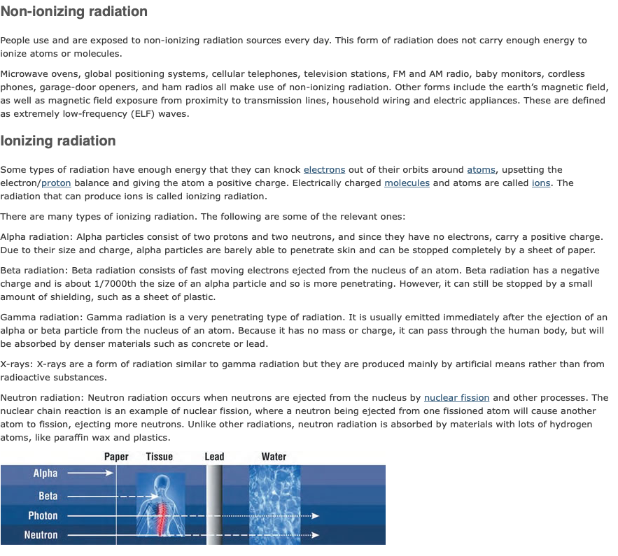

"Alpha radiation: Alpha particles consist of two protons and two neutrons, and since they have no electrons, carry a positive charge. Due to their size and charge, alpha particles are barely able to penetrate skin and can be stopped completely by a sheet of paper. "
unless there is a leak , wouldn't it not able to penetrate a watch crystal ?

Generally I think when you read that alpha particles are attenuated/blocked by a sheet of paper, they're referring more to the fact that in general, alpha particles don't penetrate very far through things or through the air. That doesn't mean no alpha particles at all make it through a sheet of paper. Same applies to a watch crystal. Most of the alpha is blocked, but you probably still do detect a significant amount since it's not all blocked by the crystal.
I don't think anyone out there has ever done a dedicated study looking at what percentage of alpha emissions emitted by radium indices is actually blocked by the crystal and what percentage makes it through.
