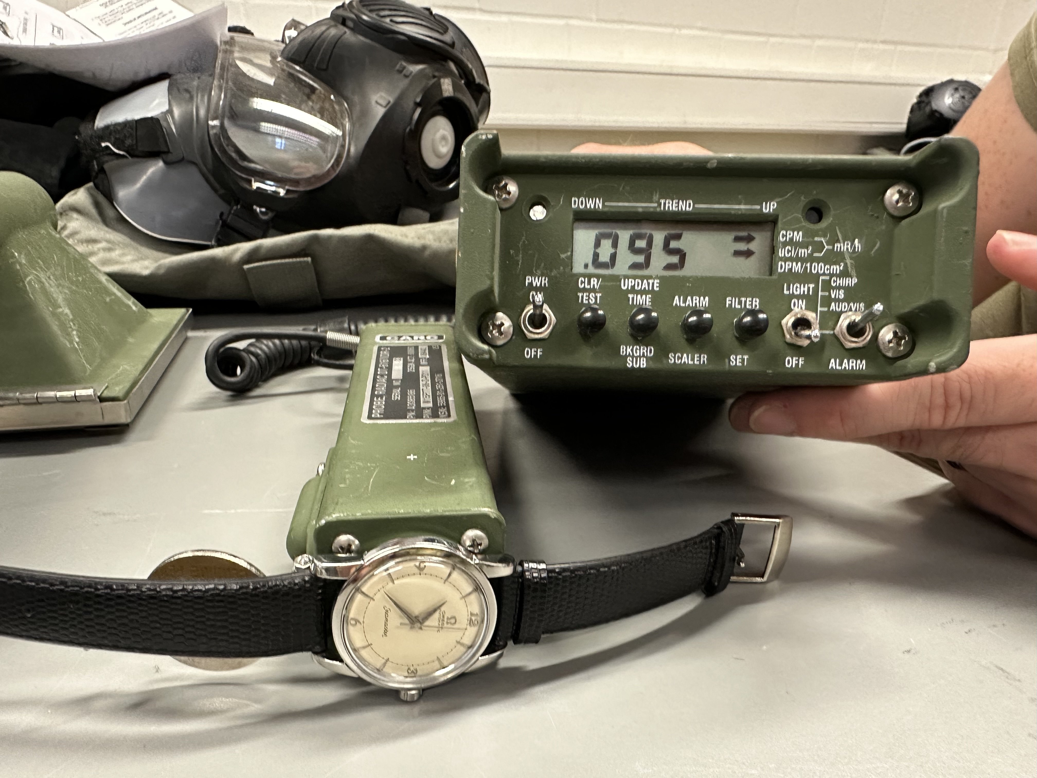

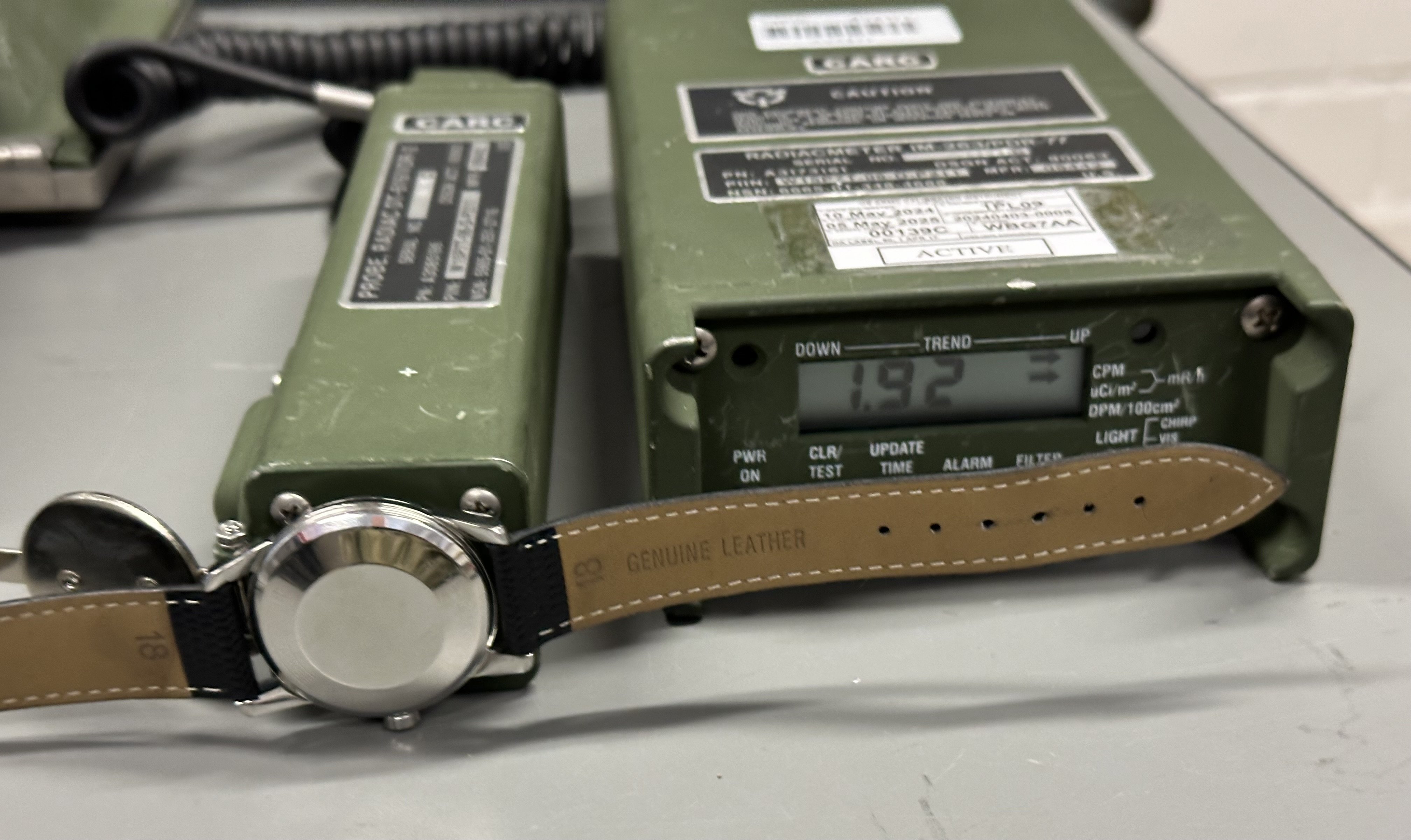

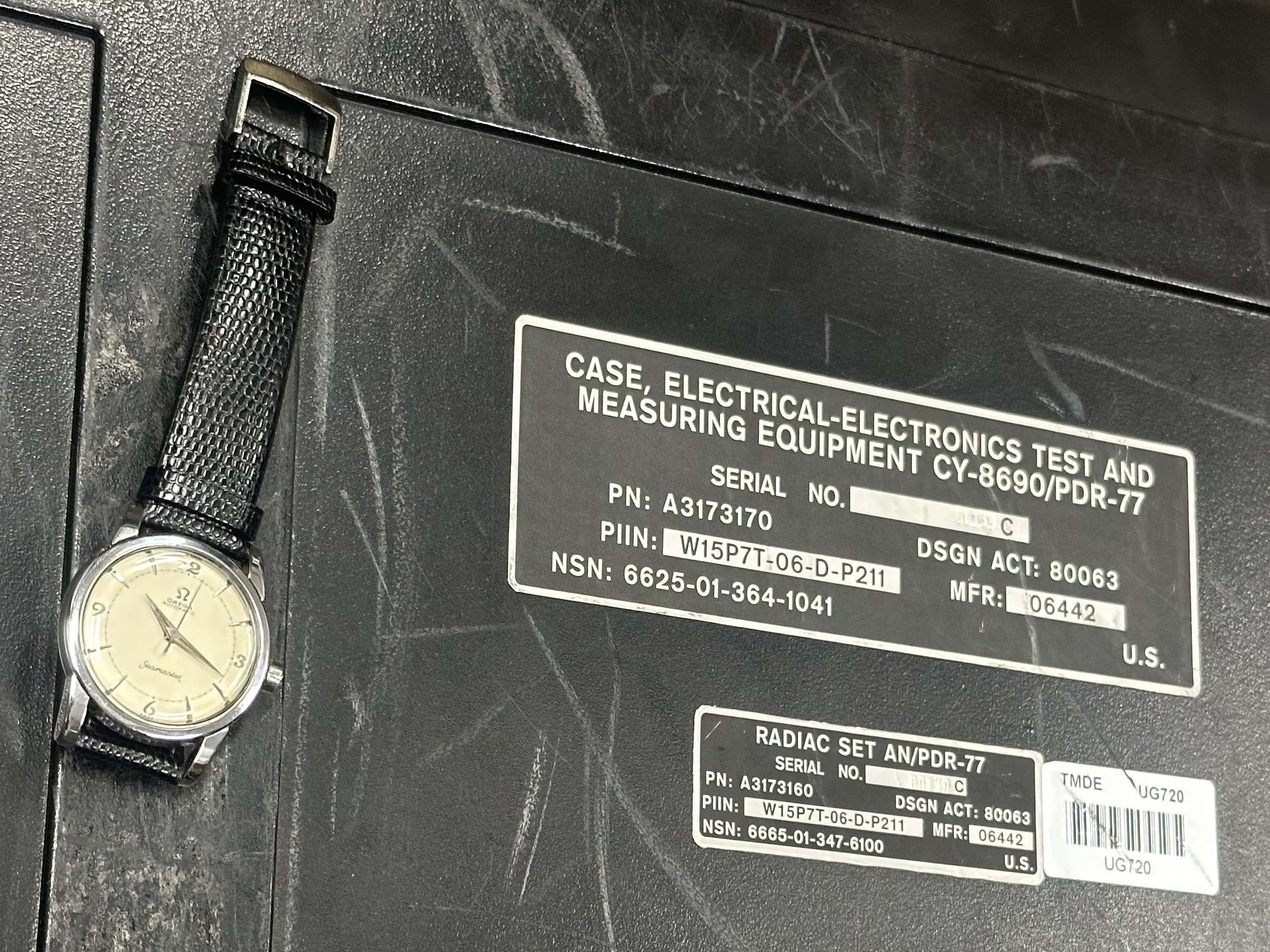

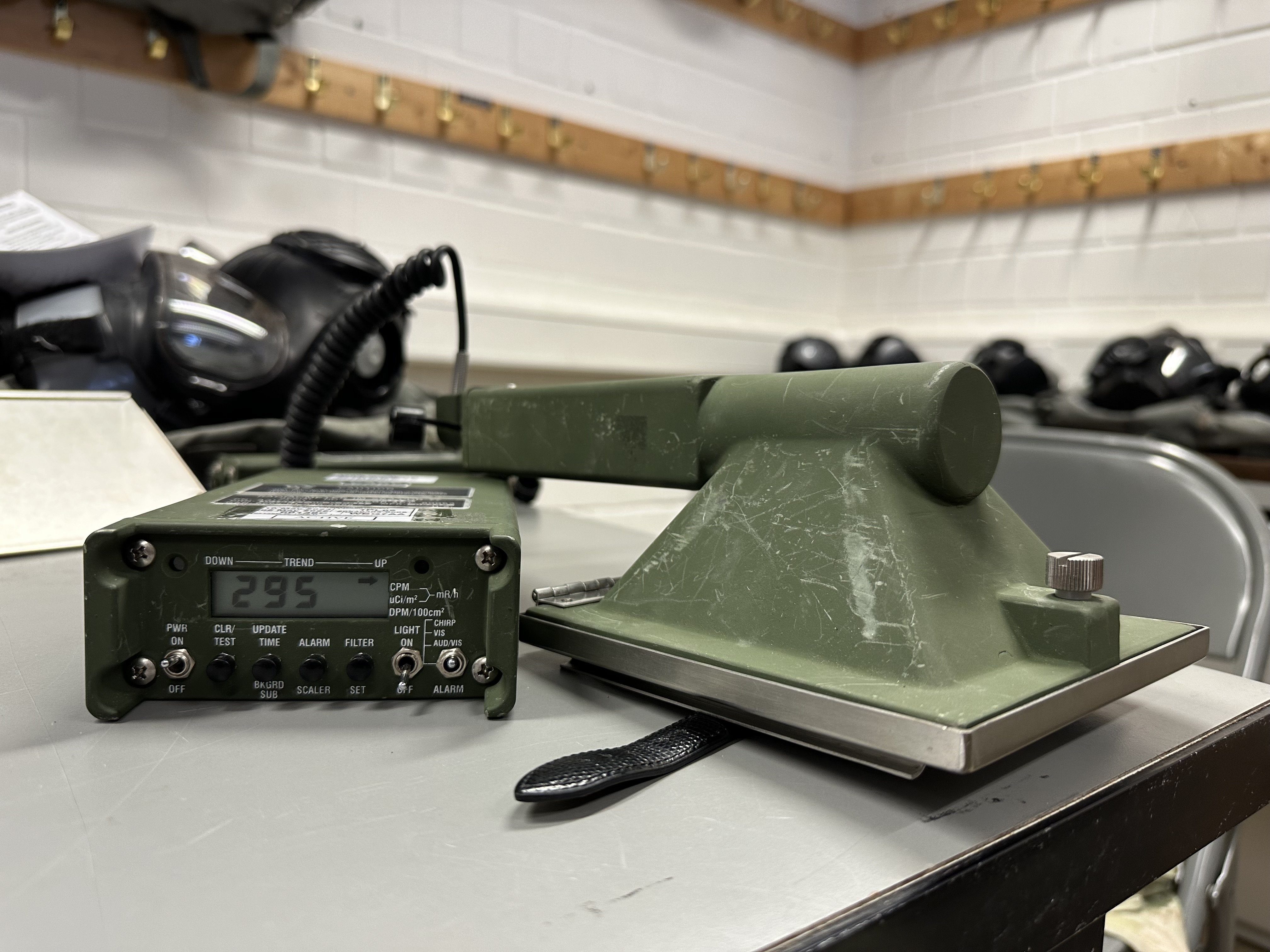

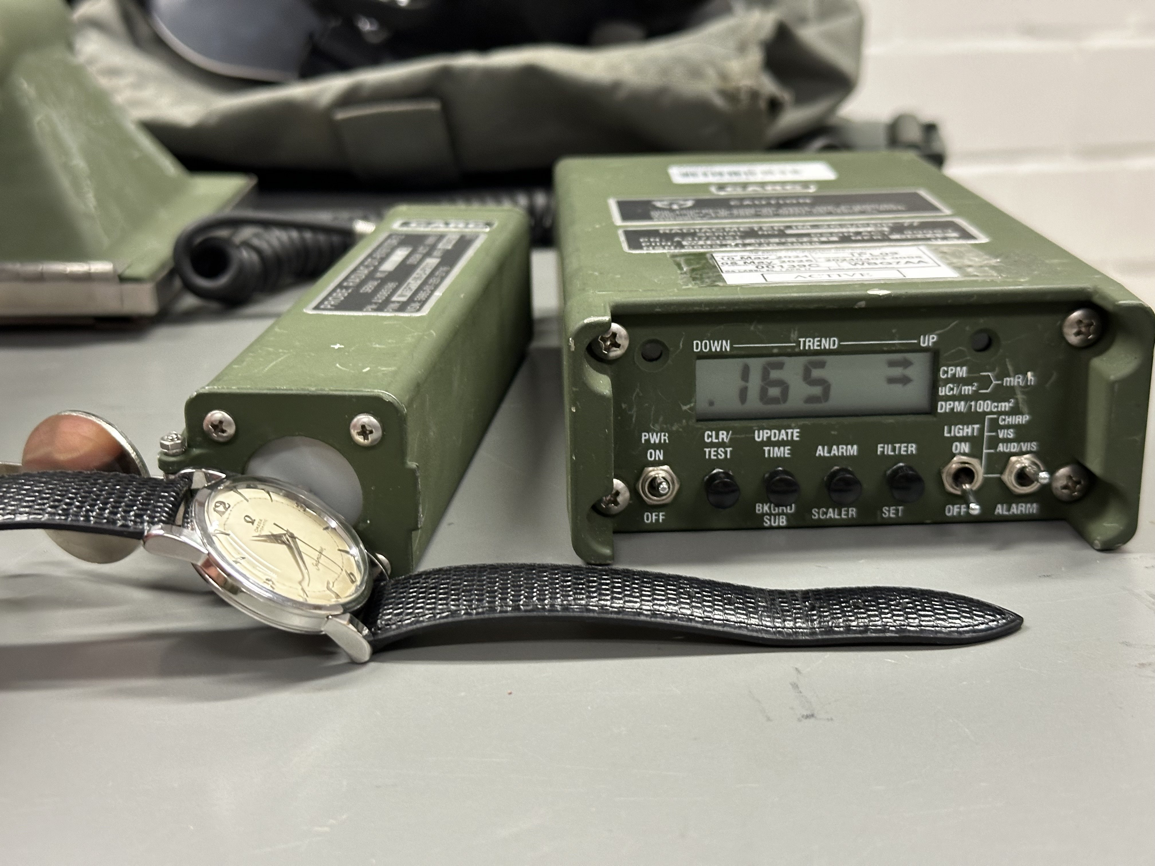

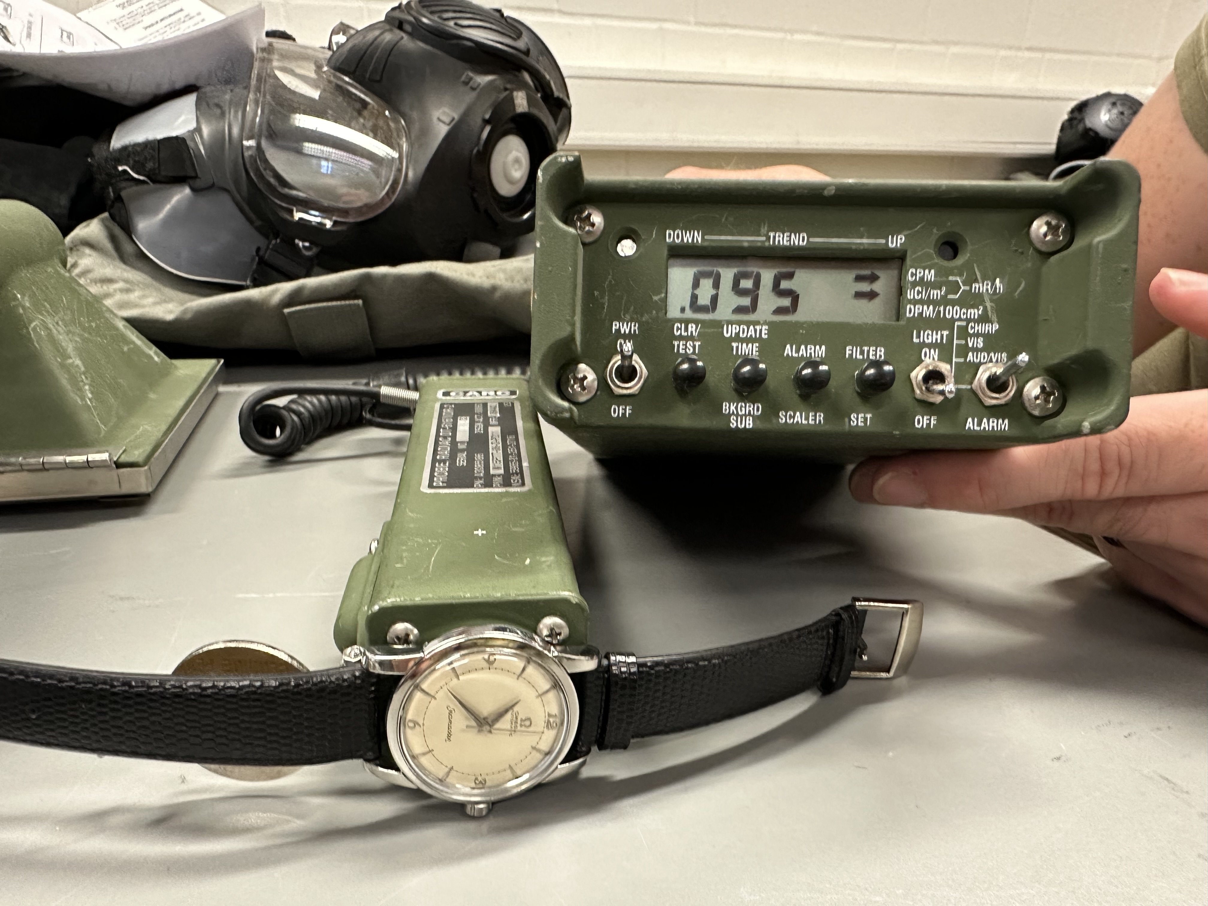

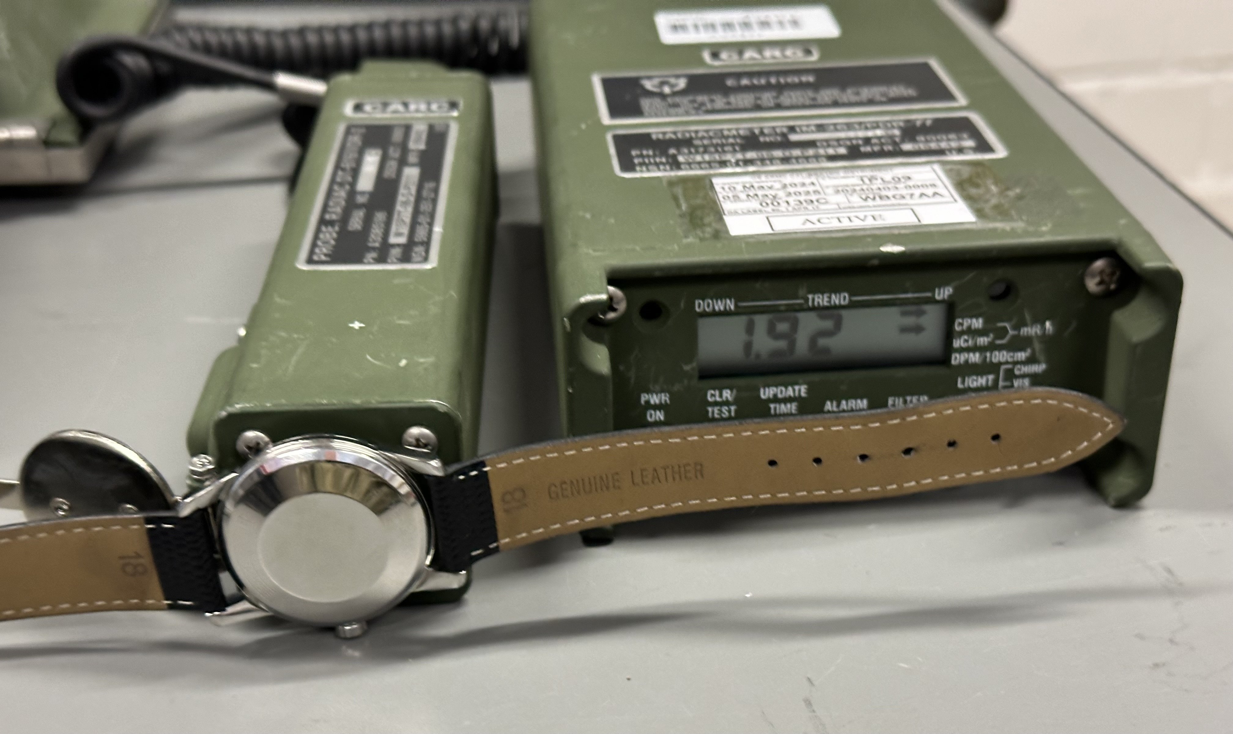

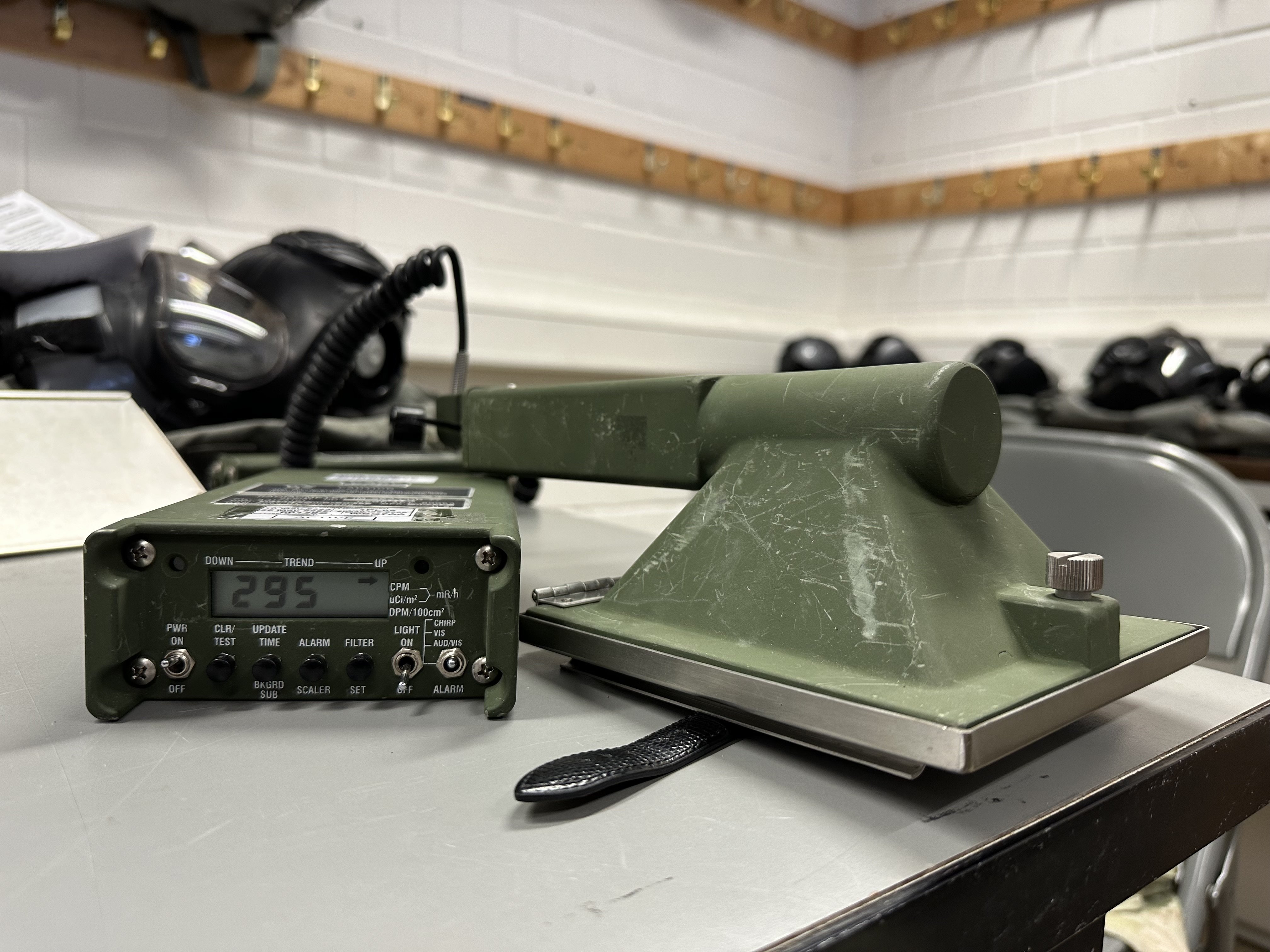

First photo is an alpha detector; second, third, and fourth is a beta/gamma detector on various parts of the watch.
Unsurprisingly, the back of the case is roughly 1/20th the beta/gamma exposure than the face ( nothing but some thin plastic between that radium and the world).
Citing info given here:
A "pretty normal, depends on local geology" on the back; "Real risk of cancer" on the front.
Interestingly, there were no more alpha particles detected than baseline on the back. Front had some detection, even after wiping it down to account for external contamination.
Radon not evaluated, but a discussion for another time.

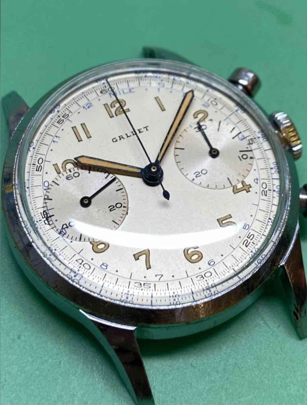

I definitely second the work of James Hyman to be able to relume this. Aesthetically it will look much better, especially lumed in a vintage dark yellow/tobacco color, and it might actually improve the value of the watch.
Reluming is not what it used to be. Many people can do this really well now, and they'll often use zinc sulfide, which is what a lot of old lume was originally made of (minus the radium or tritium)
I have a Gallet from the 50s that was putting out maybe 12 micro severts with the original radium. It looked green and awful and it just seemed like too much unnecessary risk on my wrist. Attached a photo of James' relume work. Did an amazing job on the numbers, and this is a really small 34mm dial.
A lot of people are more aware today of radon gas, and needing to keep radium watches in a ziplock bag, but also the lume degrades and flakes and can burn and damage a dial. You see radium burn on a lot of old rolexes. To me its much better have a sympathetic relume and have these watches last another 70 years.
