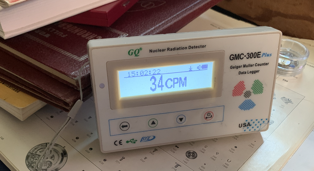

Thank you. This is interesting, and it’s absolutely the radon issue that I was more concerned about. Lots of people tend to focus only on the alpha particles and how you would need to breath in or ingest the radium dust itself to cause an issue, when it’s actually much more complicated than that. As I mentioned I literally tested this on a shelf with a Geiger counter a while ago, and I’ve just rerun some tests. Now I remember why I was concerned…
I attach the photos, but as you can see, immediately in front of the dial (where you are unlikely to be, unless you fall asleep with your watch on?), it goes off the scale and records something over 9.99 micro Sieverts per hour. Measured from behind the watch case (ie your wrist), the dose is 2.18 micro Sieverts per hour. Finally, six inches in front of the face, it’s 1.55 micro Sieverts per hour.
As can be seen from the final image “How much is dangerous” which came with the Geiger counter, it states that 1.25 micro Sieverts per hour gives you a real risk of cancer if exposed for a year. That’s much below what your wrist would experience, and who knows how long you’d have to be near the face for it to be a concern.
Anyway, hopefully someone will find this helpful, and from real-world data.
And just to provide an interesting comparison, exposure while flying at commercial altitude (35k) is approximately 3 micro Sieverts per hour). So its reasonable to think about wearing that watch for a few hours as equivalent to time on an airplane based on your readings. Obv not accounting for radon exposure, but that should be minimal if you don't keep it in an enclosed space.

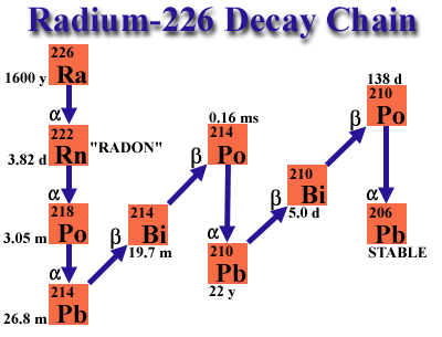

But radon is an alpha emitter and the results of radon decay are not stable either, and many of them have very, very short half lives.
I honestly wasn't sure of the entire chain so I pulled this table from the internet:
If radon gas was able to get out of the case via gas exchange, you would certainly have multiple alpha and beta emitters within days before it hit lead 210. More emmiters after as well.

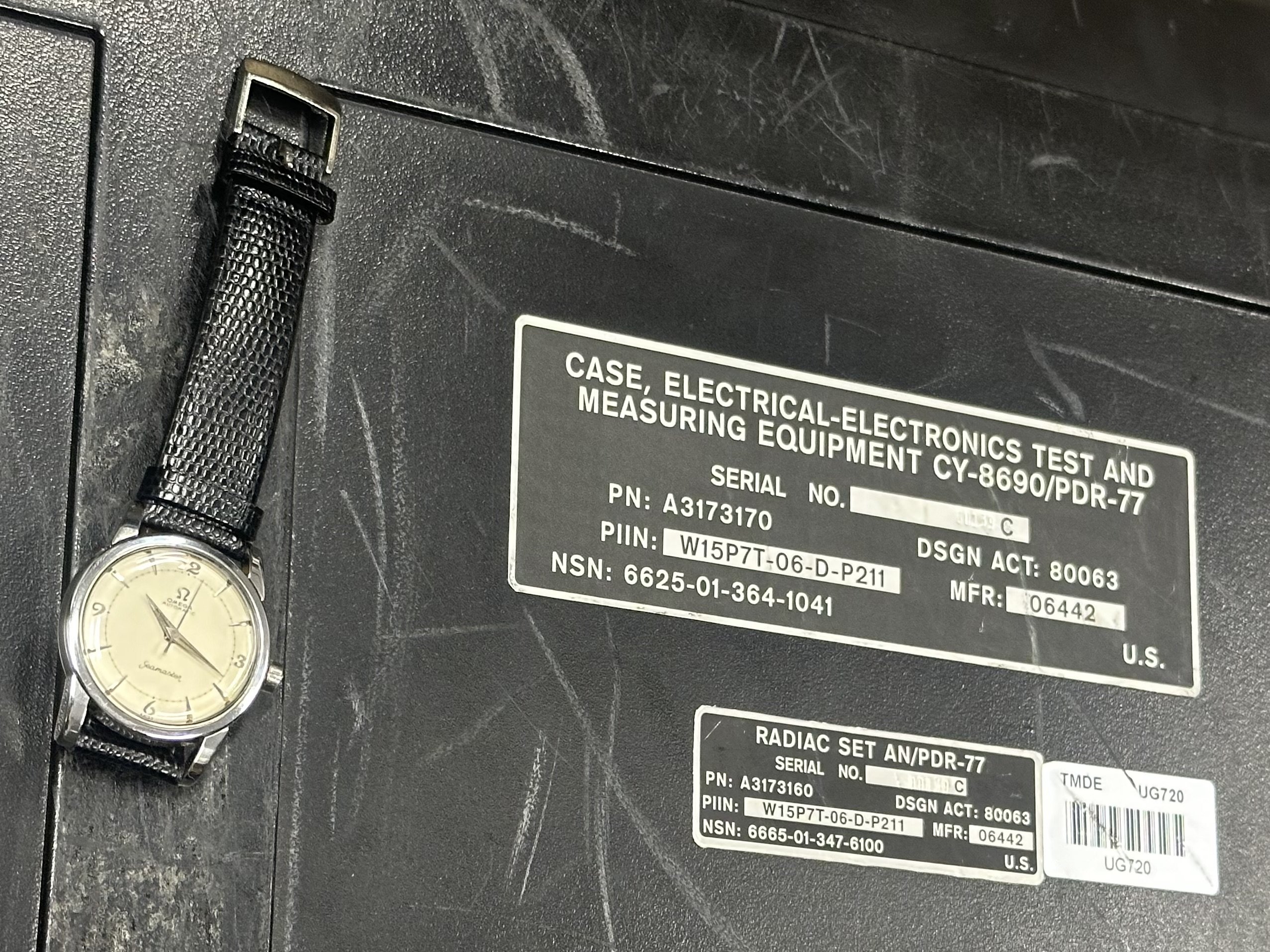

Got inspired to check in my radium watch. Spoke with our chem/radiology SME today. More to follow this week
