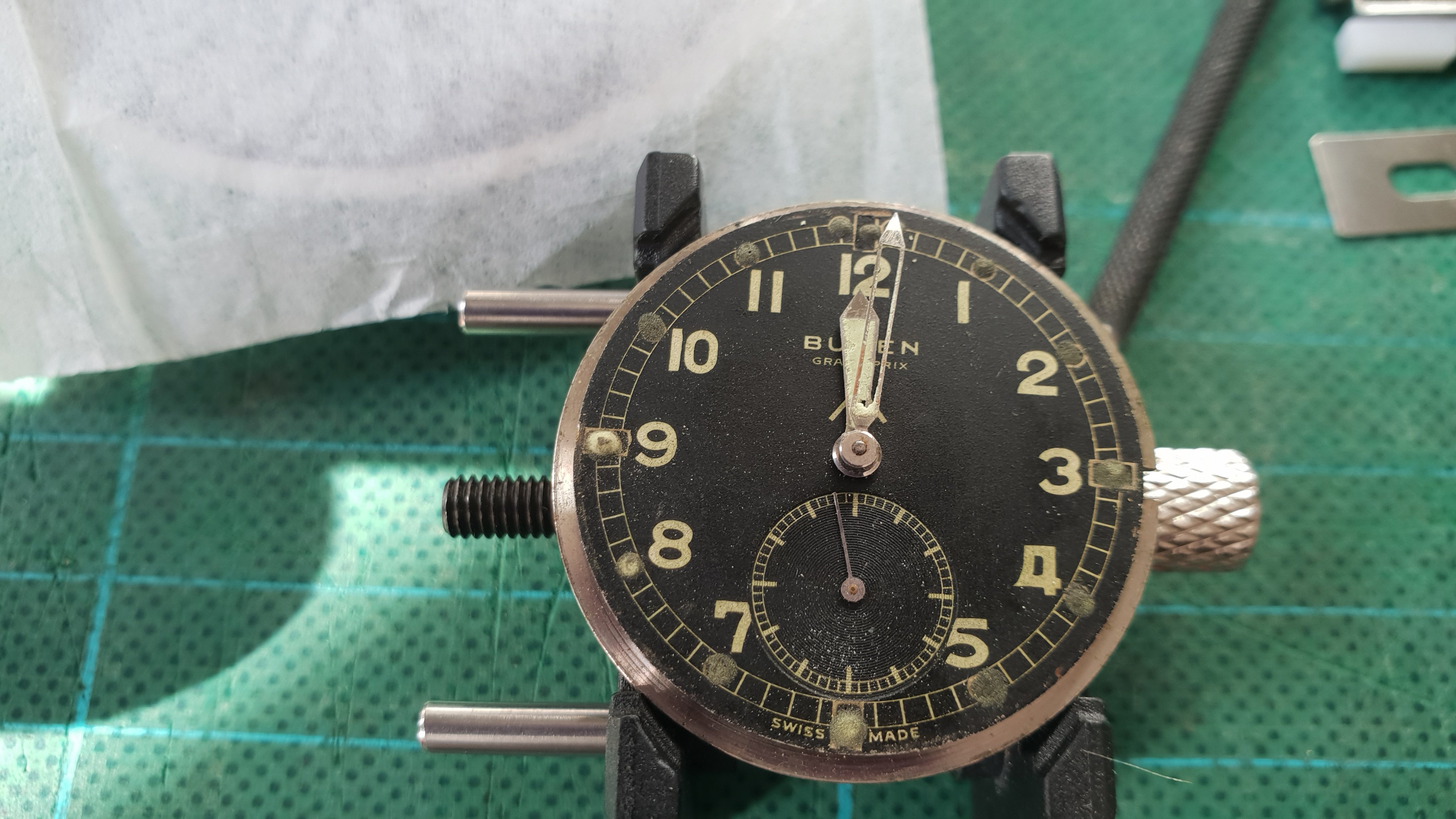

I am new to the forum so first of all hello everyone! Does anybody have experience with the radioactivity of a previously radium lumed watch after a regular service including removing the radium from the dial and repainting it? Will radium dust and other fallouts be removed during cleaning of the watches parts and therefore the radioactivity be eliminated?
Best regards, Louis
8,097
28,526
Best regards, Louis
There is no way to answer that, as it would depend on how thoroughly the watch, hands and dial are cleaned. However, whatever material might remain will almost certainly be of no danger at all to the person wearing the watch.
3
There is no way to answer that, as it would depend on how thoroughly the watch, hands and dial are cleaned. However, whatever material might remain will almost certain;y be of no danger at all to the person wearing the watch.
Hello, thanks for your reply! so whats the most proper way to clean movement parts, crystal and case? an ultrasonic bath? I assume after an ultrasonic bath the radium dust layer on a crystal for example is removed almost completely?
8,097
28,526
You're welcome. I would expect that ultrasonic cleaning would effectively remove radium from the parts, yes. Bear in mind, though, that the danger of radiation from old watches comes almost exclusively from the potential to inhale particles, so as long as you have someone else do the cleaning, you are likely to face negligible risks.
If you do choose to clean the watch yourself, then you should obviously wear both a mask, and protective eyewear.
3
Yeah I get you! Point is I'd like to wear the watch on a daily basis without having to think about radioactivity that's why I'm trying to figure out how to remove radium from a whole watch! if anyone has tried that and measured radioactivity levels before and after I‘d be happy to hear what you‘ve discovered!😀 thanks again!
