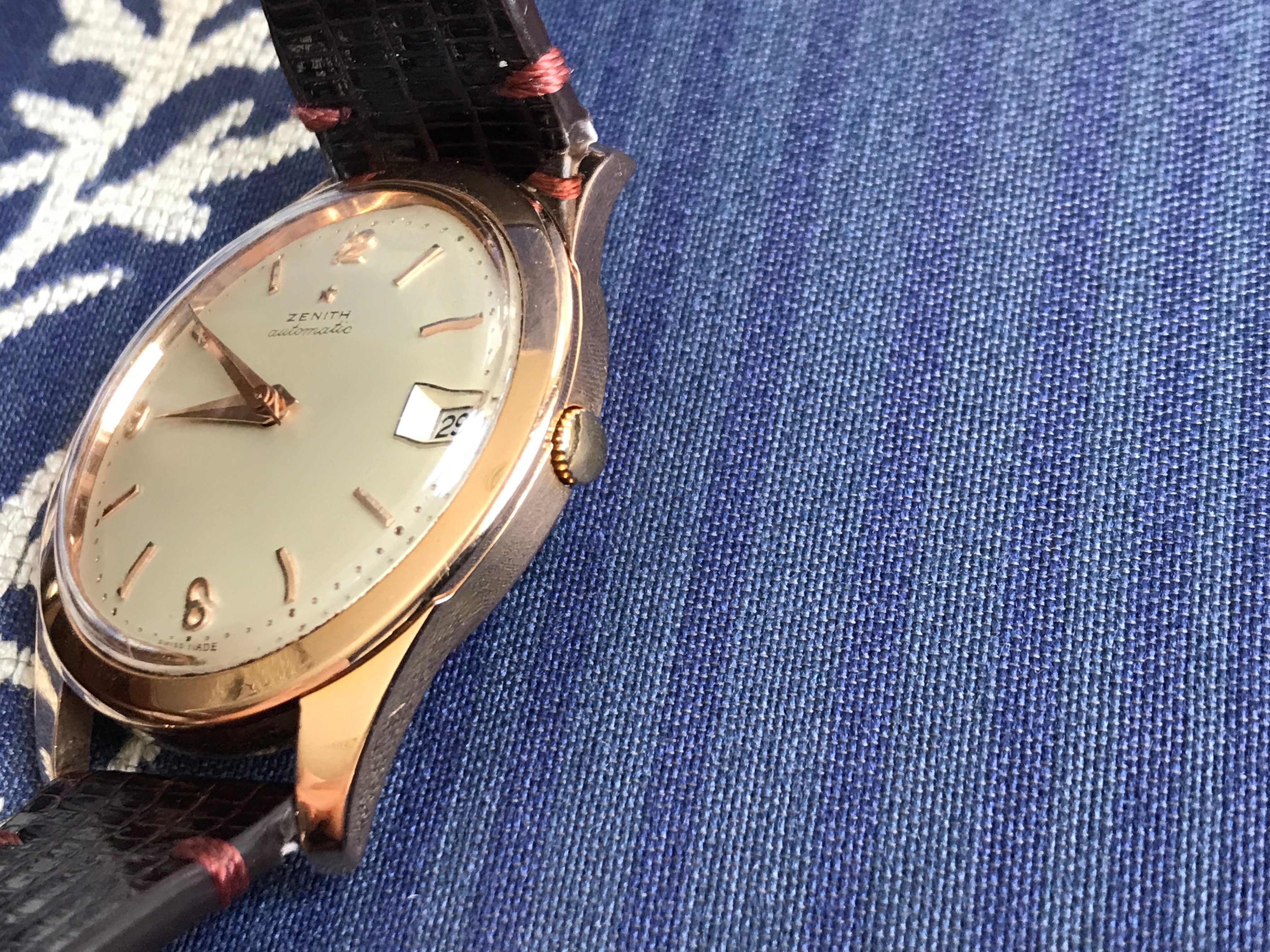

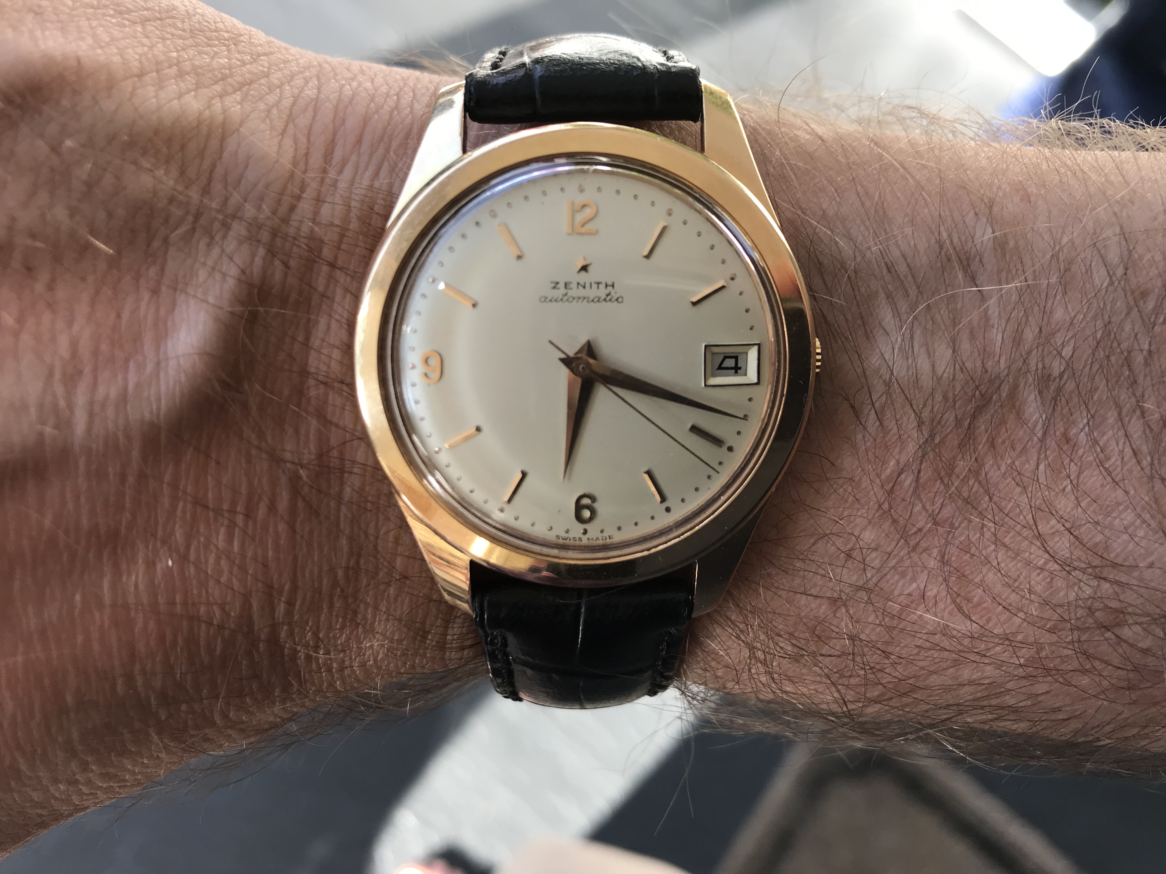

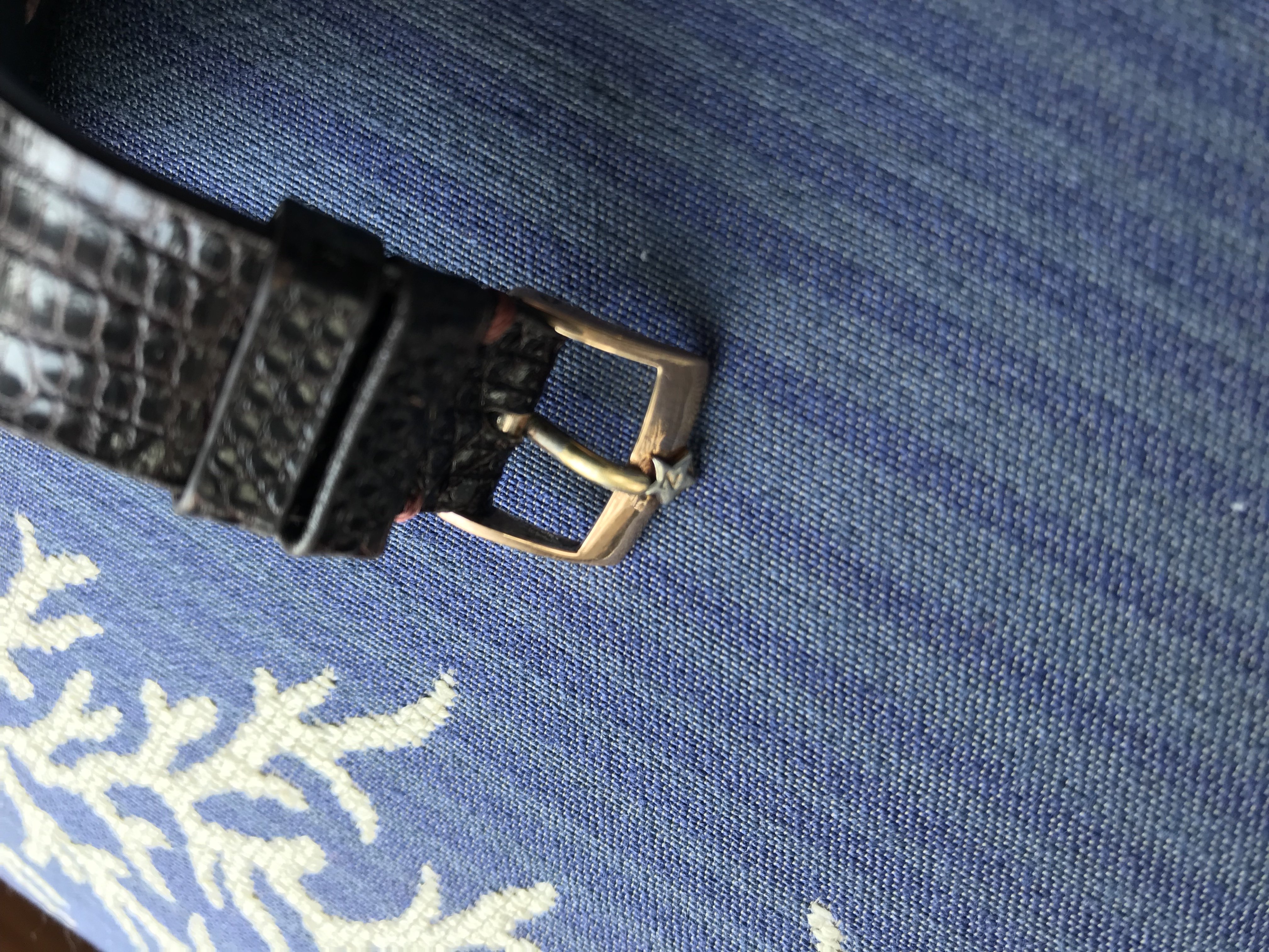

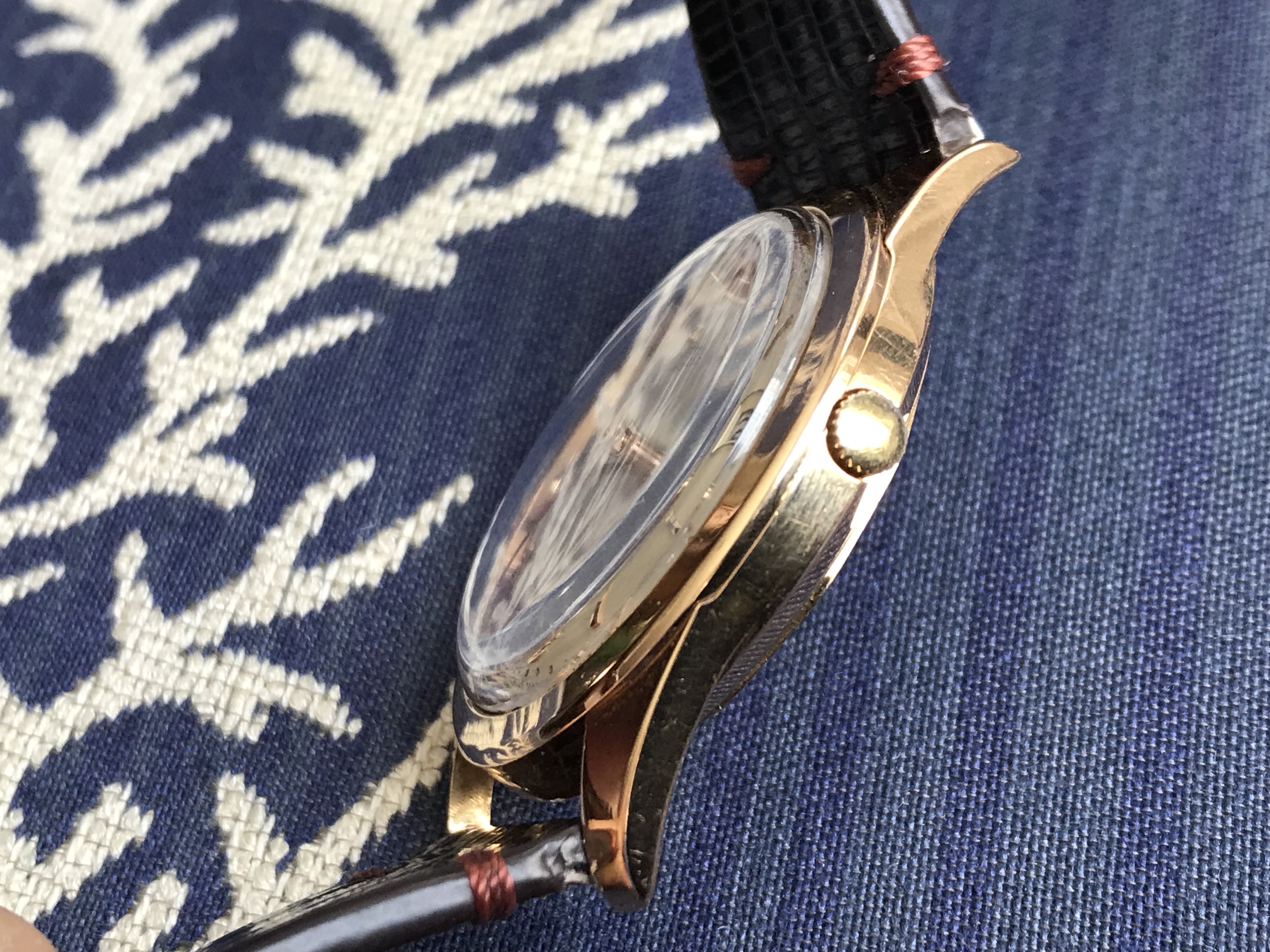

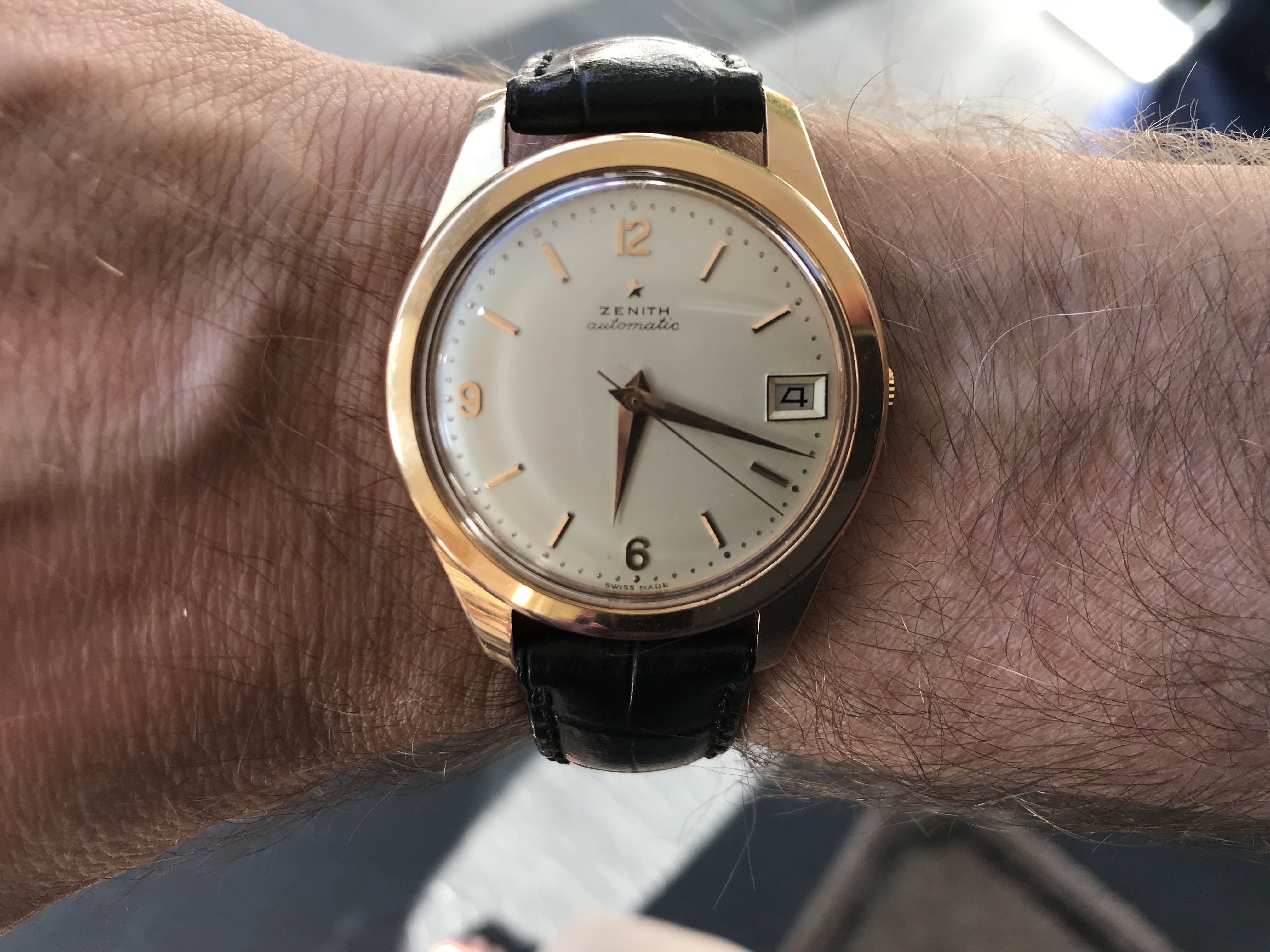

I really love my Zenith Caliber 71 watch, and I’m starting to think about its first full service under my ownership. I don’t think it needs service yet (running about 30 seconds fast per day and was serviced about a year ago from a reliable dealer from whom I purchased the watch). However, I am starting to consider whether in the future the watch should go to Zenith in Switzerland or to an independent in the US for its service. My thinking is I would like to ensure that it gets returned to its near original condition with parts such as the crystal (the current one has some scratches that cannot be removed by polishing), the crown is unsigned and I think I found the appropriate buckle for a 1950’s era Zenith. The case is 68,0000 series and the cal. 71 is 480,000 series. Your assistance with answering my questions and advice are greatly appreciated.

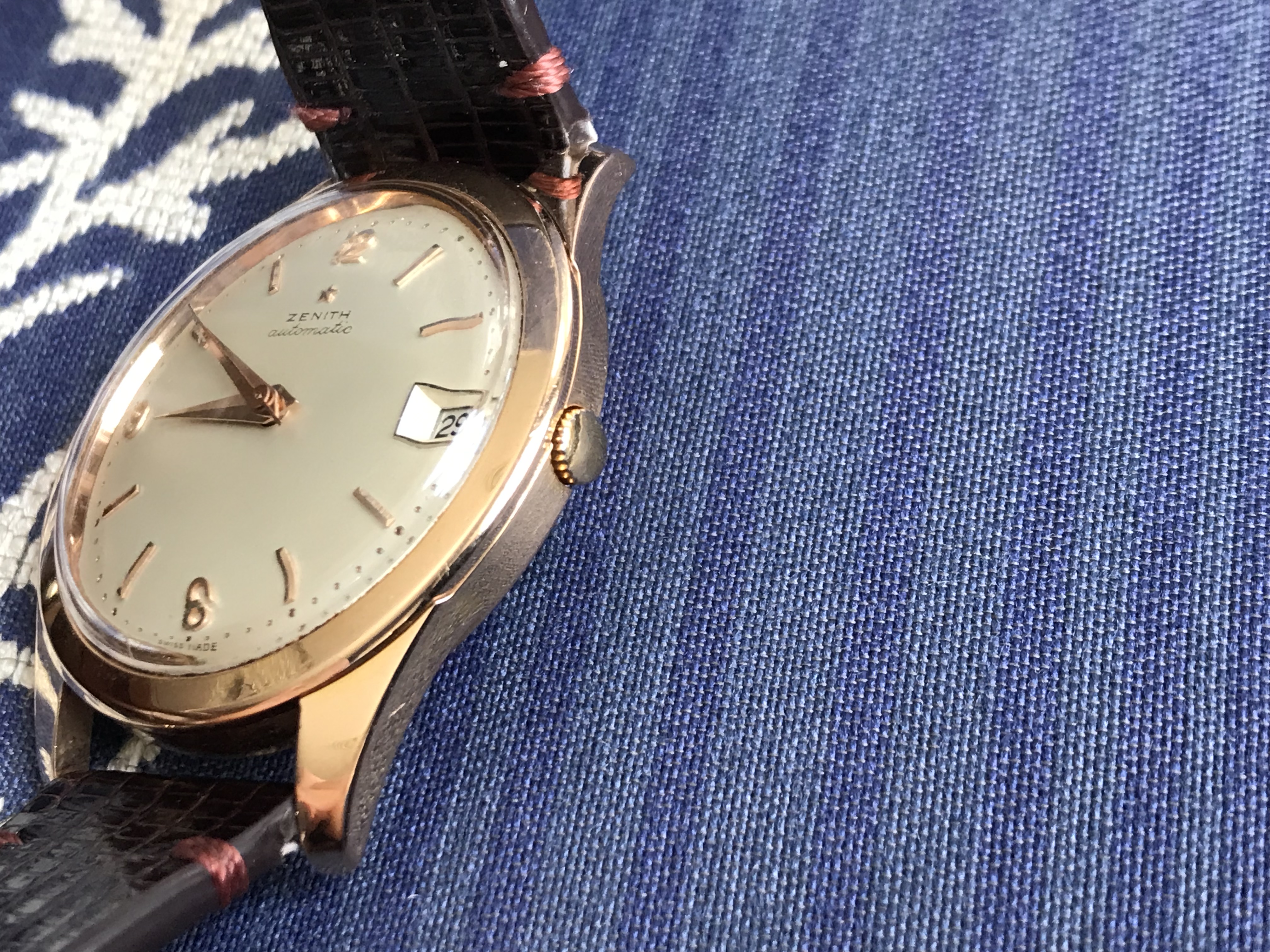

Is this crown original / consistent with a Zenith crown for the period of this watch?

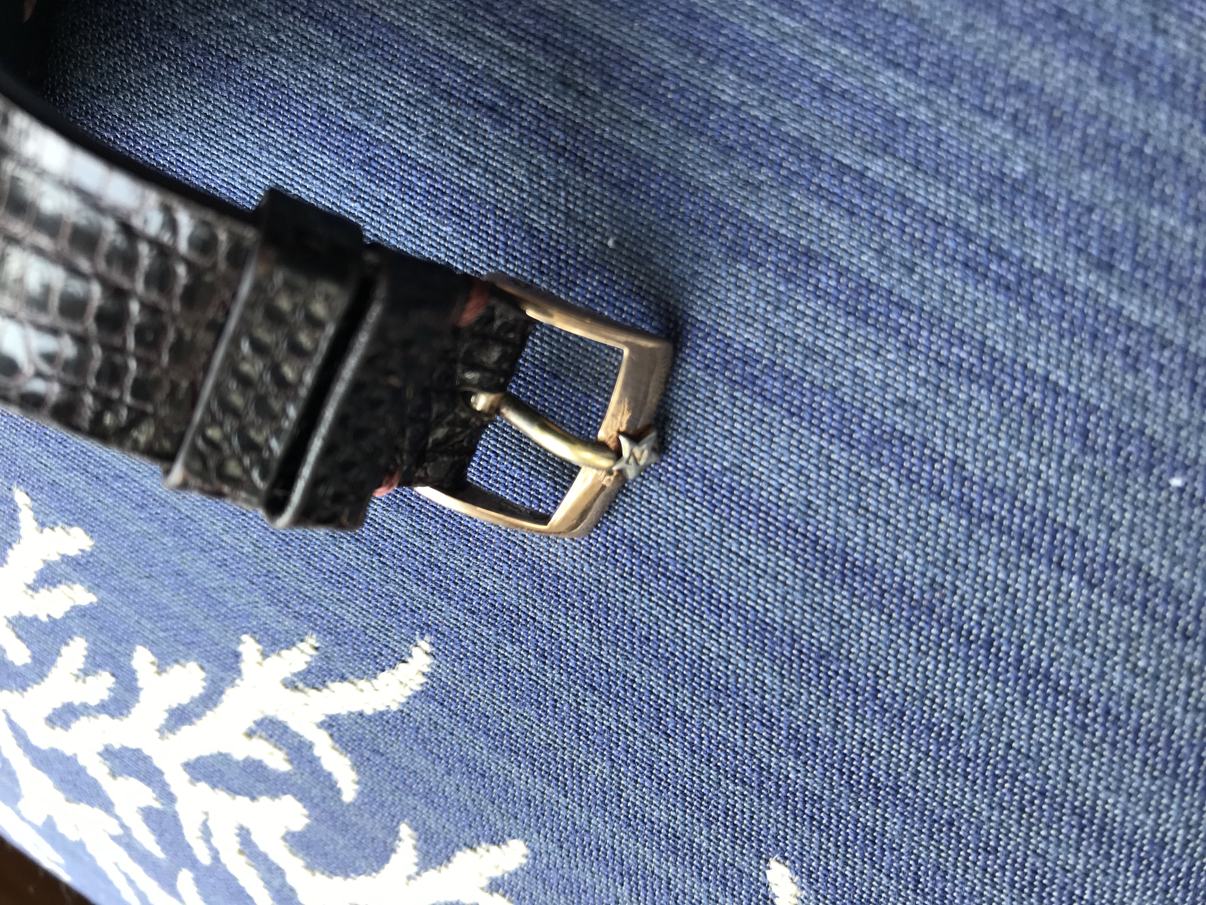

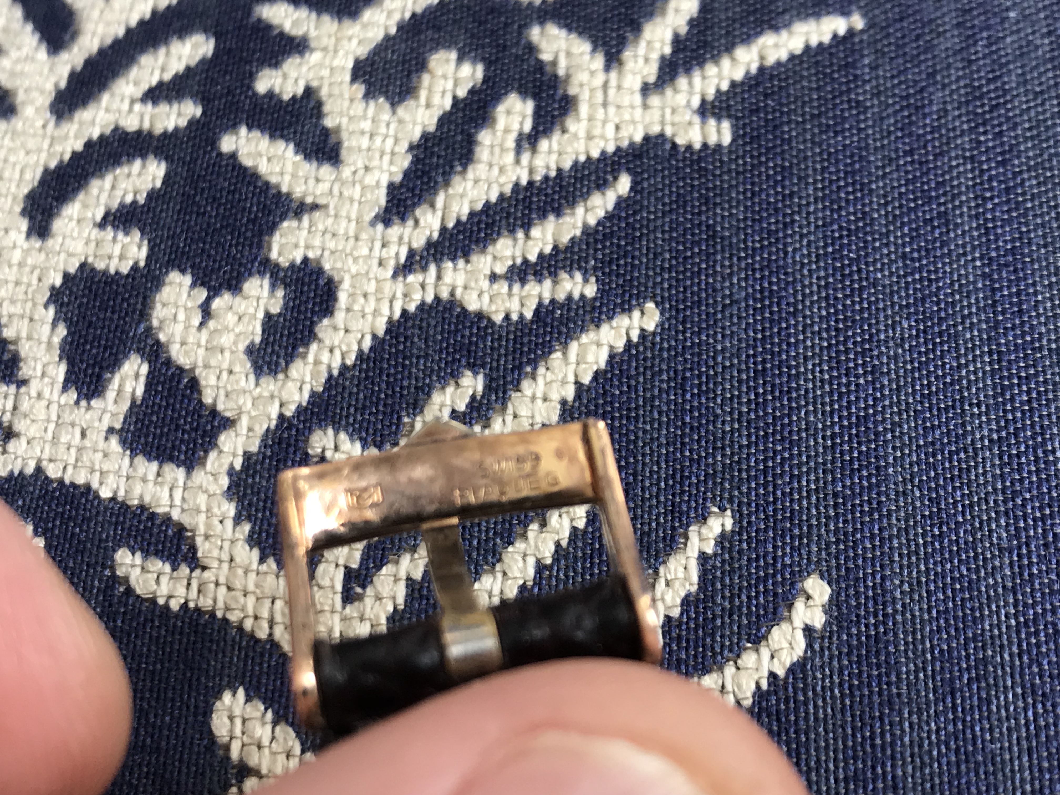

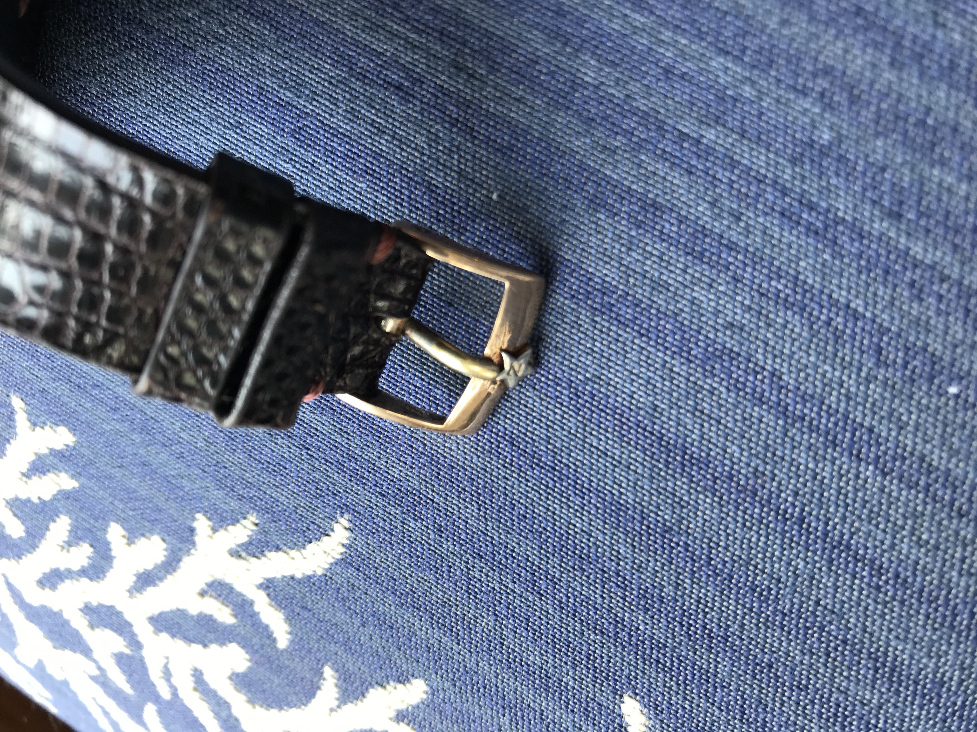

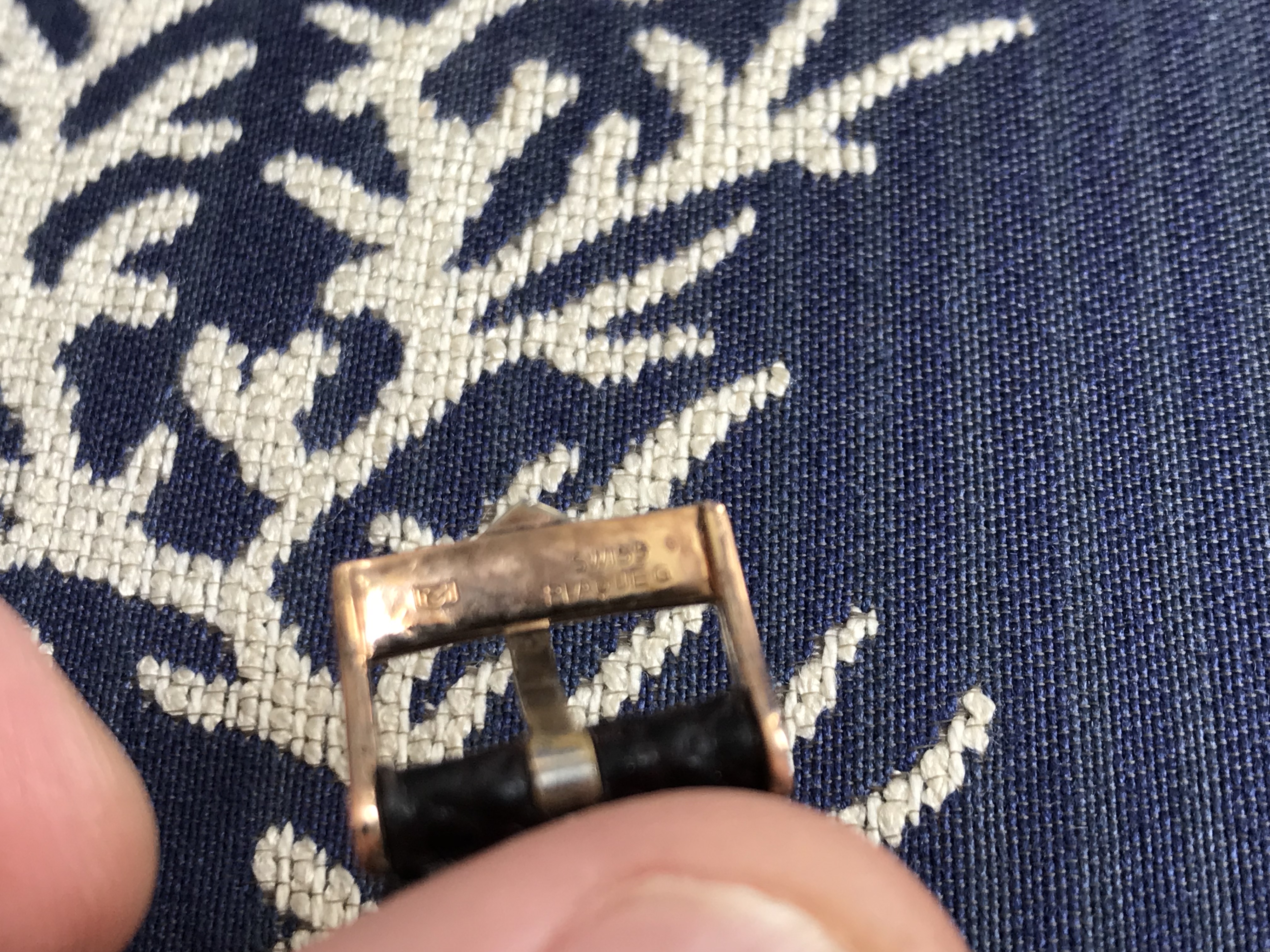

Is this plated buckle, which I recently purchased, consistent with a Zenith buckle for the period of this watch?
Should this watch go back to Zenith for a service or to an independent watchmaker in the US, and why?
Below are the relevant photos.
Thank you for your help. DTM

I forgot to add that based upon my research, the watch dates to around 1958, and the buckle appears to be appropriate for that period. I’ve seen similar Zeniths with a signed star crown; however, I’ve also seen add from the 1950’s with watch that appear to have unsigned crowns. Thanks again for any insights. DTM
1,997
3,583

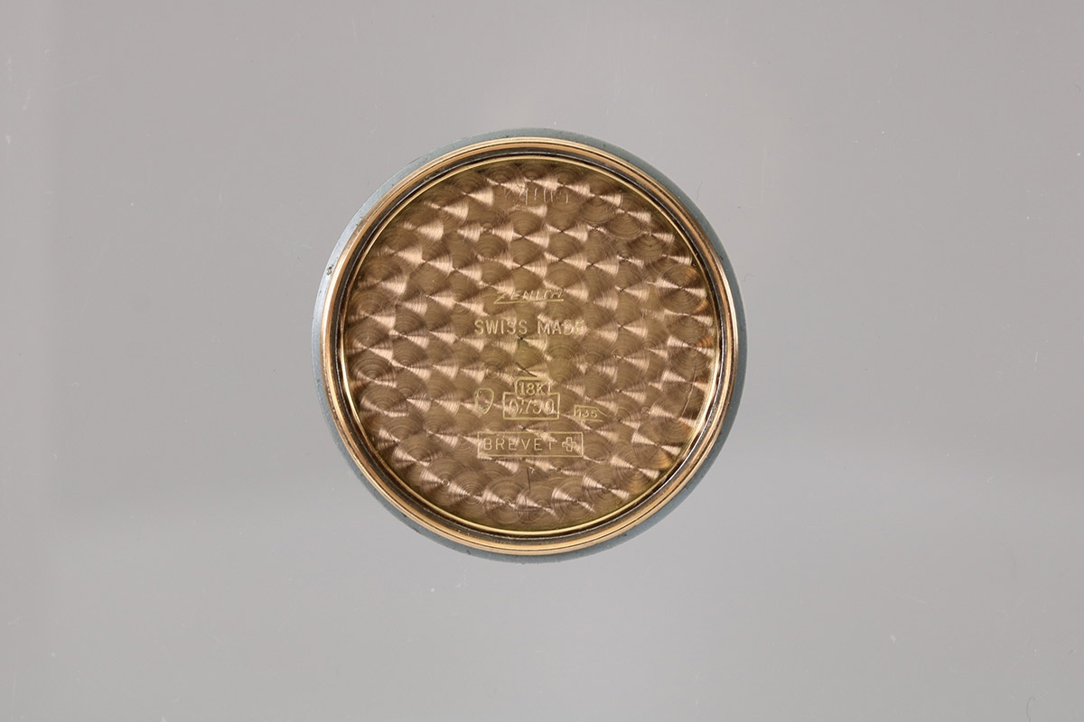

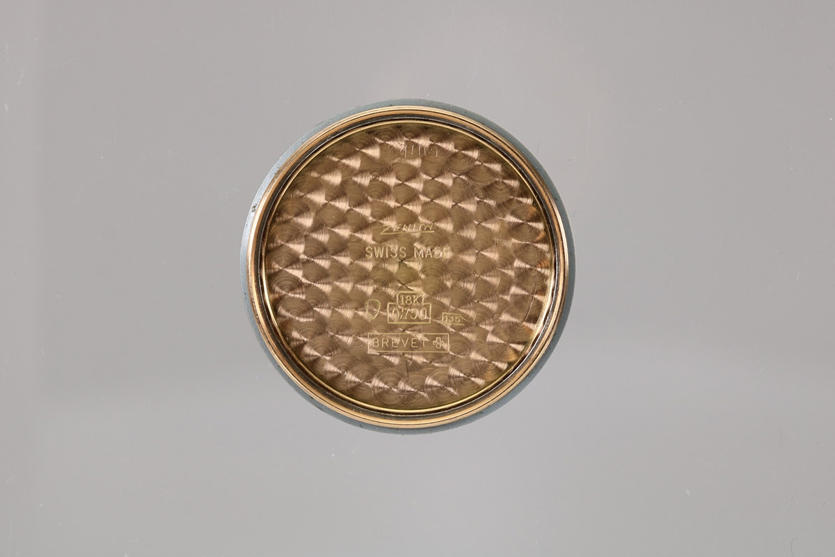

You have one of the uncommon Dennison cases with the recessed crowns. Most likely a Z Star crown. Case and Movt numbers look right for 1958. The buckle is correct as well. Inside caseback will probably say BREVET with a cross
204
352
Thanks. Here’s a photo from the dealer of inside the caseback.

Did the US dealer confirm it received a full service? I would assume they would have changed the lead gasket on the caseback if so.
204
352
Thank you. The gasket has been changed. The reason I was considering Zenith for the service was they’d be able to ensure the correct crown was on the watch. However, if I can learn that in advance, perhaps the independent watchmaker can source the correct crown if the current crown is a generic replacement crown.

Thank you for the advice on going with an independent watchmaker. Can anyone confirm that the star with a “z” is the correct crown for this model? I appreciate the help.
8,293
29,372
I'm not sure about that. The type of case that you show is what I might expect to see with a recessed, or semi-recessed crown, and I don't know that Zenith would necessarily have signed them. I am not an expert, though I have owned a couple of (bumper) Captain models.
Having done a quick search, perhaps they did sign them:
http://www.atelier-horloger.fr/boutique/vente_montre.php?num=38&mini=4
https://www.ebay.fr/itm/175455110544
8,293
29,372
Yes, I'd say that both are possible. Zenith certainly produced models with unsigned crowns, and in a sense, they would work more seamlessly with that type of case.
204
352
Thanks. It seems as though I should find a watchmaker who can source a pink / rose gold vintage Zenith crown with a star surrounding a Z.
1,997
3,583
you’ll need to find the right sized crown, width and depth if you want it to be completely recessed
204
352
Thank you. As I am not too familiar with vintage watches, is finding the right crown something I should do or can the watchmaker source one?
1,997
3,583
Both but a watchmaker may need to adjust the length of thewinding stem
