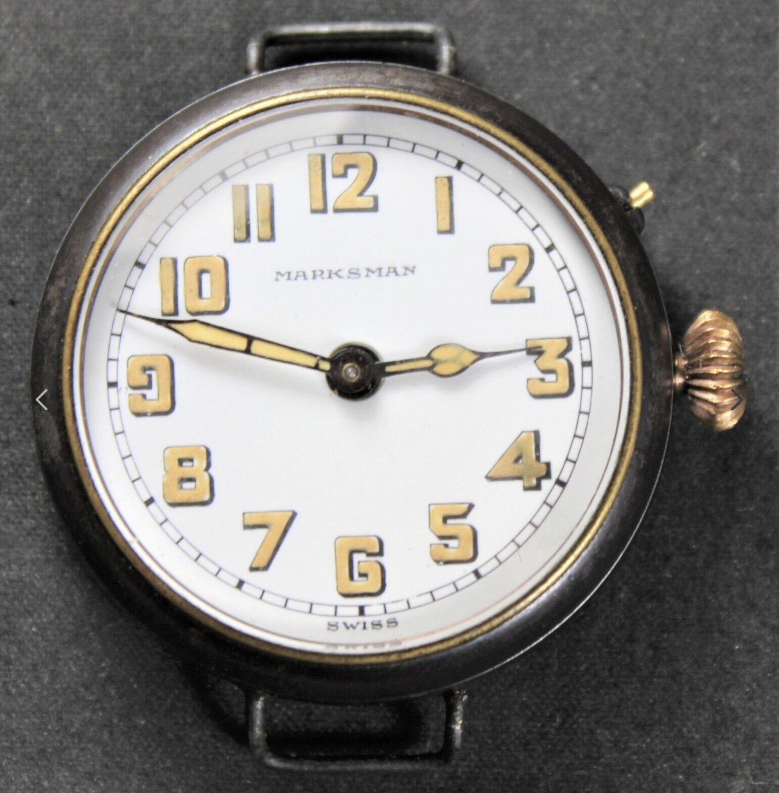

Hello chaps. I have been staring at this watch for quite some time. This ‘marksmen’ is a really excellent size for me. Dial looks great to me (don't mind the lack of sub seconds). Love its blackened case. But 1 jewel? From what Ive read briefly this implies the corrosion of the parts will occur quickly and that the watch will inevitably self destruct. I guess what I’m asking is: is the 1 jewel thing a deal breaker when it comes to buying watches? Would it mean I was basically buying a disposable watch? Are there modifications I cold make to it to increase its longevity? I feel as though I cant find conclusive information on this topic to inform my aesthetic attraction to this watch.

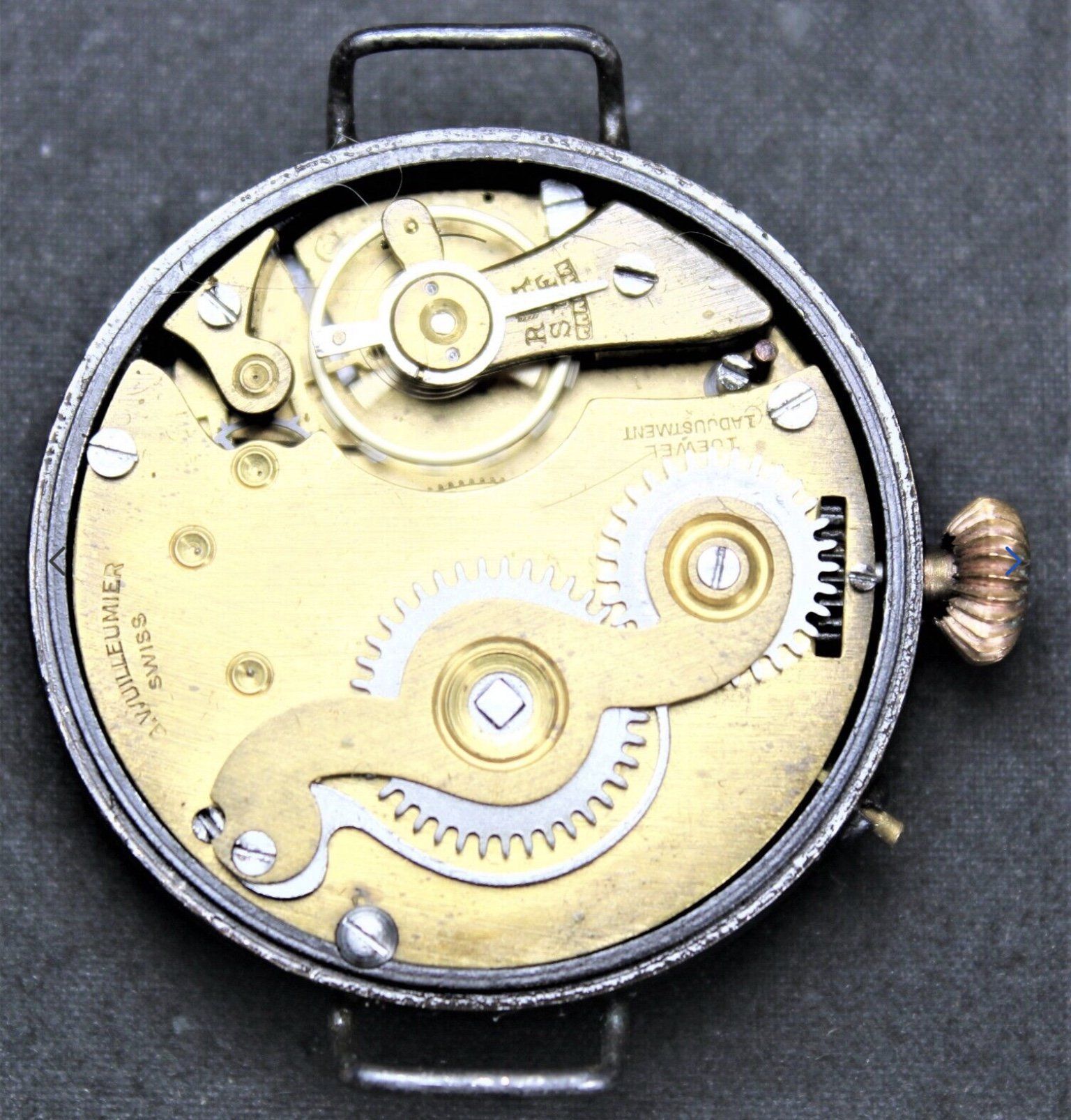

feels like modern dial and hands, what worries me about the movement is all the hair in it... If the price is very low, then why not...
Damn, i just noticed the hair, thank you. They want $269.
If there is no shipping and you would wear it sometimes then go for it but ask for a bit less. From a collectors standpoint its not interesting at all, if you want it as a fashion piece then go for it.
$269? In USD?
For a one jewel pin lever movement?
It would probably outlast you with regular care and servicing but anything more than that would be over capitalising.

$269? In USD?
No I think he got the decimal place wrong.
