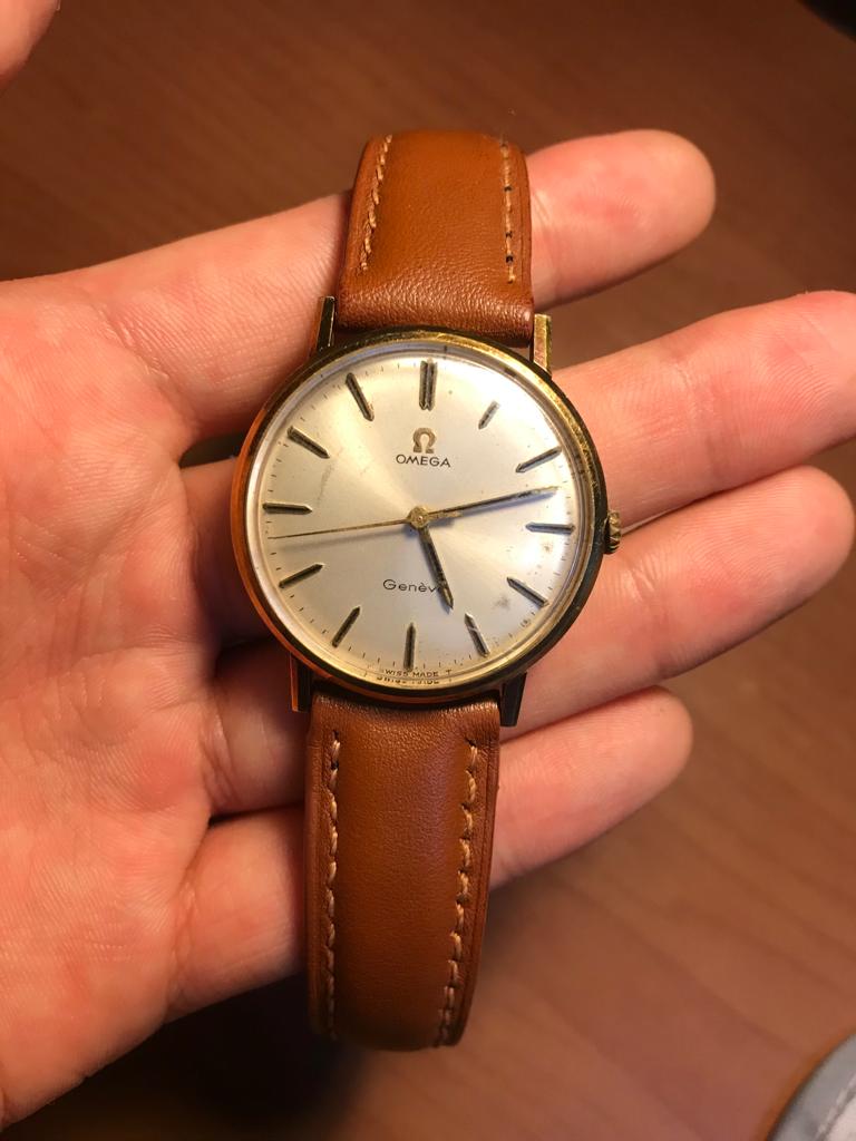

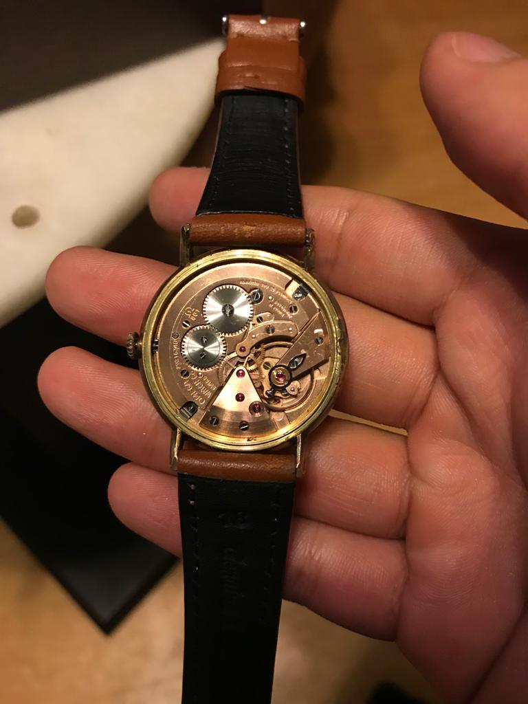

Hi everyone,
I have a cal 601 gold plated Omega Geneve.
I want to get a replacement for my crown as my current one is really worn down. Also, I don't believe it's an original Omega crown.
Would anyone happen to know how the original crown for my watch would look like? I see many examples of my watch online but many seem to have different types of crowns fitted on them.
I've attached photos for reference. Hope that it helps. Any advice would be greatly appreciated!
Thank you!
Best Regards,
Shawn
1,050
2,618
Welcome Shawn,
In order to provide a part number, we’d need the number from the inside of your case back.
If I were to hazard a guess, I’d say that is a 131.019. If that’s the case, Cousins lists the replacement crown number as 069NA32003. Note that this is a replacement part and likely differs from the crown that would have come on the watch originally.
