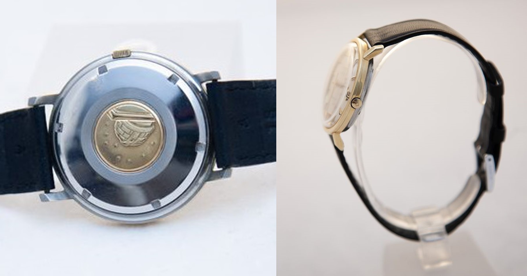

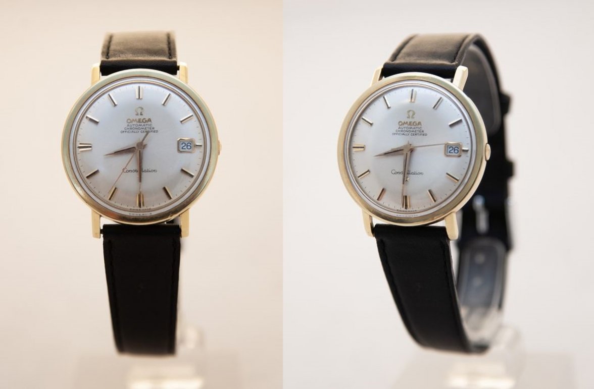

My question about the 168.004
Now I have been bitten by the collecting virus and would like to at least purchase a Constellation from the 60s. I am looking on many reseller sites on Internet trying to find something not too worn but affordable and came across this 168.004 hidden crown, which I like.
There are in IMHO 2 issues:
- Firstly it was already up for auction in December on eBay and was sold after only 1 bid and now it is up for auction on Catawiki. Maybe it is a bit of paranoïa but it seems strange to me.😕

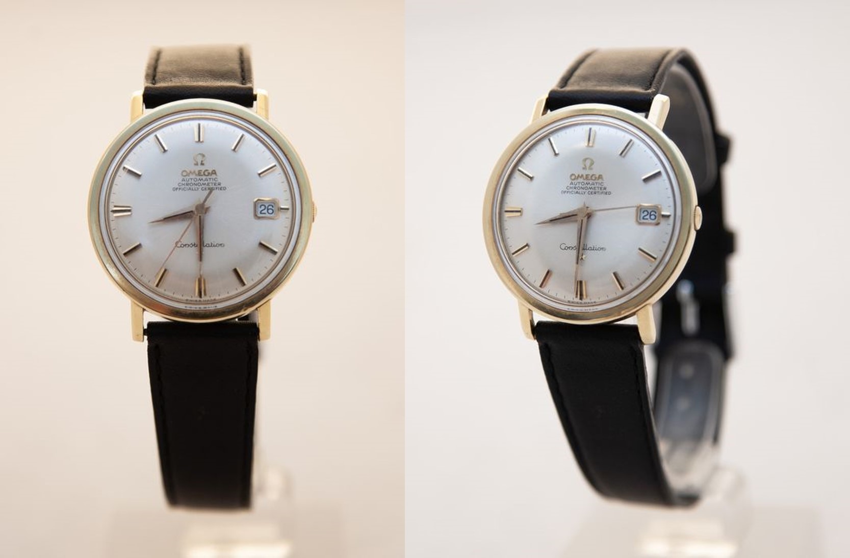

- Secondly, looking a the normal details it seems legit to my untrained eyes, except for one issue I have noticed: The Dial design. Since the 168.004 is slightly larger in diameter than other Connies, the dial should also be slightly larger to fit with the tension ring. From the photos it is not easy to see if the fit is good, but all 168.004 I have seen on the Internet does not have the special markers featured here at 6, 9 and 12 o'clock, but regular batons at 6 and 9 and double baton at 12.
Since there are so many knowledgeable persons in this forum, I am asking for your opinion if this dial is an original for a 168.004 case or not?

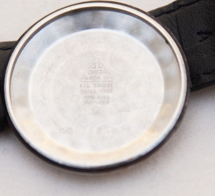

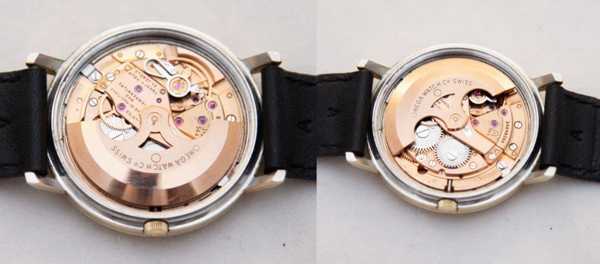

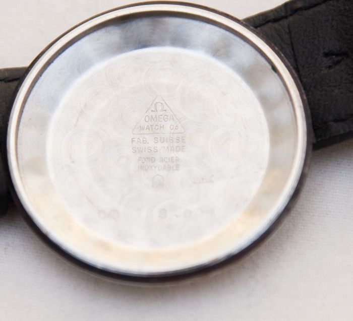

Except from the dial, do you notice any other issues on this watch?.
Many thanks in advance.😀
Ulf
5,026
18,608
Markers are not a problem. Dial looks to be good but better pictures are required. They are very blurry.
3
Thanks, nice to know about the dial.
I have asked for better photos, I will post them when/if I get them.
