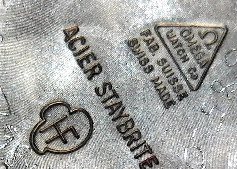

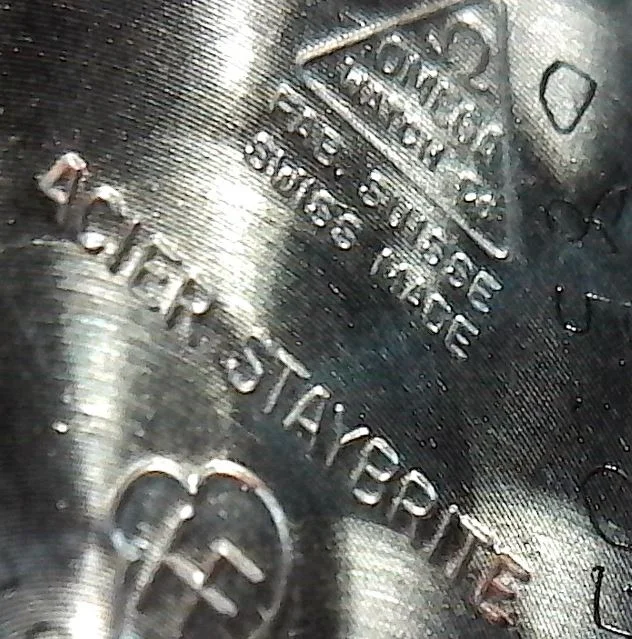

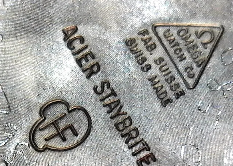

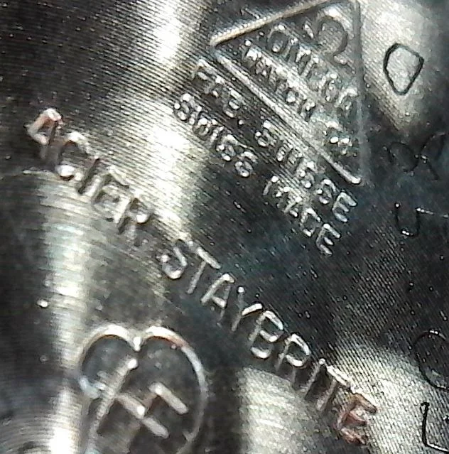

I’ve got to say I’m not seeing any issues with fake parts on this one. It does look like a franken; original vintage case
Service dial, hands and bezel
Mid-matched movement that may not have started life in a sm300.

I see red flags. Do you own this watch or looking to buy?
235
240
I think it’s obvious from the title thread that it already is his watch. Also why do you think that print is laser etched? I thought laser etched would look more sharp and consistent than in OPs pics.
4,521
11,135
I'm saying it's not struck with a die. My case is an HF but there is an obvious difference
