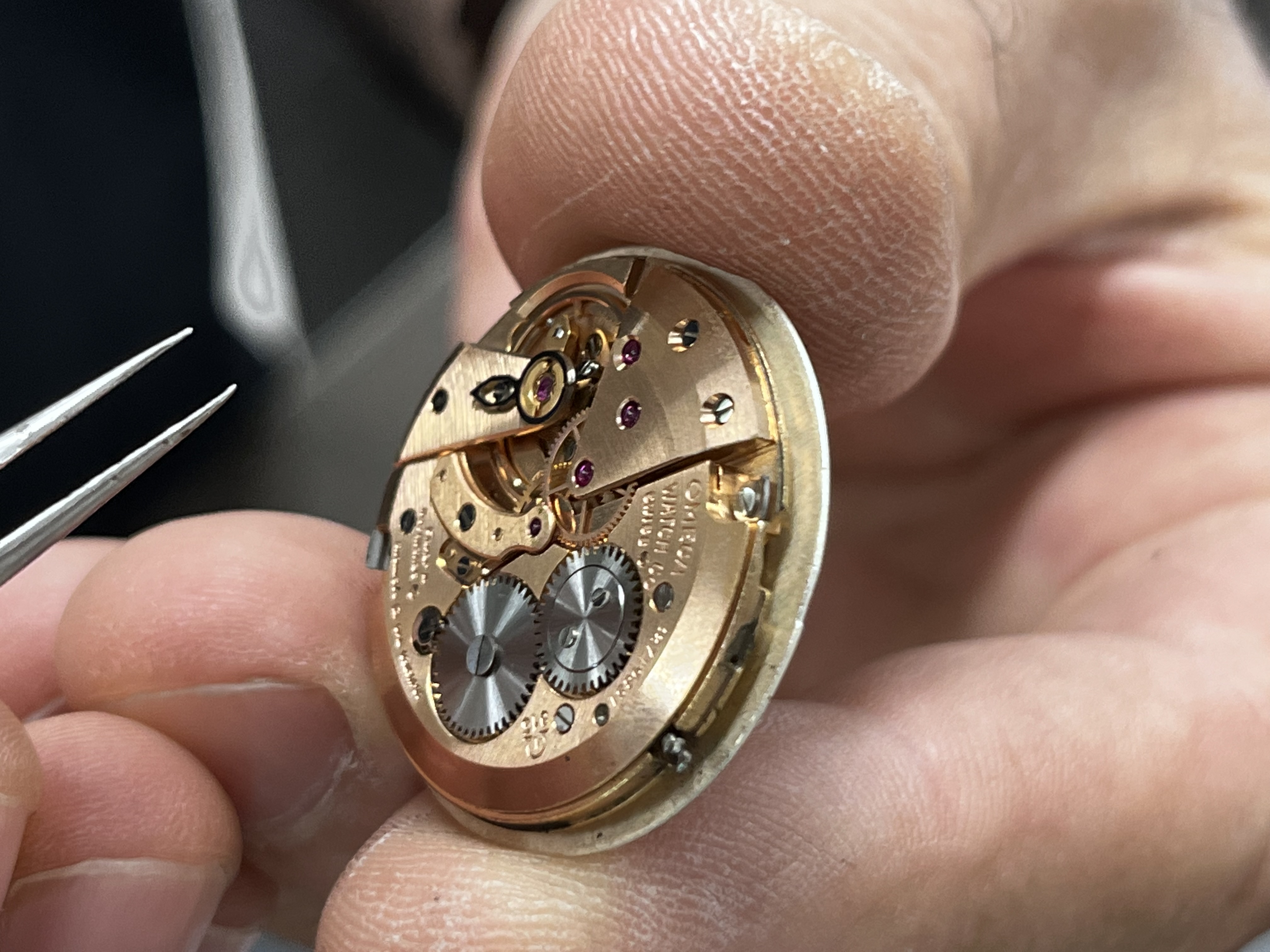

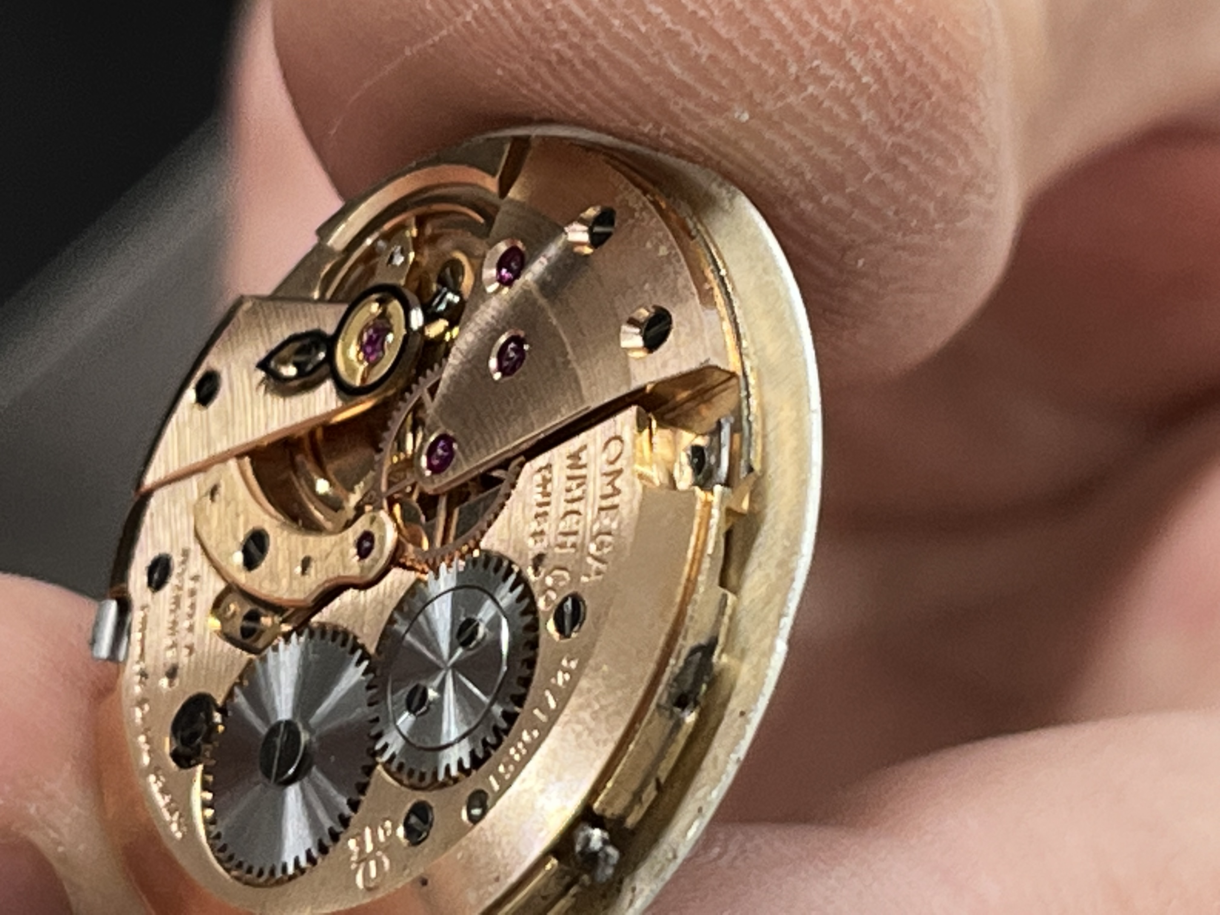

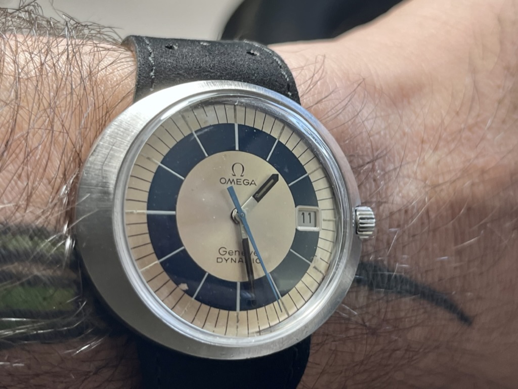

Posts 7 Likes 0 allfacts_omega ·May 11, 2023 Just got this Omega Geneve Dynamic ref 160.039 manual wind watch for a pretty decent price (under $300). It rattles noticeably in the case, is that normal?
Posts 4,519 Likes 11,127 redpcar ·May 11, 2023 If something is loose, something is wrong. Better have it checked out.
Posts 7 Likes 0 allfacts_omega ·May 11, 2023 redpcar If something is loose, something is wrong. Better have it checked out. Definitely. The movement moves slightly in the case when turned up and down even gently. It bangs against the case wall inside.
Posts 18,841 Likes 39,184 JimInOz ·May 11, 2023·Melbourne Australia Could be an incorrect crystal. Could be an incorrectly fitted movement. Could be a missing movement retainer ring. It needs to be taken to a watchmaker, preferably before you wear it again.
Posts 7 Likes 0 allfacts_omega ·May 13, 2023 Thanks for the response- my watch guy said it was damaged when someone tried to open it. See the photos.
